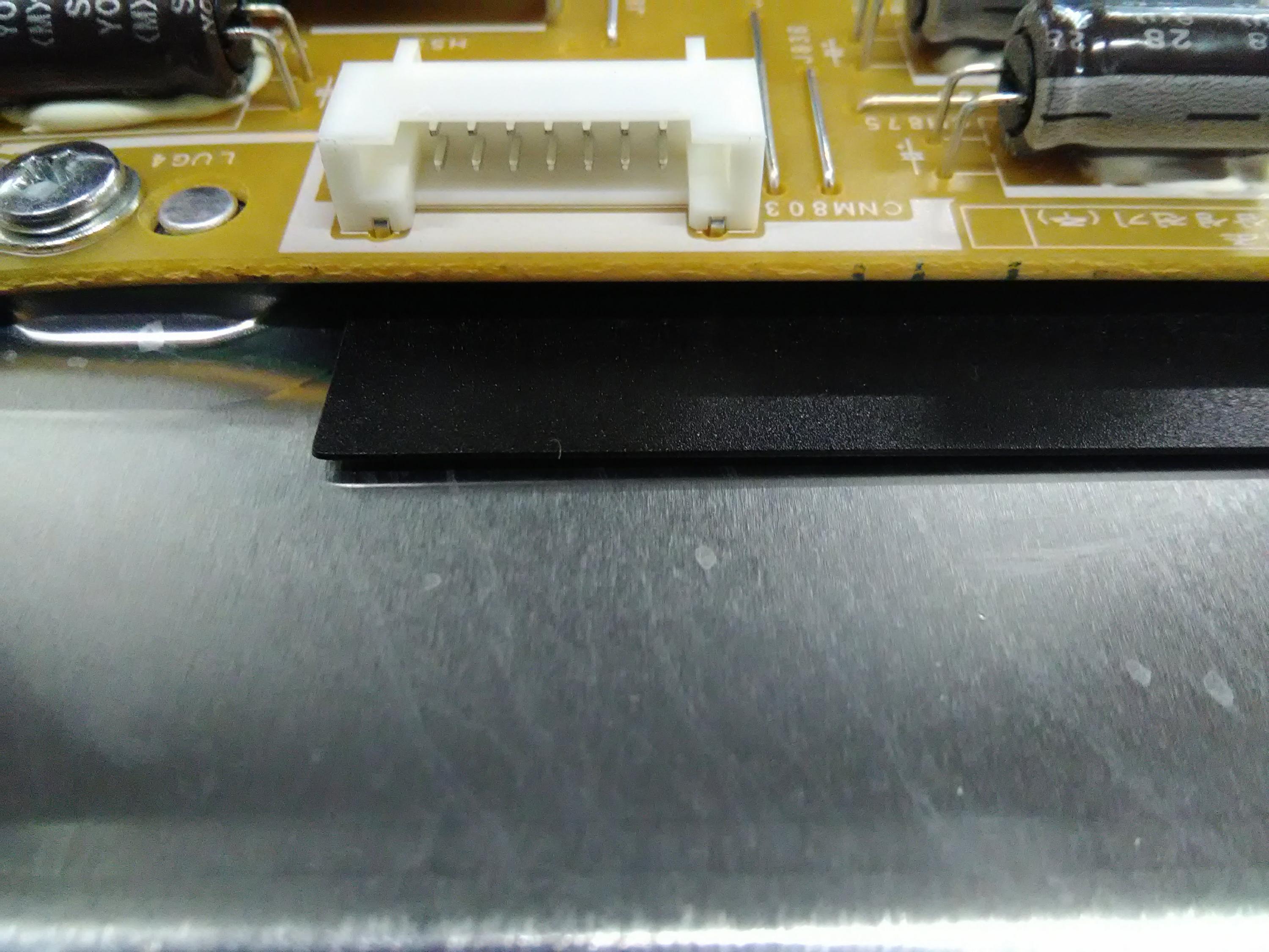

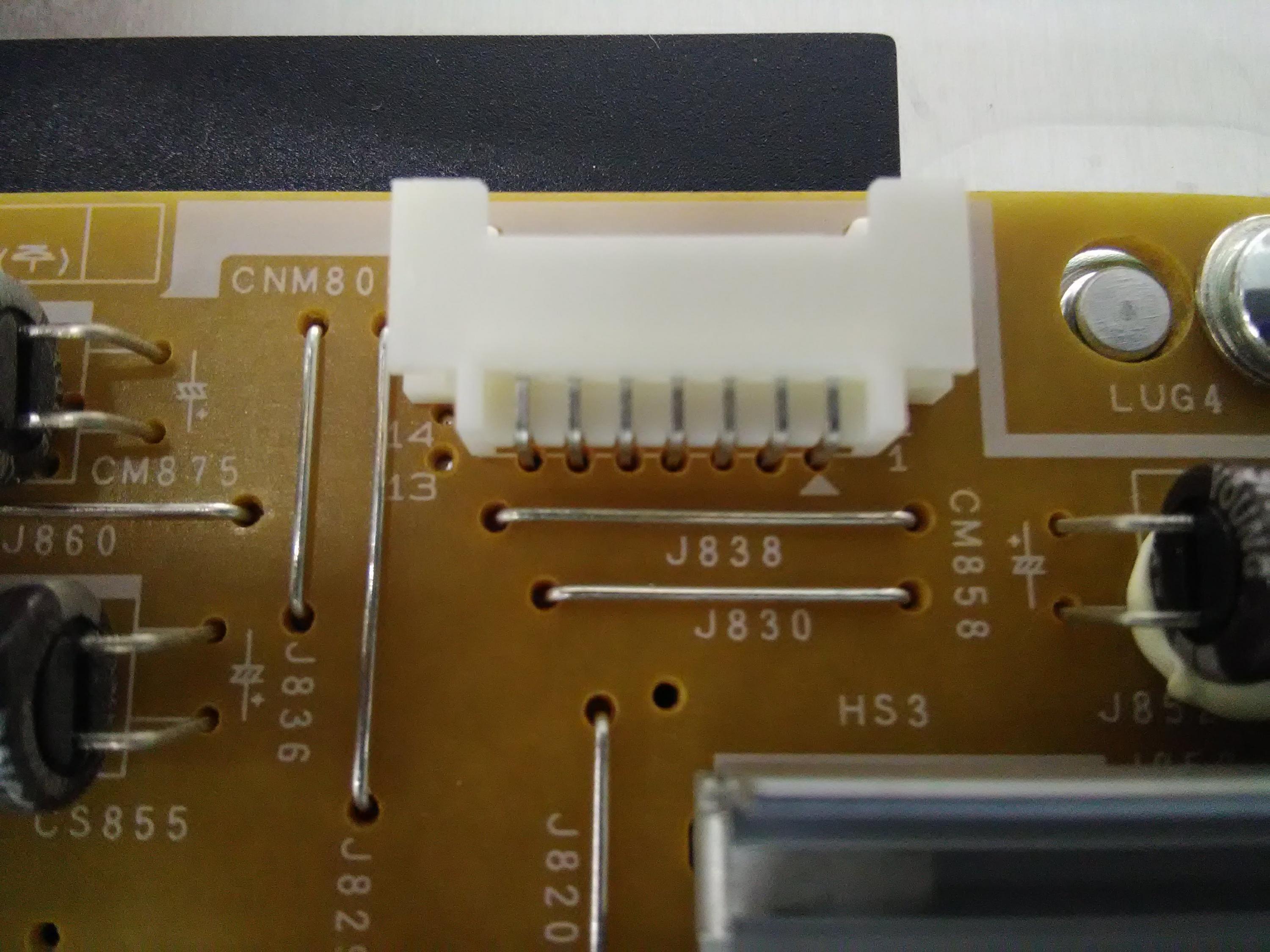

    Samsung UN55ES6003 sometimes have to hit power button 5 or six times to come on, on both remote and television. No flux in voltages on power supply getting 12.68 all the way across and 5.24. T.V. works perfect when on. Wondering if main board has possible short.
    Re: Samsung UN55ES6003 on and off
    Remove connector CNM803 on the power supply board and inspect both the socket and pins to see if there is any sign of burnt mark or not. The ES7000 and 8000 series have problem with the connector.

        Checked connection on board do not see any burn or scorch marks. Wondering if it could be the cable although it looks good also.
        • nomoresonys
          • Jan 2013
          • 12206
          • U.S.
          Check the cable for continuity, be careful not to spread out the connectors.
