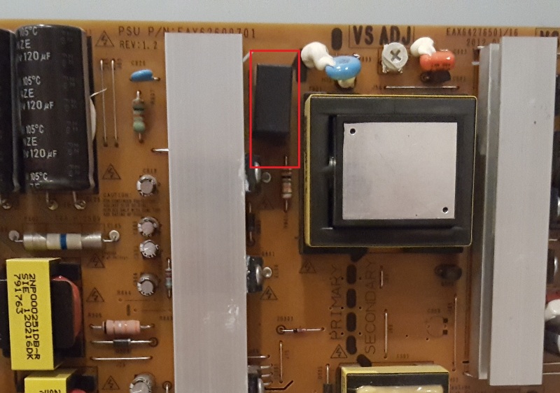

    Hello guys,
    I got the broken plasma LG from ma friend to take a look at.
    The tv cant start. If i plug in the cable i can hear the relais klicking several times. It tries to start and klicks again after a few seconds. No picture.
    Removed the above right connector. Still the same error.
    I found out, that its a power supply Problem.
    I measured a few things with the multimeter. Did also a few tests with m_on and rl_on connected to the stby pins like described here.
    http://tomtechtodrepair.blogspot.de/...d-diy.html?m=1
    I cant measure the 190v or more. I can hear one relais clicking. After moving the m_on switch, i hear the other relais, but no Output on vs. And then the same thing starts as described above. One relais starts to klick and after a few seconds the other. Again and again.
    Couldnt recognize any bad capacitors. Fuses are good, Running out of ideas.
    This is the power supply

    Re: LG 50PA6500 power supply Relais klicks
    Replace cap as shown
      Thank you! This was the solution. Got one from a local store. It has a bigger size, but i could connect it with some cables. Working well now.
      3,49€ repair costs Couldnt be better
