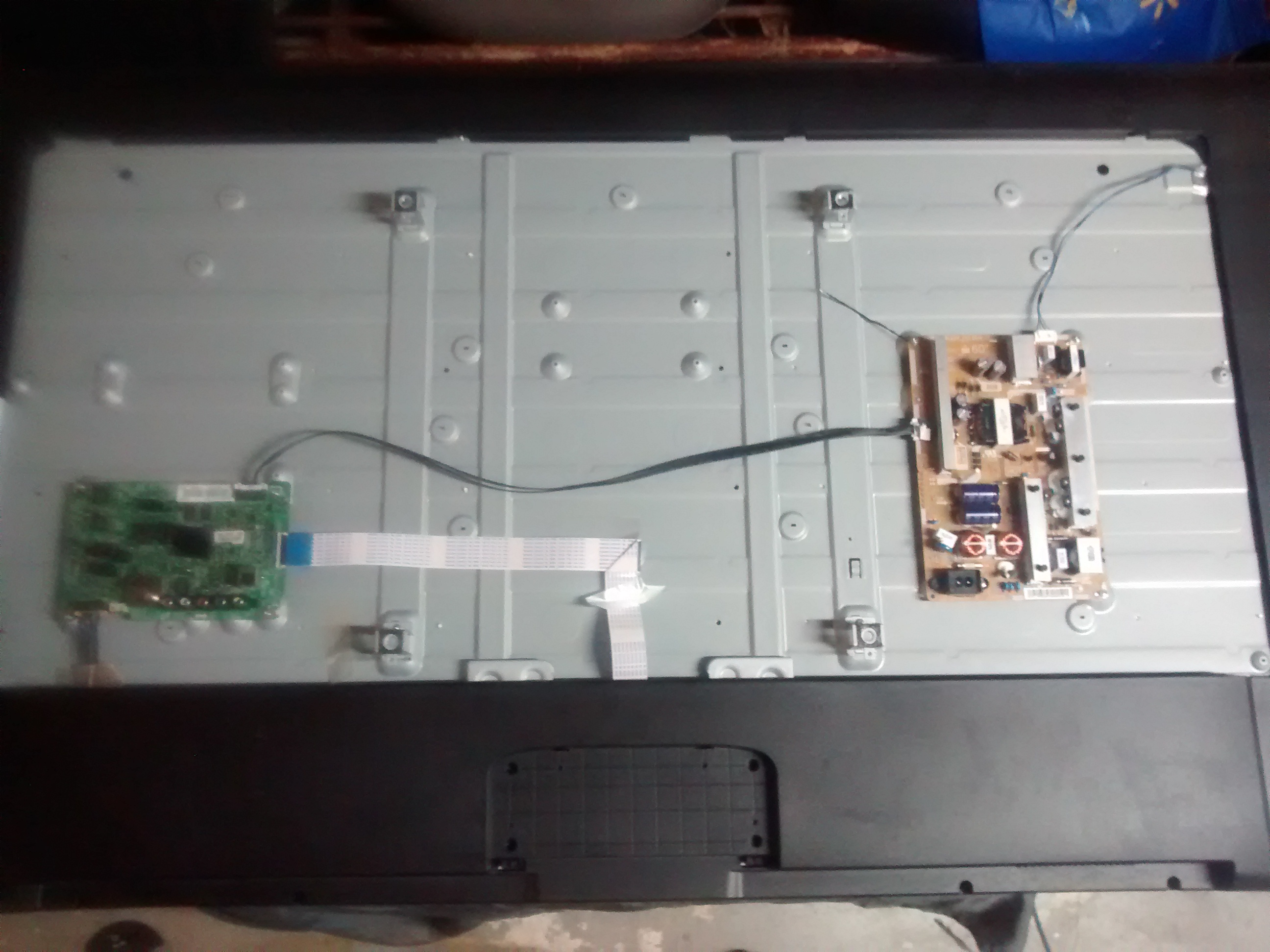

    i jumped the gun again, and completely reassembled the TV when i should have left it apart to test the psu and backlight combo but i didnt.
    once i got it back together and tested the psu and backlight by themselves, or with the mainboard connected i
    was now getting a strobing backlight, and im pretty sure its crashing the
    mainboard as well because when its connected i cant see any image at all when powering on.
    when i leave the backlights diconnected, and all other boards connected normally and power the backlights seperately with the LED tester, i can see the picture is fine, the menu is fine. the LCD is fine, not cracked. the TV looks great, if only a little dark because only one string is being lit.
    in this state, i unhooked the led tester from the backlights and plugged the
    backlight connector into the PSU and immediately get the strobing light, and
    the image that was on the screen gets corrupted in some weird way. and the tv would not respond to power off requests. i had to unplug it.

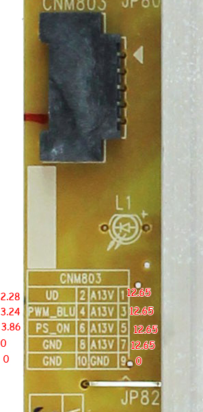

    voltages, with MB and BL disconnected:
    for the mb connector:
    on the 13v pins im getting 12.65
    others:
    UD: 2.28v (no idea what UD is)
    PWM_BLU: 3.24v (seems normal but i just dont know anymore)
    PS_ON: 3.24v (ditto)

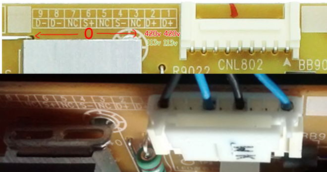

    for the LED connector
    im getting 401v on pin 1 and 2 and 0v on all others
    (no idea how to know what to expect as normal V+ on these pins with no boards or LED connected, but 400v seems like enough?)
    voltages with MB disconnected, BL connected: (while BL strobes, which i dont like to do for very long...is this damaging?)
    on all the 13v pins im getting around 5v
    and 0 on all the others except 1.6v on the PS_ON pin
    on the LED connectors i get 113v on pins 1 and 2, and 0 on all the others.
    the 113v seems in line with the 115v i was getting on the readout of the LED tester, but why does it fail?

    continuity between harness pins and connector pins for LED connector are good. pins are making contact with the wires.

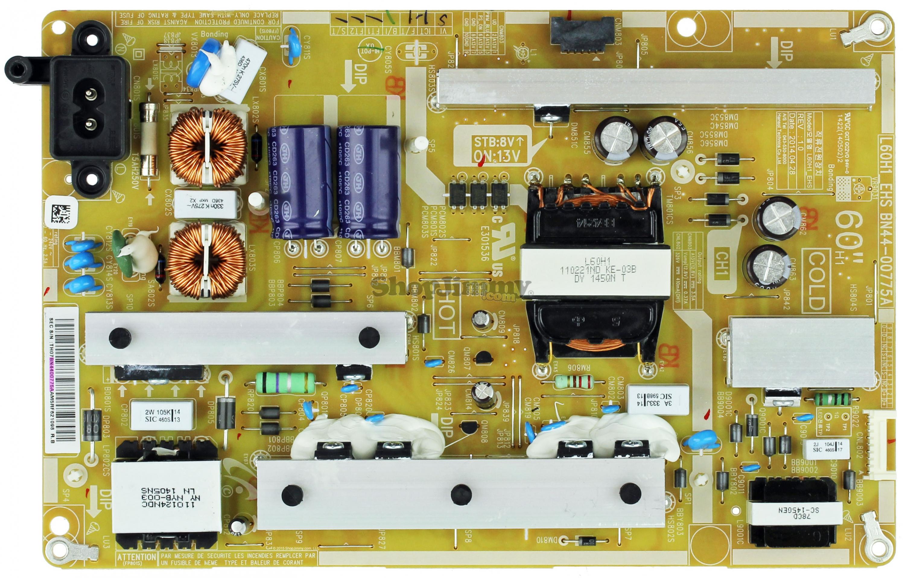

    psu model:
    L60H1_EHS BN44-00775A
    BN4400775A
