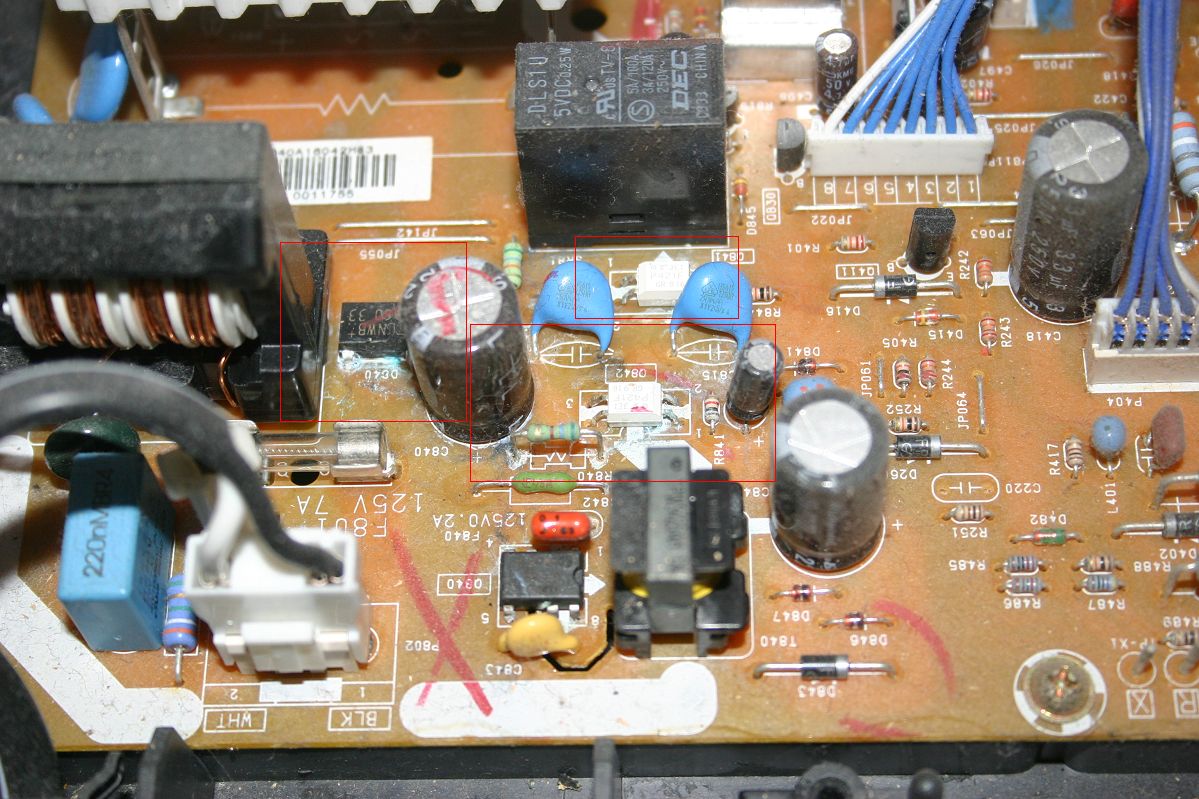

              This is excellent, thank you. I had a question. On the power board, I've noticed a bunch of blue gunk on some of the chips. Do you think these could possibly be bad?

                    The blue color comes from corrosion/electrolysis of the component leads. It is conductive.
                    Get some 70% rubbing alcohol and a old soft toothbrush and clean and flush in and around those components. Get the bristles underneath them if you can. Check the underside of the board also. Clean in the same manner. Then dry the area thoroughly with a hair dryer set to medium or low.
                    If it's a coolant leak, projection tube has lost its seal, it's a major problem. Since it is very specific to that area, you should be able to see where it came from.

                      Alright. I'll have to give it a shot, and hope the components haven't shorted themselves out. Thanks.
                      I checked and the projection tubes are still intact, so I'm left to blame good ol' H2O.

                        this area you snapped pic of is 5V standby power. Not that one. Go more toward front of the circuit board where big yellow and dark grey transformer is. Those are where fuses are. But this one you snapped is not the fuse we talking about.
