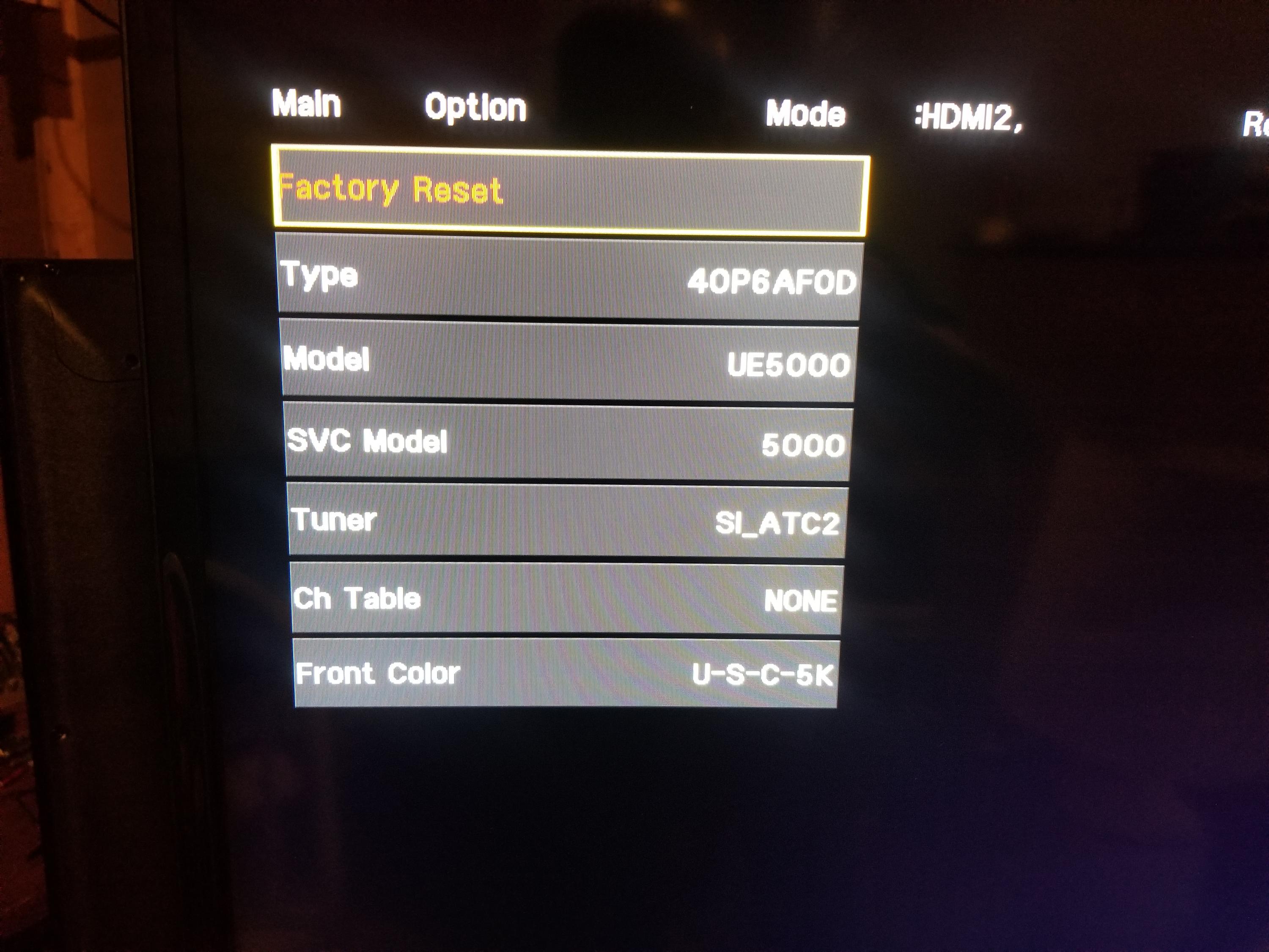

    Replaced a main in this set and I'm not quite sure what the settings in the service menu need to be.
    When powering on, it gives the message to set the Local, Type, and Front Color.

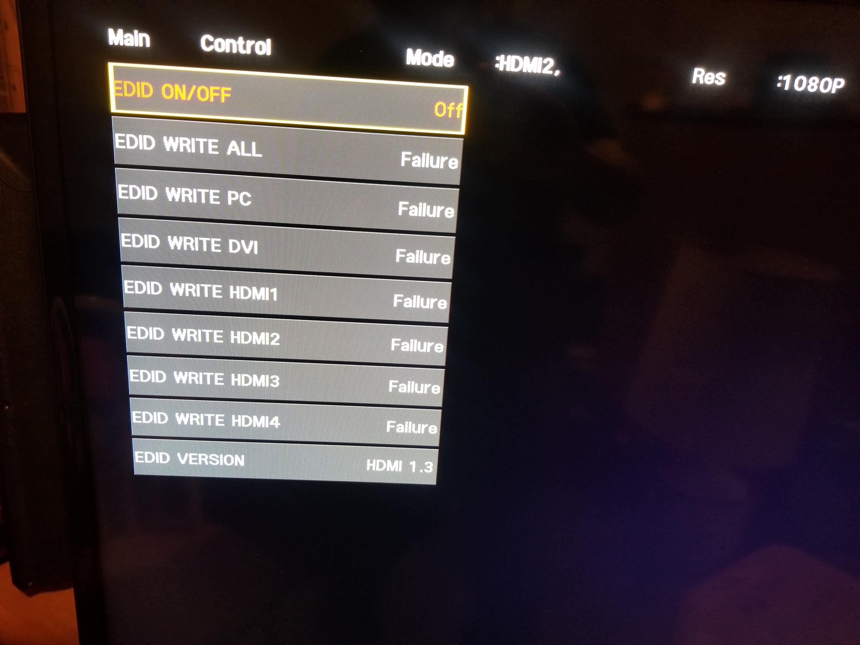

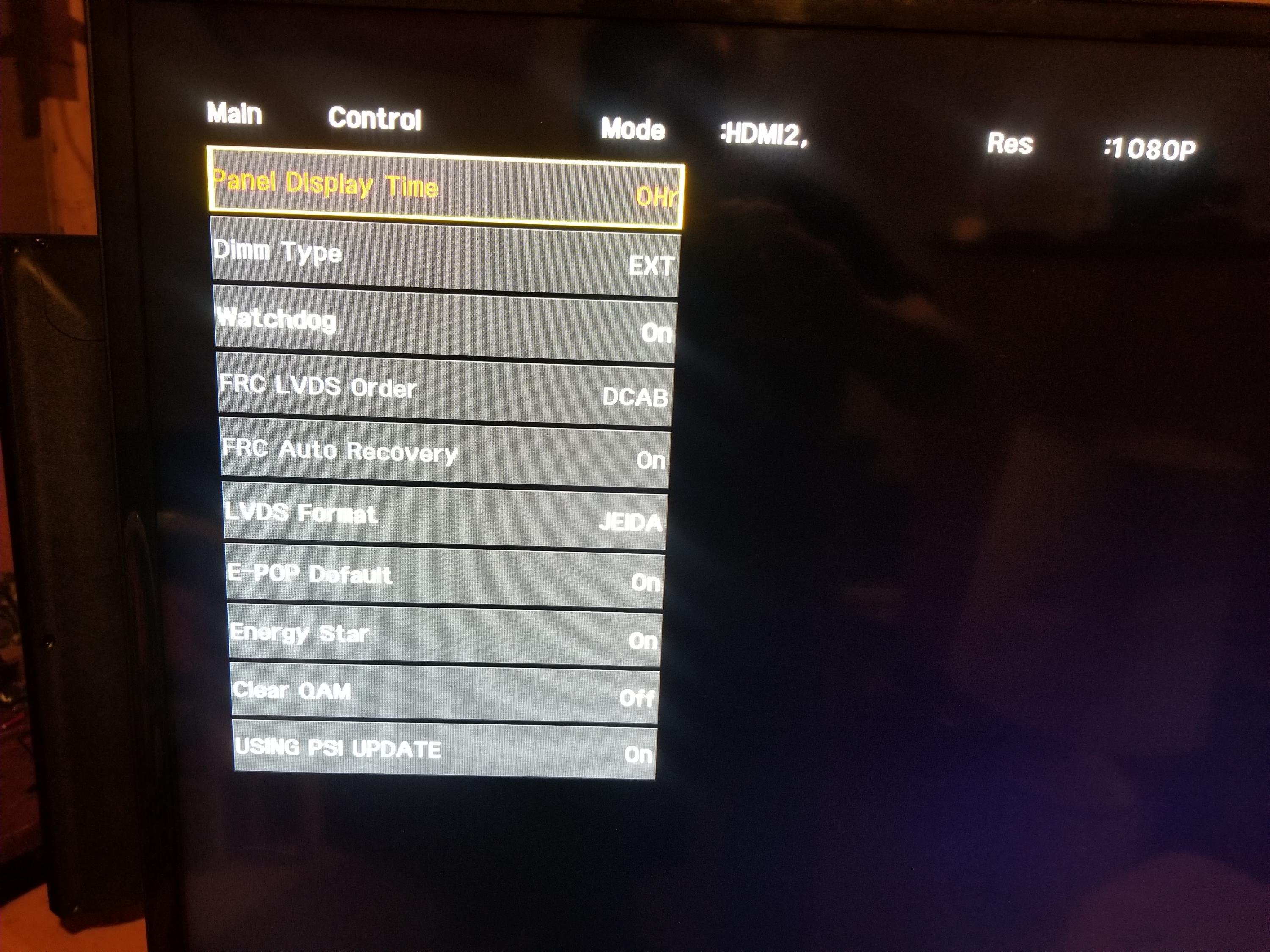

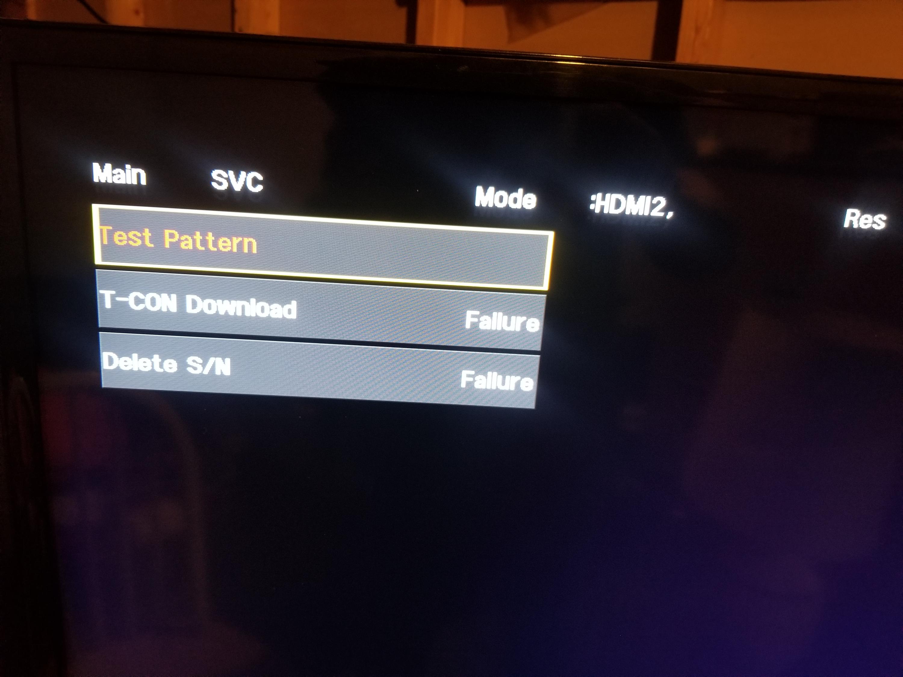

    I also notice while in service mode, the failures in the attached photos.
    Hopefully someone can tell me what the settings should be.
    I've looked online and couldn't find much about the actual settings.

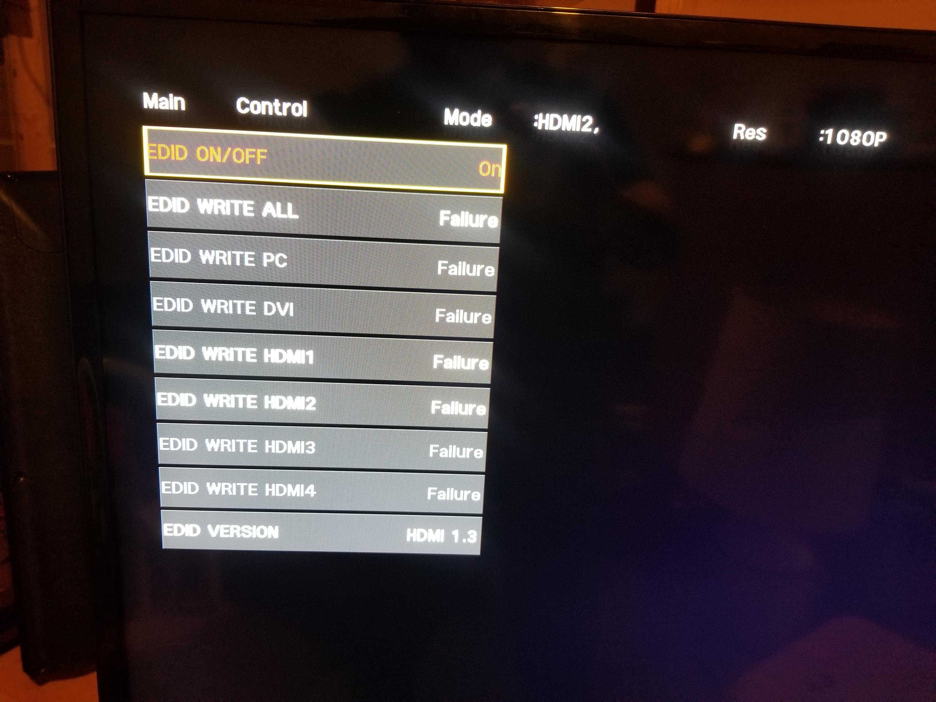

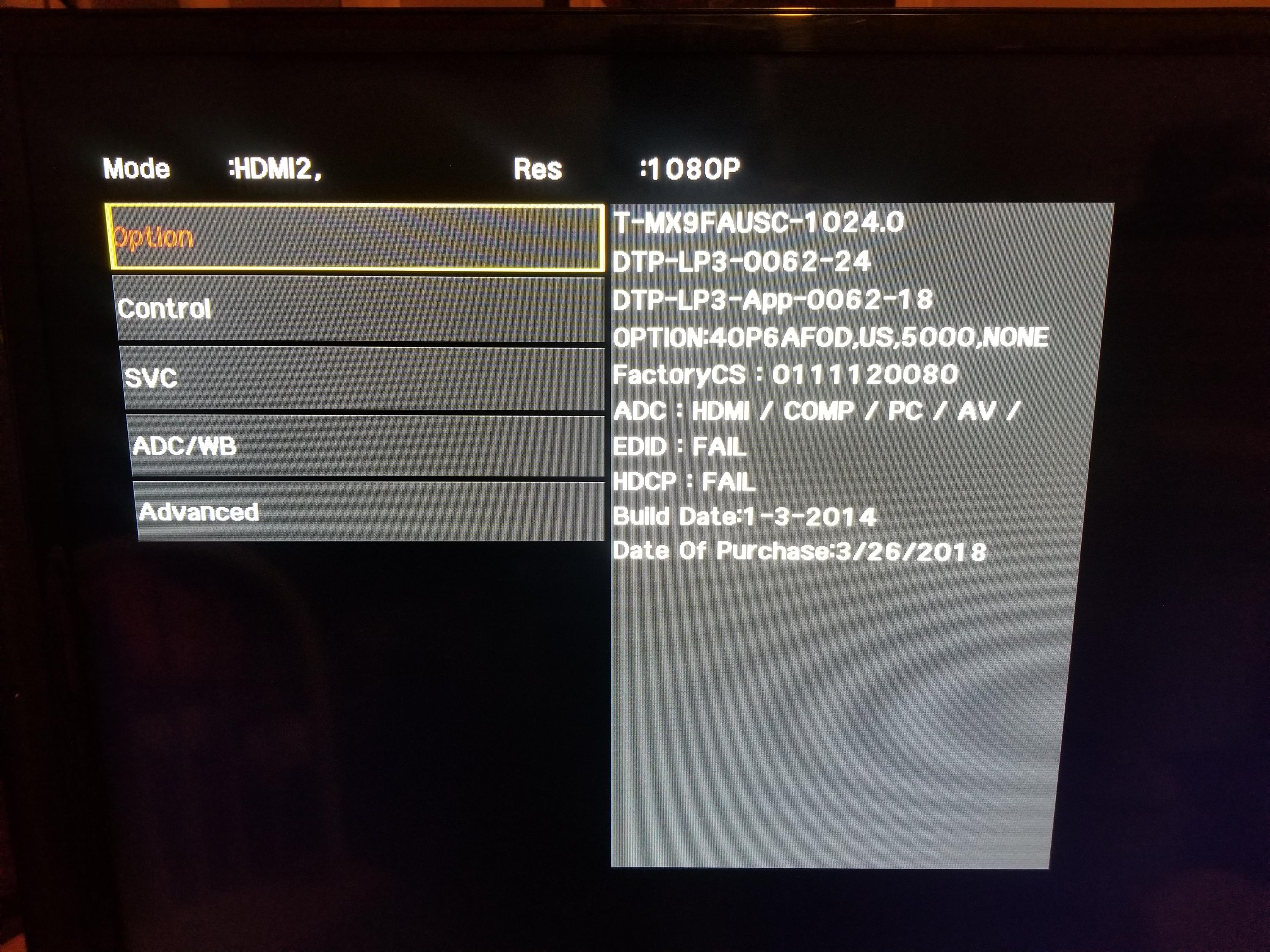

        When hooking up a video source, Blu-Ray player, it will show the Blu-Ray symbol as the player boots up, then the screen shuts down. Not off, but the backlights go out and nothing appears on screen. EDID and HDCP both show FAIL after factory reset.

                  Post #2 might be helpful, seems like he went into EDID sub menu and turned it on. http://www.avsforum.com/forum/166-lc...menu-work.html

                                    I removed the back to make sure this was the set I replaced the main on...and it isn't. (I had 4 sets apart at once and confused the main repair)
                                    This set I replaced the EEPROM on. This set also had the backlights replaced. I will pick up a whole main board and throw it in there to see if that gets her goin'.

                                      New main did the trick. Checked the service menu and both EDID and HDCP had SUCCESS after it. Did a factory reset and all is well again.

                                        Thanks for feedback, so looks like the service menu settings didn't help with the edid and hdcp giving failure report, needed mainboard for the fix, thought that mainboard was buggered up, glad you got it sorted.
