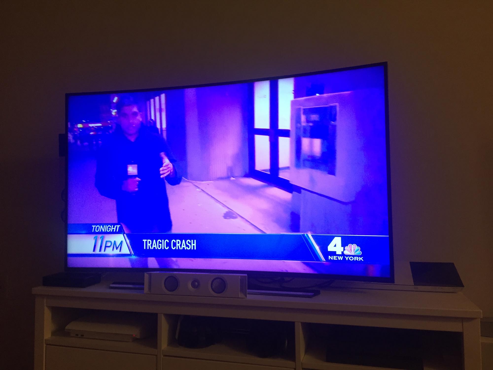

    TV Samsung UN55HU7200 screen color issue
    Hello!
    Something very weird is happening with my TV. When I watch ordinary TV the colors look too much blue saturated, but when I open the menus of the TV, they have normal color. If I open the smart app, normal colors. If I open youtube, normal colors too, but when I play any youtube video, boom, everything gets blue saturated again.
    Anyone has any idea?

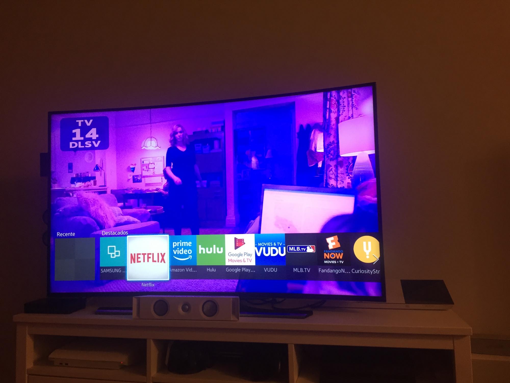

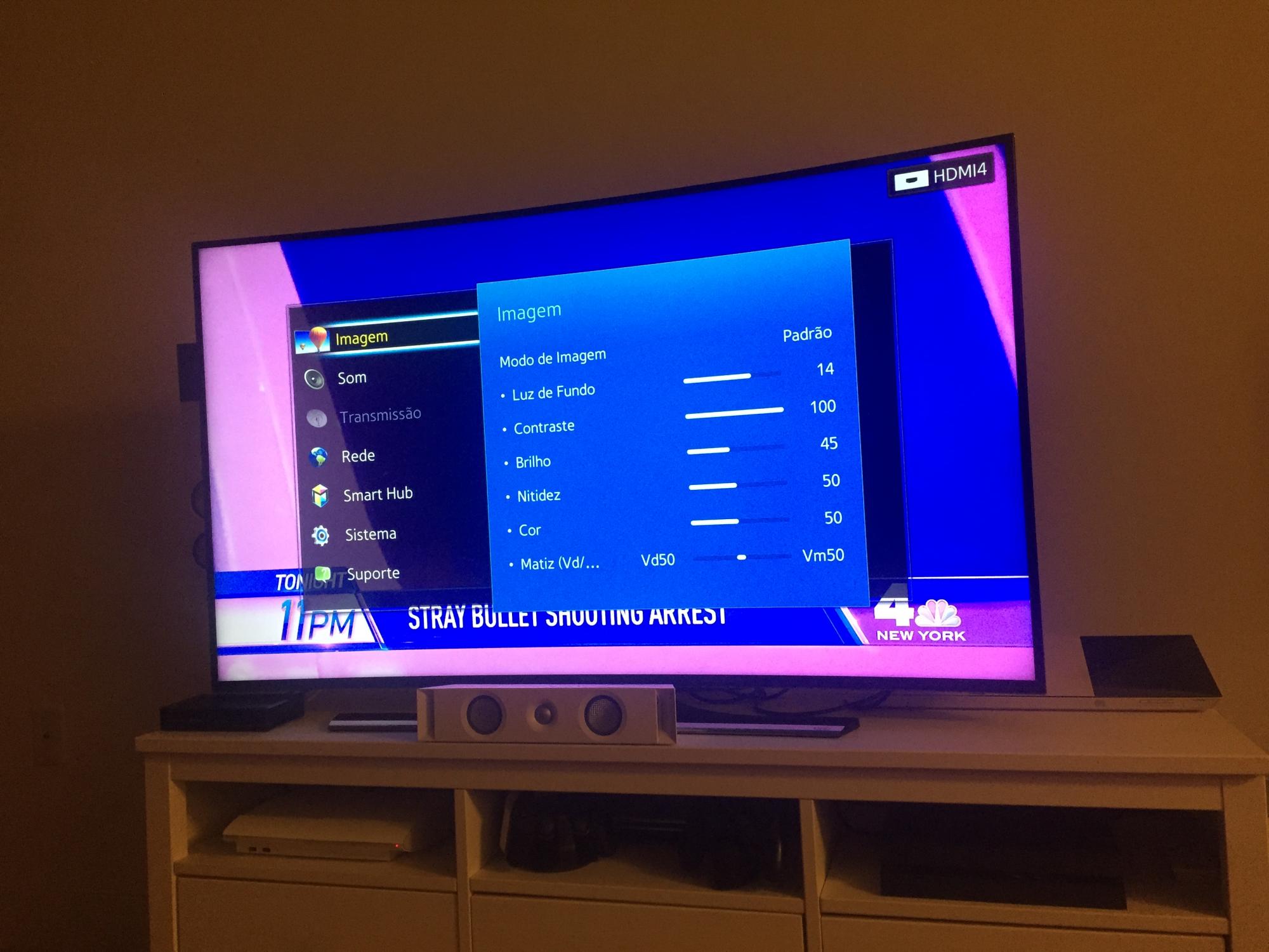

    Re: TV Samsung UN55HU7200 screen color issue
    some images
      Try a firmware update? Certainly a mainboard issue as your menus and apps look good that alleviates the tcon or the panel as an issue.
        Tried firmware update already.
        And yes, all menus are ok. Very weird issue.
          So, I was reading about tcon, you think if it was tcon the menus would be problematic too?
            Yes. The tcon decodes for whatever comes from mainboard. So menus and apps would appear messed up too. This has to be mainboard related.
