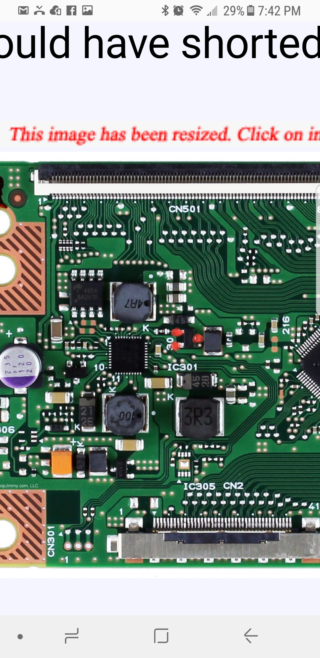

                  Re: Last chance Bravia. blank or white screen KDL-60EX645
                  I had the sheild off before plugging the TV on and testing. I was pretty carefull with the multimeter, and cant see how I would have shorted anything.
                  F101 bottom right. I cant even see a slip of the probe being able to touch 2 pads and short something. Yet I wonder if just using the meter could have caused the short?

                            From the sounds of it you are missing VGH voltage. This will cause the white screen effect. There might be a slight possibility that there are some pico fuses located on the panels source driver boards. You might be able to get in there in check all capacitors and resistors on the panel boards for shorts or opens especially around VGH
                            I'll give the panel boards a check. The driver tabs was my first suspect, as when I was flipping the TV over durring reassembly one of the tab ribbons got twisted up on the frame. Didn't look too damaging, but it was the only thing that I did witness.
                            I swapped the connecting ribbons from the second set, and aside from attempting to swap the tabs, if thats even possible, I'm out of ideas.
                            Thanks a lot for the help though. I'll check the driver boards now.

                              Here's some pics. I have the driver tab/boards removed off the second tv, yet I can identify any fuses. There are 2 fuses on the right bottom of the T-con that have less than 1v on one side and 0 on the other. Also no continuity across them.

                                    I used a continuity tester, yet I'm thinking there not fuses. The 2 arrows on the far left, 103 & 242, have resistance of 2300 ohm and 6300 ohm. Which would explain why my 1 AA battery and bulb continuity tester wont show continuity.

                                      The arrows on the right are just the fuses I checked. I've noted they have letters, and the ones on the left are numbers only. Resistor?

                                        OK so YD is the fuse. That's open. 1r0 is a 1 ohm .also open. You got tcon problems man. And I would be expecting a problem with the panel replace that fuse in that resistor power of the tcon with no panel connected. Check for voltages around coils you should have higher voltages some around 28v in some areas for HVDD
                                        103 is a 10kohm. 242 is 2.4kohm.
                                        If I'm understanding you YD is open right?
