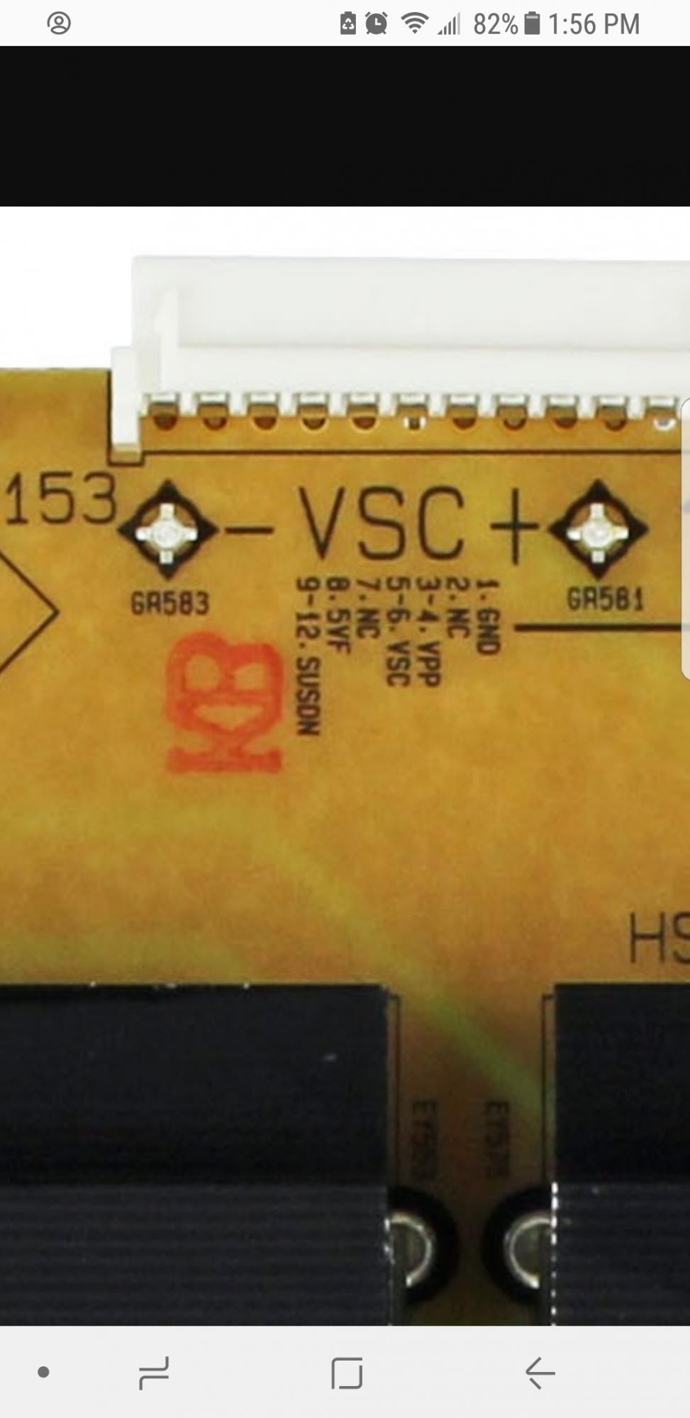

          This is your VSCAN test points? Red to +, Black to -.. do you have voltage there?
            Re: EBR73712701 YSUS No Vsc
            No I do not but that is exactly my point. If you look at the solder side of the board it looks like Vsc+ never makes it to the test point except when it is passed through the upper buffer.
            I've also read about the ribbon being damaged, I did a quick inspection on the second from the top ribbon and I see nothing.
            Testing with the bottom buffer properly... disconnect upper buffer from the Ysus and leave the data ribbon connecting the two buffers connected ? Or remove upper buffer completely ?

              On this particular set it appears that Vsc is passed between the buffer boards by the Y-sustain. So indeed with a missing upper buffer you will not read Vsc. This is NOT the case for every plasma. They do things differently on different sets.
              You need, in this case, to check Vsc with all boards in. If the voltage on the big 10R resistor is LOW after this, you may have a shorted buffer

                        Ok so reassembled and no prime and no Vsc and no -Vy. Well there is a slight buzz from the ysus about every second and the -Vy goes from about 13v to around 30v. Vsc is essentially zero.
                        Either the ysus is not repaired properly or I have a failed buffer dragging down my ysus.
                        Is it safe do you think to run the set with just the lower buffer to see if I get prime and good voltages ?
                              You had -vy before. Was this with buffers disconnected or connected because if you tested it disconnected before then buffers are loading down the y board since connected no -vy
                                #35
                                Correct. I have both of those voltages without buffers connected. When connected they are gone or pulsing at a much lower voltage.
                                I've forgotten how to bench test buffers properly. Will look it up to verify a short in one or both.

                                  Most likely a buffer short. Most likely vscan does not come up without buffers connected and connected dead short considering the pulsing ysus. In this case you will not have vscan either way.

                                      Confirmed upper buff short in either the top one or top two ic's. I've replaced these scan ic's on Samsung buffers anyone have the same success on these LG buffers ?
