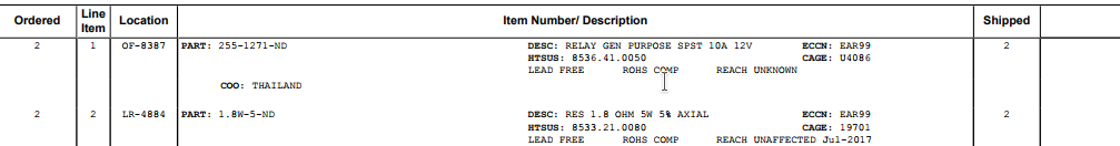

                        My TV has the same exact problem and I've been searching for a solution and glad that I found this thread. Can you please give me the part numbers of the relay and resistor from Digikey? Any pictures would be great too. I have no experience in soldering components on the board so I plan to have my friend do it for me. My other alternative is to order a used power supply board from ebay which costs around $100 and there's no guarantee that it will work. Thanks in advance.

                          Re: Toshiba 46XV545U No power-only orangle light blinks
                          here we go my friend
                            If you want the same radial type the closest digikey has is a 2 ohm 5watt https://www.digikey.com/product-deta...2R0E-ND/824543
