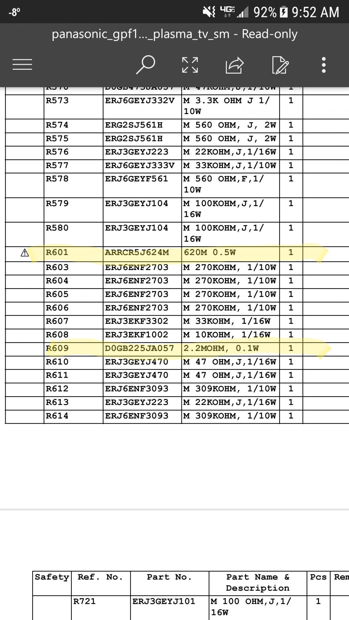

    Trying to put in kit to fix my sc board must have put in D618 backwards. Upon testing popped R601 and R609. Anyone know the values direction if it matters so in can rrplace and see if it still works.

    That number comes up as a C3 buffer board. Check your number again,and list the model number of the tv it came out of.

      TC-P50S2 is the tv

        Tnpa5105ab

          I don't have the values but directional doesn't matter with these resistors.

            there's a parts board on eBay for 21 shipped, or there's a new board from China for 85 shipped don't know what one to do. What if I messed up more than I thought on the repair board.

              found a service manual and values of them both now a good place to buy. Looked on digi-key but didn't find any.
