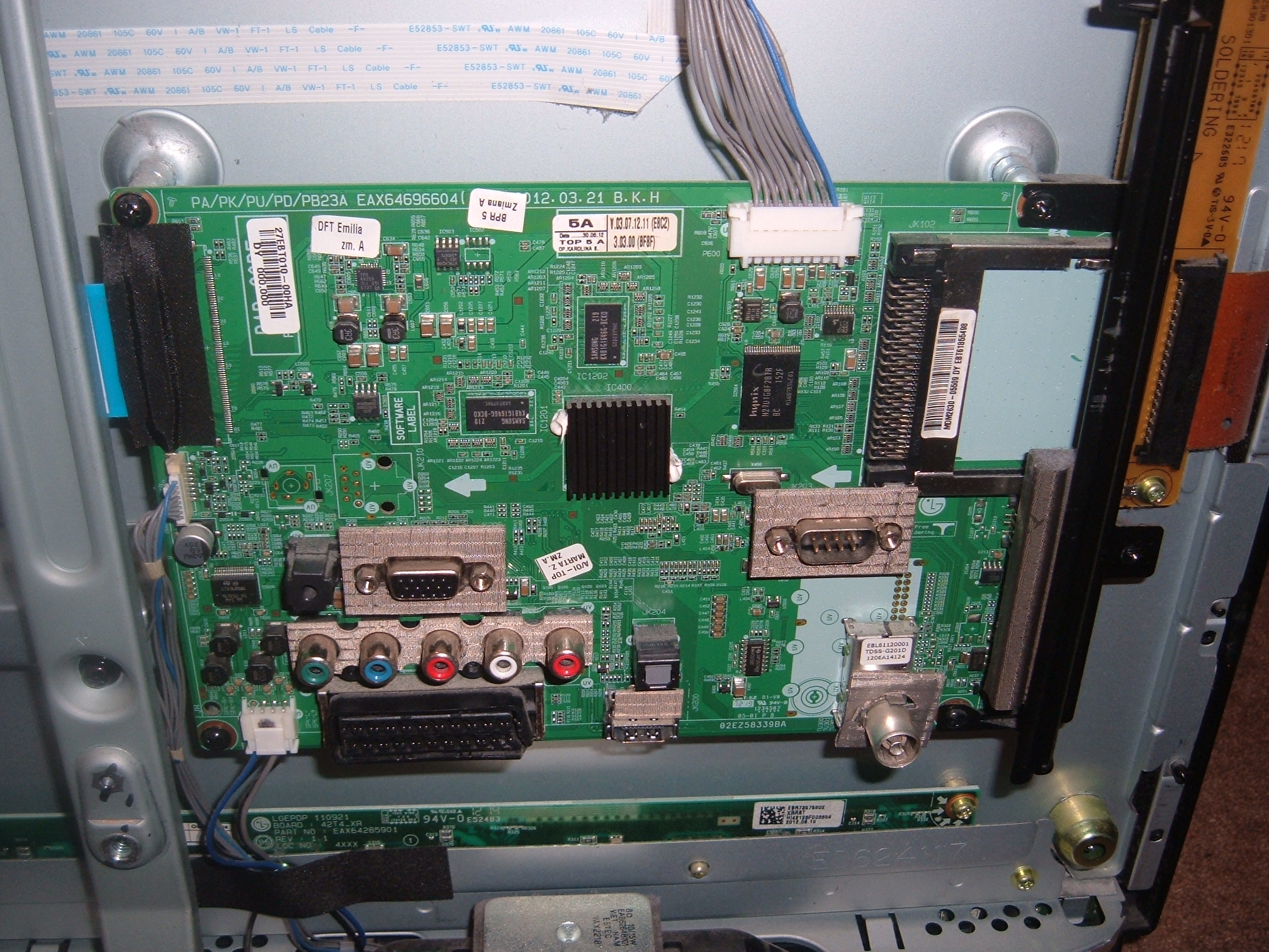

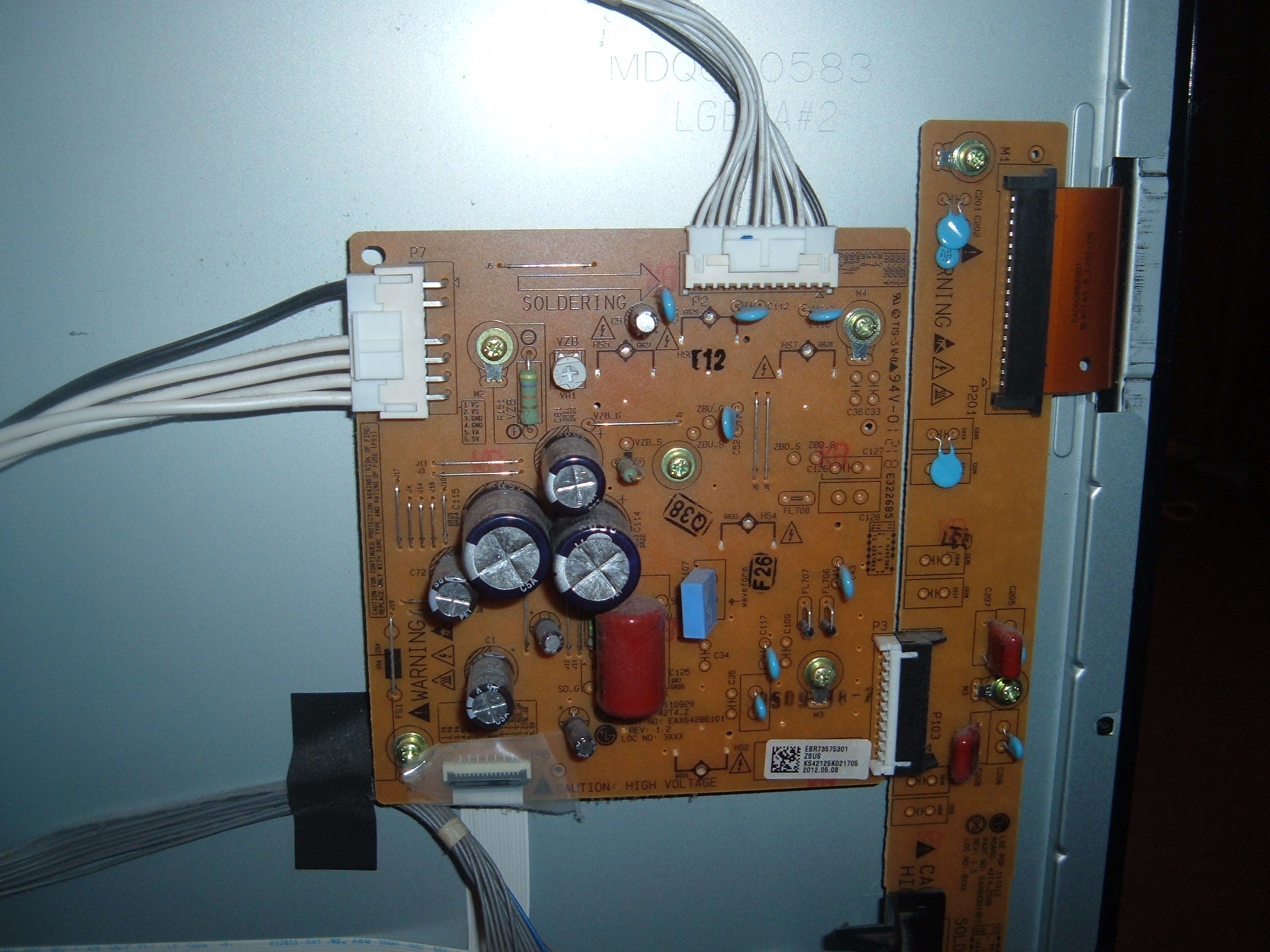

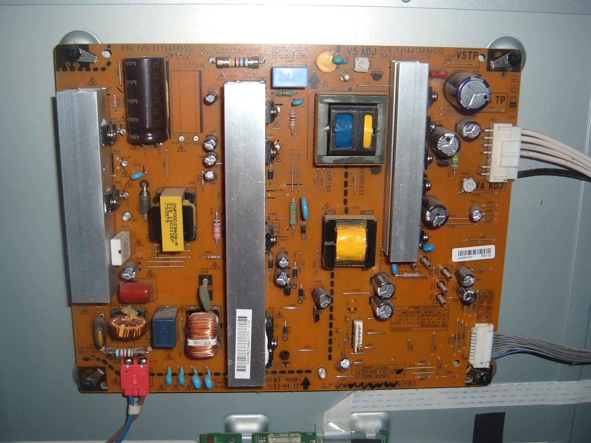

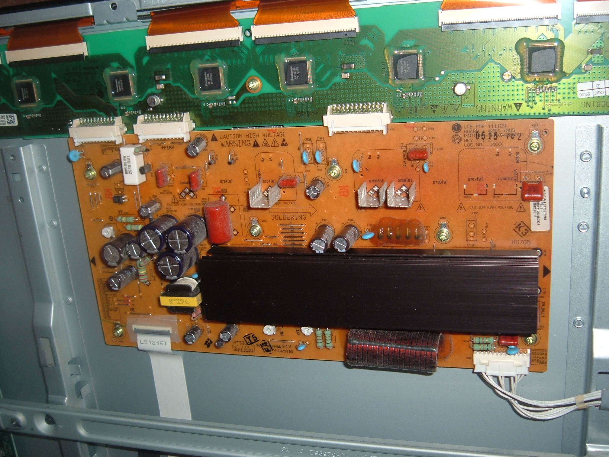

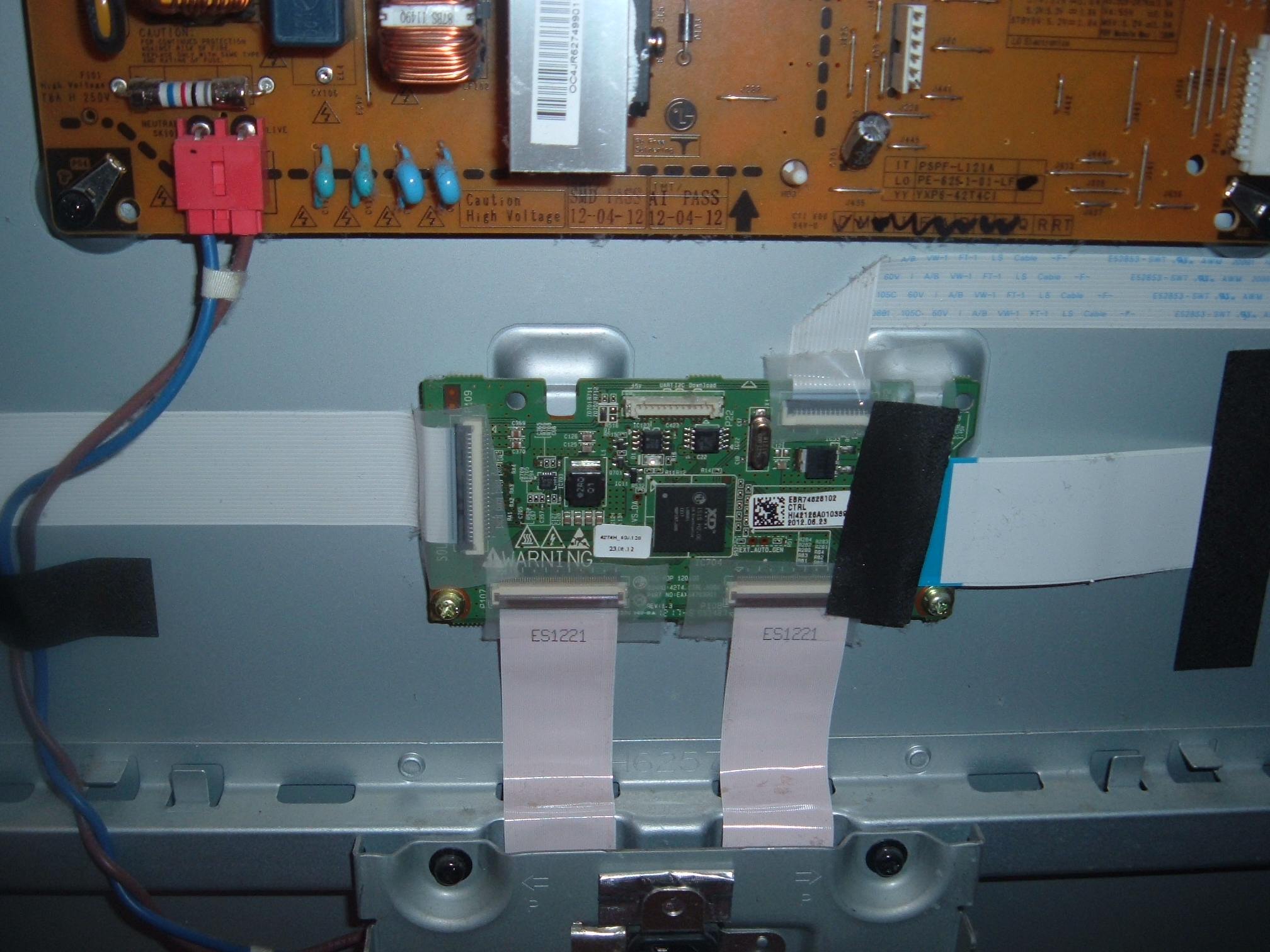

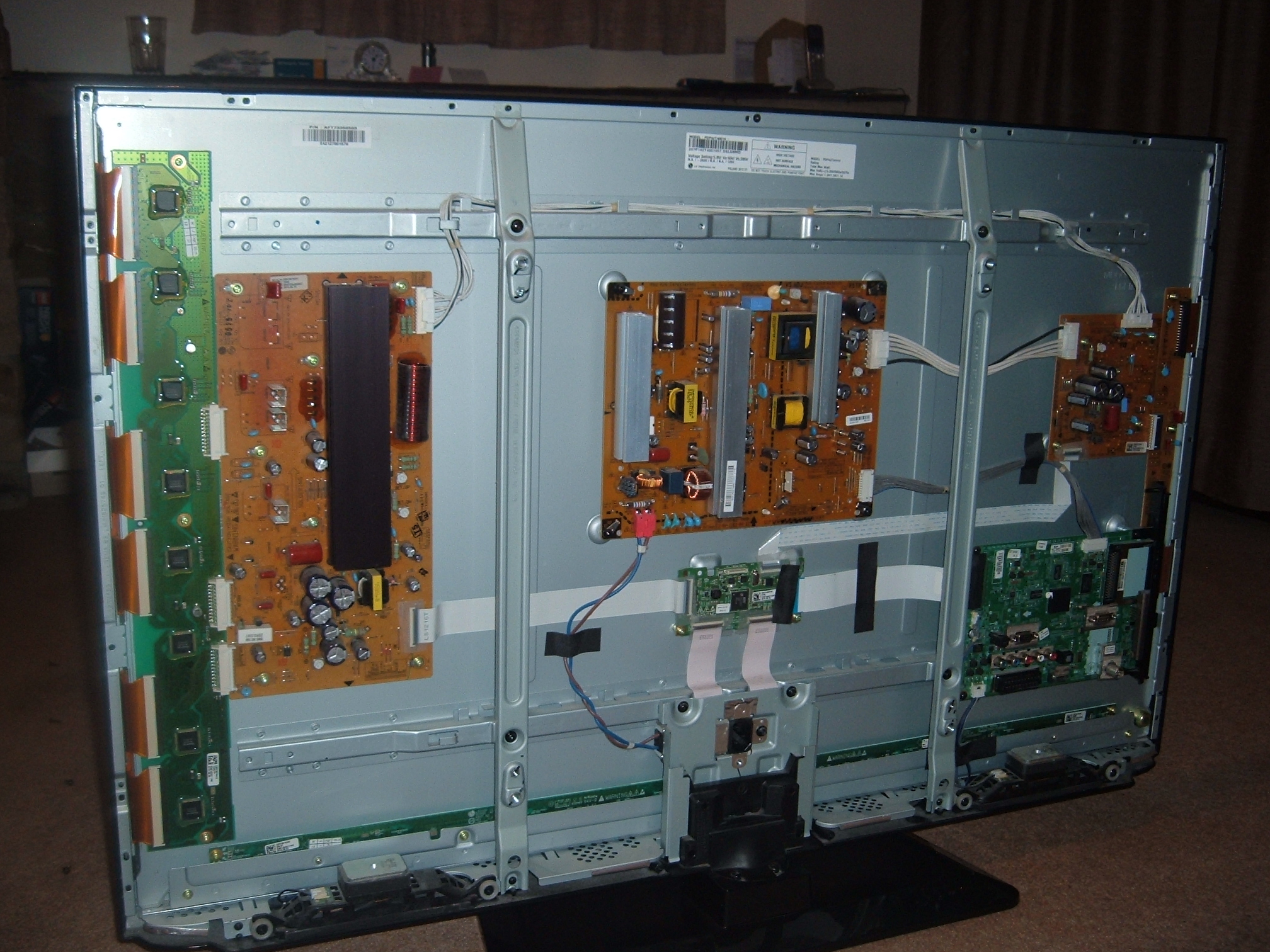

    Need good clear straight on pictures of back of tv with cover off and each board. Close up of control board. What rate is the green light flashing?
    • Ady2017
      • Dec 2017
      • 50
      Re: LG 42PA4500 plasma TV not turning on
      Pictures attached. Will post the flashing next.
            Probably a mainboard do this 1st disconnect the ribbon cable that goes from the main board to the control board.
            On the control board you'll see 2 gold color holes that say AUTO_ EXT_GEN. Jumper this with a paper clip or something and then turn the TV on and see if it goes through test patterns
            • Ady2017
              • Dec 2017
              • 50
              I have just tried jumping the 2 AUTO_EXT_GEN pins and yes I get what must be a test pattern with white bars moving across and then down the screen followed by the screen flashing red, blue and green. It looks like it is the main board then.
              Any ideas on how these things can be repaired or common culprit components.
                            It's not located on the motherboard, rather the logic board, seen on the sixth picture of post #3, unplug the LVDS (large flat cable from mainboard to logic board) and the short the EXT_AUTO_GEN pins.
