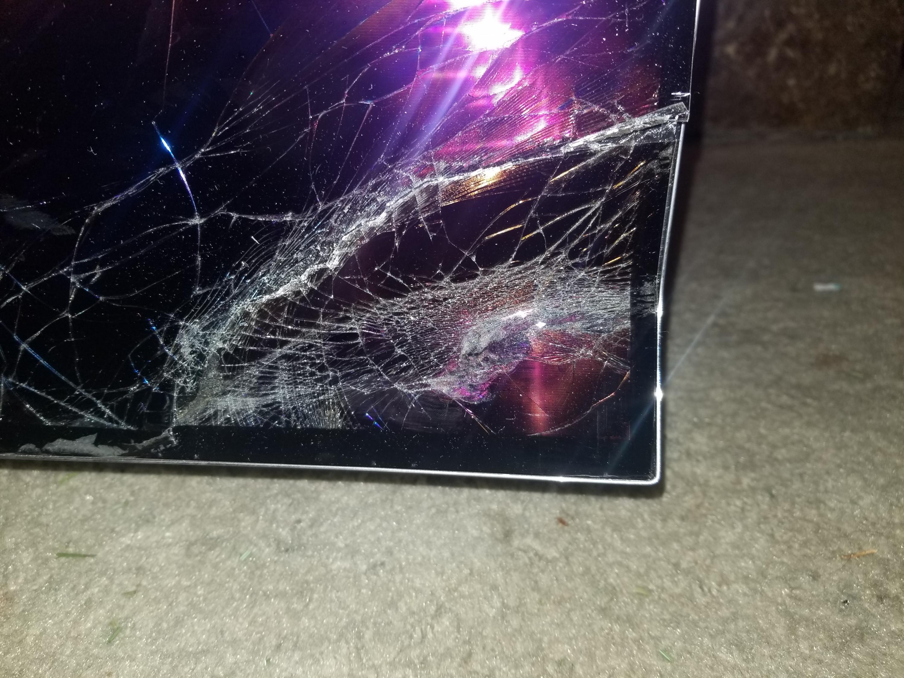

                                #75
                                Re: Just picked up a 55 inch LG 4k OLED for $50!
                                Got the damaged one. Can somebody say oopsie. Shipping damage?

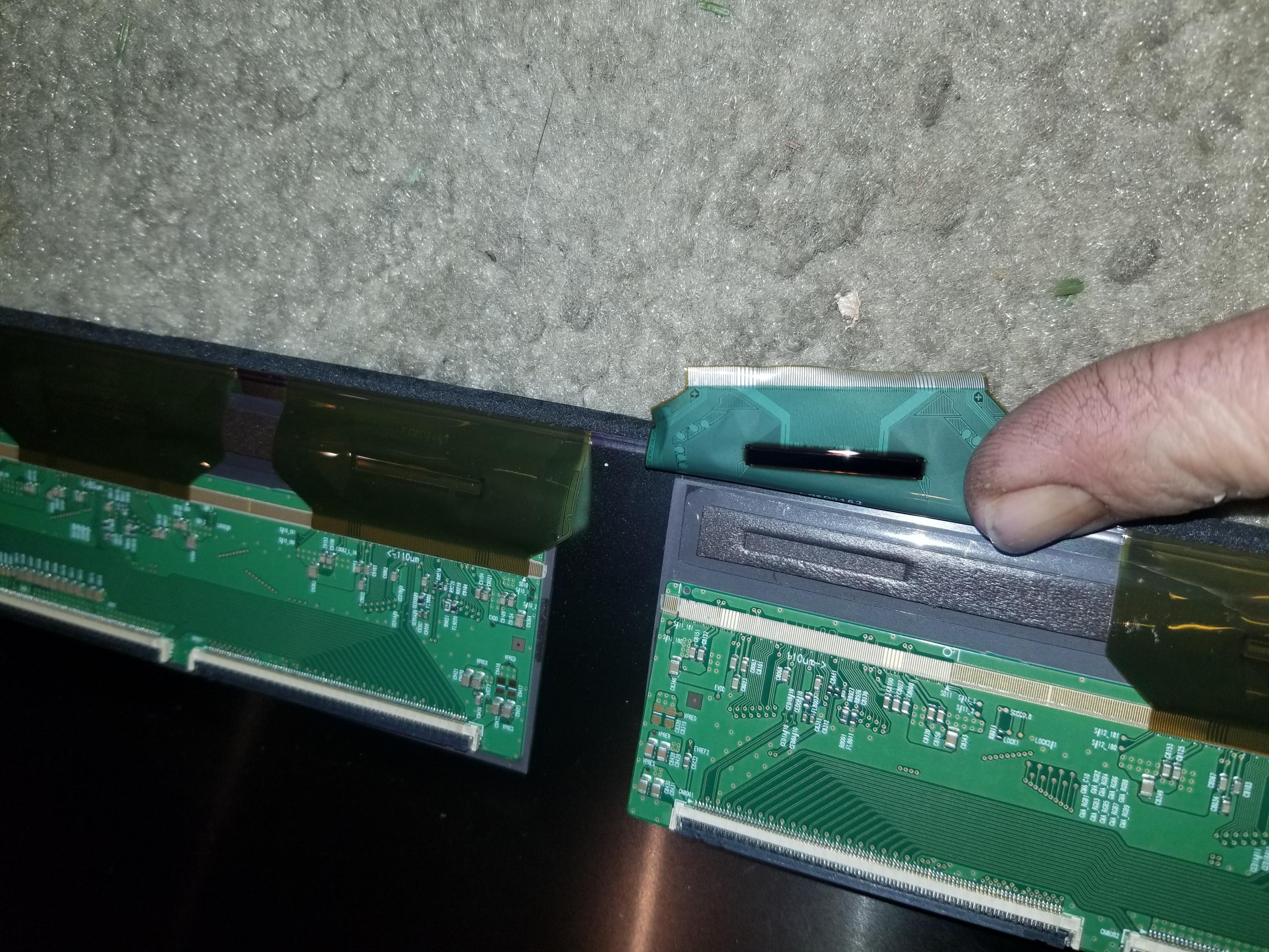

                                  #76
                                  Yes folks, it does have side gate drivers.
                                  • freakaftr8
                                    • Oct 2012
                                    • 3743
                                    #77
                                    And here you have it! A look at the workings of an OLED panel.
                                    Strikingly similar to LCD except the organic compound on the back side of the panel. Mated to the LCD.

                                      #78
                                      The panel is for certain not designed to remove If you have to access the driver boards. It will crack. Believe it or not the whole thing is held in by double sided sticky tape in 8 areas.
                                      I found the LCD layer to be extremely fragile like typical LCD's but the organic LED or OLED layer behind the LCD was super flexible
                                        #79
                                        It's a TFT layer...not quite the same as an LCD.
                                        Interesting that the ELVDD power passes through the source drivers, and disappointing... is that the only supply path for ELVDD? (The 24V supply from the PSU, which supplies the current for the OLED pixels).
                                        Also interesting that the pin-out of the drivers is similar to PDP address drivers, something LG would have had experience with. Unlike normal source drivers, there's a high-power path for OLED current. I was hoping that it would be supplied directly to the panel via a pair of dedicated pads.
