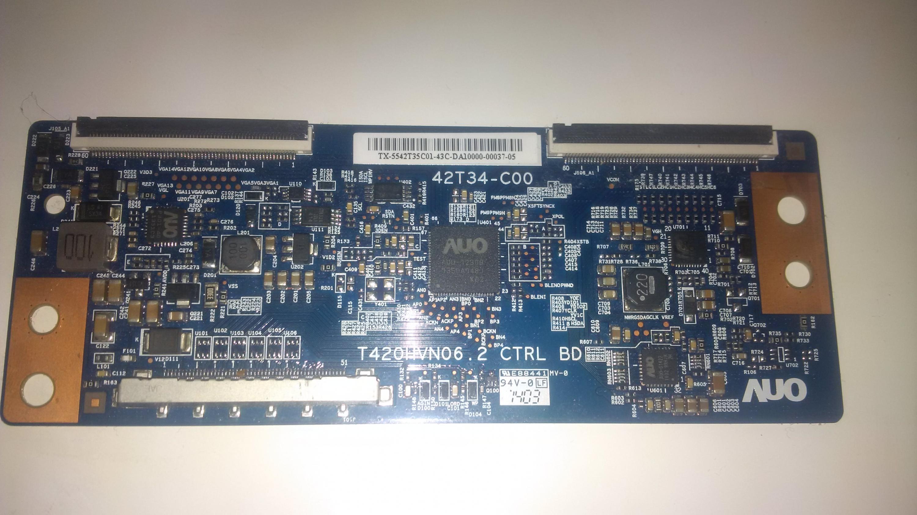

    hello I have problem with my sony bravia.
    when I turn on tv I get backlight ,sound but no picture.
    I changed T-con, on old t-con was burned chip.
    bad panel or mainboard?
  • chrle
    • Sep 2013
    • 158
    • slovakia
    Re: Sony Bravia KDL-42W705B
    disconnected one and another cable from t-con to panel ,still no picture on half side on screen.
    I hear some sound from T-con ,not good to my ears

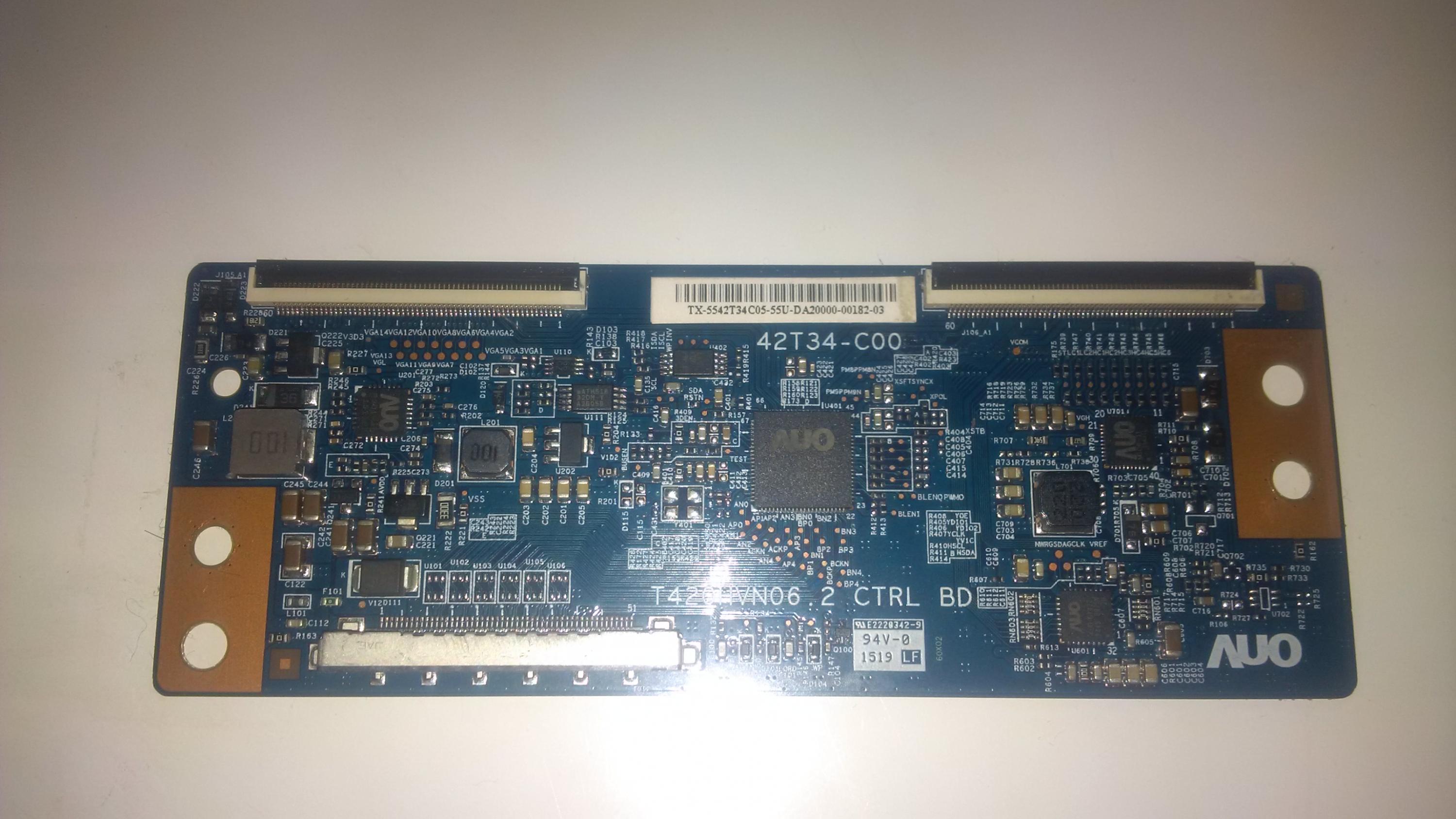

    original t-con burned :TX-5542T35C01-43C T420HNO06.2 BD
    replace with : TX5542T34C05-55U T420HVN06.2 BD
    after replace I got orange/amber flashing light
    updated firmware ,tv turn on but no picture.

      Do you mean you had picture on one side when you disconnected 1 cable from tcon to panel?

        Also please post picture of tcon. Also measure voltage on tcon inductor coils
          no, a dont have picture when disconnect one cable from t-con to panel.
            burned T-con and replacement.
