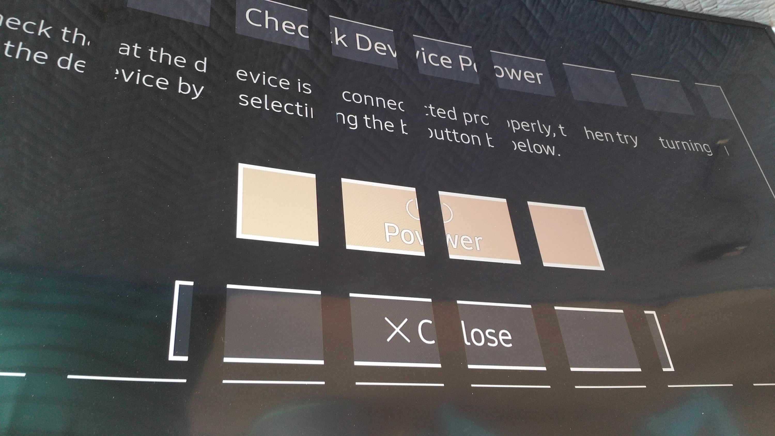

    Got one of those newer concave Sammys...
    It had no power and I determined it was a bad Main Video board..
    Got a replacement Video Board in and the TV did come on and a picture did show up. Which tells me my assessment was accurate.. Yea Me!!
    Unfortunately, there is a new problem..
    Dark vertical bands...
    I am hoping I just got a bum Video Board, because the only alternative I can see is a bad board where the tab bonds are secured to the display panel.. There is no TCON....
    Can anyone confirm one way or the other??
    Re: Samsung UN55KU6500 Concave Dark Vertical Bands..
    since the missing lines cover the whole screen and are evenly spaced, i would say that your replacement main has issues. you could reseat the lvds, but i don't think that will have any effect.

      Yea, I cleaned and re-seated the LVDS..
      Good to hear it's likely a Main Board issue.. Have a replacement board en route..
