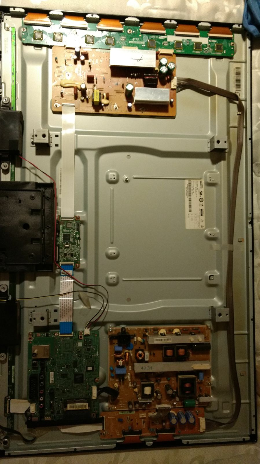

    I just got a Samsung PS43E450 from a friend for doing a favour for him.
    It was dead, with no picture. Vs and Va present, but shut down shortly after and control board goes into protect mode (5-2 blink)
    Scoping the Y-main waveform revealed the set was shutting down after the first sustain field. The Y-main waveform was distorted badly, there was no Vs portion and only the negative part was present. The X-main waveform, for the few cycles the set was active for, appeared OK.

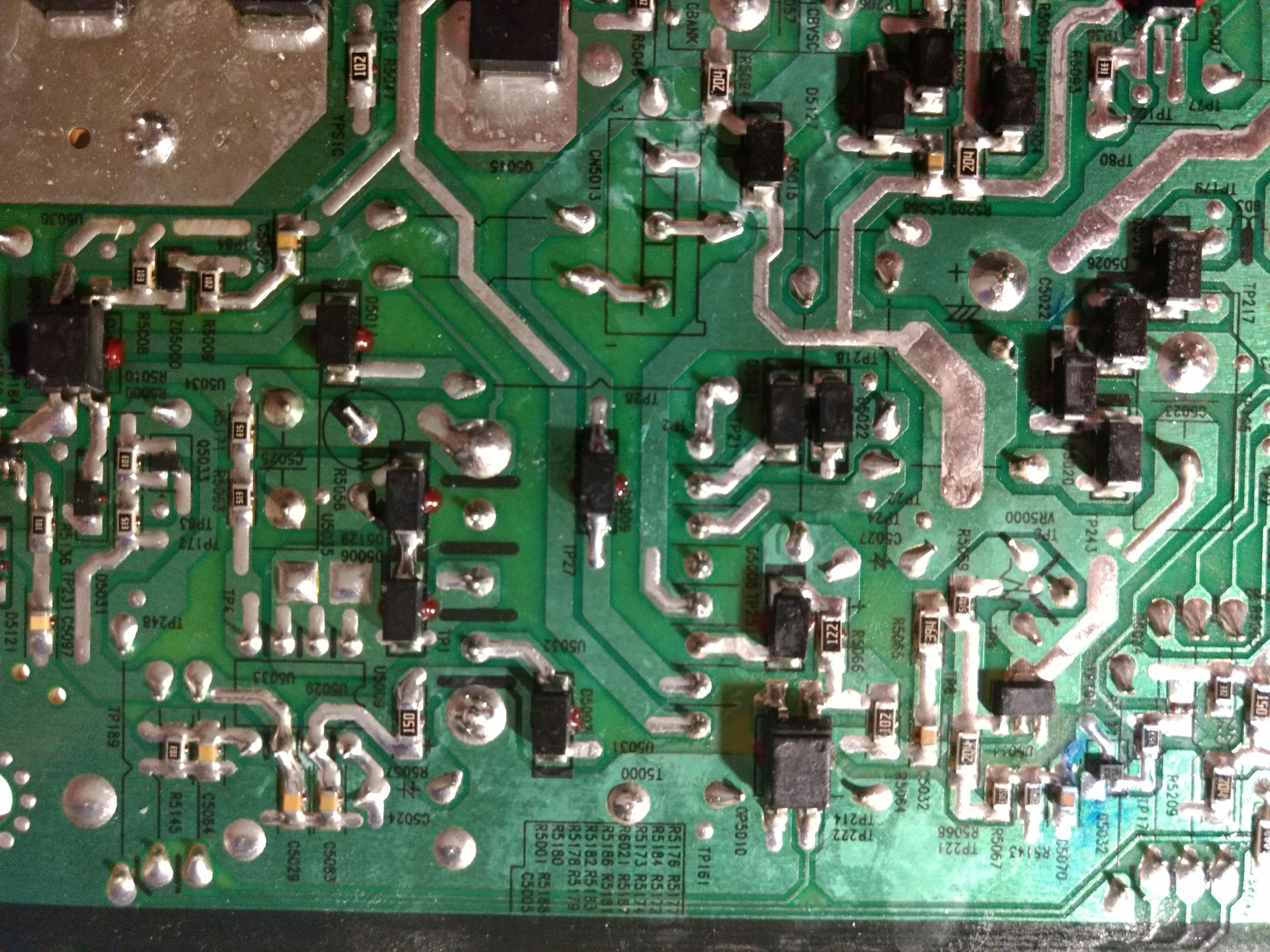

    I found that the 15V_F supply, which sits on top of the Y-main output (VFG in Panasonic terms, YOUT in Samsung terms) had a 5 ohm short to ground. I was able to locate this supply as it is visible as a tap coming off the main switching transformer on the board. (This transformer is responsible for 15V_F, another 15V rail, Vscan, Vsch and Ve. I would not want to be the engineer who designed that, balancing those loads must have been a bitch!) Without the 15V_F supply, no high-voltage output can be properly generated. This includes the Y-ramp (Yrr, Yfr) and Ys parts of the waveform. It will also cause a shutdown because the ERC path voltage will drop below a threshold (same cause as Panasonic SOS6, though the mechanism on a Samsung set is not well understood for me).

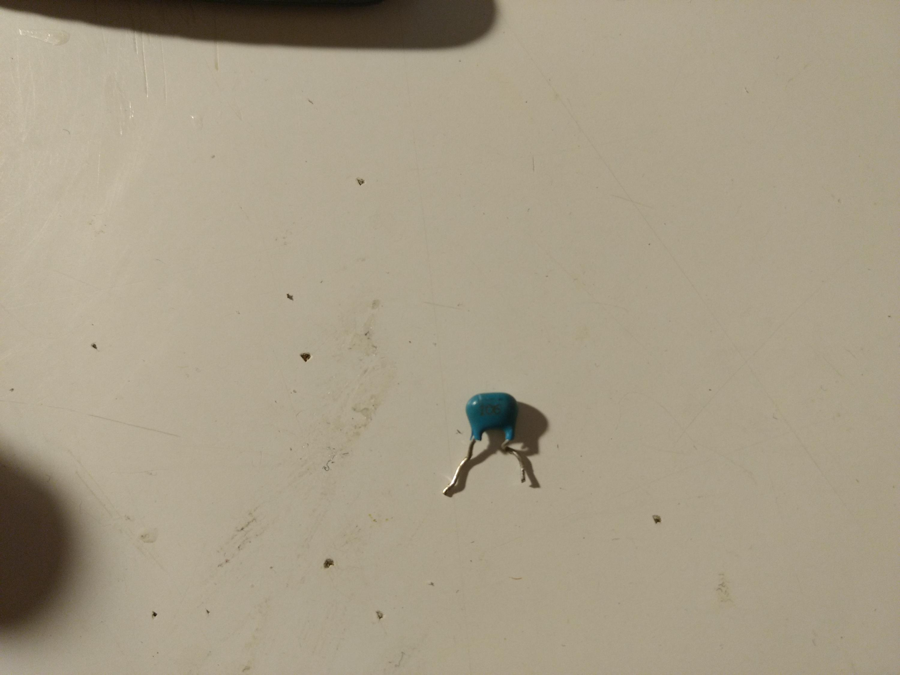

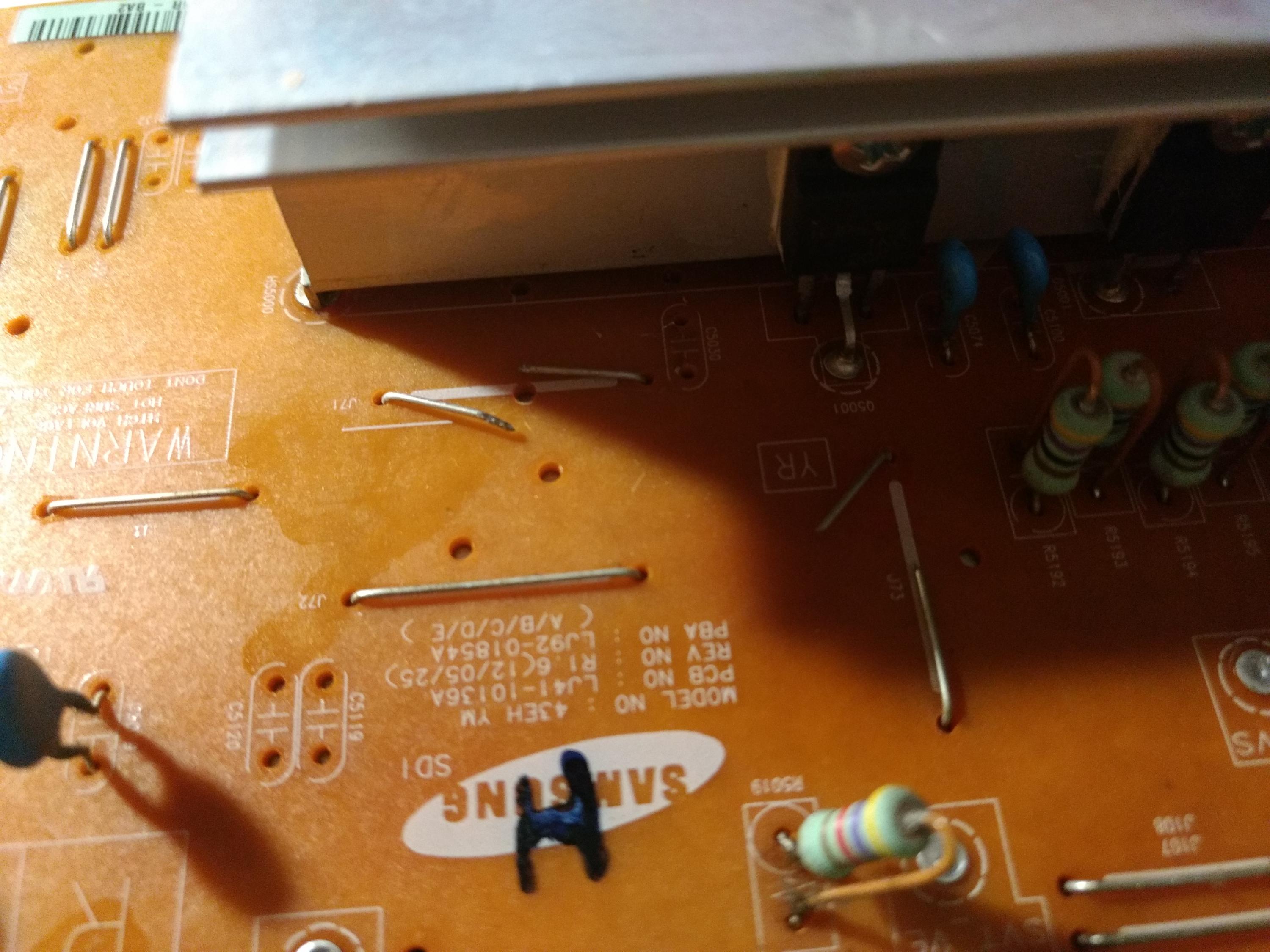

    The board makes it easy to cut jumpers to isolate different sections - a nice design, although I suspect this is not deliberate but a function of the 1-layer layout. In any case, by cutting jumpers, I was able to locate the short to the section of the board that drives the YS switch for bringing the Y-main output to Vs. I thought that the driver might be bad, but each driver is fed via a 15 ohm resistor. So a 5 ohm short would not be possible, it would have to be at least 15 ohms (I checked the resistor to make sure, and indeed there was 5 ohms to YOUT on one end, and 20 ohms to VFG on the other end, a sure indicator that the short is on the 5 ohm end.) I checked an SMD ceramic and it was OK. The only thing left was a small ceramic through hole cap, value 1uF (code 105) and position C5030. Sure enough when I removed it the short went. And the cap tested 5 ohm shorted.

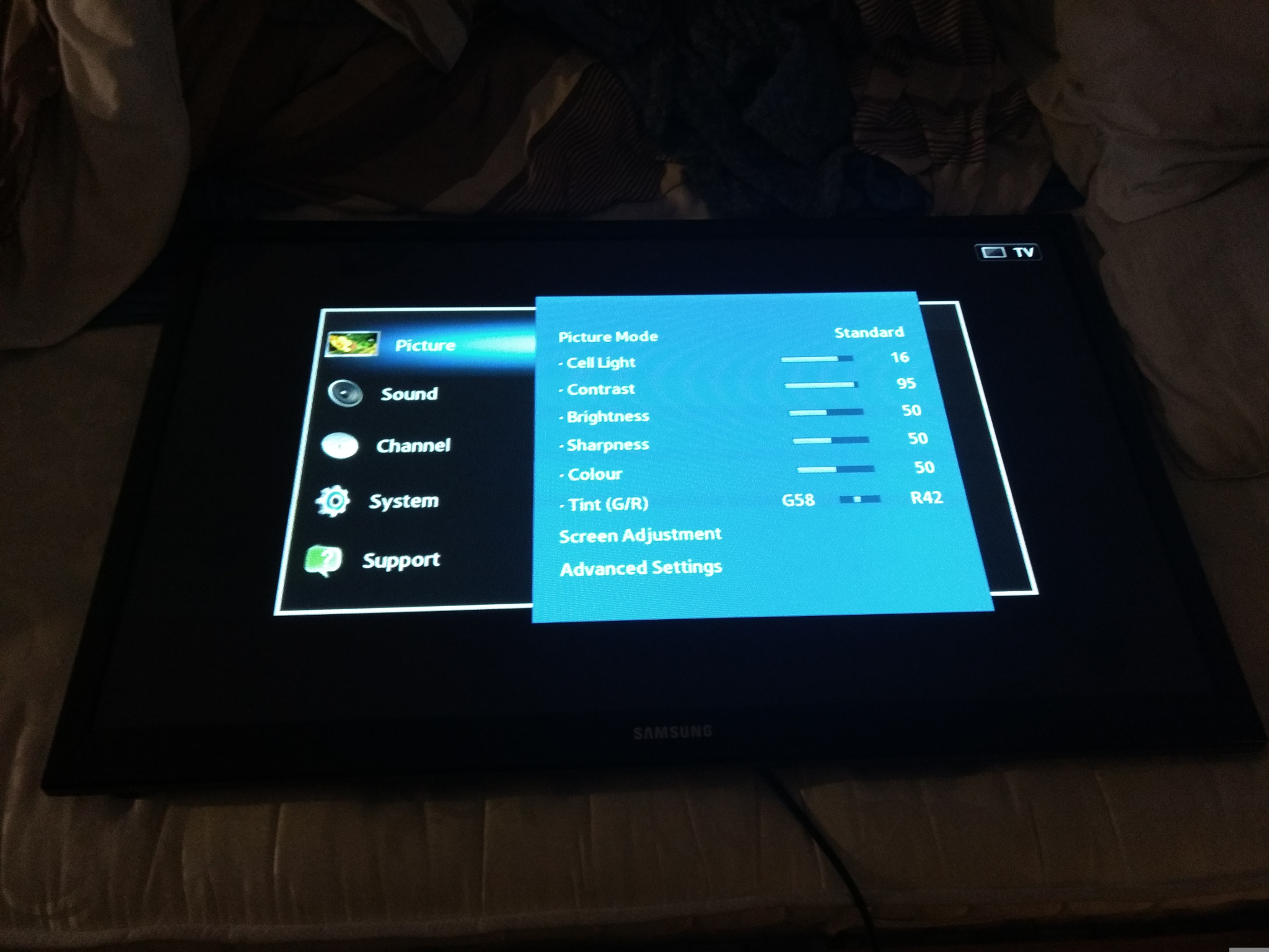

    After removing the cap and replacing it with a SMD ceramic equivalent, the TV works now. Although there is a little maldischarge on some pixels in shaded areas, though it is quite minor. I will check the Vscan voltage later in hopes of fixing this as well.
