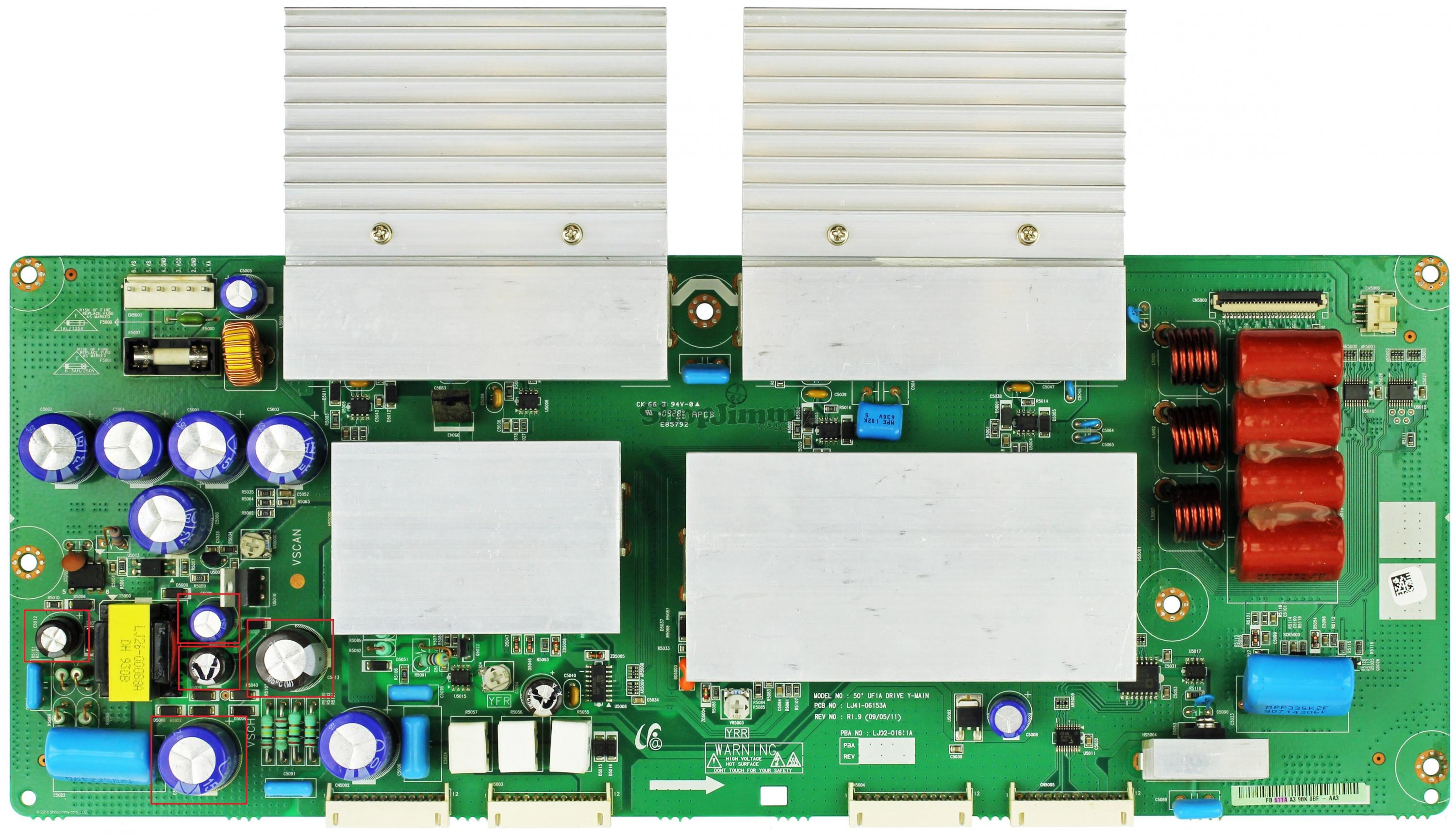

    Boards could have the same failure, though - especially if they are used. It's hard to tell w/out a scope, unfortunately
    Man... so do you think a recap on the PS board would be a fool's errand?
      Re: Samsung PN50B650 plasma dark picture (better than what I started with)
      Unlikely to resolve this particular issue but may be worth looking at a few caps on the Y-main.
        Was gonna put in a Mouser order anyhow, point out the Y board caps you think might be the issue? Not gonna be mad if it doesn't fix the issue, appreciate all the help, just grasping at straws because I don't want to just chuck out a good 50" 1080p plasma panel.
        http://assets.shopjimmy.com/media/ca...744a-top_3.jpg
        Power input is top left.

          Unfortunately ShopJimmy restricts UK IP addresses from accessing their site (due to some long-standing fraud problem). Could you upload the image here, or to an image-sharing site like Imgur?
            https://imgur.com/4AP2Jdr
            Thanks again.
              I would suggest replacing the highlighted capacitors...
              However I cannot be sure if this is the fault on this particular set.
                You're a prince among men, at least this is something I can try.
