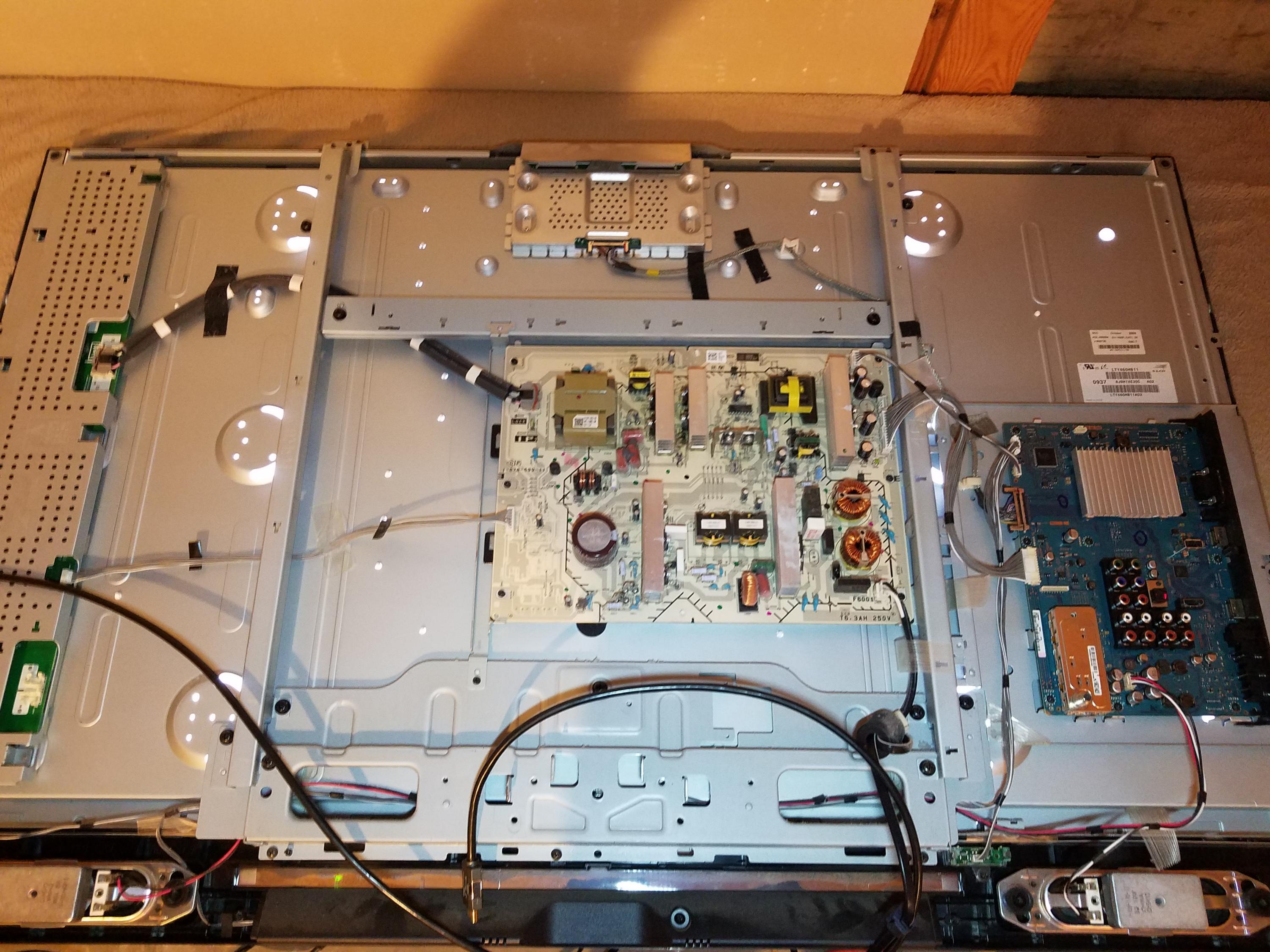

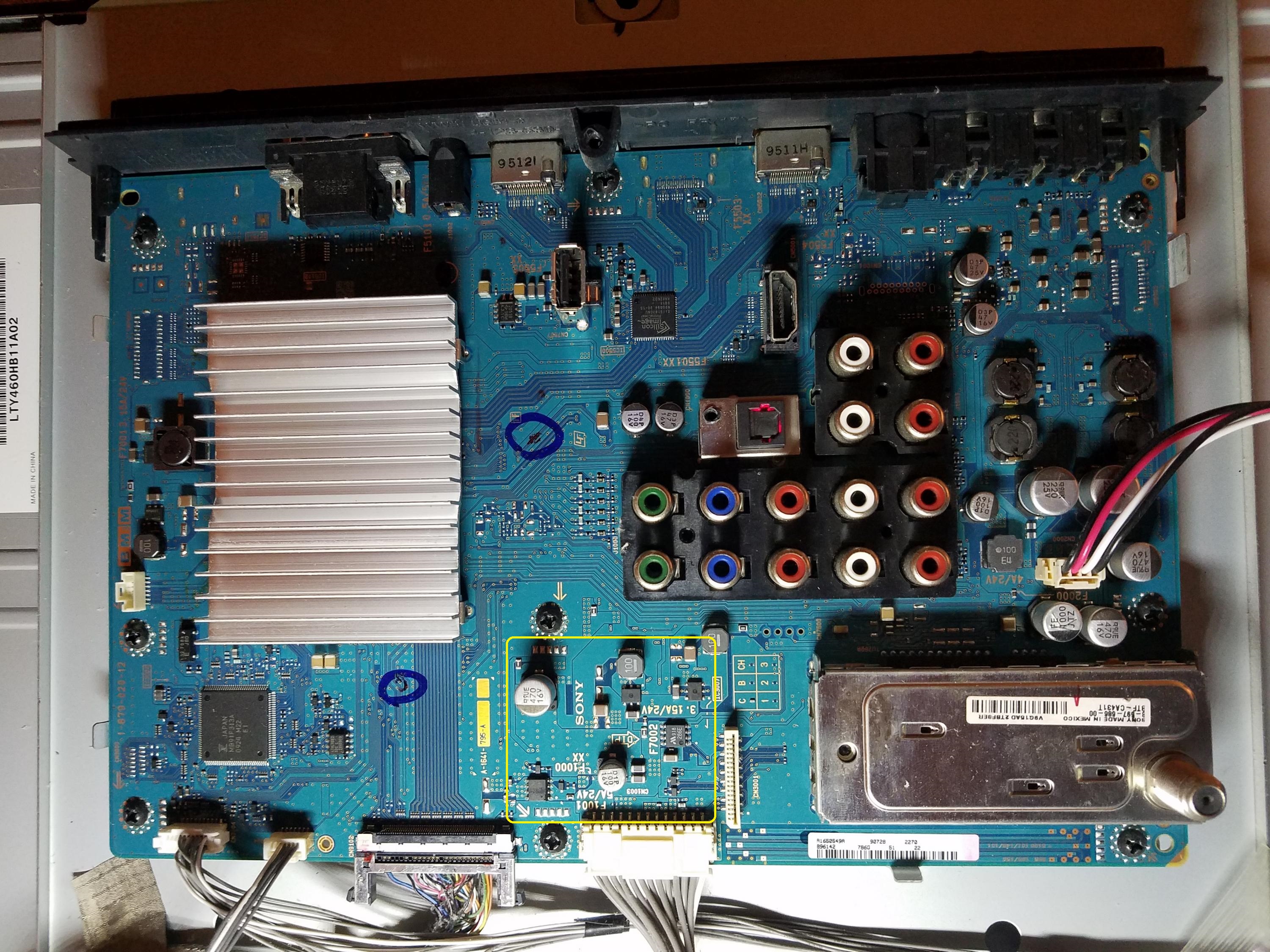

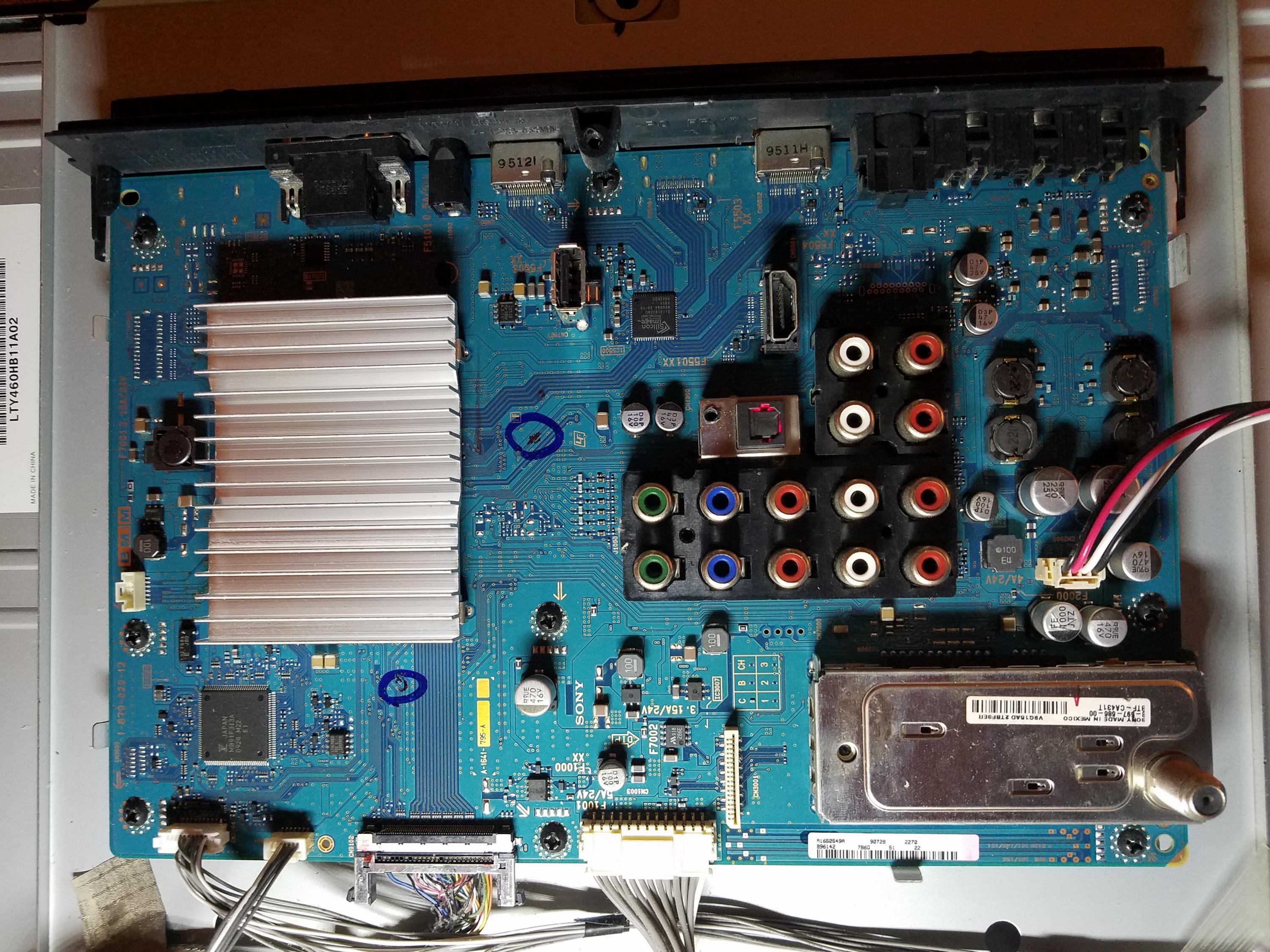

    I have a Sony TV that when I turn it on the backlighting comes on and the green power LED comes on however I have no picture or no sound as I cycle through inputs. Any ideas on where I should start?

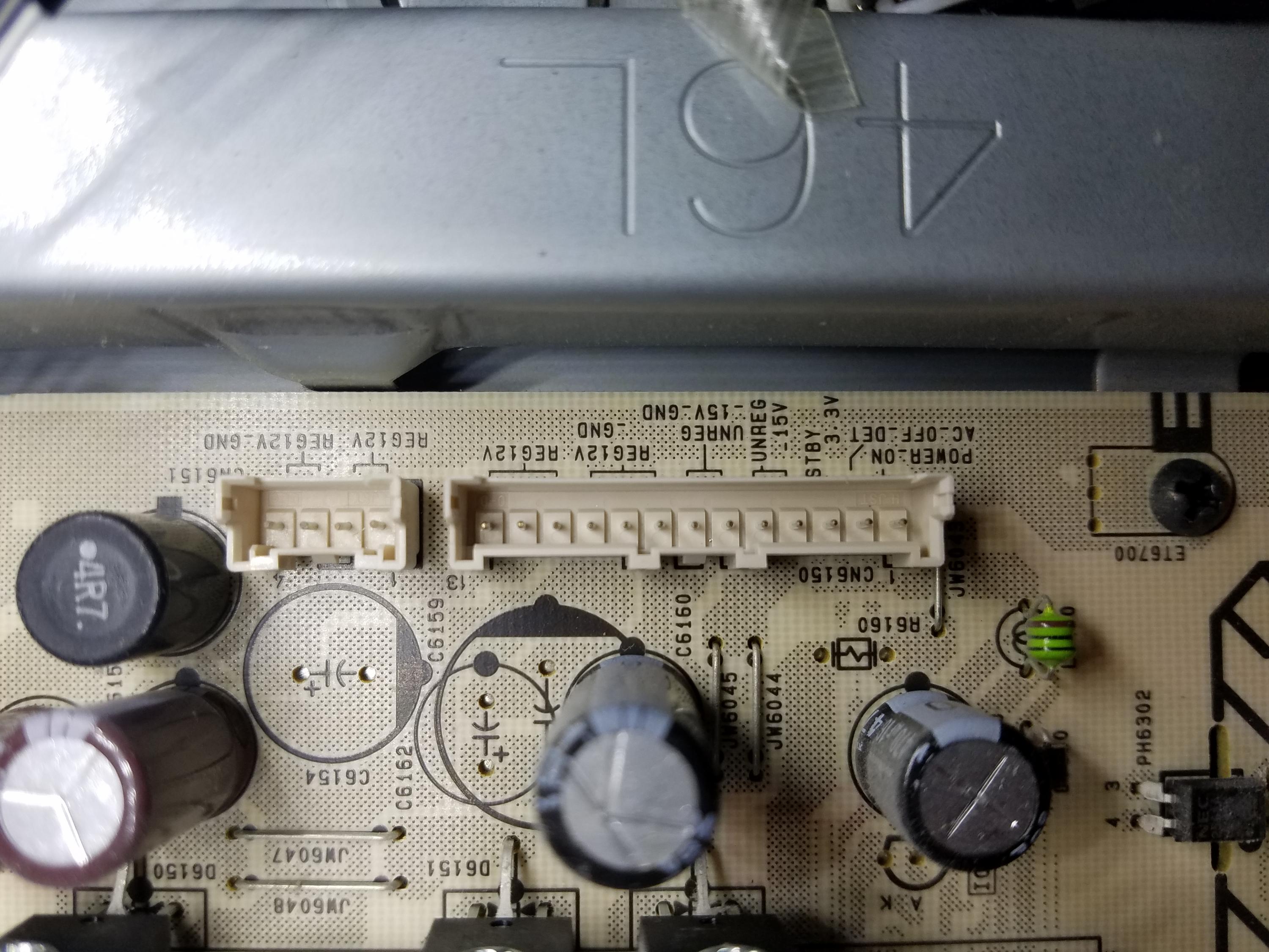

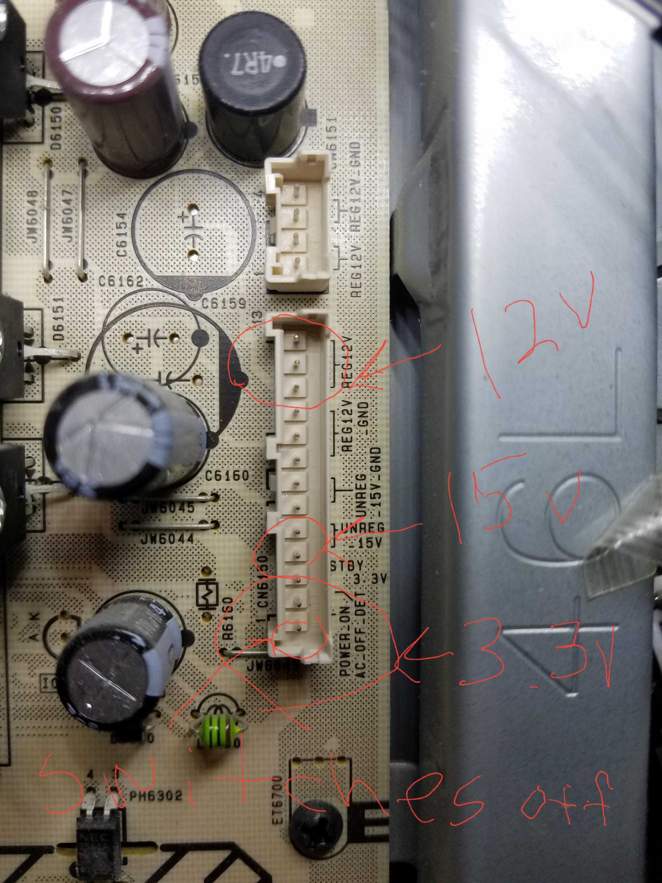

    Here is the voltages on that plug

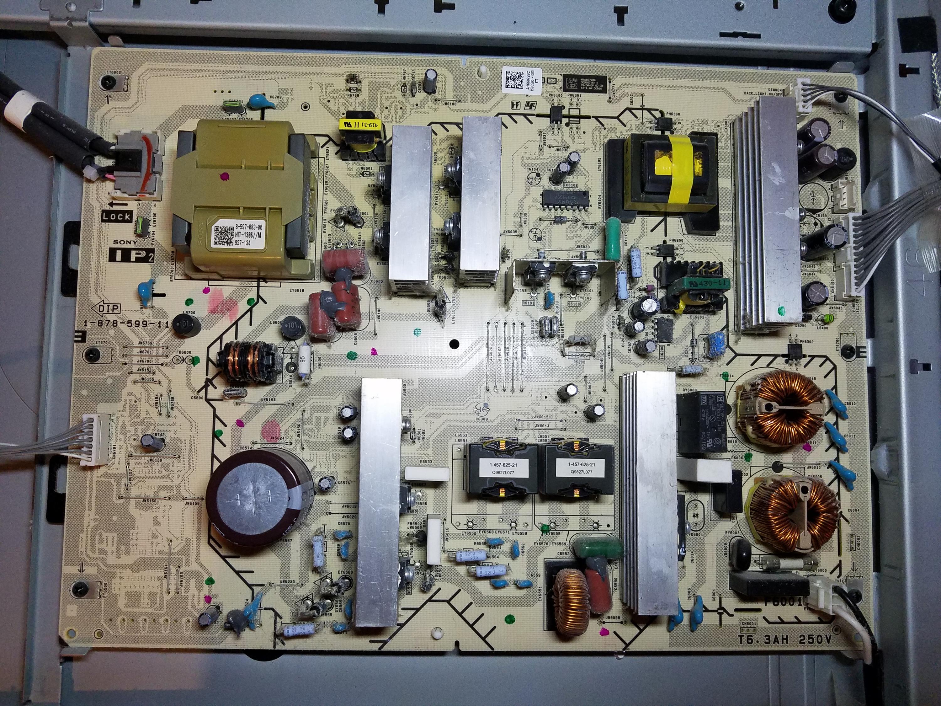

      Locate the surface mount fuses marked on the mainboard and check they are not open circuited.

        Are those the actual voltages you measured and recorded off the board??
