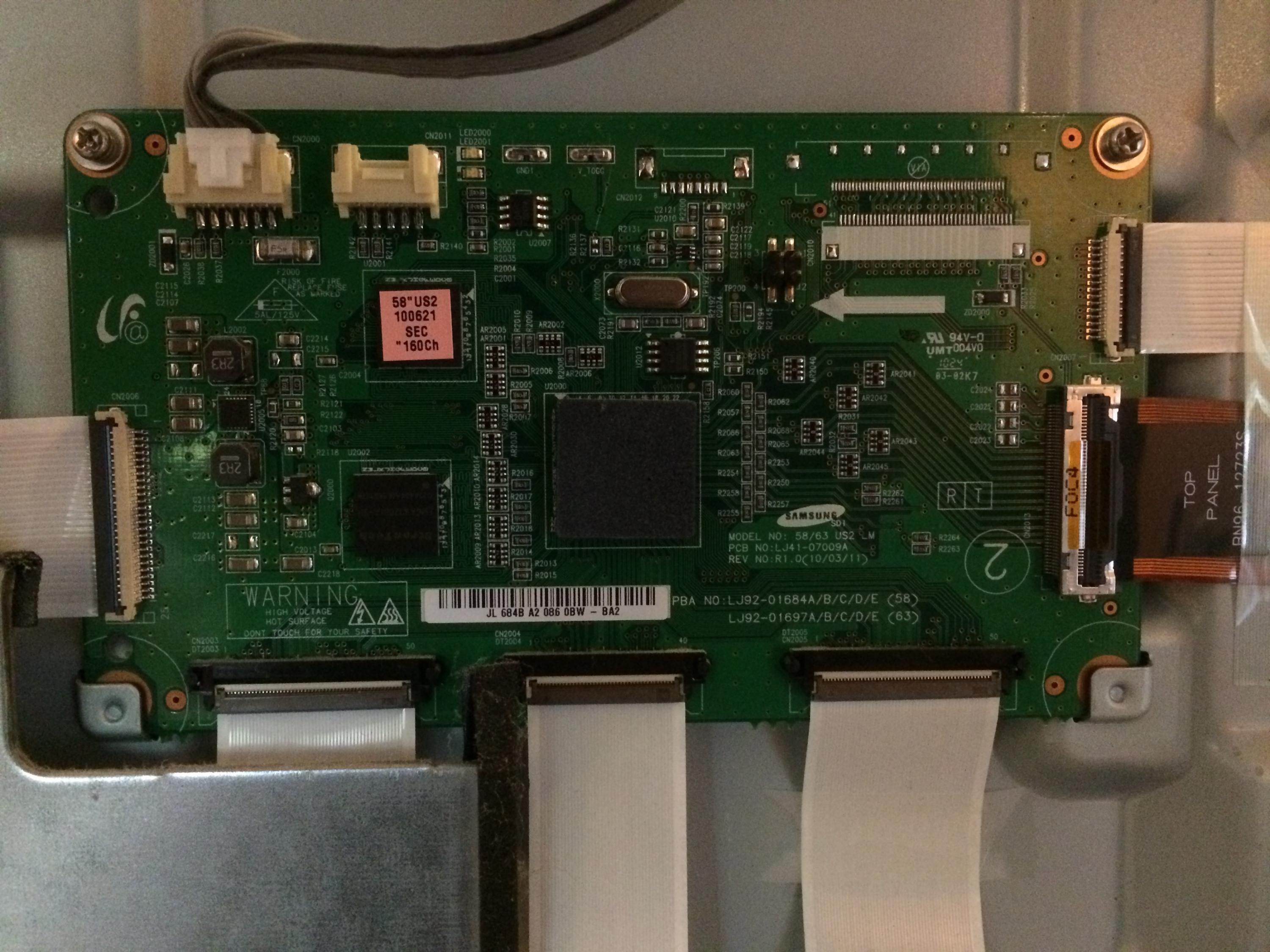

      Remove the connector from the mainboard to the logic control board and use a small "roach" clip to short pins 3 &4 on control board. If you see nice clear test screens the mainboard is bad.
      • tee el cee
        • Nov 2017
        • 11
        Re: Samsung Plasma (PN58C8000) won't power up.
        In this configuration, I got no LOGIC board LED, no chunks, and nothing on the screen. I measured standby and ps_on at 5.2 and 2.8.
        I also tried this configuration AND shorting ps_on to ground using the MAIN side of the cable as suggested by the fast track linked above. I got the chunks, the slow flashing LOGIC board LED, and nothing on the screen. Standby and ps_on measured 5.2 and -3.2.
        EDIT: Then I additionally disconnected the LVDS from LOGIC to MAIN. (Saw it on a youtube vid.) Same result.

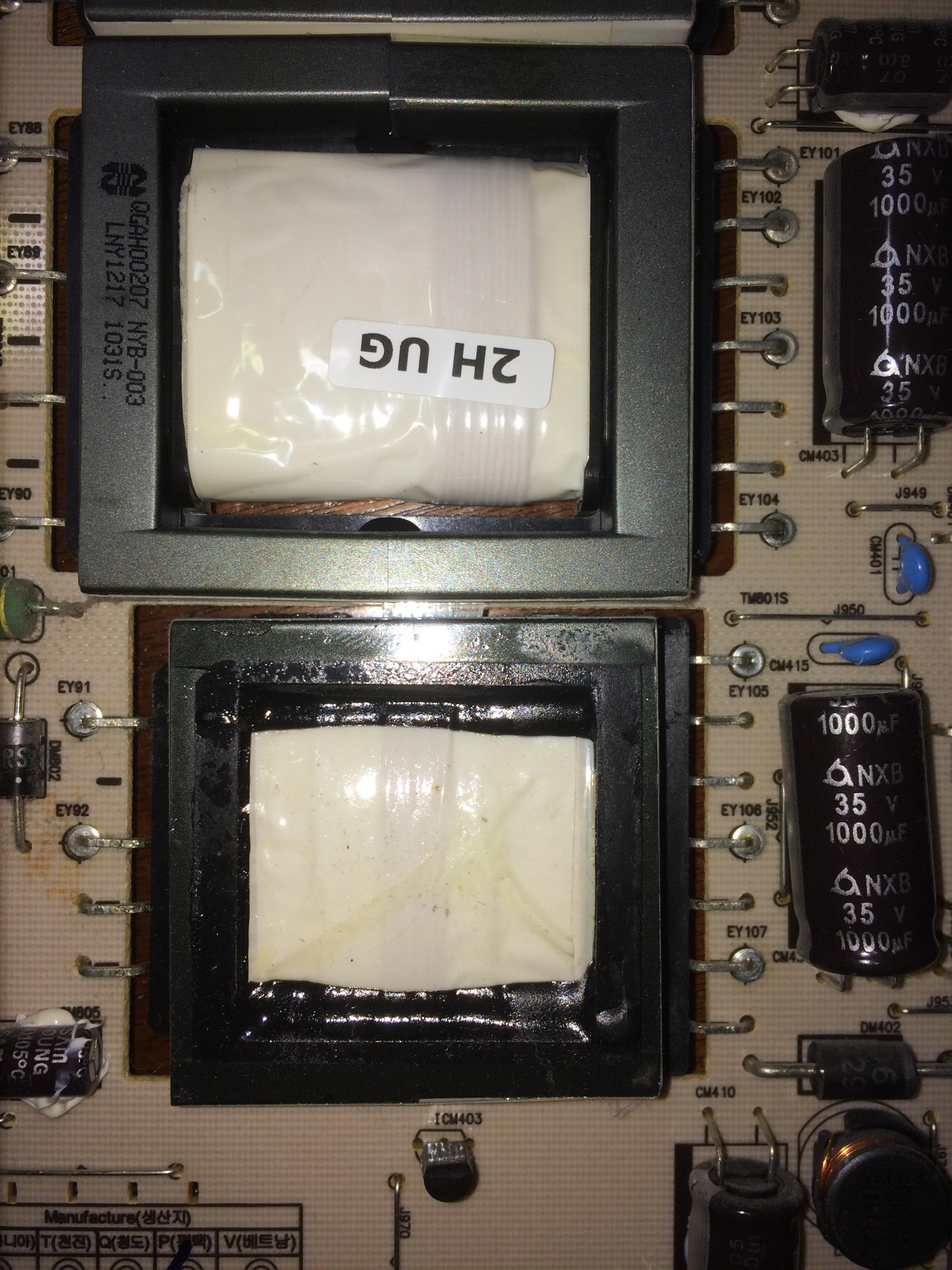

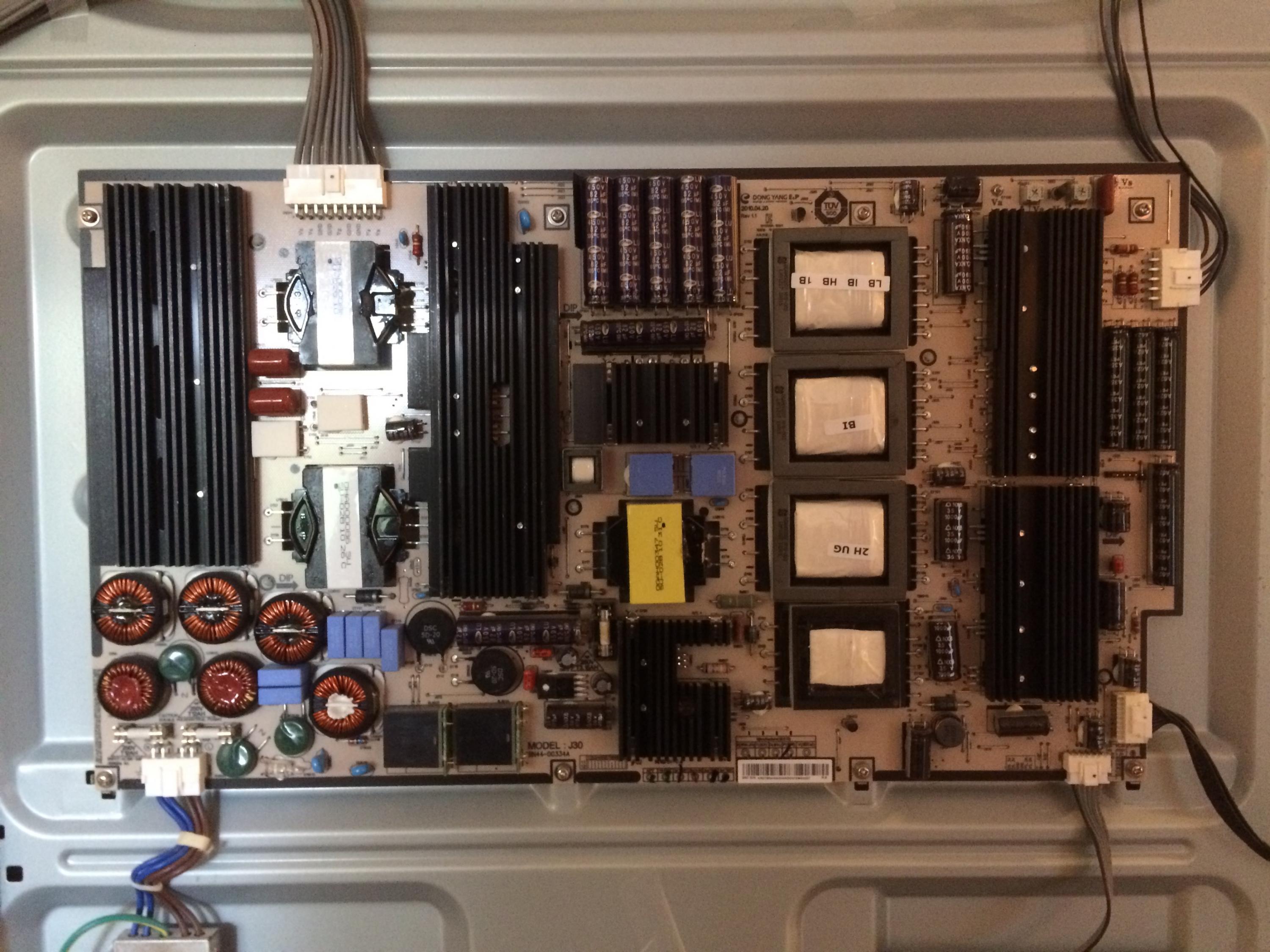

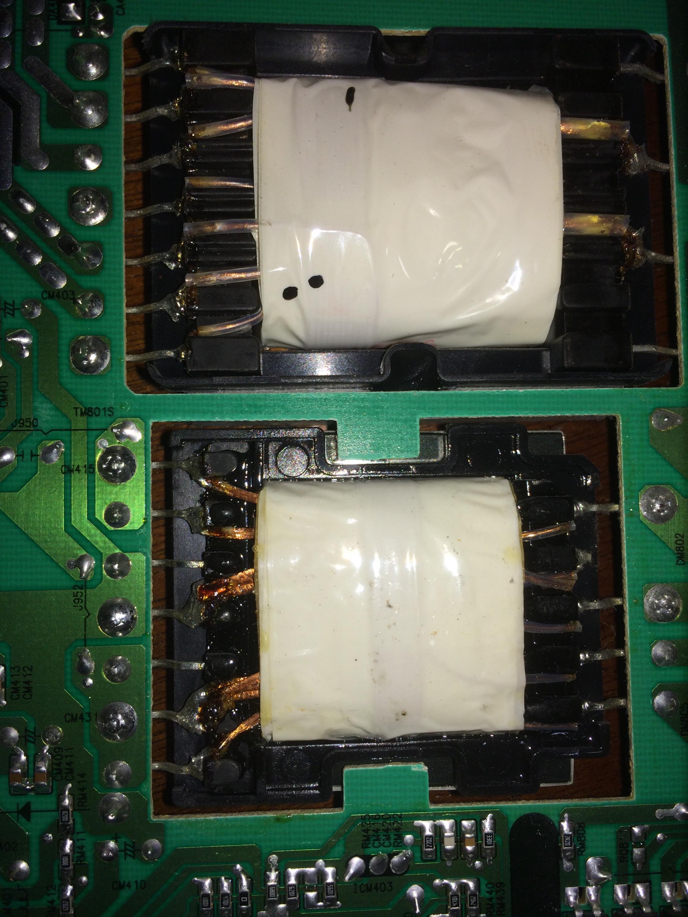

            I think I found it. I pulled the power board to look at the back and it looks like one of the transformers (?) has been hot. If you zoom in, you can see that the plastic coating on the leads have been melted off on one side.
            Then I flipped it back over and noticed that there are brown marks on nearby. At first I thought that the transformer had melted off a pretty "rim cover" (?) that the others had. But pics of new boards don't have that either.

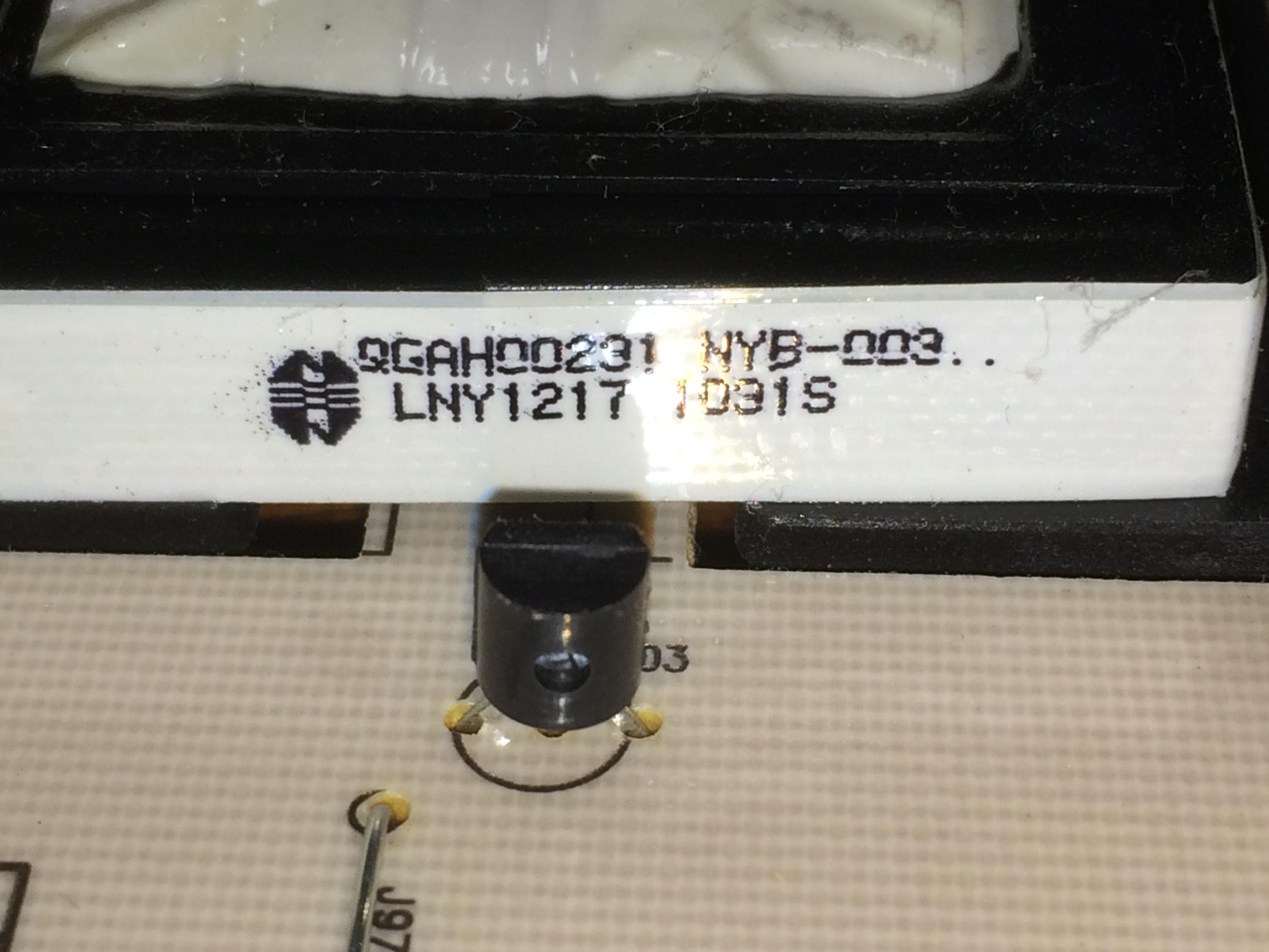

            I haven't any luck finding the part number (QGAH00231). I'd probably buy the board anyway. Does this look like my problem and match my other symptoms? I saw 125 volts on one of the pins earlier, which I think is a sign of a transformer short.
            Anyone want to recommend a place to buy the board? Samsungparts.com has it for $200. It's on ebay for $83...
            Thanks!

                Did you find the logic board test pins? On your pic there is a white arrow pointing to the pins. You get nothing from removing the ldvs cable and shorting out pins 3&4?
                • tee el cee
                  • Nov 2017
                  • 11
                  Black screen. Slow blinking LOGIC LED.

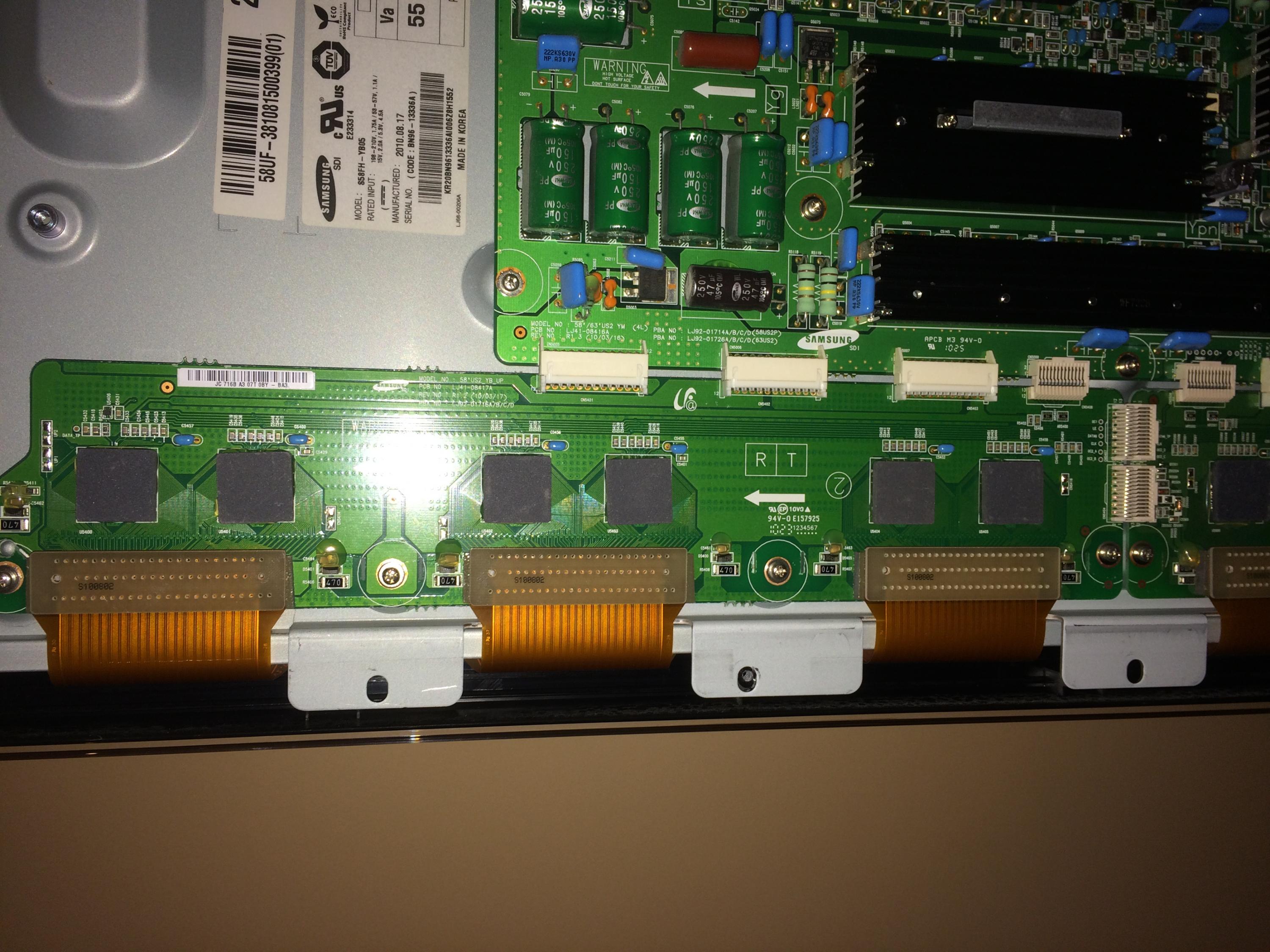

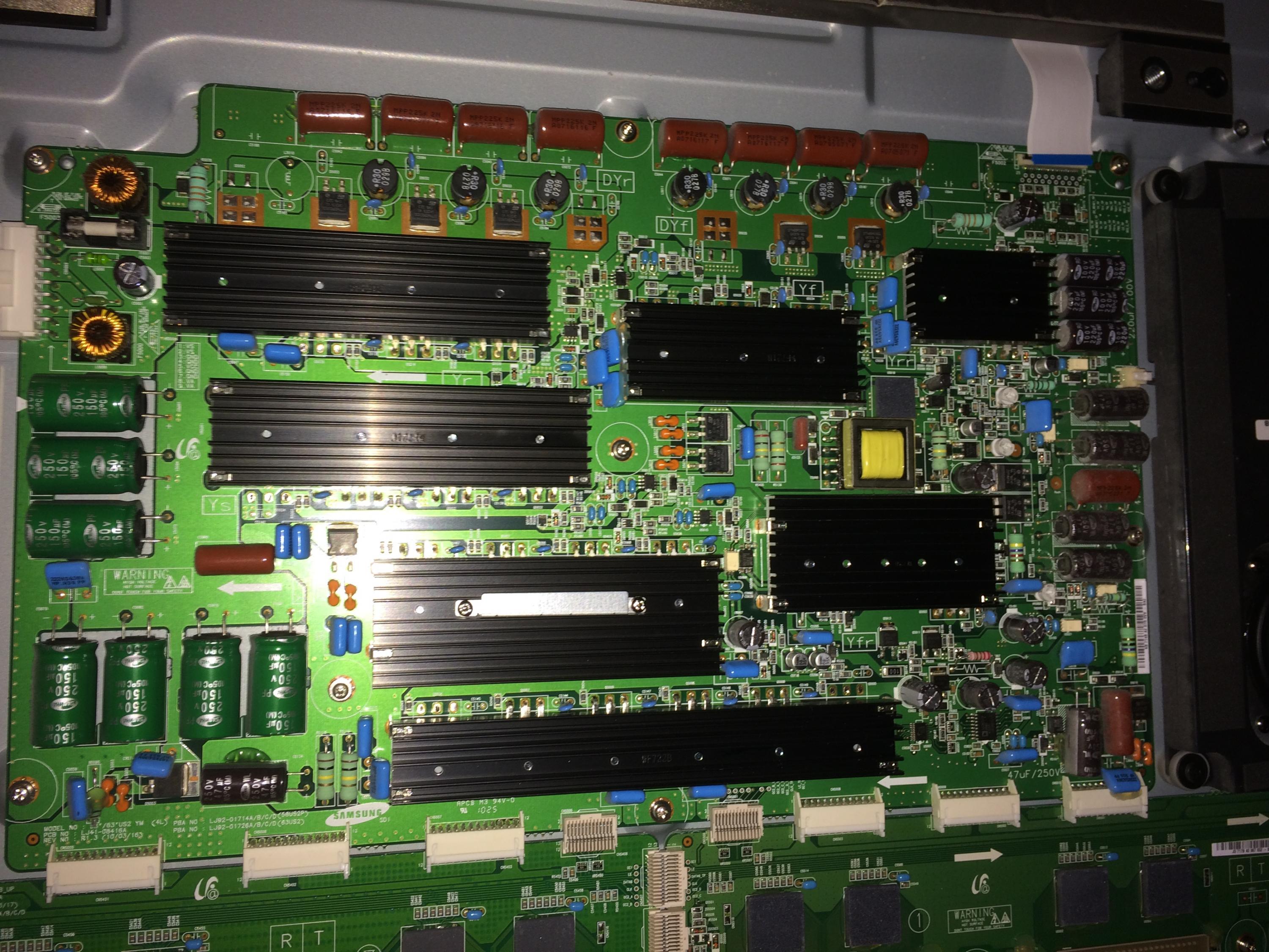

                    A step forward!
                    Based on a tip here: https://www.badcaps.net/forum/showpo...9&postcount=61
                    I tried disconnecting the flat cables to X-Main and Y-main. When Y-Main is disconnected, the LED blinks fast instead of slow! I think this means I've narrowed it to the Y- boards. (Or the LOGIC board?)
                    Also, Vs, Va, Vsc, Ve are all good. VS_on is 3.2 and PS_ON is still high at 124v.
                    This tech bulletin describes checking for shorts around OUT_H and OUT_L. But I can't find my OUT_H and OUT_L. Can you?
                    Can anyone help me move forward?
