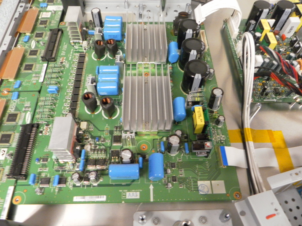

    Dell W5001c sound no video
    I am pretty sure I have found the problem. At least one bad capacitor on the Y main. The problem is I can not get the board off of the TV. The thermal pad below the large heatsink's are holding it down and I do not want to break the board removing it. I was hoping someone in the group has a tip on how to remove it or break it free.
  • nwcs
    • Dec 2015
    • 311
    • usa
    Re: Dell W5001c sound no video
    Never mind I figured it out. Took the two buffer boards on then twisted the y main until it broke free.
