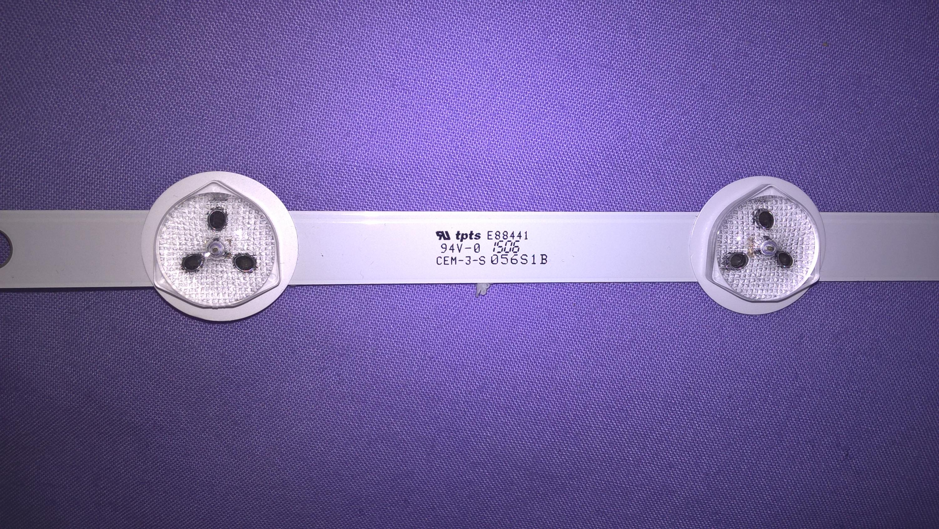

      There are four strips in this TV here are the part numbers
      Two strips have 94v-0 1222 32" ROW Rev0.9 2 A-TYPE 6916L-0881A
      Two strips have 94V-0 1222 32" ROW Rev0.9 2 B-TYPE 6916L-0923A
      They are all 25 and a half inch in length.

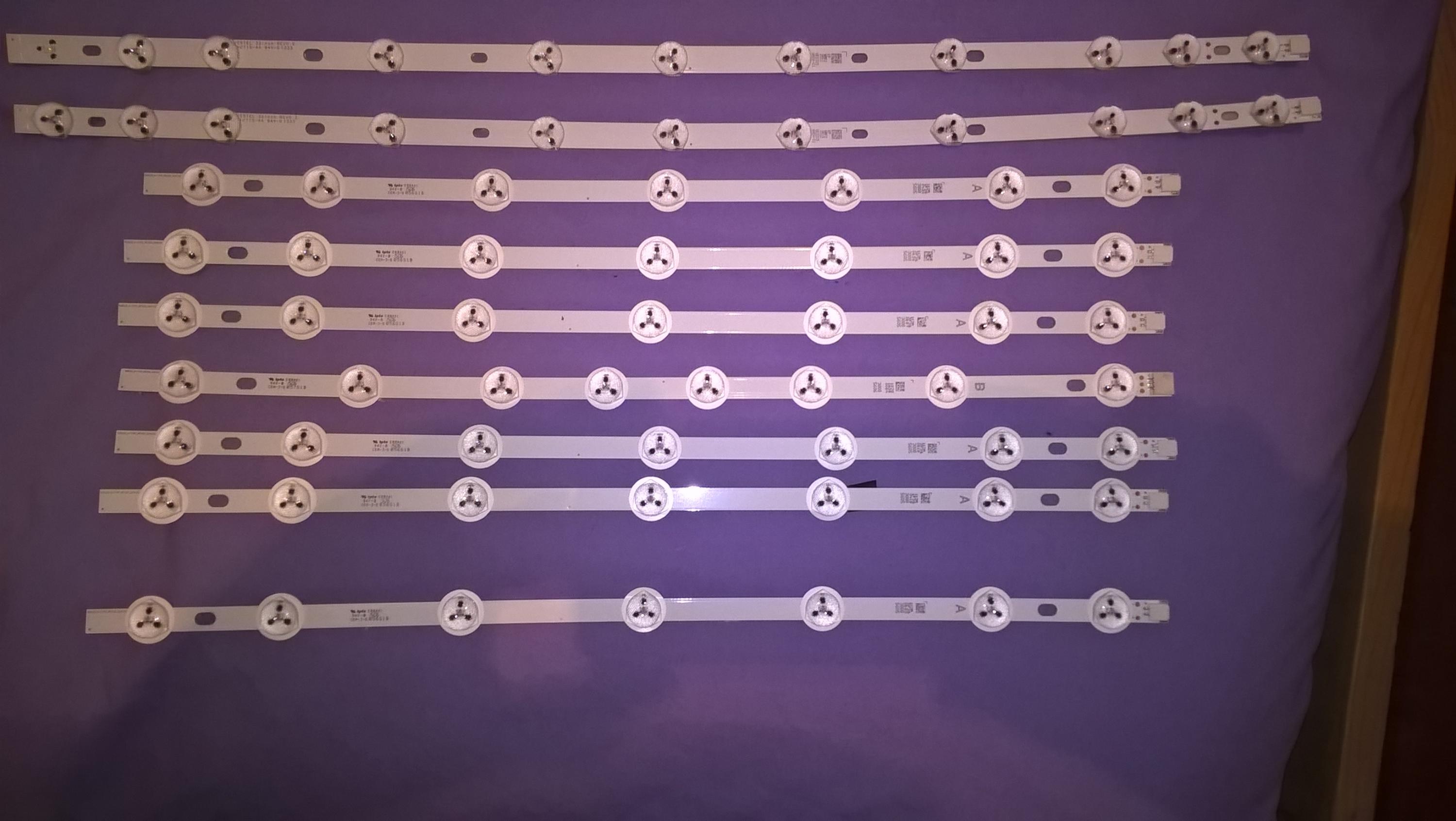

                          i I have just had a look through the strips i have salvaged none of these match yours sorry

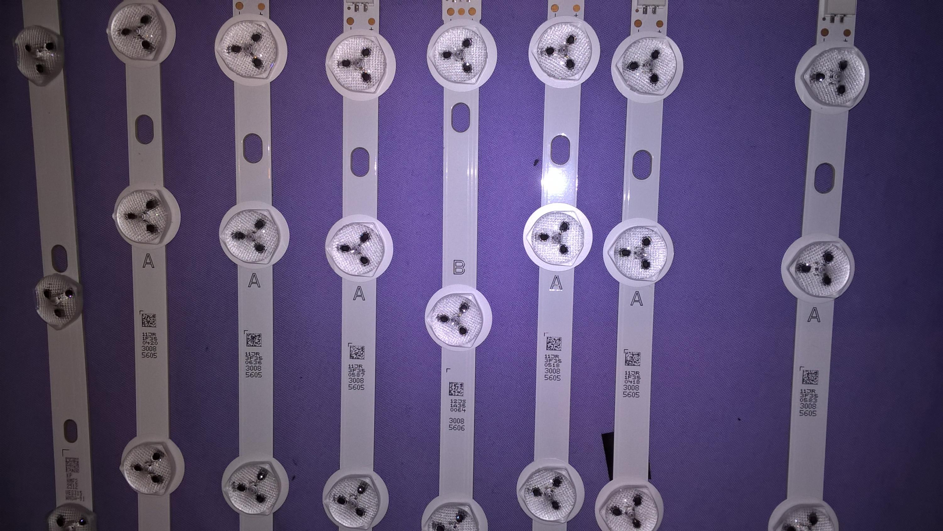

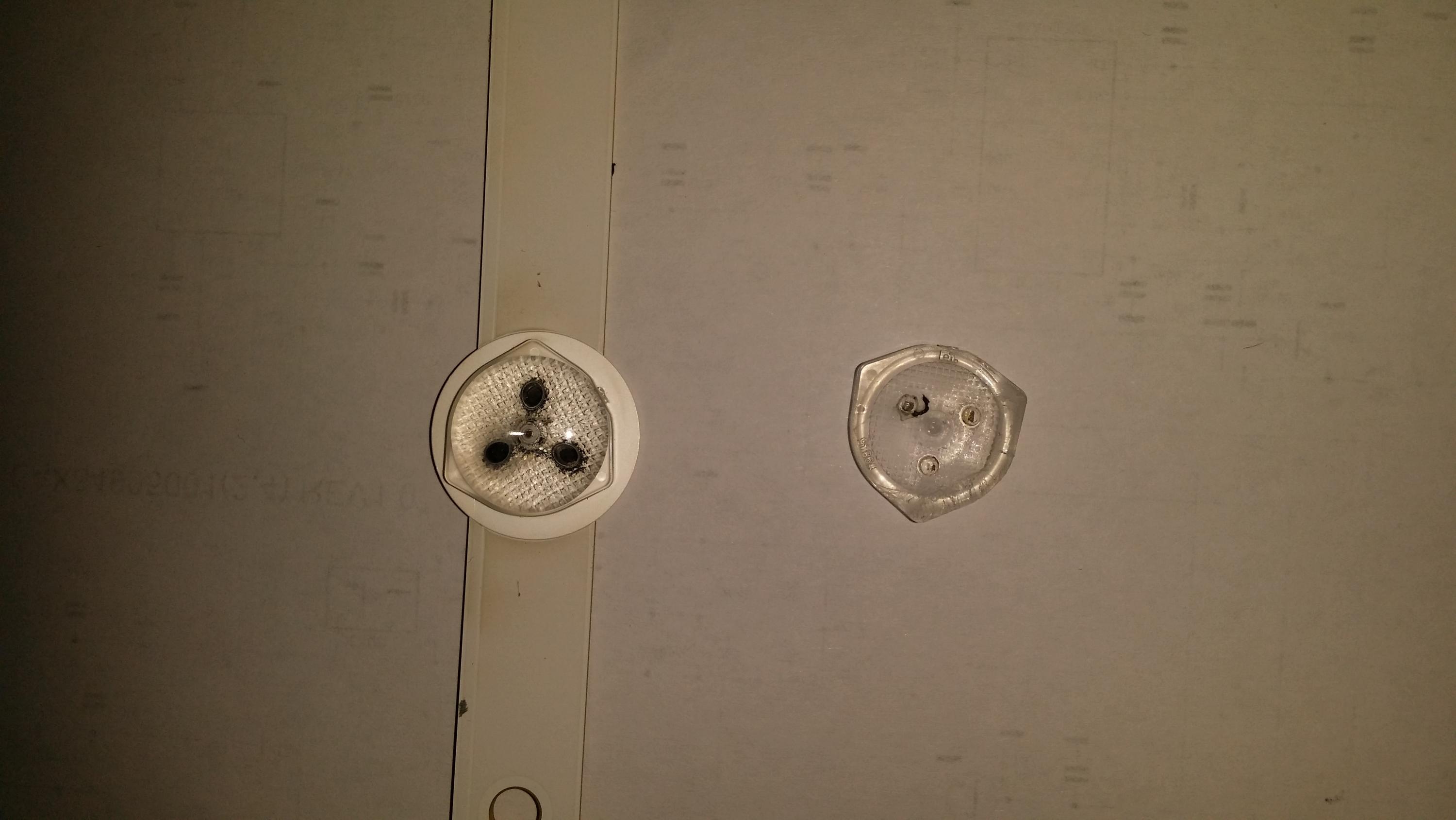

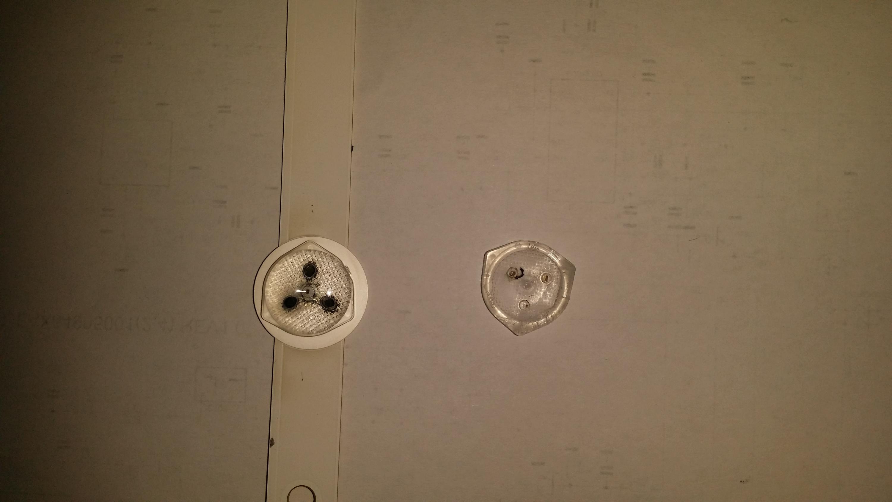

                              i have not used proman myself, but have messaged him for advice before hes always helpful i personally would still replace all the leds in one go i know its time consuming but hey once done the set will last as no doubt one of the old leds will fail shortly anyway, have you got a good picture of the lenses your set is using
                                #55
                                Re: Digihome 32DLed906
                                I think
                                Your right Vince I will change them all.
                                Here is a couple of pictures let me know if not clear enough.
                                  #56
                                  i did see some loose lenses in my box of odd bits in my shed earlier i will have a look in the morning whats in there, how many have broke so far?
                                    #57
                                    About four or five maybe but I have not stripped all off yet I was going to wait until the new LED's arrive and then I was going to do one at a time so not to mix them up so if I take one off change the LED then glue the lense straight back on the same way it came off.
                                    I know this will be a very slow process but I stand a better chance of getting it right !
