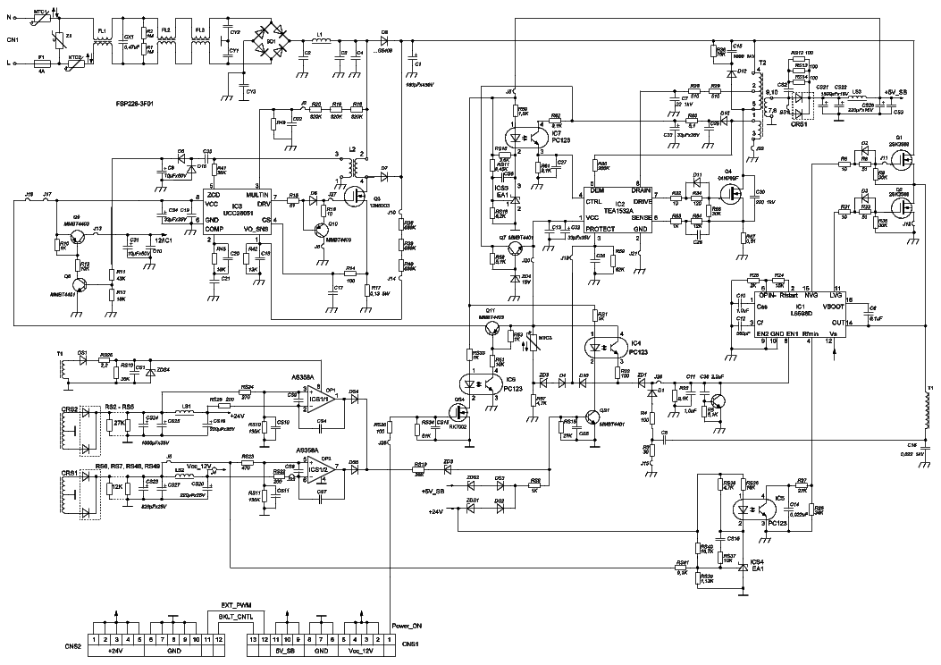

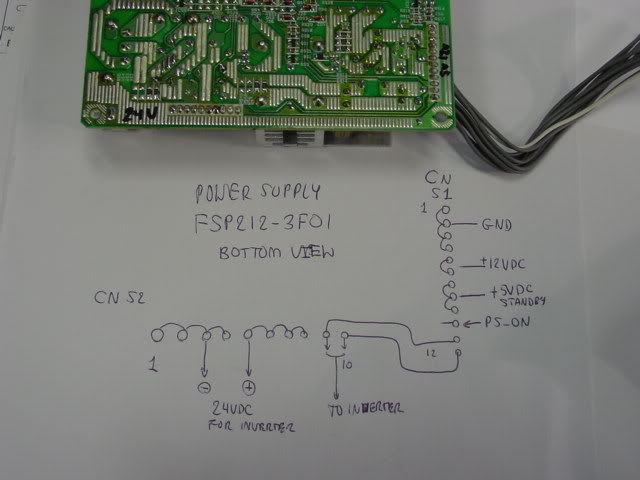

Transformation PSU FSP228-3F01 into FSP212-3F01
  • Xardas
    • Sep 2017
    • 4
    • Polska
    Hi, I would like to transform FSP228-3F01 to work like FSP212-3F01. I found schematic for *228* and found some handmade drawing for *212* by budm(?) I have no skills and no gear to repairing my (no st/by) *212* and I found cheap *228* PSU. So I decided to do some transformation with wires. Could you tell me does it gonna work? Those schematic are good?
