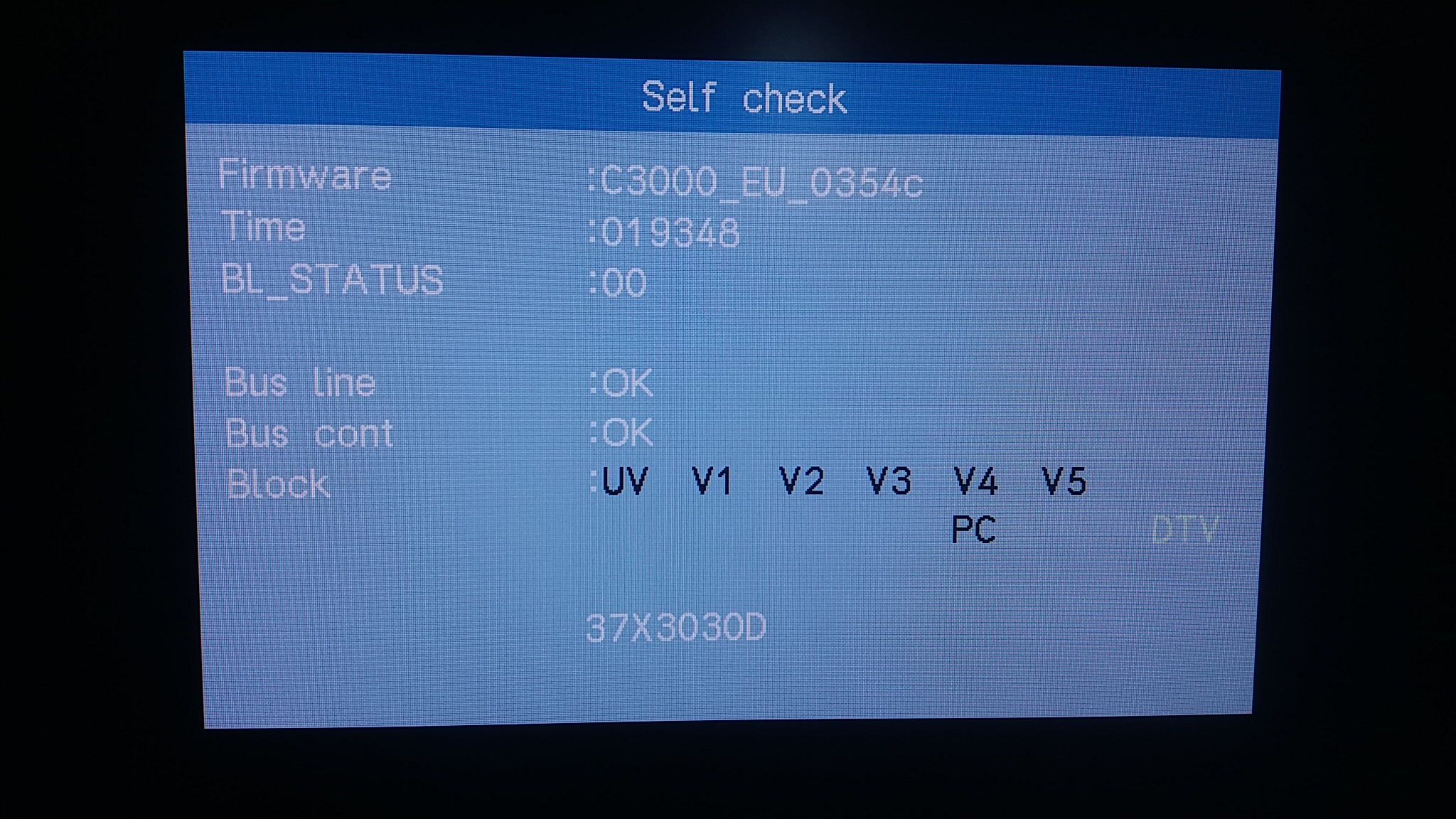

      In service menu pressing '9' shows Self Test screens and other info, on all other source input modes the 'Block' setting is solid red, however on DTV source the 'Block' setting 'DTV' flashes between red and green, I assume this indicates a fault condition.
      UV - analog tv
      V1 - scart 1
      V2 - scart 2
      V3 - component
      V4 - hdmi 1
      V5 - hdmi 2
      PC - obviously PC input
      DTV - obviously digital tv

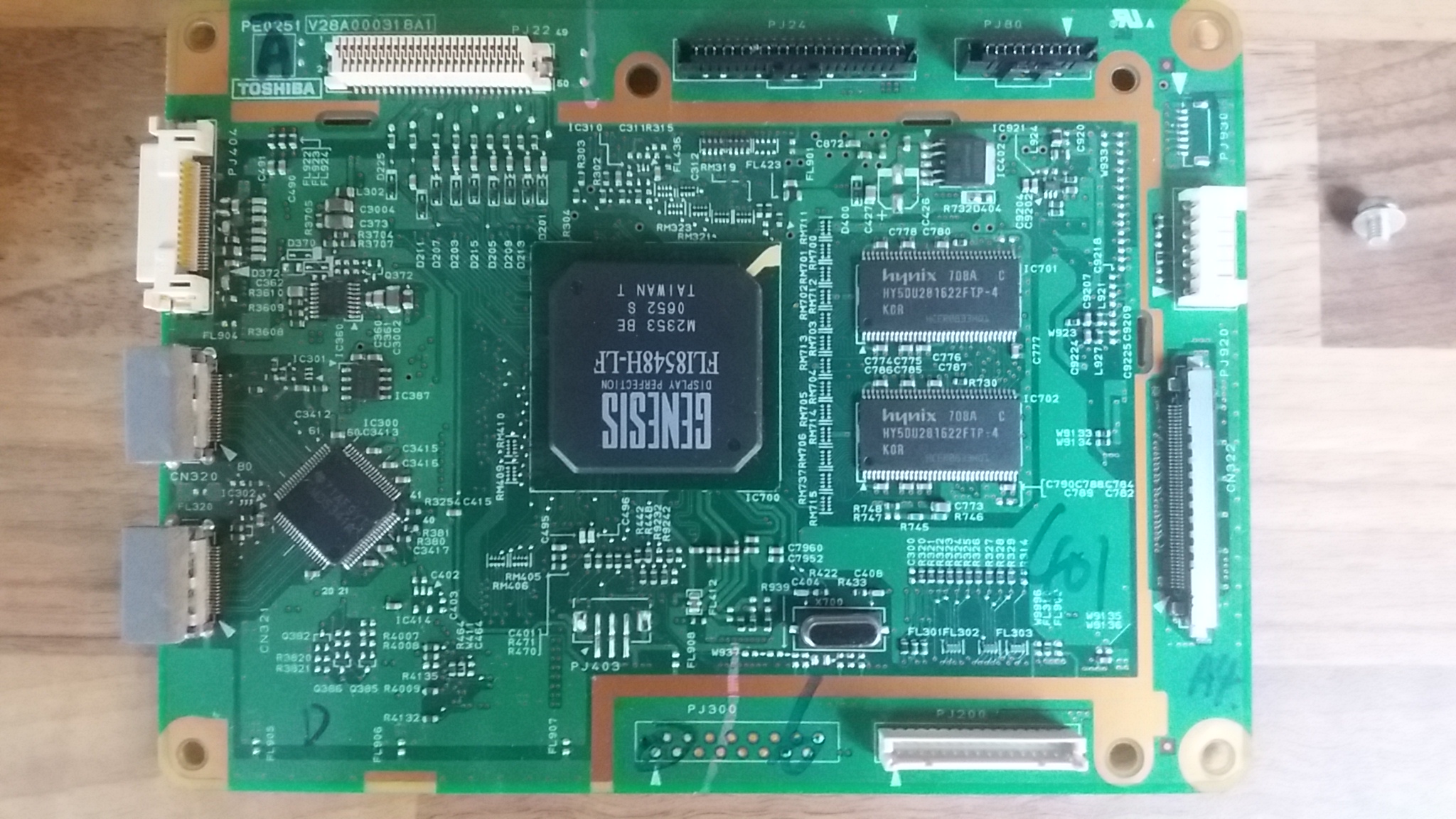

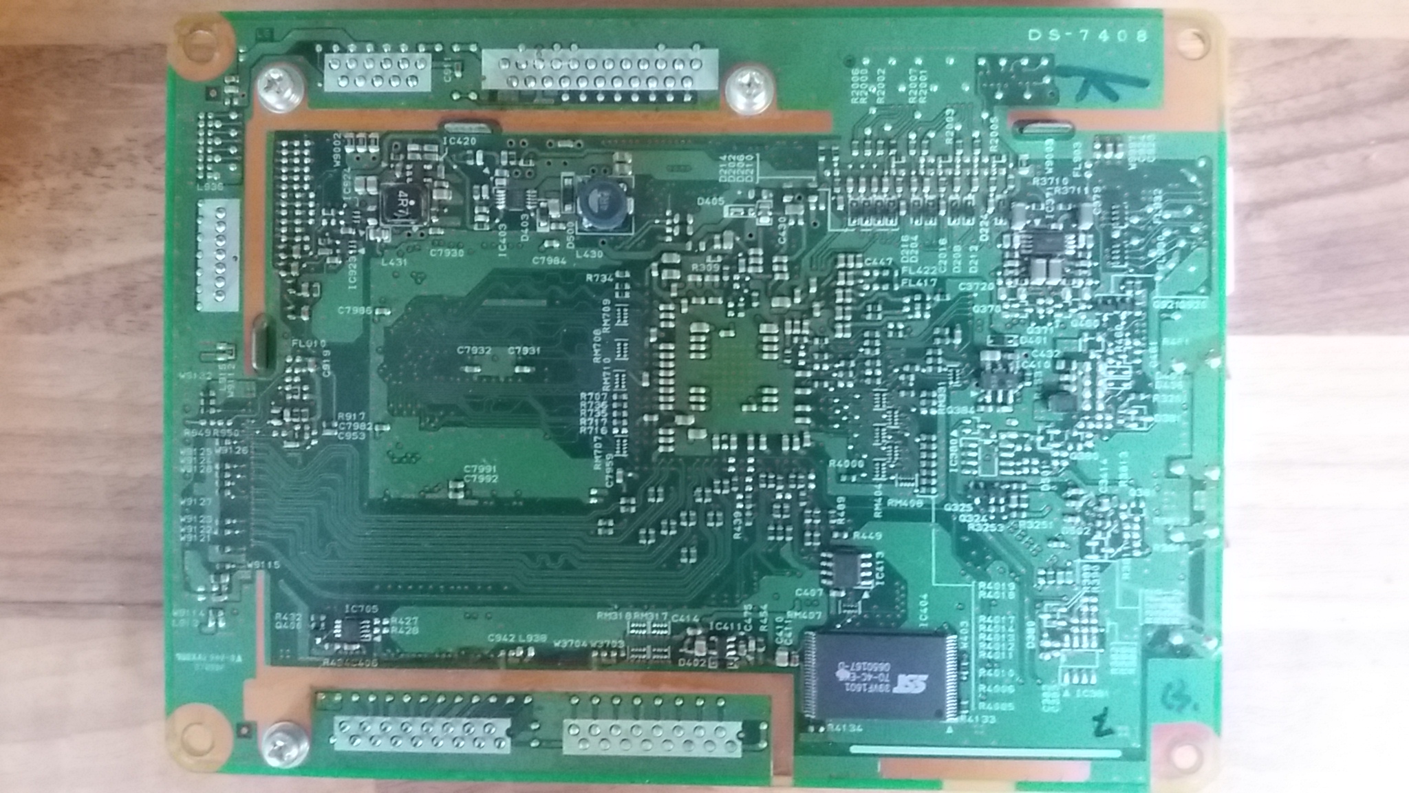

              I inadvertently in a hurry bought the wrong PE0251 board, its for a 32C3030D. Have tried it with no success!
              The Tv powers up from cold boot but instead of going into stanby mode it turns on with backlight lit only, nothing else happens and no response to remote or keypad.
              Anyway, the 2 boards look identical so I assume the only difference is firmware.
              In theory would simply swapping the eeprom from the original bd to the replacement bd work? assuming the original board is faulty and the firmware is not corrupt, of course.
