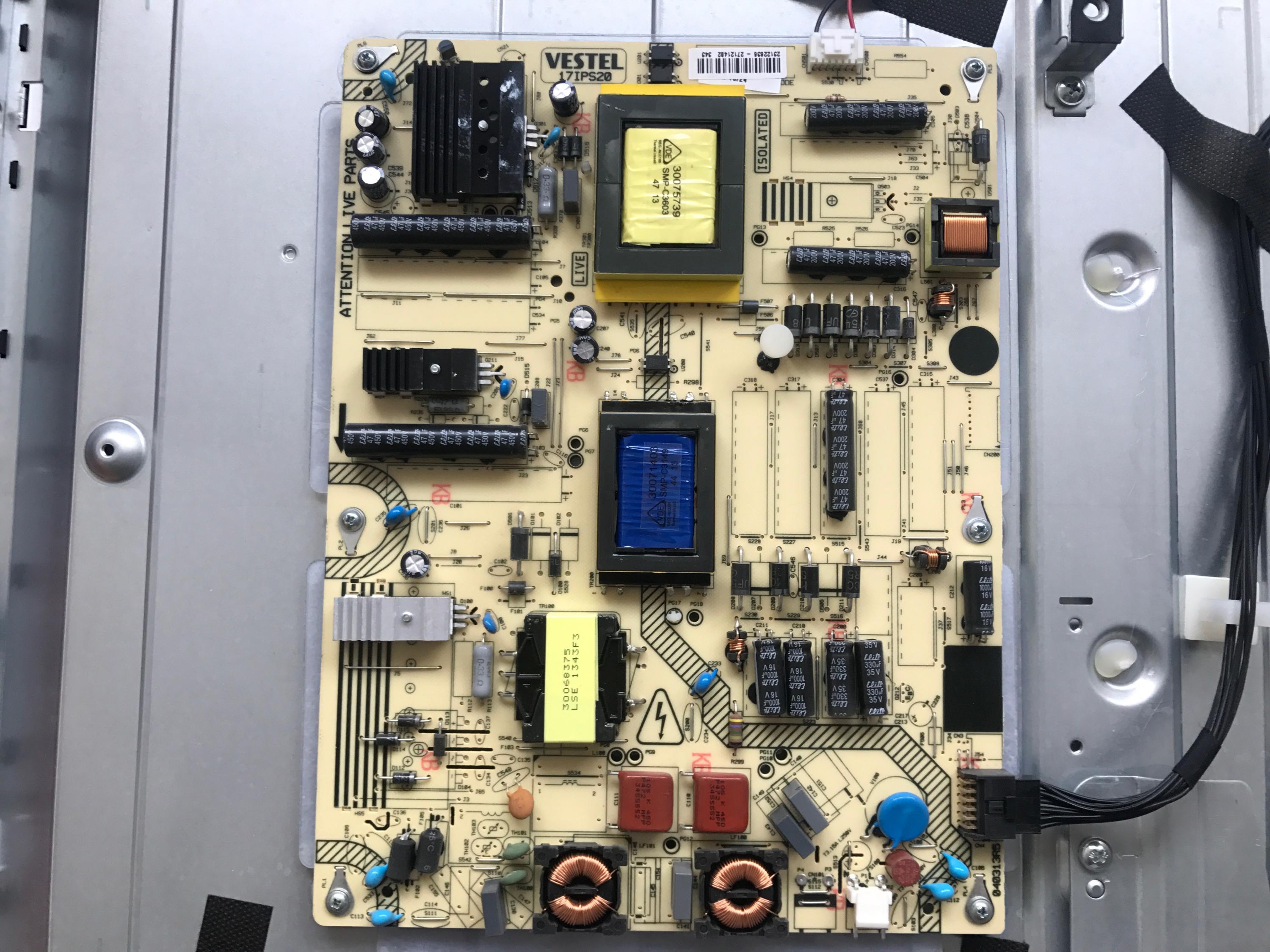

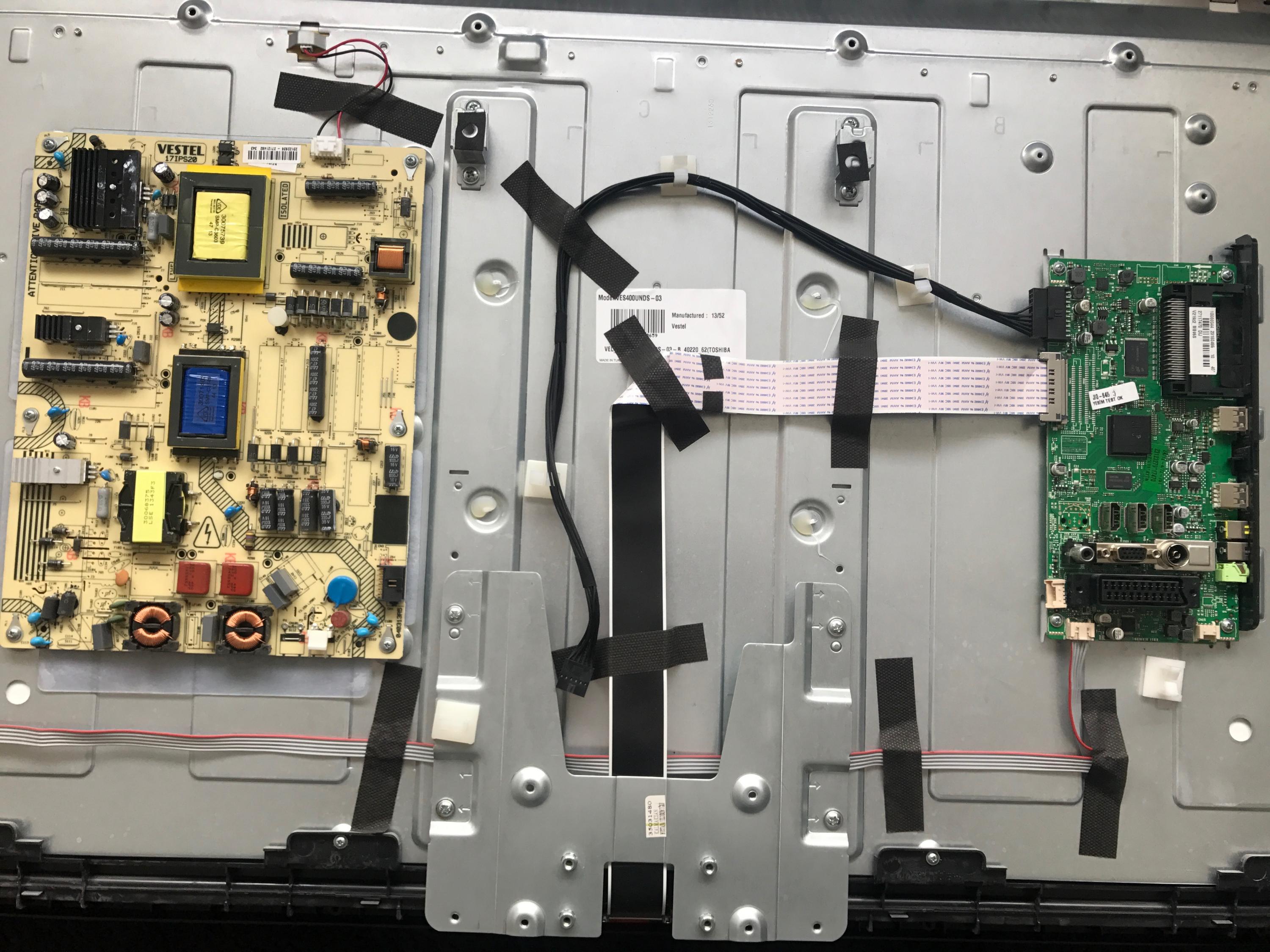

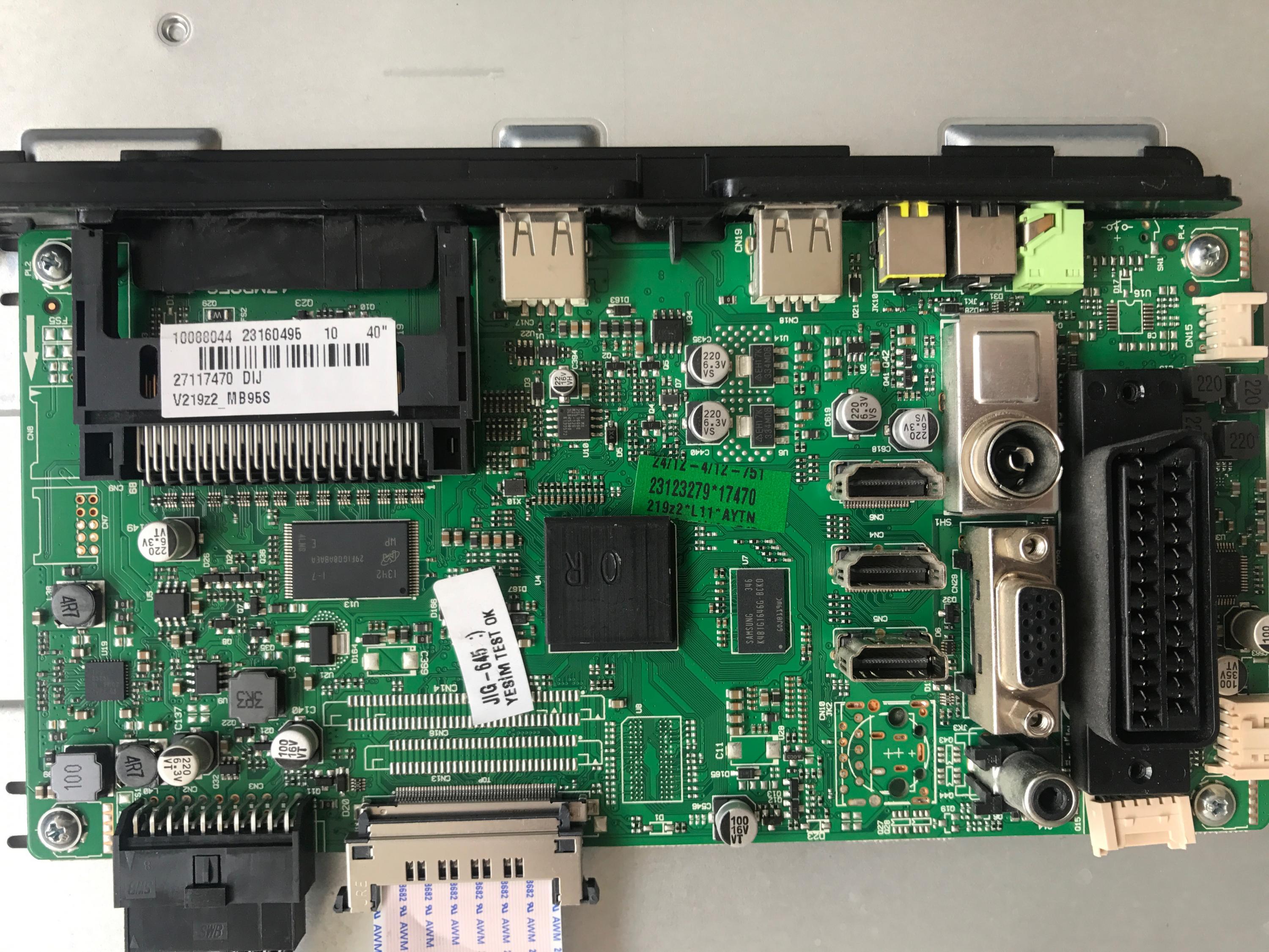

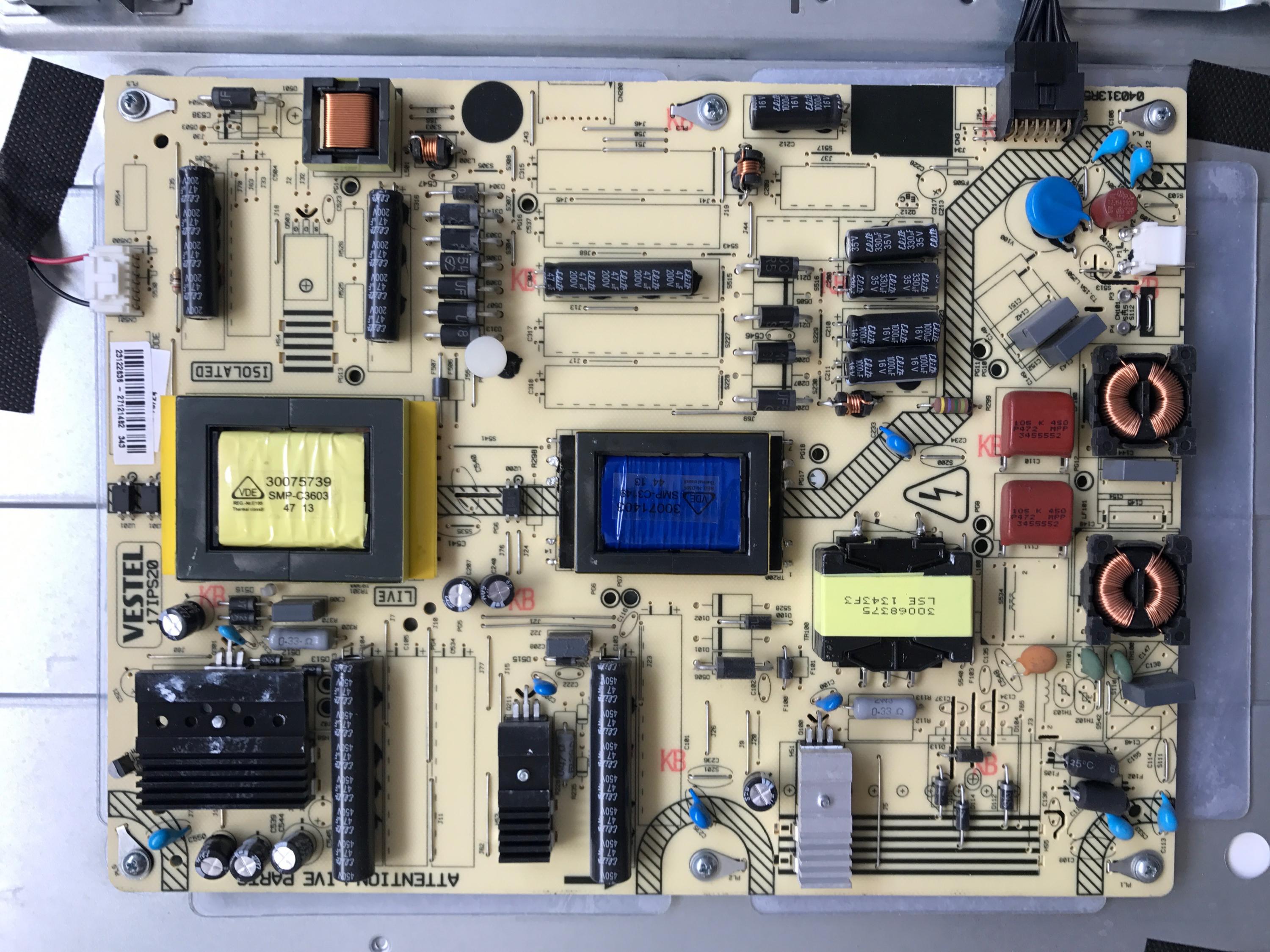

    Need good clear straight on pictures of back of tv with cover off and each board.
    • smiddy1980
      HELLLLLP
      • Sep 2014
      • 57
      • Scotland
      Re: Toshiba 40L1333DB not turning on
      Sorry I meant to unload these

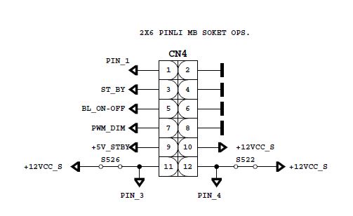

            It would help if you can give the dc voltages on CN4
            • smiddy1980
              HELLLLLP
              • Sep 2014
              • 57
              • Scotland
              Sorry for the lack of info guys, I'm not 100% sure of the layout of the pins but looking at CN4 on the board pin one being bottom left here is what I get the only voltage I get is pin 9 goes from 6 to 11v ping 12 13.2v that's with the main board disconnected

                  This is a LED set with the dreaded Vestel PSU. In my country we have all Chinese manufactured gear generally and no scarrt connectors so my comments are general. Your standby red light is going out at switch on and the power is coming on to a degree. Voltage fluctuations can be used as signals to turn on other circuits. At top of PSU what voltage is going from white connector to leds? For the other connector are pins identified on the board/s on top or underneath? Do you get sound? Does the set turn off OK as usual with remote or set button ? Any sign of screen lighting up at all even a flicker at switch on ? From answers to these and other questions the gurus can be confident in a diagnosis to assist in a fix. Most people look to board replacement as the solution but power supplies can sometimes be easily fixed. LED string problems are another matter.

                    Only just noted dick_barton has shown the pinouts. So your voltage readings raise question is you dmm reading correctly as a 5v movement would be likely at switch on for pin 9 but usually from near nil to 5. Also 23v instead of expected 12v is strange.
                    No voltage at backlight on so you need to isolate PSU from main and force it on to check what it does then force backlight on to see if LEDs respond. Dick will know which connections to make on this particular connector.

                          yeah my settings are ok, I can hear the board making a small clicking noise, like a switch going on /off very faint, with everything disconnected I'm am getting these voltages so I think it is the PSU that's at fault
                          • maxvalutech
                            • Dec 2014
                            • 804
                            • australia
                            I agree and the Vestel PSU hasn't many admirers on this forum as far as I can see. The relay clicking is normal as it switches. At switch on the 5v signal goes to main which reacts by voltage change back to PSU which then starts all other voltage outputs including sound and backlights the latter also usually controlled via main. Look to troubleshoot PSU by searching in forums or just replace with known good one if economical. Good luck with it.
