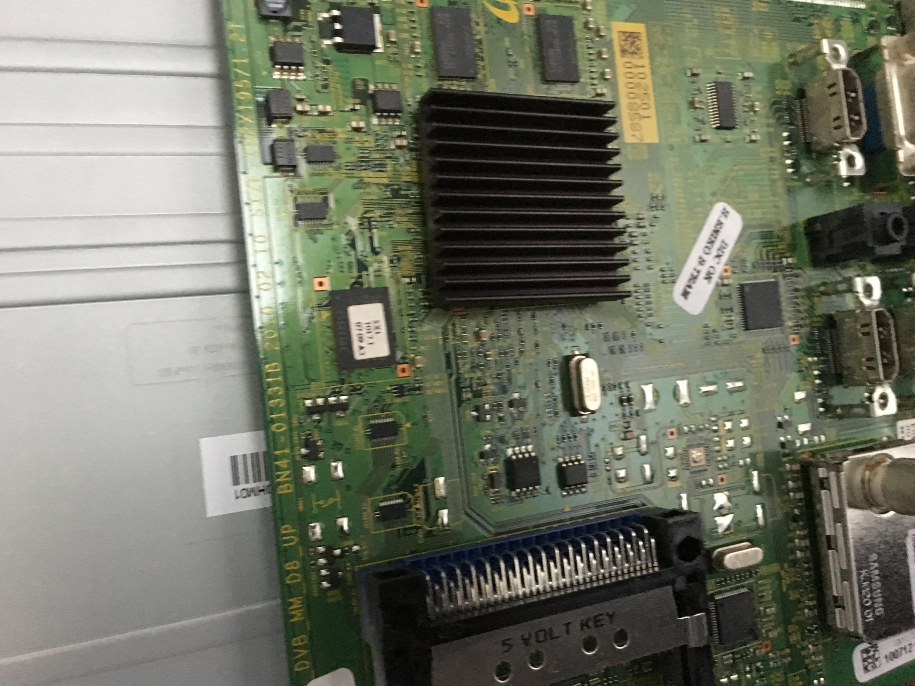

    Hi
    I Have a samsung lcd tv with only standby.
    No response On off
    Remote no response either.
    backlight is working when mainboard not connected
    Problem is the mainBoard.
    Can i try something with the Mainboard maybe eeprom flash?
    Need some help.

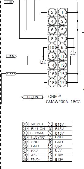

    You need to check your voltages on the power supply connector as shown in the attached photo.
    • Jimmy1979
      • Apr 2015
      • 120
      • holland
      Re: Samsung le40c550j1w
      With the connector connected to mainboard or not?
        Initially connected, yes.
          2 =0,2. 1=0,3 >13,2
          4= 0. 3=0,3 >13,2
          6=0>4,92. 5=0,3>13,2
          8=0>4,57. 7=0
          10=0. 9=0
          12=0. 11=0>5,2
          14=0>5,2. 13=0>5,2
          16=5,2. 15=0>13,1
          18=0>3,9. 17=0>13,1
          Power supply try's to start
          *And voltages pulsating from 0 to >13,2
          Example
          • dick_barton
            • Aug 2015
            • 6643
            • Wales
            Disconnect the main board and connect pin 16 to 18 using a 1K resistor then test all the voltages at the connector again with mainboard still disconnected.
              Would also help if you put pin description so don't have to go back and forth between posts

                With the Main Bd disconnected the Backlights came On. Then there is definite a working PSU and faulty Main Bd. It could either be a problem with the BGA chip or a non-working Regulator Chip not sending the PWR-ON signal to the PSU to start it up.

                  you need to check your voltages on the power supply connector as shown in the attached photo.
                  2=5,2. 1=13,1
                  4=2,1. 3=13
                  6=4,83. 5=13
                  8=0. 7=0
                  10=0. 9=0
                  12=0. 11=5,3
                  14=5,3. 13=5,3
                  16=5,3. 15=13
                  18=5,3. 17=13
                  • dick_barton
                    • Aug 2015
                    • 6643
                    • Wales
                    As Andrew F Ali has just pointed towards, it looks as though there is a main board fault with it trying to power on the set (Pin 18) but failing and retrying which is why your voltages are swinging up and down.

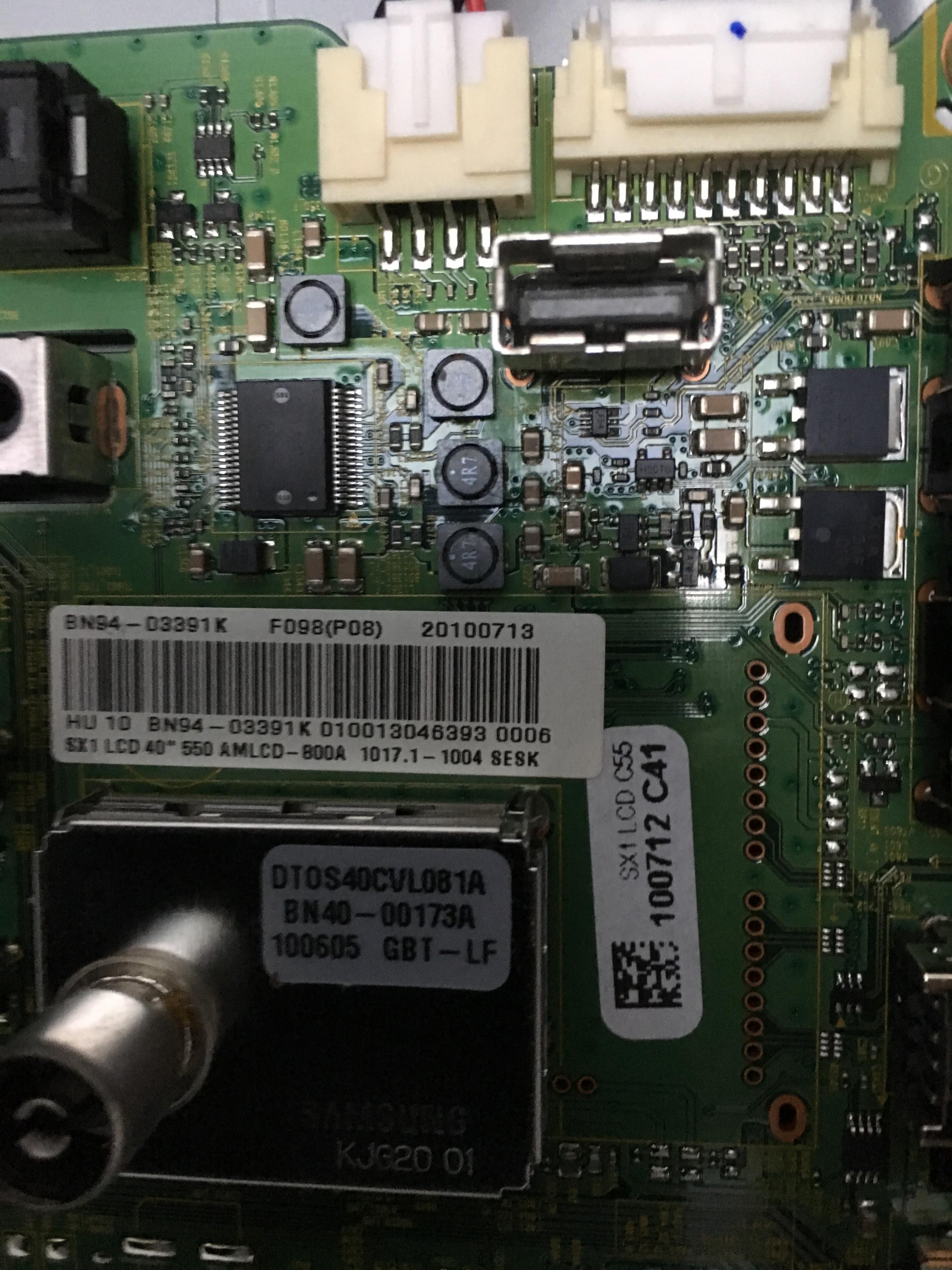

                          A flash file was included in the threads although i didn't read all the way though to know if its also suitable for your set.
                          If the EEPROM on your mainboard is corrupt then reading it and writing it back may not cure the fault.
                          You could try freezing the eeprom and then switch on the set and see if it powers up correctly. If it does then you could remove it, freeze it and then read it and save it to file and write it back to the same EEPROM or to a new one.
                          • Jimmy1979
                            • Apr 2015
                            • 120
                            • holland
                            I will try and see if i got luck.
                            I wanted to try en write the file on a new eeprom chip not old one.
                            But i have to wait untill i get the usb flash programmer

                                  I have changed the eeprom with a new empty one first.
                                  No standby and no power on after 30 seconds.
                                  So i read the old one and programmed the file on the new one.
                                  Then power led burning just like the old one but when powering on the standby light dims and no reaction after that just like the new old one.
                                  Does someone has the right bin file.
                                  Maybe mine is corrupt or there is an other issue with the mainboard.
                                  Thanx
