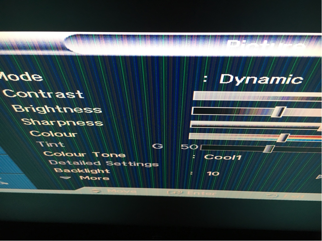

    had faded screen
    replaced and no have the vertical lines
    reckon its a bad panel
    any one seen before

    Likely t-con, it's rare for repeating vertical lines to be caused by a panel failure.

      Ok,
      I had it in with a failed as15 chip
      replaced chip twice and both times have had this ...
      Posibbly bad batch of as15's
      or has something else also gone on the tcon board
      Good thing i didnt strip for parts yesterday..lol

          No,
          I had it with a faded screen
          replaced the as15 twice
          but this proble with the lines persists...

            You've tried cleaning and reseating cables?
              Re: Samsung 40m86 Vertical lines bad tcon or panel
              AS15 wouldn't cause this. Doubt dirty cables would either. Likely a processor fault on the T-con -- maybe the RAM or BGA soldering. I think the M86 has an advanced T-con -- I can't remember if this model has the 100Hz interpolation stuff.

                Gone into storage till a tcon comes up at a reasonable price.
                might try relfowing the board if I get time..
                but otherwise will update once i have access to a replacement tcon.
