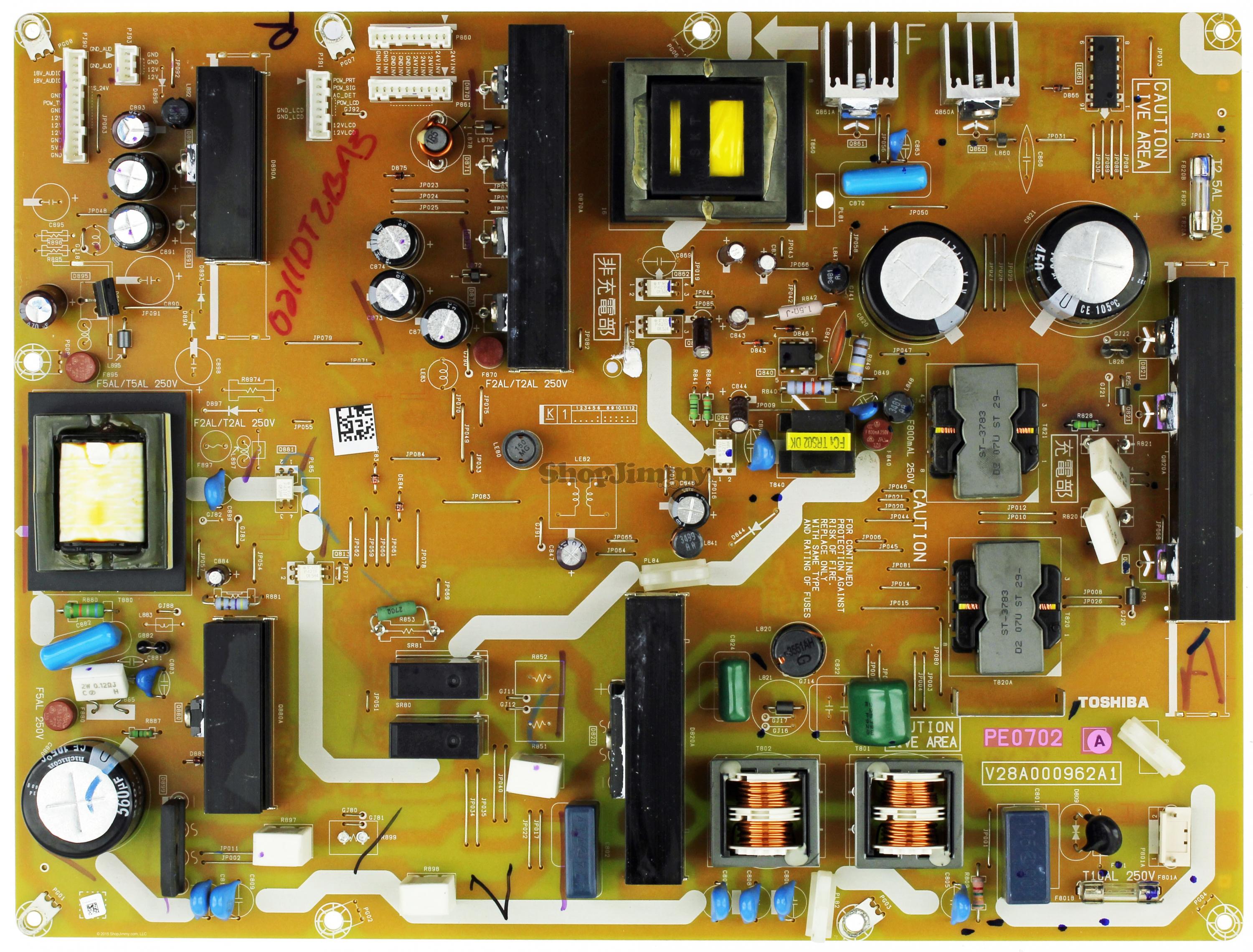

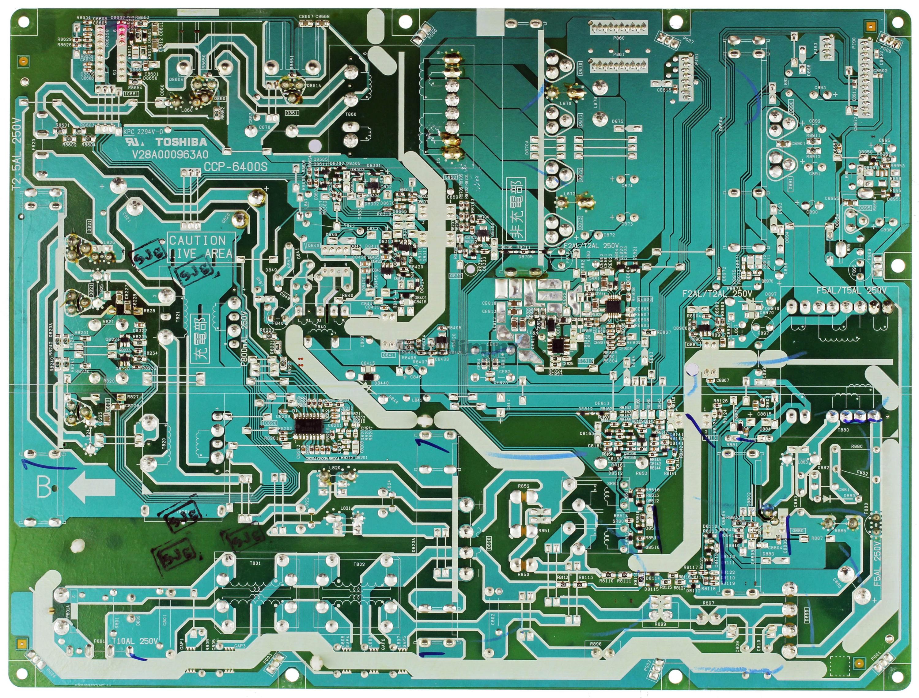

          We need good clear straight shot pictures of the top and bottom side of the power supply board.

            SJ has good pictures top & bottom

                "If you need pictures to reference, I can dig those up off the interwebs easily enough" We need the pictures of your board since you may not see the problem on your board but we may be able to see problems based on our experiences.

                  I'll see about getting a picture of my board top and bottom.

                    If you look at the bottom side of the board then you will see that the + legs of the caps go to the fuse F820 and the negative legs of the caps go the jumper wire which means you can access those two test points from the top side of the board.

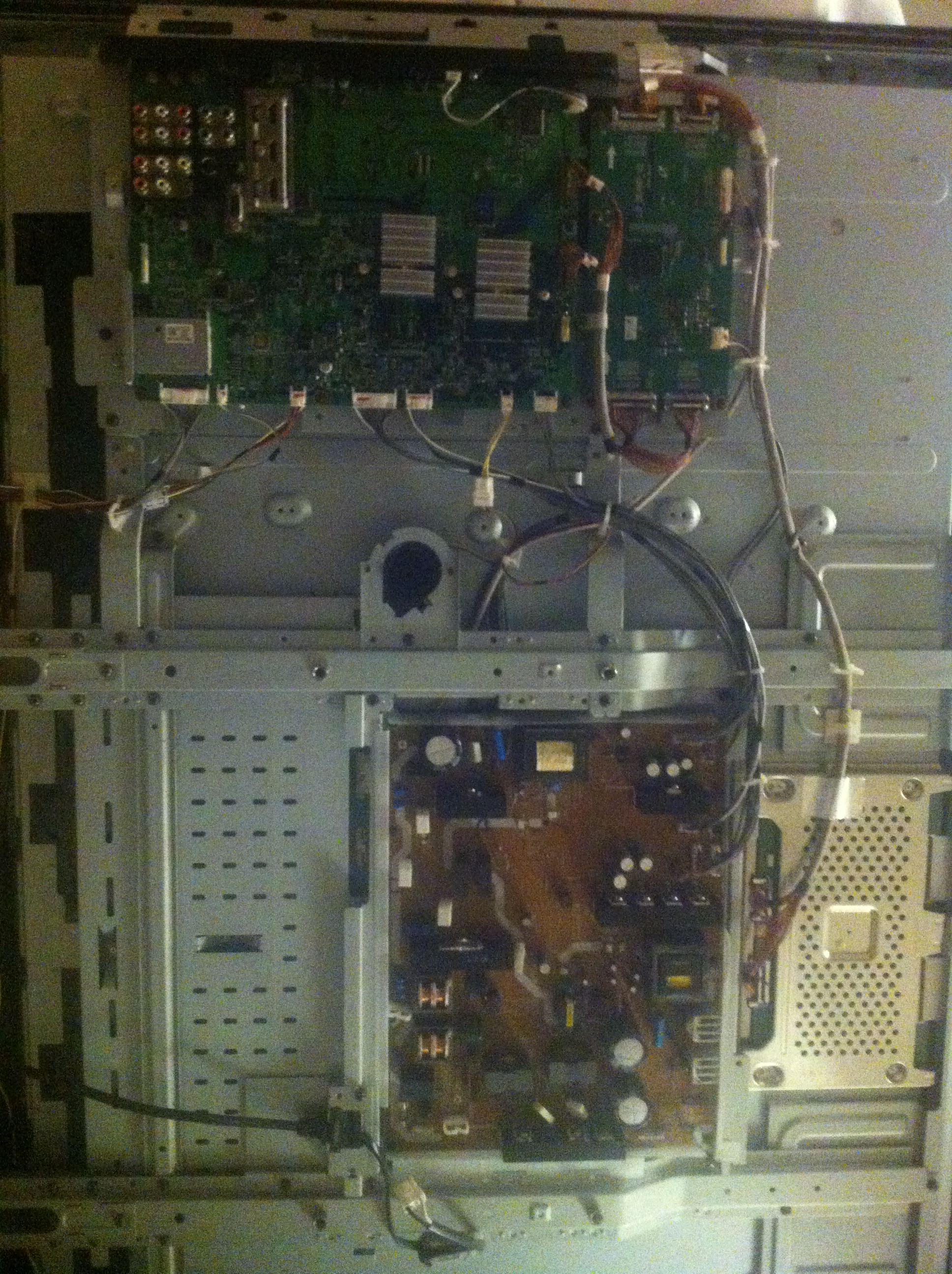

                                  Also, while my honey-do list is keeping me from getting full pictures of the board tonight, here is a quick snap of the power and main board both mounted.

                                    I couldn't help myself, chores be damned.
                                    Pulled the covers off the relays and I was wrong. SR81 IS NOT closing. SR80 closes once plugged in and opens when unplugged.
