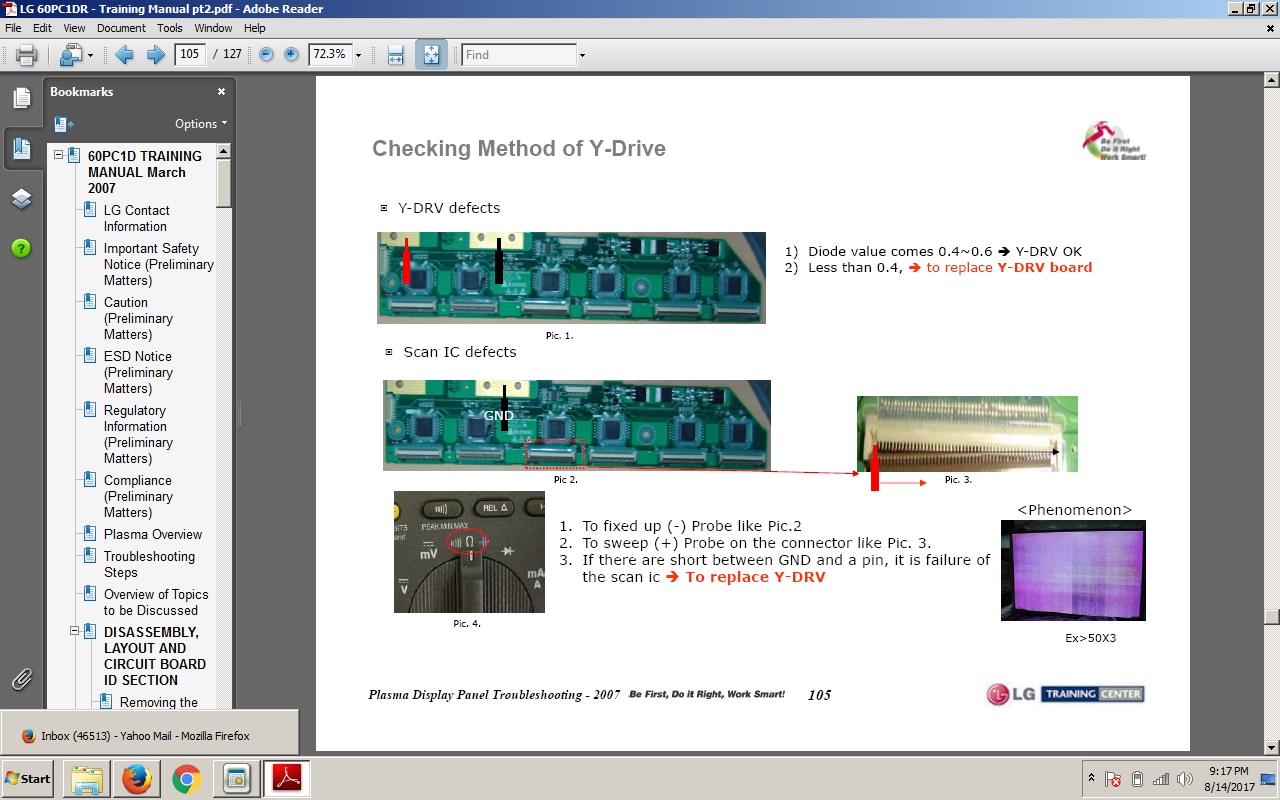

                                      Re: LG 60PC1D-UE picture messed up
                                      per serv manual buffer test is one lead on floating ground pad on buffer other lead rake pins on buffer
                                      should be no contnuity
                                      does this sound correct?
                                      i just tested my buffers that way and i get multiple shorts
                                        #99
                                        and i just looked back and tom you stated how to check buffer for shorts and it is exactly how serv man shows
                                        so i have to assume my buffers are both shorted?
                                          see pic taken from lg service manual for this model tv
