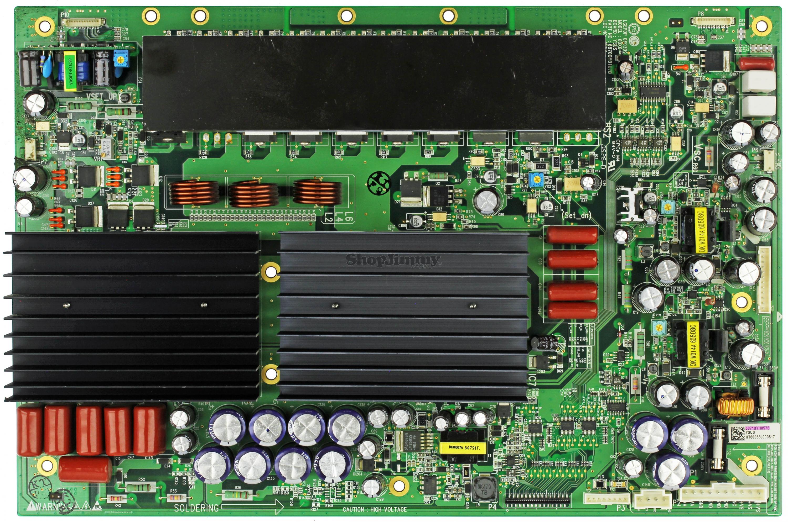

                              #74
                              Re: LG 60PC1D-UE picture messed up
                              actually its p3 cable not p300
                              here is a photo of y
                              im going to take a pic of back of tv..maybe someone can see something else that could be causing the issue

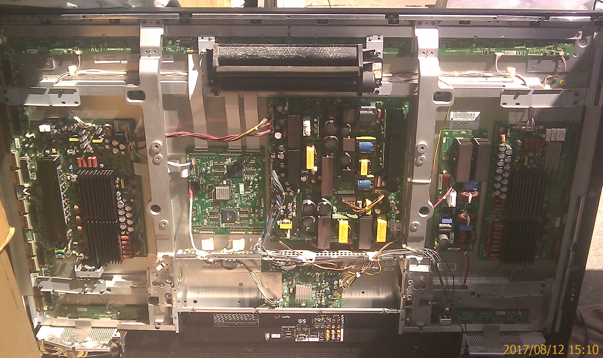

                                #75
                                here is pic of back of tv.....
                                not sure what other boards could be the issue of the problem im having
                                i do not believe it is y board or logic board since i replaced both boards and no change in symptoms or voltages.
                                  #76
                                  P3 is just the cable that sends 15V power for gate drive. Removing it will remove the transient short issue that is causing your problem, either on the Y or the control board. I suspect though that your issue is caused by incorrect control signals from the control board, but I cannot confirm my suspicions without a scope.
