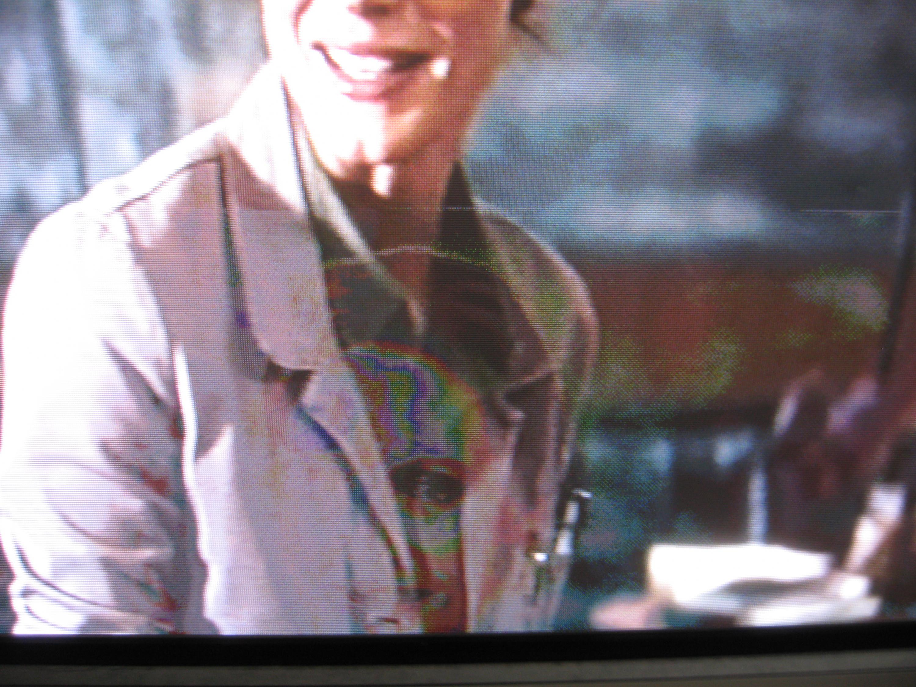

    i have a toshiba 42in plasma tv which has given very good service over the years.
    it has developed a picture problem , after it has been on for some time there is a ghost image of the top half of the picture on the bottom which flickers it can be seen most on a dark image .
    i am looking for some advice on how i can fix the problem
    the set came with another which did not work and is for parts only so i have everything except the y upper and lower buffer and y sustain boards , i can see that the tv is made mostly if not all by LG. as the boards seem to be common to a wide range of sets
    Any advice would be welcome , thank you

        Re: Advice on Toshiba 42wp46p plasma tv picture problem please
        Thank you for reading my post i have taken some pictures which i hope you can see ,
        there is a clear divide line across the screen , the set has been running for some time before this starts,
        p/s i have not taken this set apart yet although i did try and get the other set going , but gave up after it blew two y buffer boards and one lower , it was going to cost to much to continue , i did keep all the other boards
        thank you regards Dave
            A bit out of my league but erase problem or control board??
                    I would swap control board as a first try. Also, you note that the fault occurs after some time which indicates heating is probably involved. You could try a fan behind the set as a test. When fault appears if you turn set off for a few minutes is the fault still there when you turn it on again. Some detective work required. I get a feeling that as plasma is now passe the guys on here are now on the learning curve for oled uled etc. There certainly is lot more knowledge than mine:on this forum.
                      Hi
                      Thanks for your reply , i have tried a fan behind but is not easy to get much flow into the back , funny thing is i left the picture on pause whilst the camera charged up ( on a dark part of the image ) when i came down to take the picture it was ok and i had to run the film again until the fault came up again clearly bright sections of the film etc cause things to heat up faster when i get some time i may try swapping the board although the set is a bit of a lump to work on ,
                      thanks for your input
                      regards Dave
                        I would definitely say control board. But this set is really old, I would also say it is not worth repairing unless the board is very cheap.
                          Thanks again for all your time , as i have all the parts except for the buffer boards and the board they plug unto i may well try that ,
                          i know its old but i like the picture and its got lots off scart inputs
