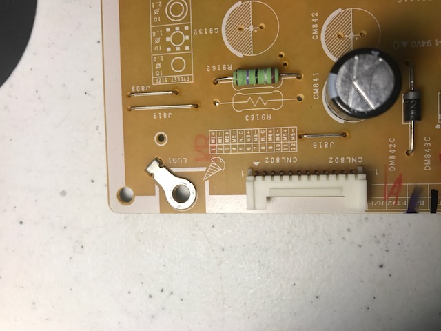

    Hi guys hope i can get some help here
    Led was blinking wasnt getting no backlight wn removed connector from smp now i replaced the smp and getting the same led blinking light in front of tv
    Wn i remove cable from main board to tcon tv backlight comes on and soon i snap it back on the tv is normail all works perfect if i power off tv it doesn't come back on till i do thye same cyle again it seems that either the tcon has an issue or the new powerboard i replaced has a short and not sending enough voltage im puzzled help please
    Thank

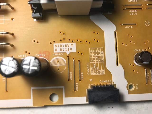

      The pins from smp with 13v markings are reading12.8v all 4 2/4/6/8
        Re: samsung un55h6203af led constant blinking
        https://www.badcaps.net/forum/attach...7&d=1499923017
        How about the signal pins 2, 4, and 6?
        A13V = Always ON 13V, not switched.

          Ok those pins have4.4 pin2 2.3v pin4 3.2v pin6 and pin8 0
          So i think thats where the prob is cause on the board says they should have 13v too
          No caps look swollen but will start testing the main caps
          Let me know what u think please

              Where did you see it shows those command pins should be 13V? It better not be 13V since those command Voltage are running on 5V.
              Pin 2 (OD/UD, some kind of error signal)= 4.4V not sure if normal is High (>2V, or normal should be LOW (<1V).
              Pin 4 (BLUPWM) Dimming control = 2.3V which is fine
              Pin 6 (PS-ON, for turning on the switched power supplies sections) = 3.2V which is fine.

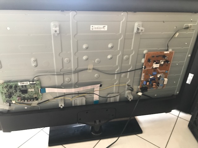

                BTW, we need pictures of the whole back side of the TV showing all the boards and how they are connected together.
                There are more Voltages you need to check on other connectors beside the two pictures you have shown.

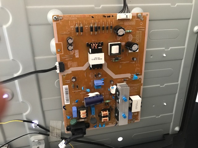

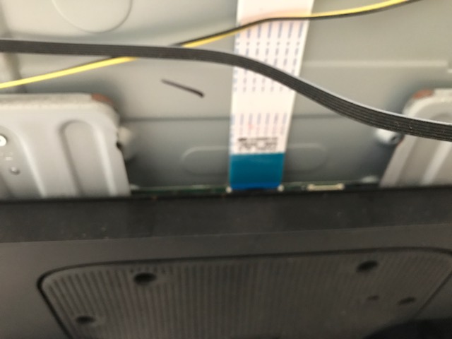

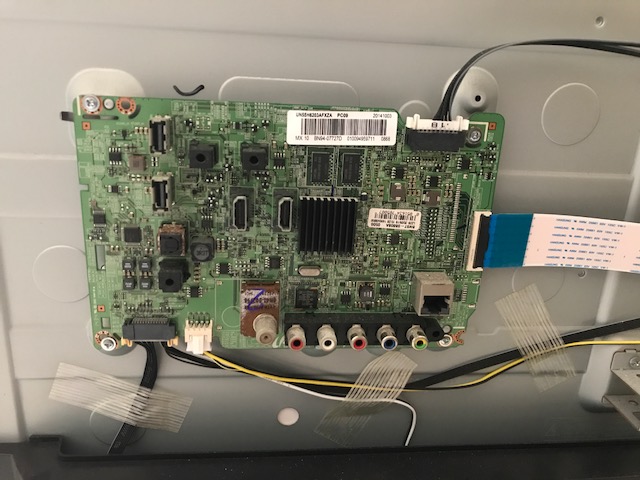

                      Here are pics of the back
                          OK, the T-CON board does not control the backlights in this set.
                          You can do self test of the Power supply/LED driver board/backlights by disconnecting the cable between the power supply board and the main board, when you plug the power cord into the AC outlet the backlights should come on and stay on if the power supply board and the backlights are OK (hopefully it does not need the dim signal for the self test).
