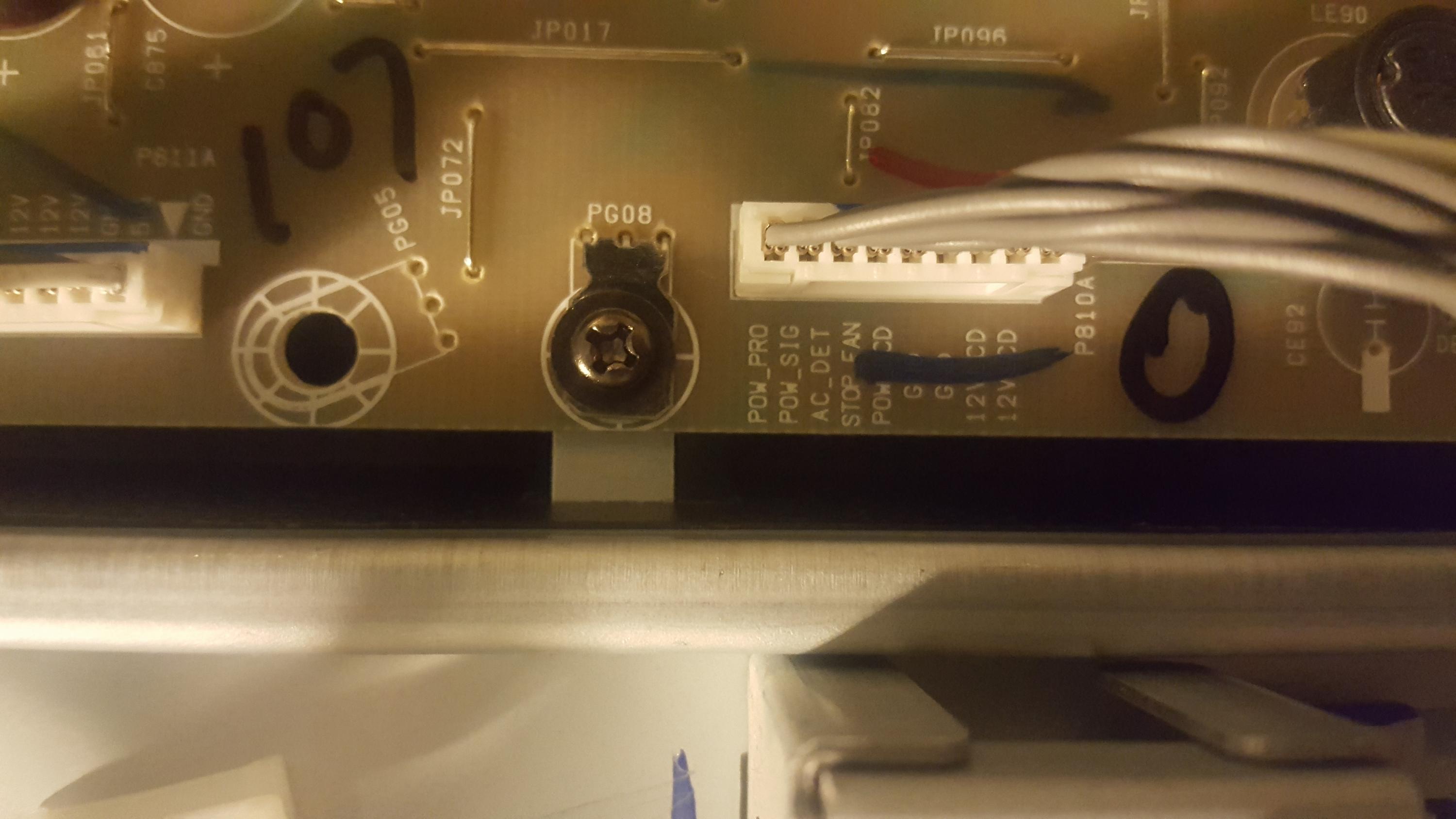

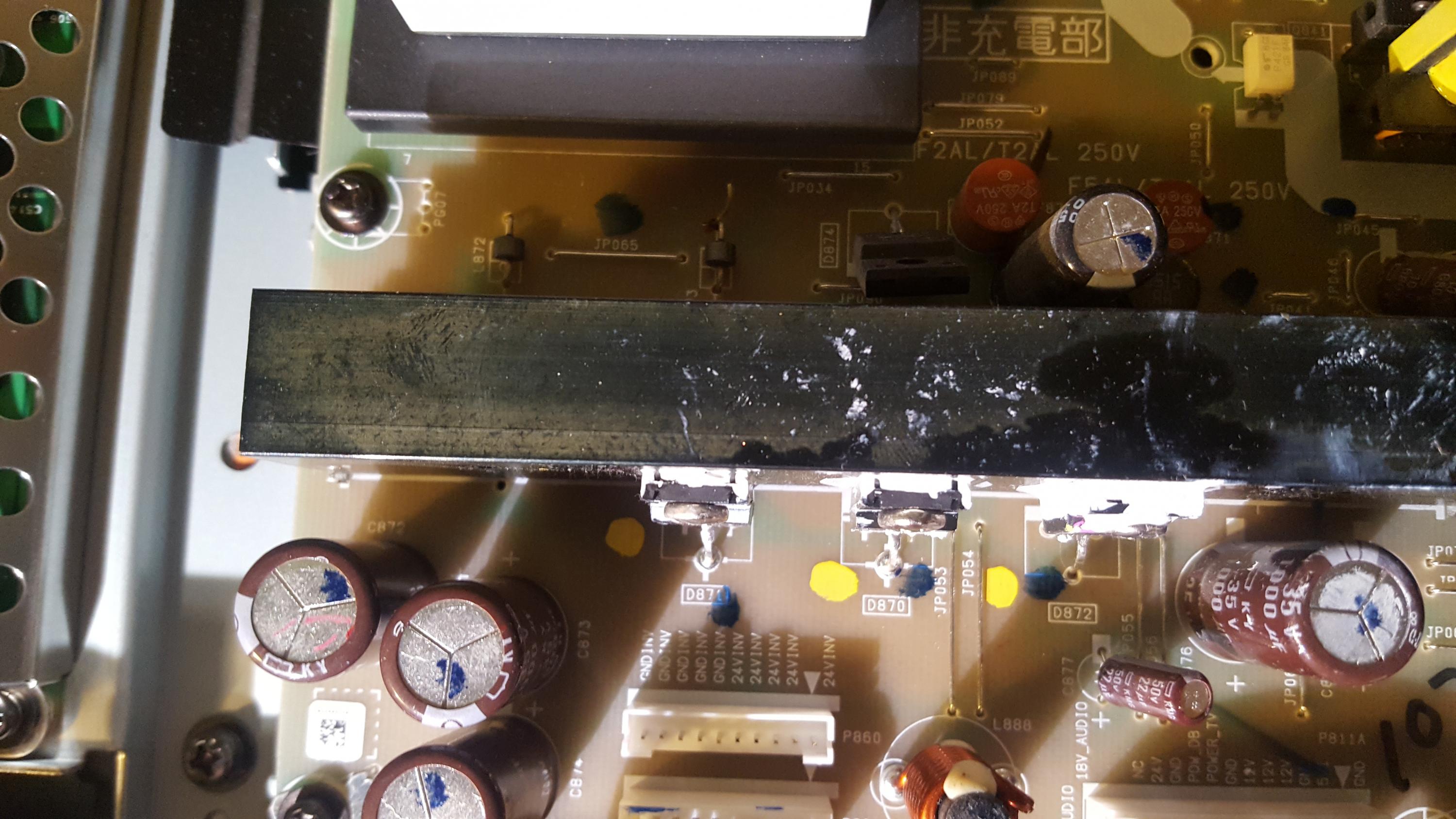

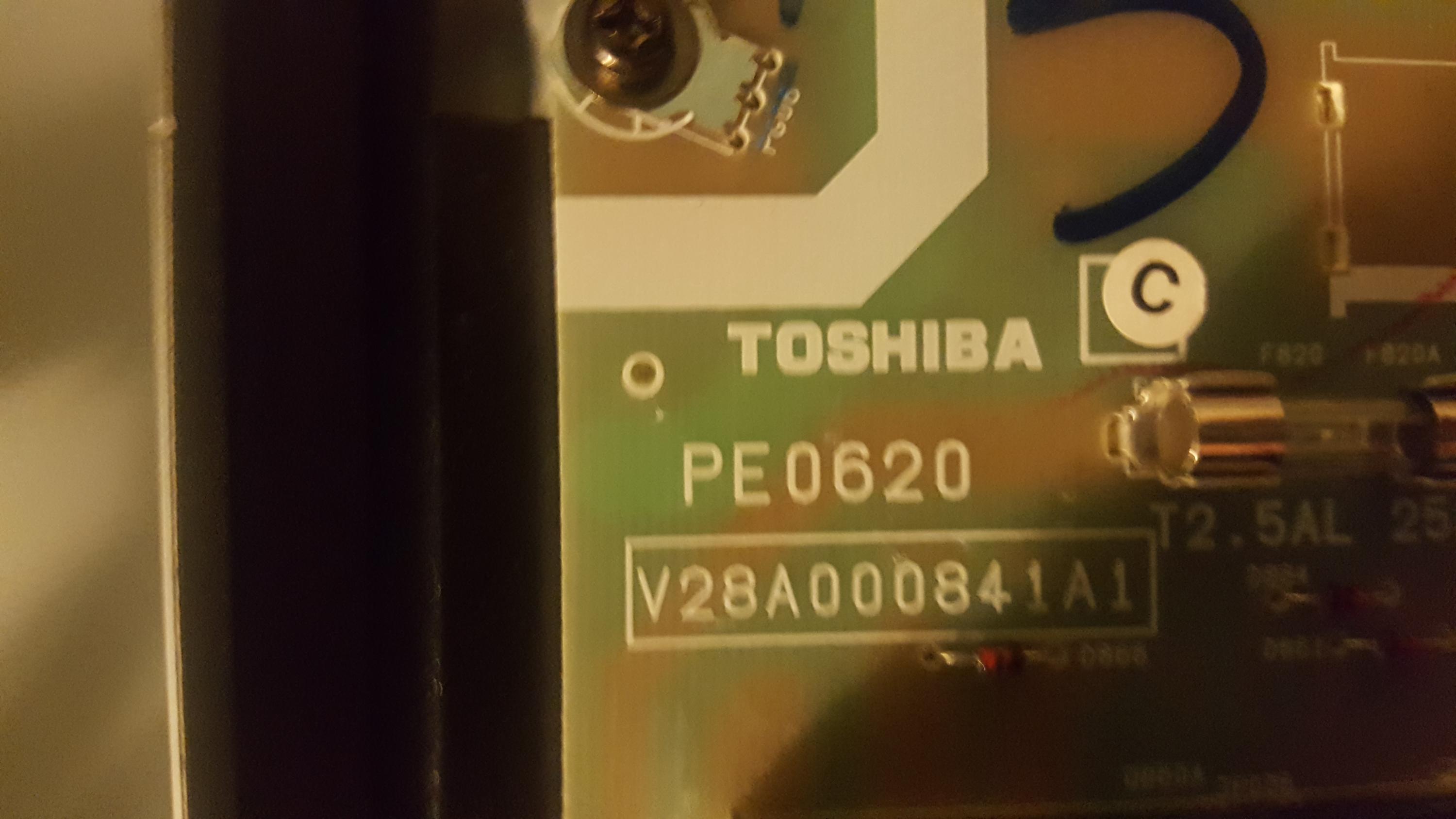

    Hello.
    I've been troubleshooting a Toshiba Regza 42XV545U over the last couple of months and I've run into some problems.
    The power supply is a PE0620 V28A000841A1
    When I originally received the TV it had no signs of life. I did some troubleshooting and found that a thermal fuse resister R850 was blown, I replaced it. After doing this I noticed I was getting three yellow blinking lights on the power LED, however nothing else. Some more troubleshooting and I found that fuse F820 next to the SMPS chip was blown, I replaced it and it blew again immediately. I replaced the SMPS chip Q860 and now the fuse F820 doesn't blow but I also get no signs of life at all from the TV again.
    I know the power supply is at least partially alive. If I measure along the connectors going to the logic board at least some points have voltages on them. AC_DET has around 3.3V for instance, some others have 5V.
    I'd like to check the standby voltage going to the main board, but I don't know what points to check, or what the voltages should be. Any assistance would be appreciated.
    One thing I did notice. I measured voltage on the POWER_TV point and it sits at zero, if I press and hold the TVs power button nothing happens for a second or two, then it hopes up to 5V and back to zero again.
    I've attached some screenshots of the board.
    Any assistance or direction would be appreciated.

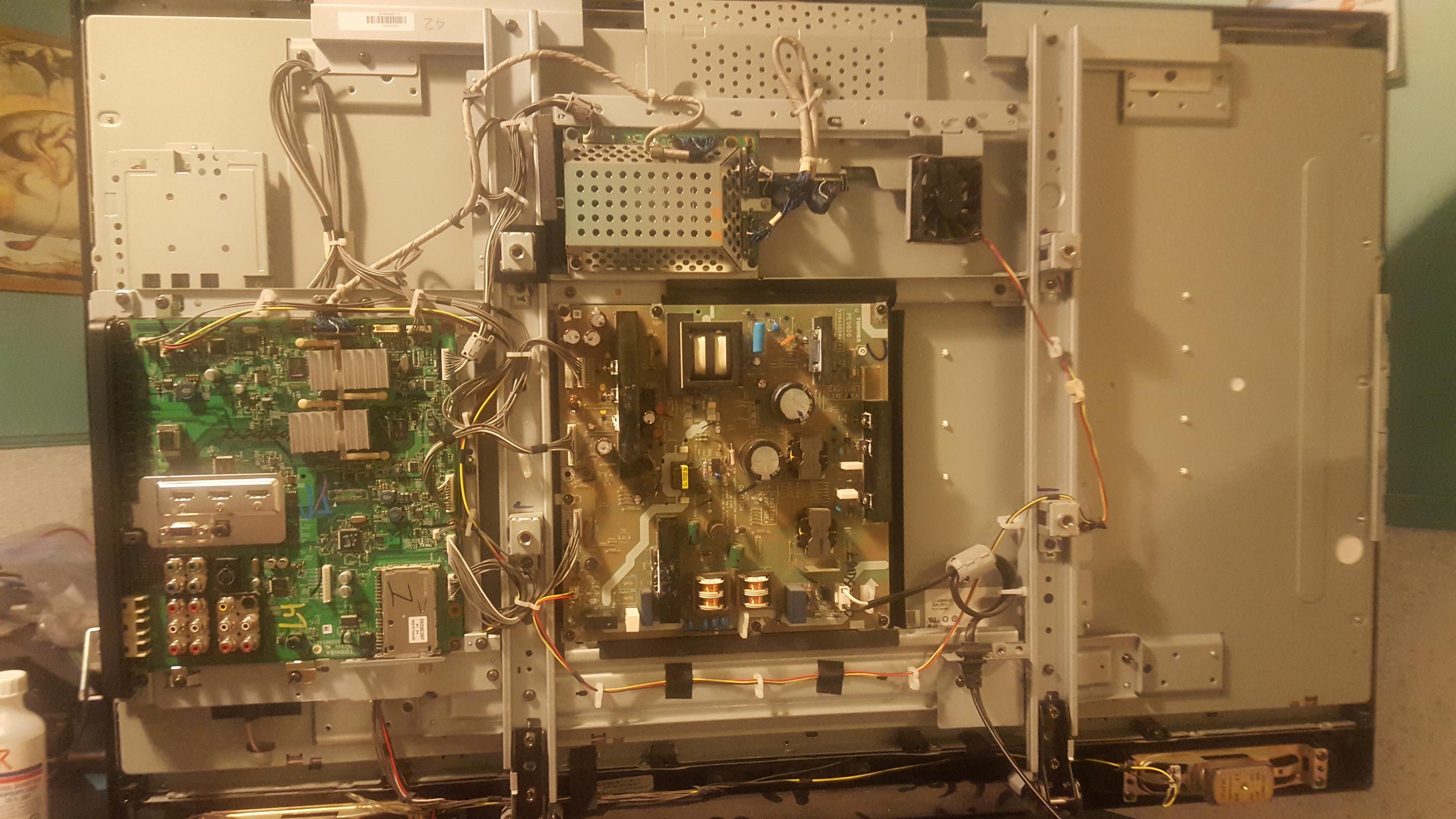

    Re: Can't Find Standbye Voltage on Toshiba Regza
    We need the pictures of the whole backside of the TV showing all the boards, then we need the straight shot pictures of the whole top side and bottom of this power supply board.
    POWER_TV is the same as PS-ON, so something has caused that control signal to drop out.

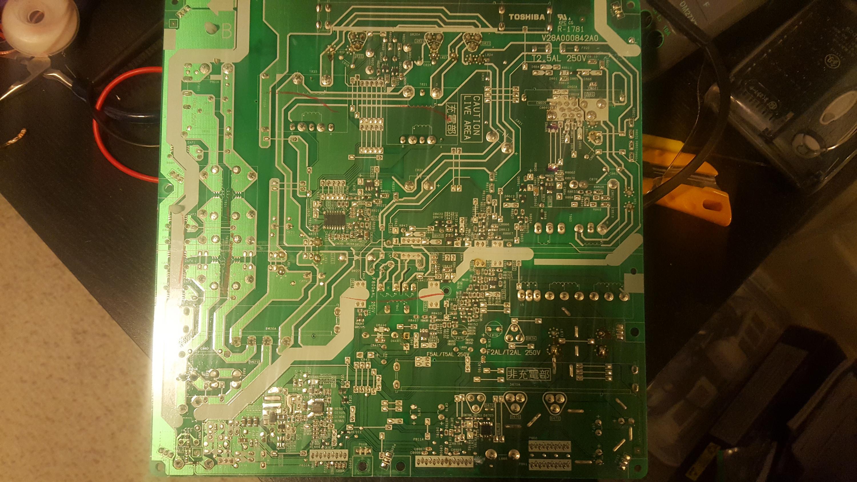

      Hello
      Here are the requested screenshots.
      Is it possible to bridge the gnd and one of the points in order to cause the power supply to start so I can test voltages on the other points?
      Thank you.

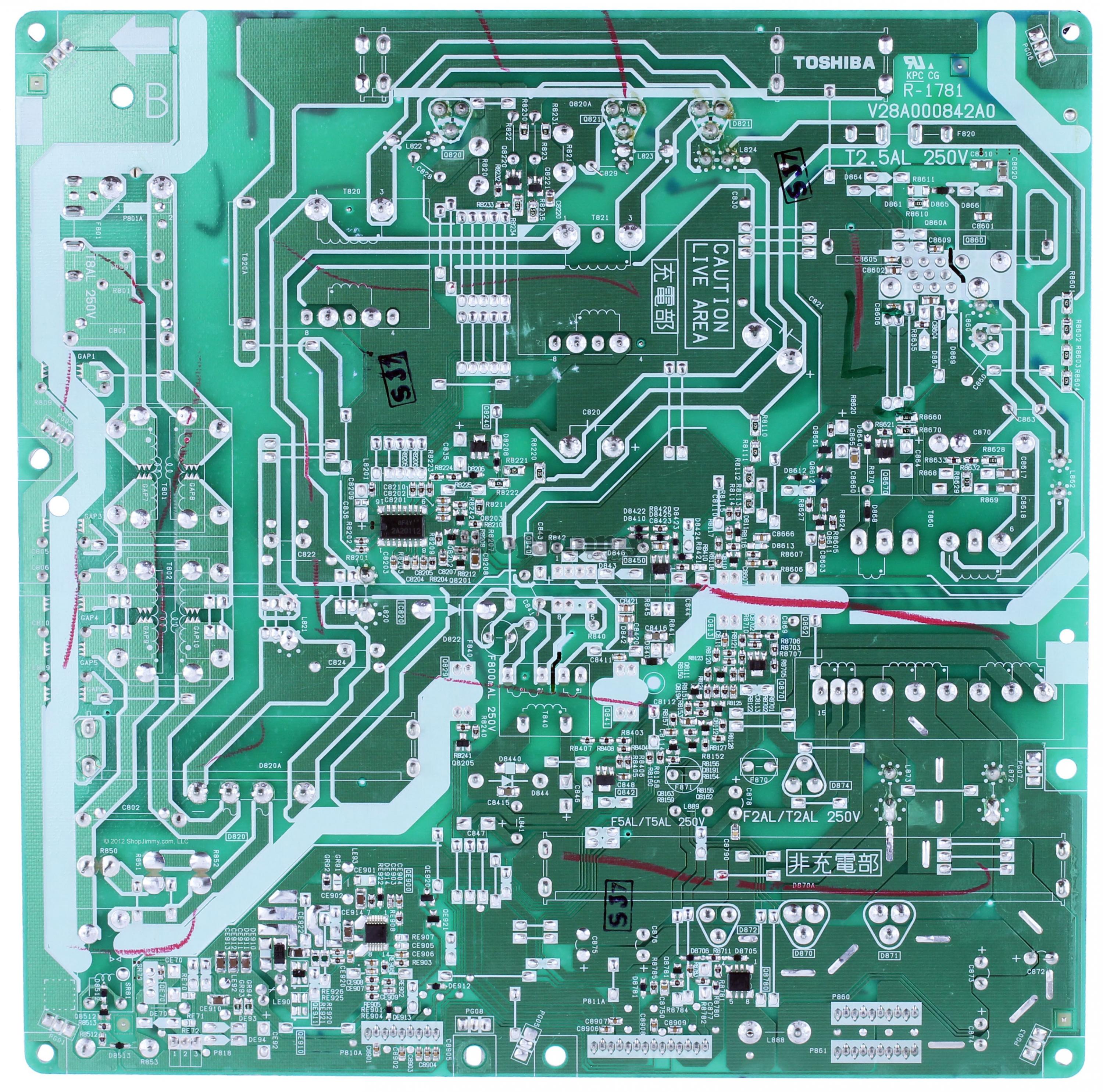

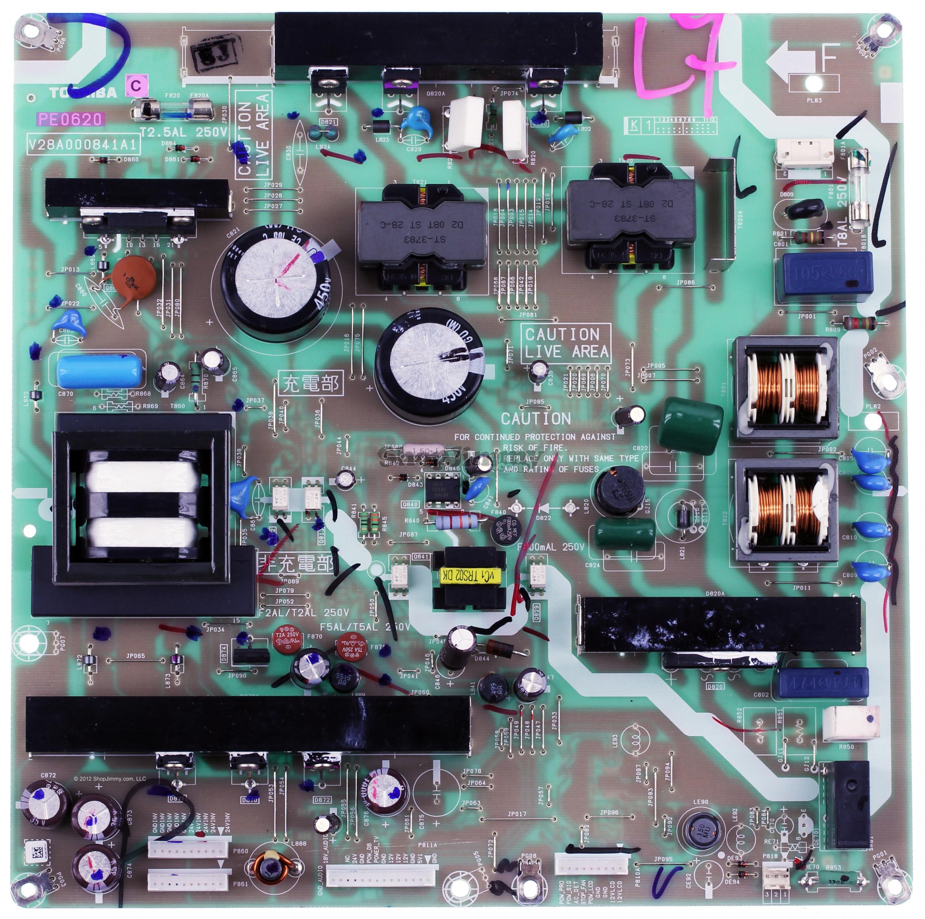

        Toshiba 75013066 (PE0620C) Power Supply for 42XV545U
        http://www.shopjimmy.com/toshiba-750...pply-unit.htm#
        I will have to download the service manual and see what test points you will need to test.
        The power supply circuits are more likely to use Active High to run on the circuit, but you must remove the wires going back to the main board first before forcing on using resistors otherwise you can damage the circuits on the main board.
        BTW, did you see if the cooling fan even try to come on or not?
        Pictures provided by shopjimmy

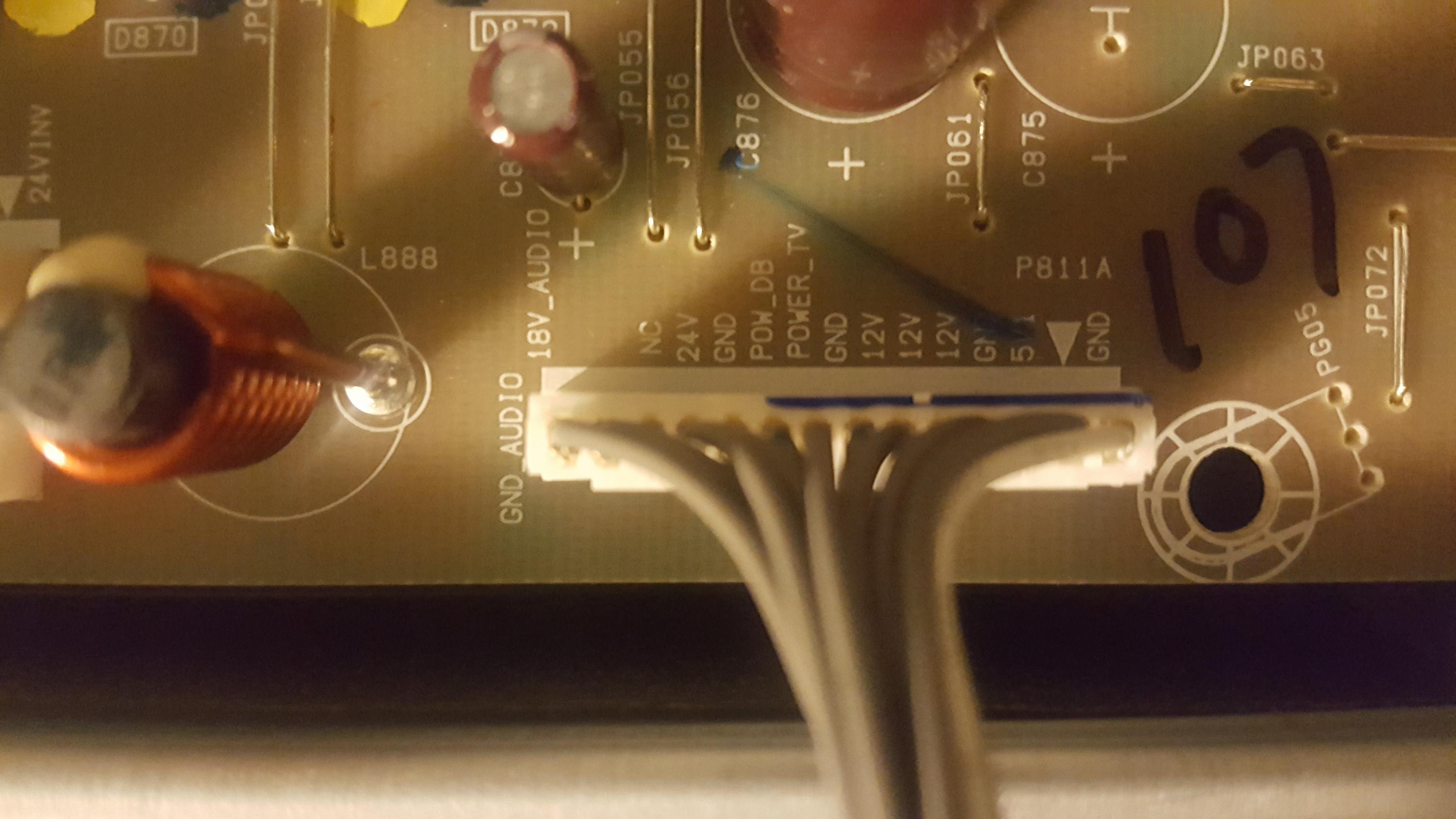

                    Hello.

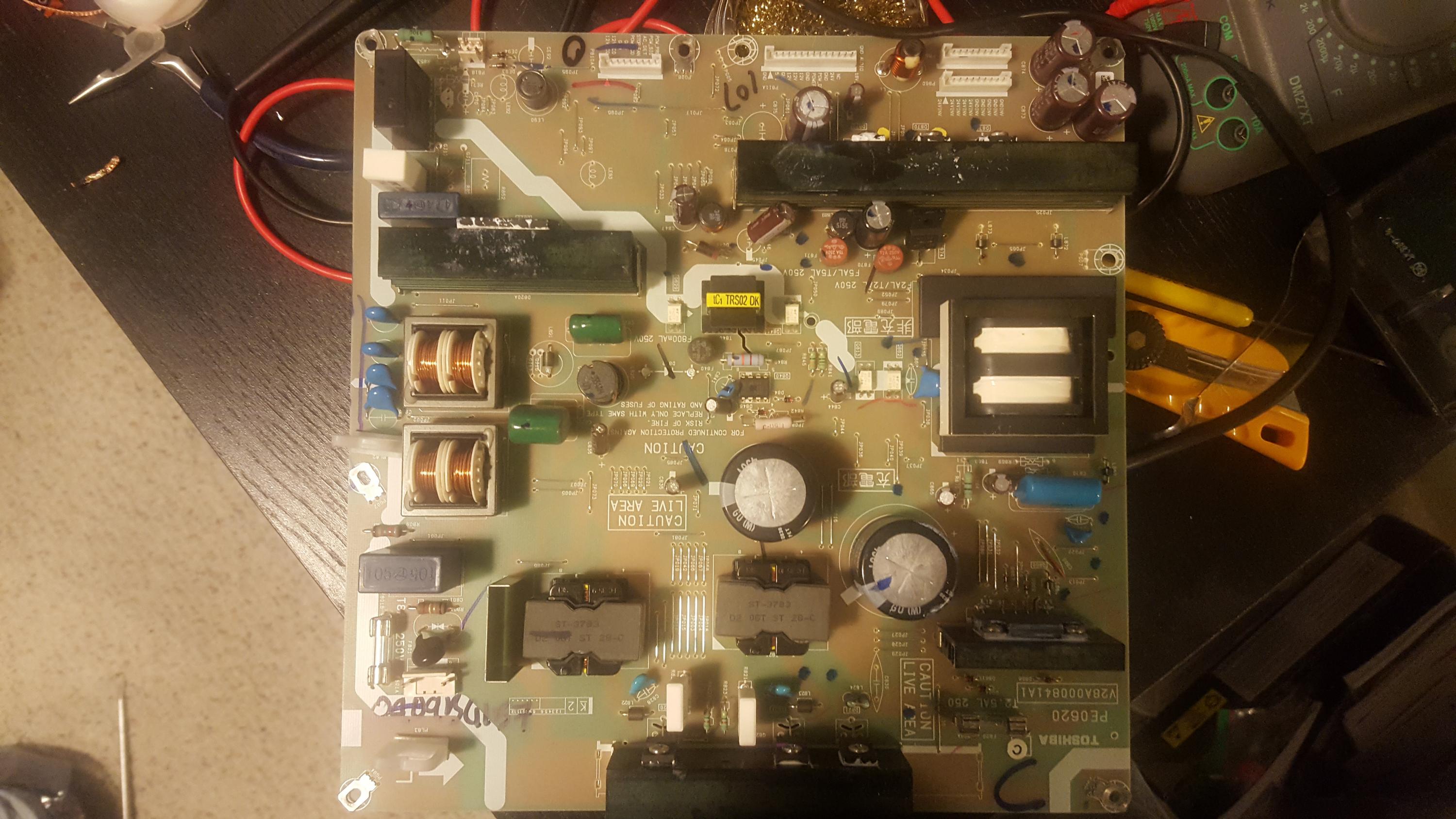

                    I took another look at the power supply in this TV and I've noticed a few oddities.
                    The 5V1 pin on connector P811A is providing a steady 5V, I've used the schematics that budm posted to determine that is the standbye voltage, however several of the other pins on P811A are acting strangely.
                    The Power_TV pin has a steady 3.18V on it
                    Pow_DB is usually 0V put every few seconds it jumps to 4.5V then quickly goes back to 0V.
                    The 12V pins start at 3.79V and over a few seconds fall to 2.2V before jumping to 3.79V again.
                    The fact that several of the pins have voltages which are bouncing around suggests to me that something is still very wrong with the power supply but I don't know what.
                    I tried to take Moreno83's advice and check the voltages on the voltage regulators but found that what I thought were voltage regulars actually aren't, they are schottky diode arrays they have part numbers of RB215T and FMW24L (D870, D871 and D872) on the schematic. I don't see any voltage regulars on this board.
                    I've attached some screenshots of the diode arrays and P811A again.
                    Does anybody have any thoughts? I'm enjoying working through this puzzle, and learning lots.
                    Craig.
                    • R_J
                      • Jun 2012
                      • 9624
                      Check the round red fuses (T*A 250V) *= amperage F871 is for +12 volts
                      Do you have +18 volts on pin 13 or +24 volts on pin 11 of that connector?

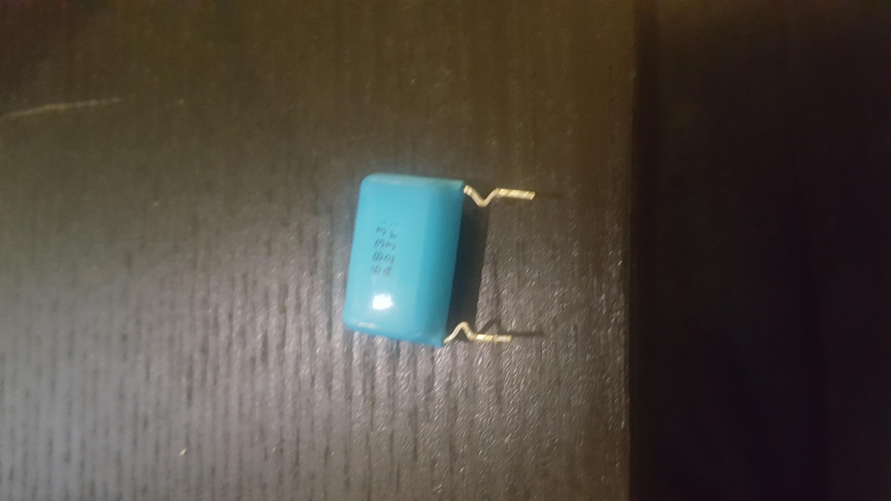

                          I wonder if C870 is ok and not open? It's not a square white cap is it?

                            I will check C870 tonight. It is a large blue boxy one with a rounded top. It's not the usual electrolytic can style.
                            Thank you for the response.
                            • lowteq
                              • Mar 2013
                              • 27
                              Hello
                              I removed C870 and tested it.
                              It's capacitance is correct according the the schematic. It measured 0.70uF, the schematic said 0.068uF.
                              However it does appear to be open. I tried to measure it's resistance and it registered as Open Line. Normally I would expect the resistance of a capacitor to be 0 then climb up to infinity, however I've never measured a capacitor like this before. Does this mean that capacitor is bad?
                              I've attached a picture of it. I know it's 0.068uF and 630V, however I'm not sure what sort of capacitor it is. Does anybody know?
                                Cap is fine.
                                Capacitor should show open circuit, especially the film cap. Ideal cap will have infinite resistance. Capacitor blocks DC but passes AC.

                                  It was just a thought, those type are usually fine its those square white ones that usually go bad
