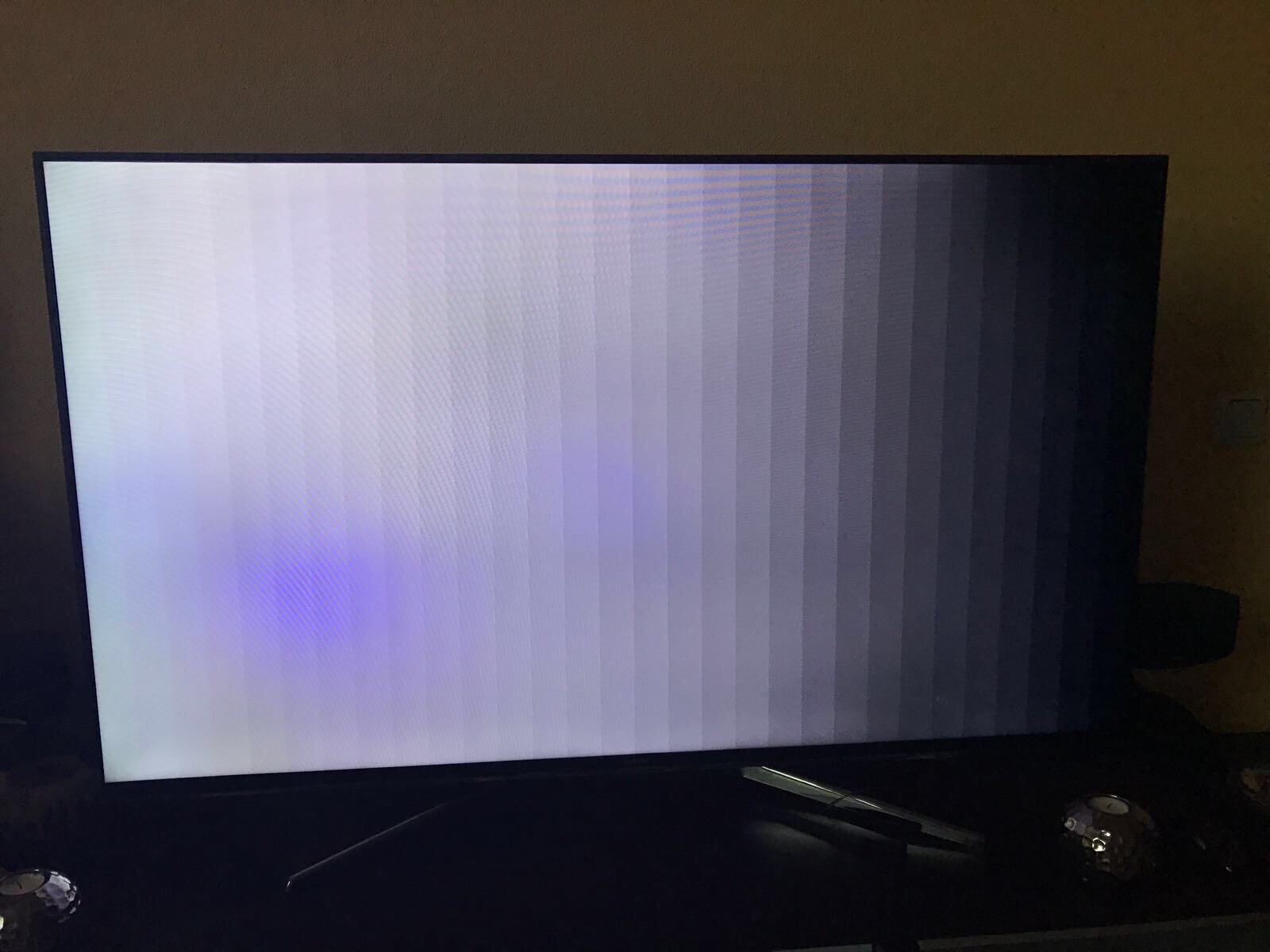

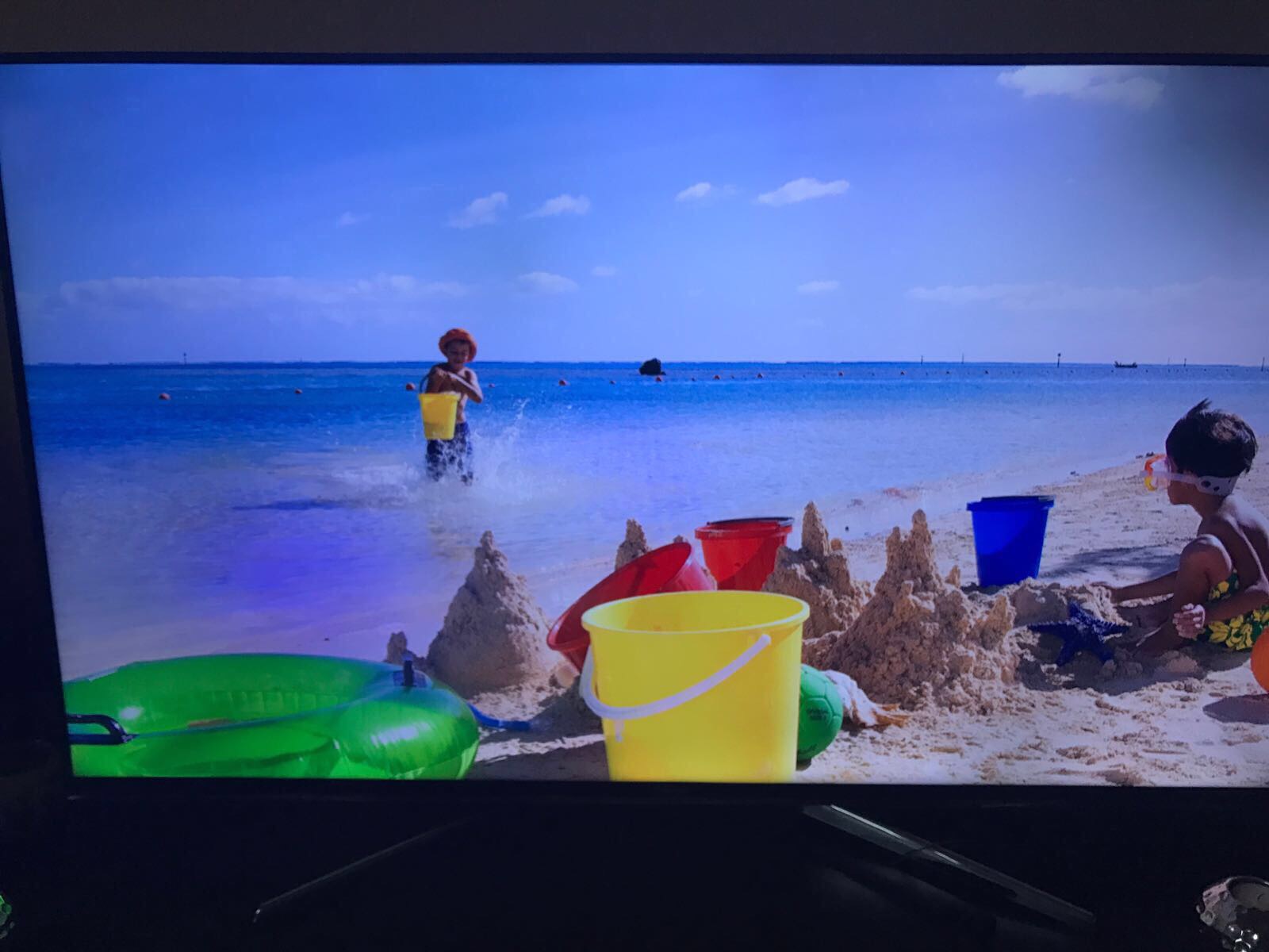

    Hi everybody,
    I was wondering if anyone could help me with this set,
    There is a black and purple spot on the tv, as it warms up it gets worse.
    Any idea??

    Re: Samsung UE55h6640 purple and black color artifacts
    Hi, Try it for the second time, Is there anybody who could give me a hint as where to look in this TV set. Purple and black spots on the screen...,
      May be a problem with diffuser film behind panel. Is that a dark spot in right hand corner?
        Thanks for the answer,
        No that
        's a bit purple, but now there are more spots on the screen, black in the upper right corner.
        After a while they vanish a little bit, but I have no idea as where to look.
            could try disconnecting one side of the t-con ribbon cables at a time and seeing if it gives you a clear pic.
