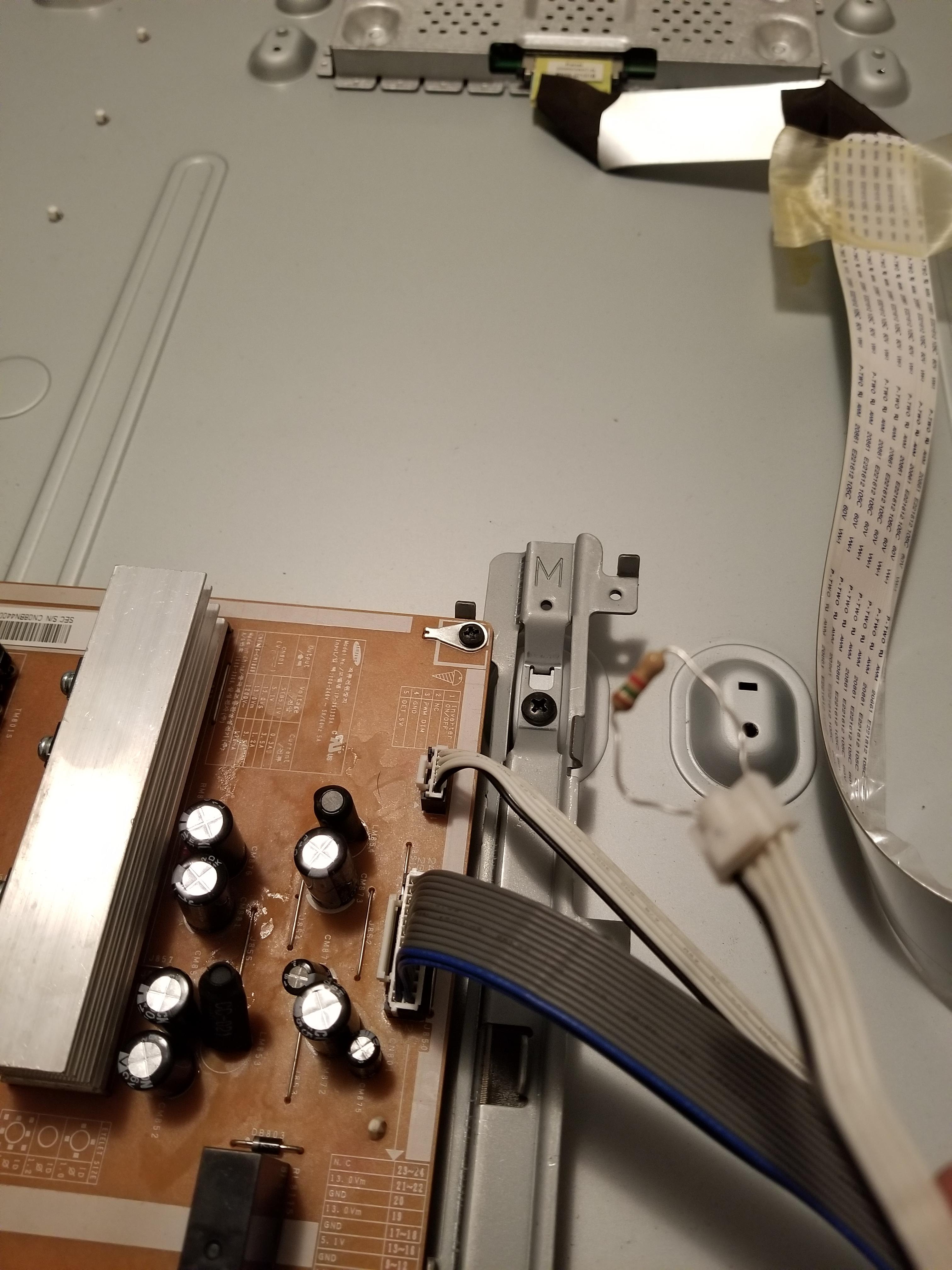

                    Re: Samsung LN52A550P3FX2A, blinking red light in front. No backlight.
                    disconnect the cable to the main board. i remove it at the main end, then use the end of that loom to place 1 resistor between stby and the ps/on pin.
                    on (what looks like cn803, in your pic), place the other resistor between inverter on/off pin and any of the active 5v lines. back lights should come on, but without any pic since the main is now disconnected.
                    you wont need to press the power button with the resistors in place, it will power in automatically when you plug it back in.

                      So I tried what you suggested with a 15kohm resistor and the backlight still didnt come on. I did notice a very faint squeaking coming from the 'HOT' side of the power board that I normally don't get. I made sure the resistor made good contact with the connector and even tried to unplug and replug the power back in. No success. What does this tell me about what steps I should take next?
                          have you got a resistor closer to 1k?
                          that first resistor should turn the ps on. are your other output voltages there?
                          if they are, then add another 1k resistor between 5v and bl/on.
                            I'm a dolt. The resistor in that picture is actually 1.5kohm, not 15.
                            anyway, I tried a 15 ohm resistor in the same configuration and I still didn't get a backlight.
                                  yours in marked inv on/off.
                                  this is the inverter on control
                                    AHA. After connecting the 1.5kohm resistor to INVERTER ON/OFF and DET_5V the backlight came on for 5 seconds then a *click* and the backlight went off for approximately 15 seconds.... then it came back on for 5 seconds... then off, and on and off and on.
                                    It doesn't stay on solidly, but it's good to know that the backlight at least works.
                                    I hope this sheds some light on what direction I can take on the repair. Thanks!
