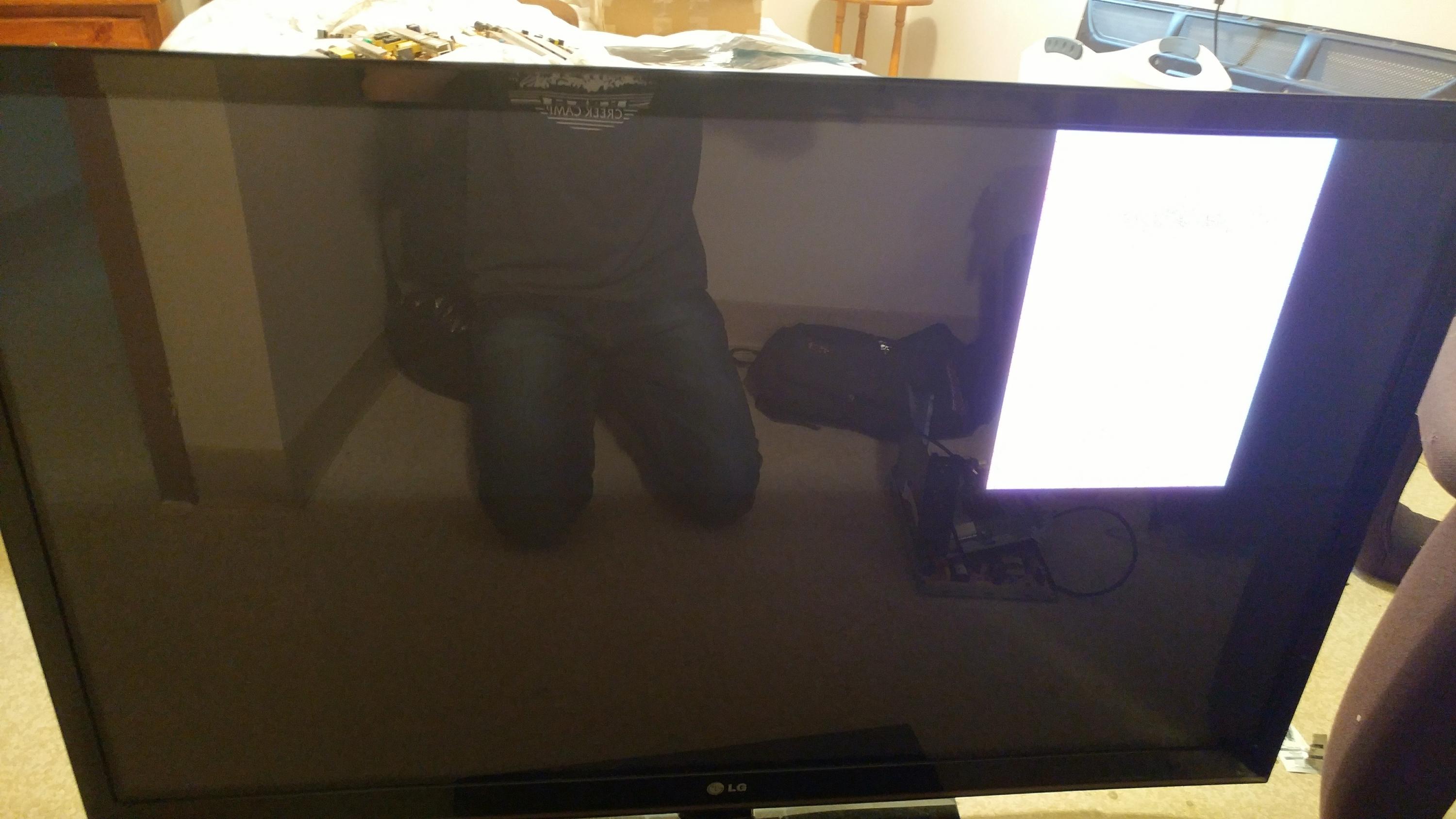

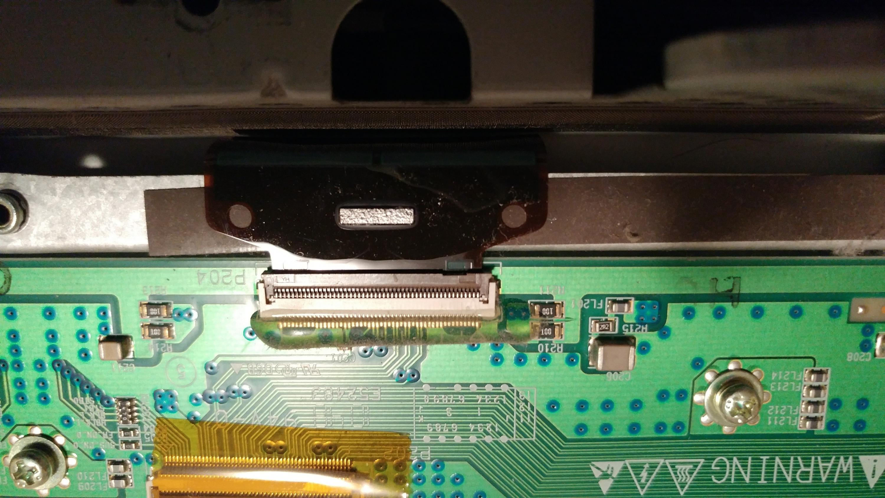

    Need to know if there is damage to this ribbon cable. Ive never seen what a damged on looks like and if these ribbons are repairable.
    Re: Defective chip on ribbon cables
    It does look as though the chip has been cooked. If it has been then there's no cost effective repair.

        If it is cooked then I don't think there is anything you can do to save the panel. From the picture it's hard to tell what has happened to them. It could be caused by water ingress if the screen has been wiped down with a too damp a cloth and this tends to affect the circuit boards located at the bottom of the set. If this is a plasma set and these are the boards at the bottom of the set then the chips (COF) can fry if the heatsink is not fitted in place when the set is run.

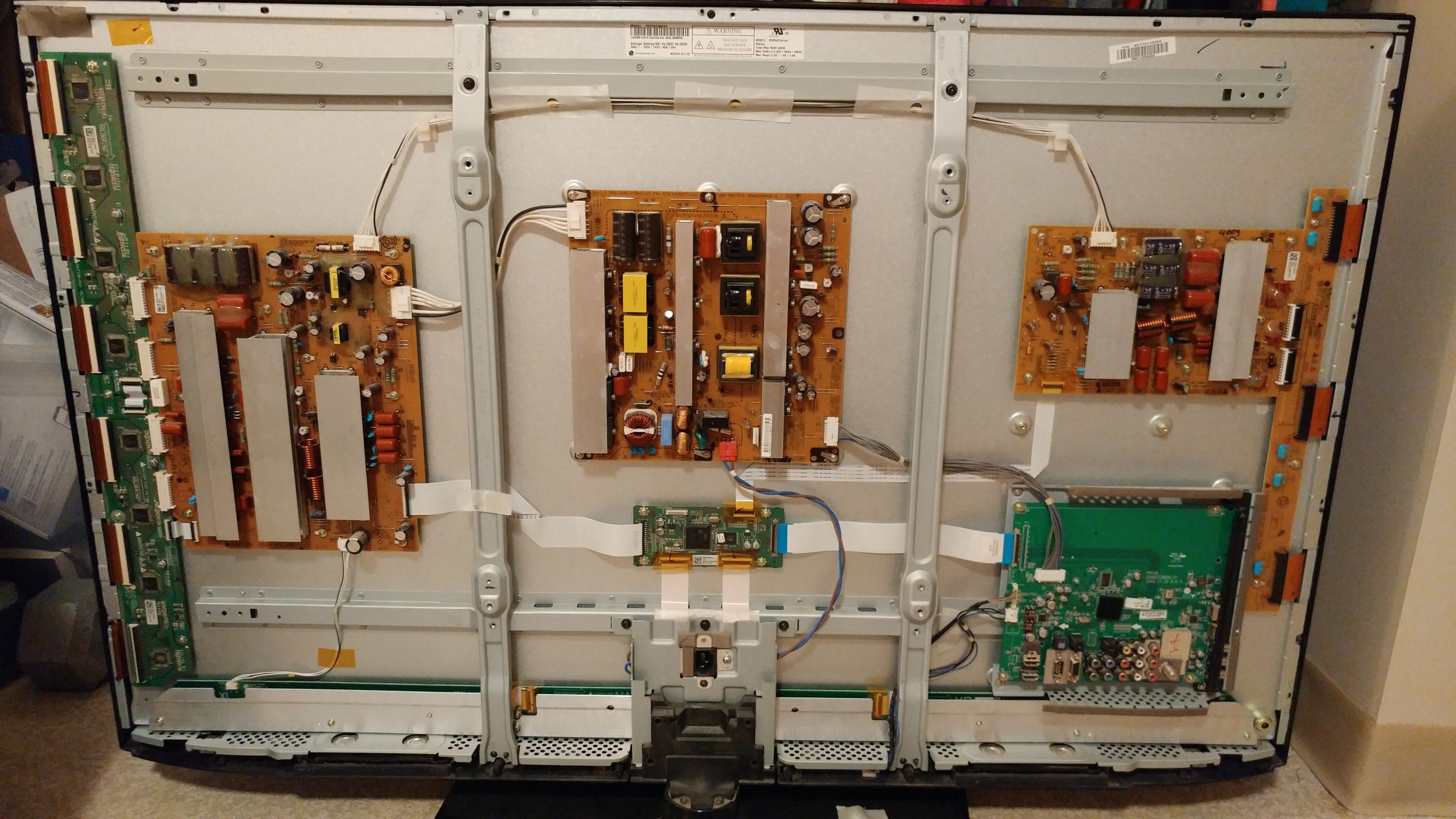

        Do you have a photo of the complete back of the set showing where this board is.
        What's the tv model number?

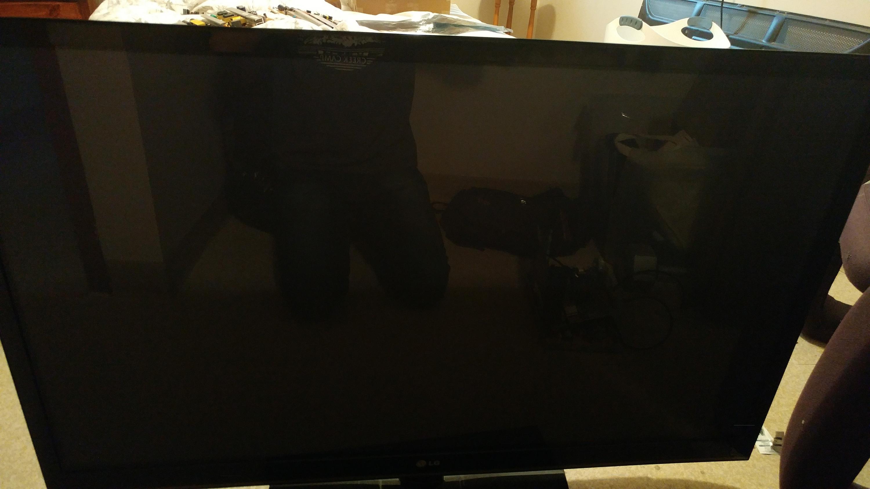

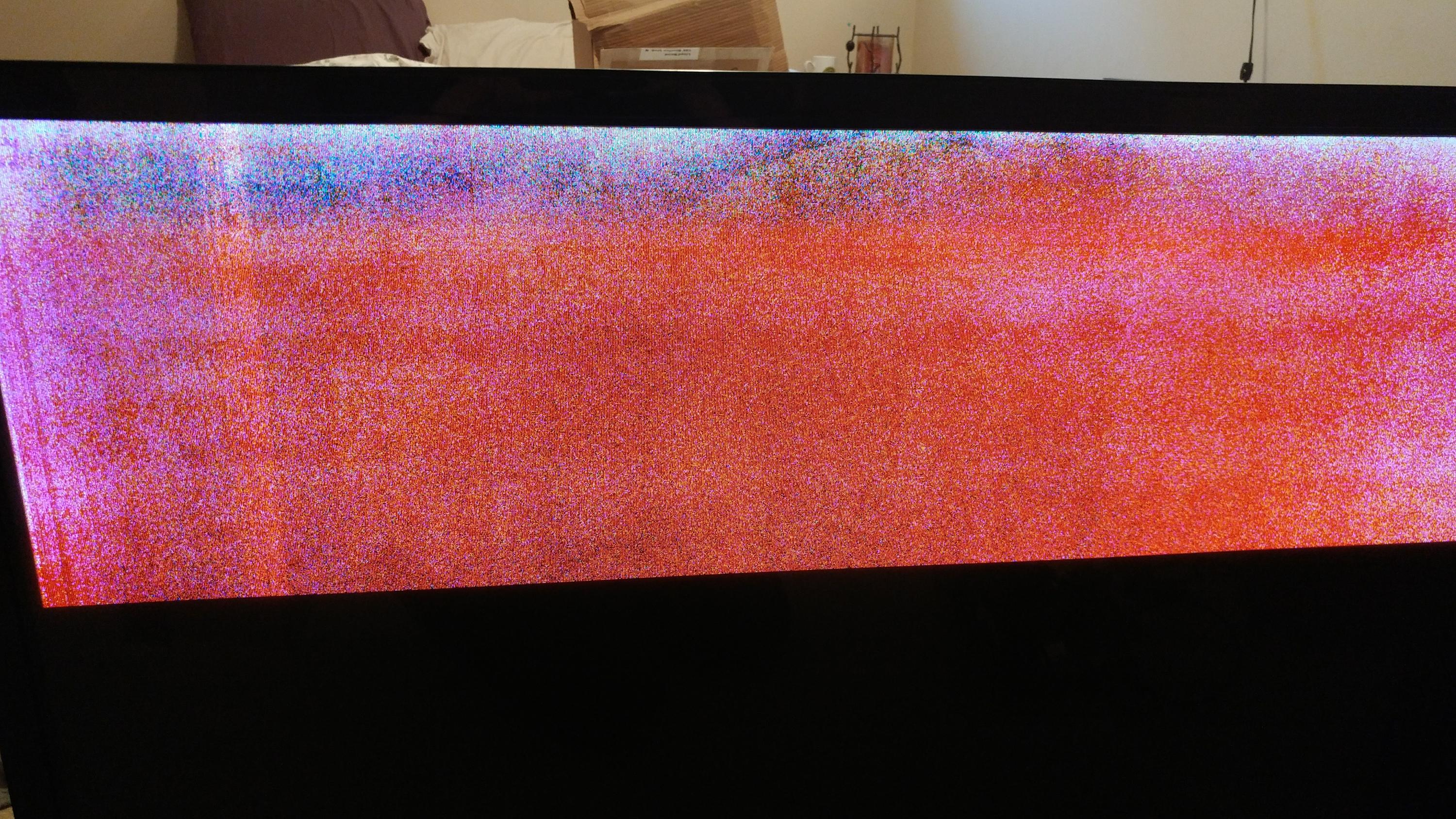

          So the horizontal lines in the top half are from damaged ribbon chips?? And when tv starts up im left with a square of stic that alternates throug the top hal bouncing back and forth. Im waiting for. Ysus buffer board that will be here monday. How do i test the ribbons to see if anymore are damaged and how do i replace them

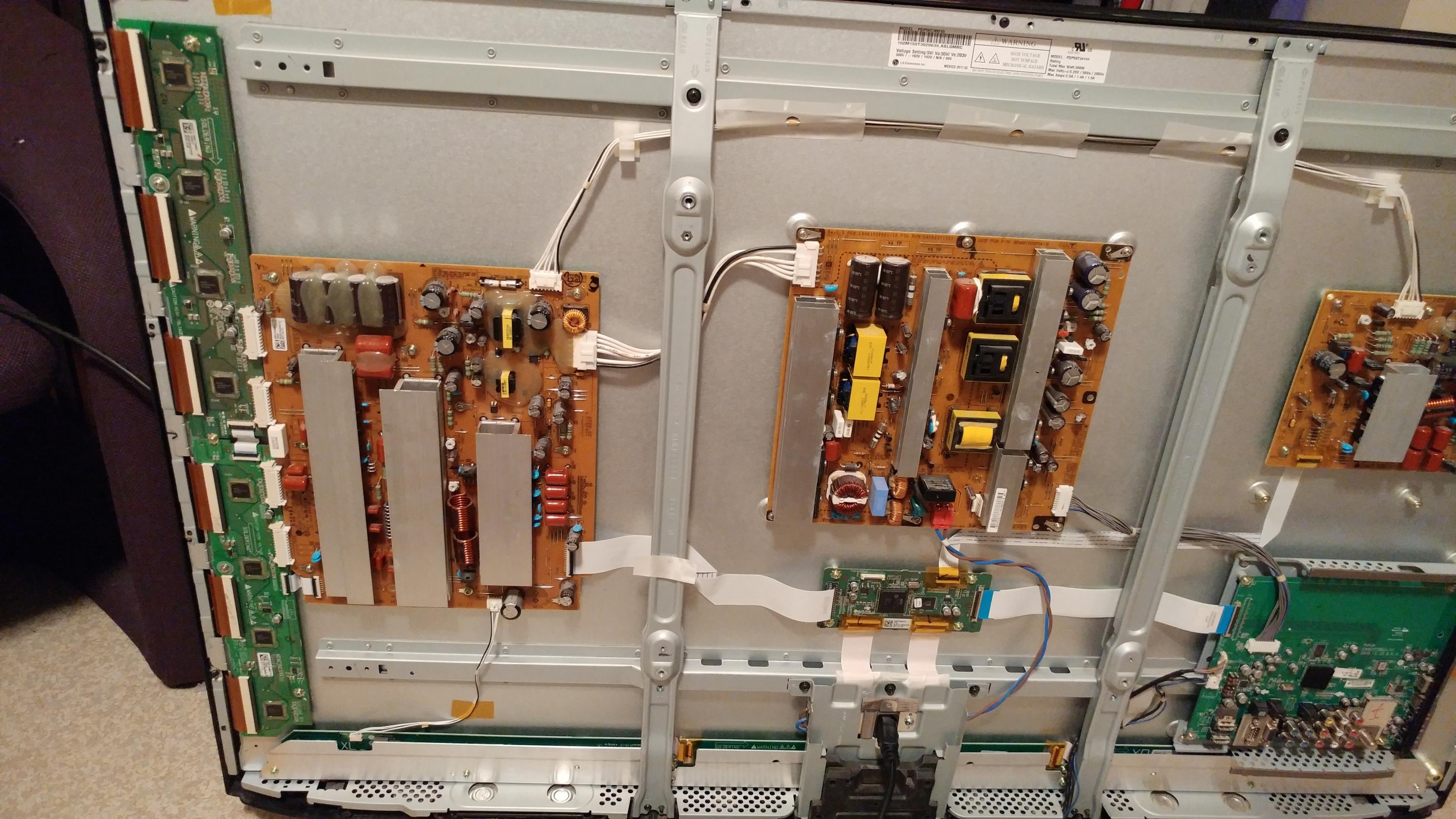

                What circuit board is shown in post #1. Is it the long circuit board running across the bottom?
                  Yes XYZ buffer boards under the heat sink

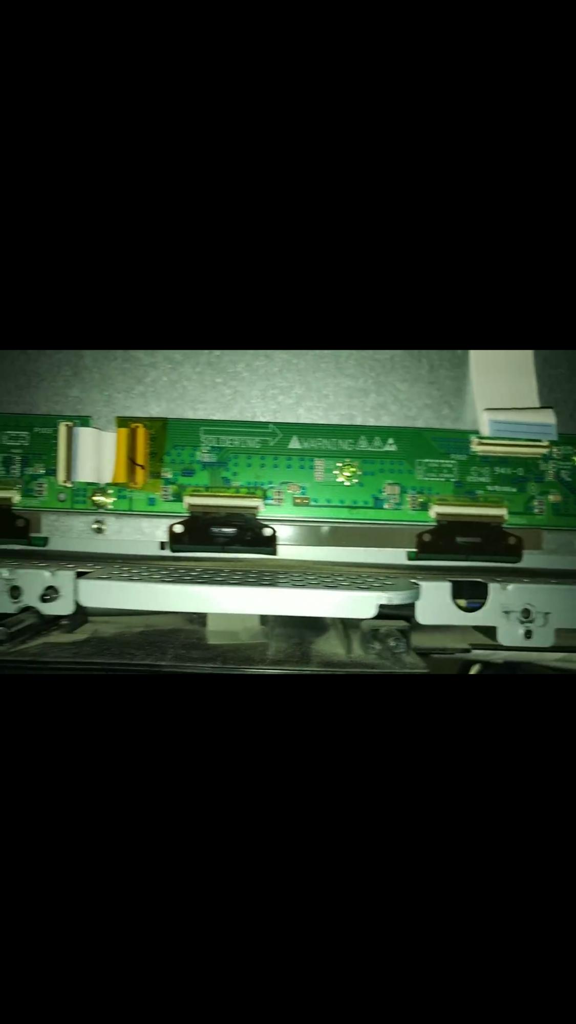

                        Then I suspect they may be OK (the white uneven look on the COF chip in post #1 could be heatsink compound) since photo 2 shows a full width image even if it is static. If one of those COF chips were damaged you would have a blank bar running top to bottom as in photo #3.
                        Don't run the set without the heatsink back in place or you will damage the IC's on the ribbons and the set will be scrap.
                        The lower Y buffer section appears not to be working (half picture missing) so although you said you have replaced it I would check it for short circuit buffers. There are plenty of Youtube video's showing you how to check them for short circuit.
                        The reddish picture could be a problem with the Xsus board. I note that when the coils on the X board are not well soldered it tends to give a pinkish picture.
                        Have you measured and compared the voltages with those given on the label on the rear of the panel. VS, VA, Vsc, Ve etc

                          it's nearly impossible to replace a 'x' buffer chip,even if it's a 1366x768 plasma,which generally has 16 buffers,the math is > 1366/16x3=256 microscopic wires for each buffer,times 3 because red/green and blue pixels,if it's a full HD it's even worse,360 wires,it's just not possible the solder would just crack and short itself.
                          try unplugging each one and see which is interfering with the image,one failed buffer can mess up the output from all of them,remember to always put back the heatsink before powering on.

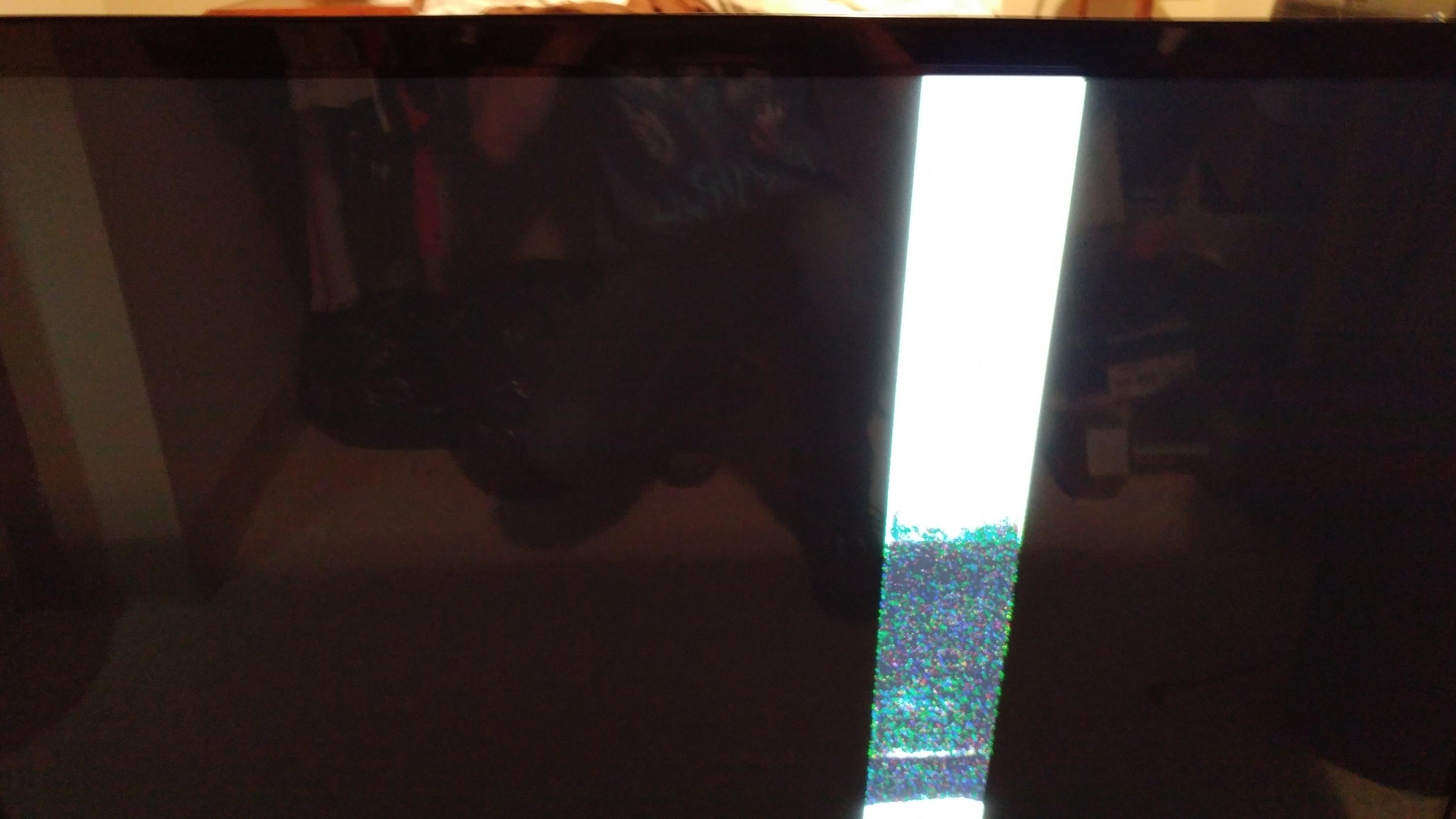

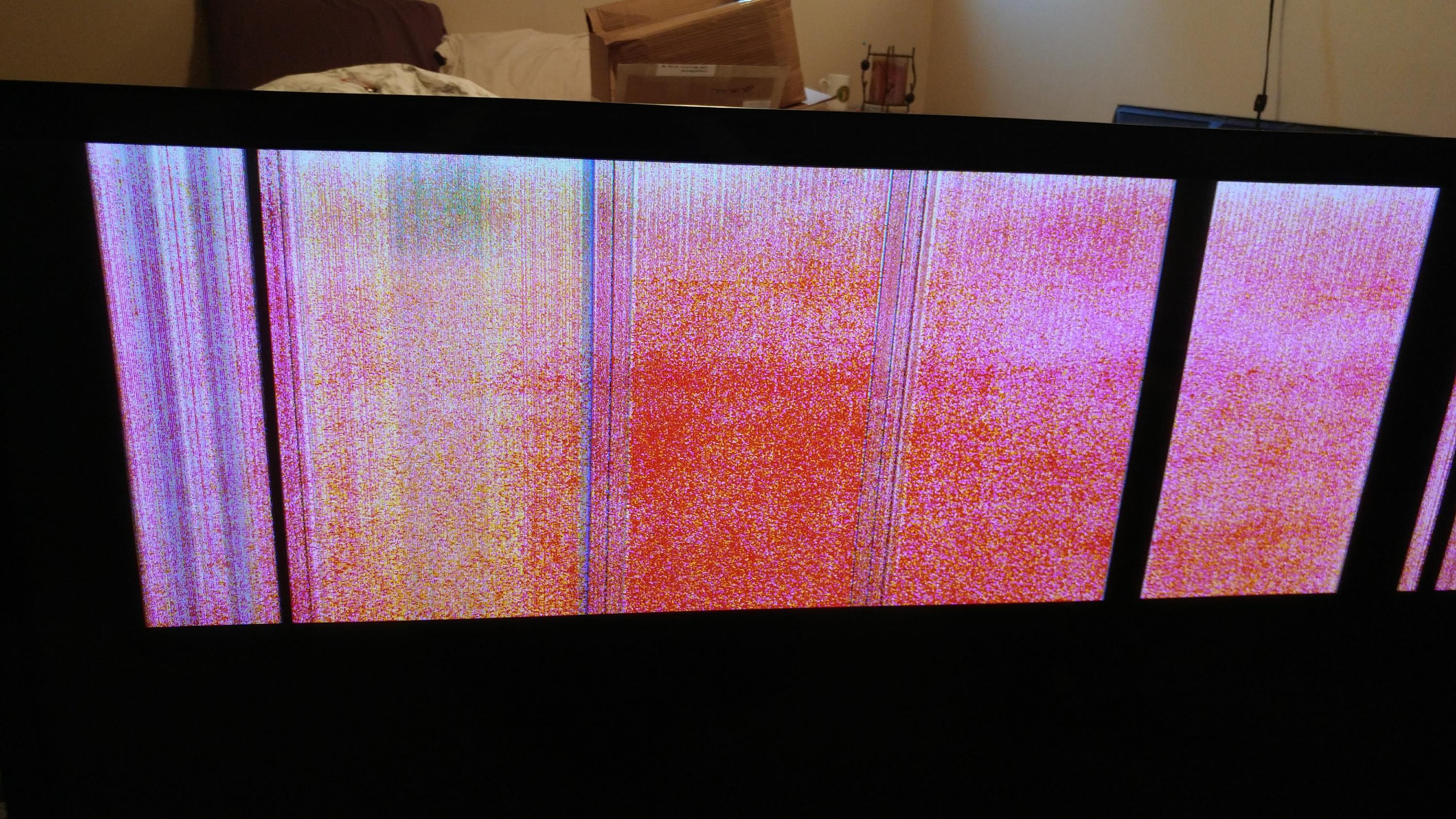

                                      Ok here we go and this is what is whats happening now...a line thru the screen good news is that its not the ribbon cable i suspected could it be another or something else. Im kinda at a loss HELP
