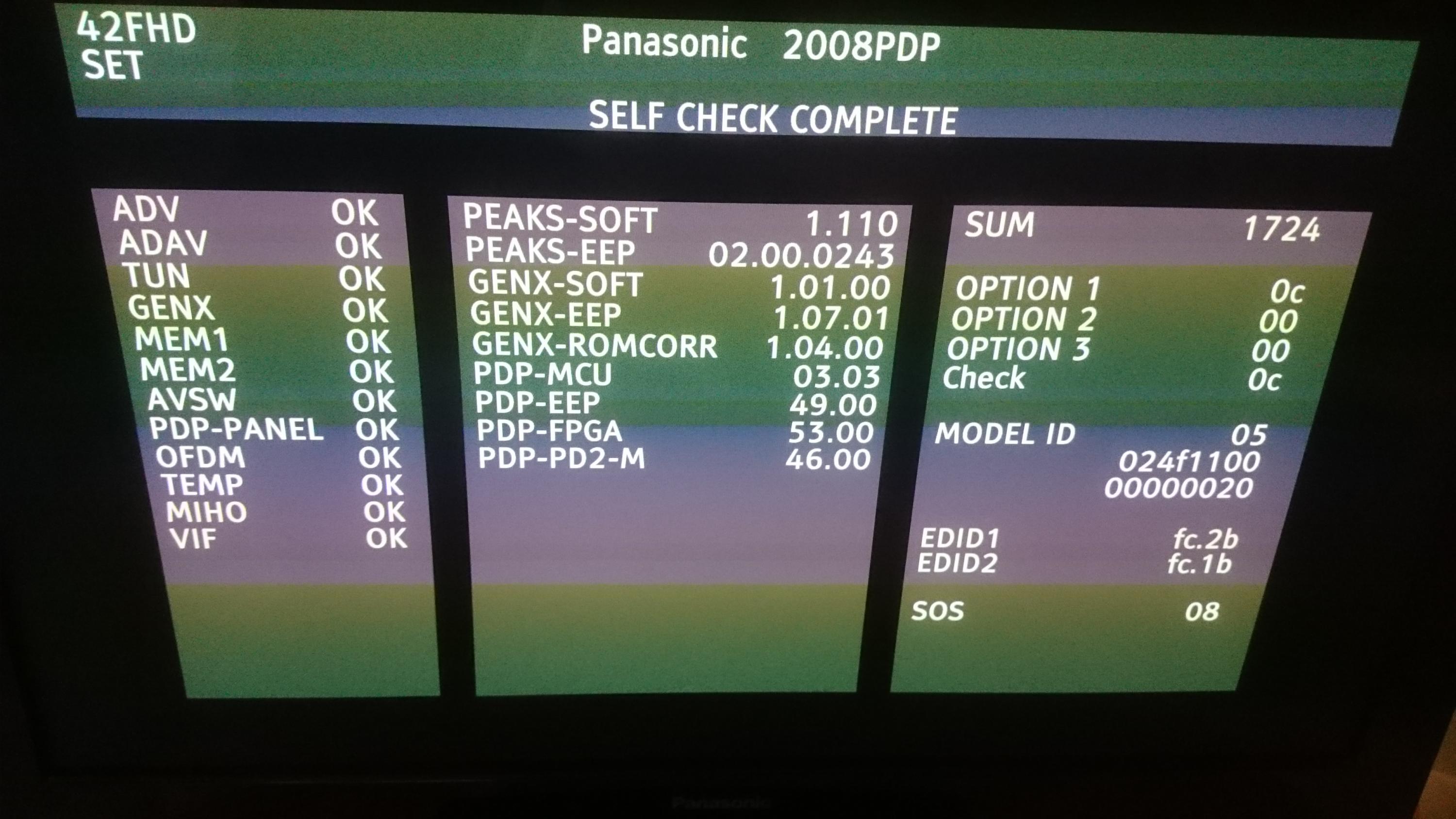

    My Panasonic experienced what probably was a power surge event. Now I can't get a picture through any of the three HDMI ports or the VGA port. TV is all digital in Norway so I don't know if the antenna input works.
    When selecting the HDMI ports, the entire screen is black except for the HDMI-label in the top left corner of the screen.
    When the VGA-port is selected the VGA-label is displayed, but there is a vertical bar of multicolored madness on the rightmost 15% of the screen.
    What I've done so far:
    - Verified all voltages on the power board
    - Checked all the fuses on the power board
    - Ran test patterns as described here
    - Tested that all user menus and service menus are working
    - Ran self test, all ok. See attached image.
    Any input on further troubleshooting is much appreciated.

    Bad mainboard. Prob had a spike on one of the ports that took the HDMI IC out.

      "Mainboard" is that the A- or D-board? How can I verify that short of exchanging the board?

        It will be the board with the inputs hdmi etc. If you get good test pattern then it will be mainboard.
