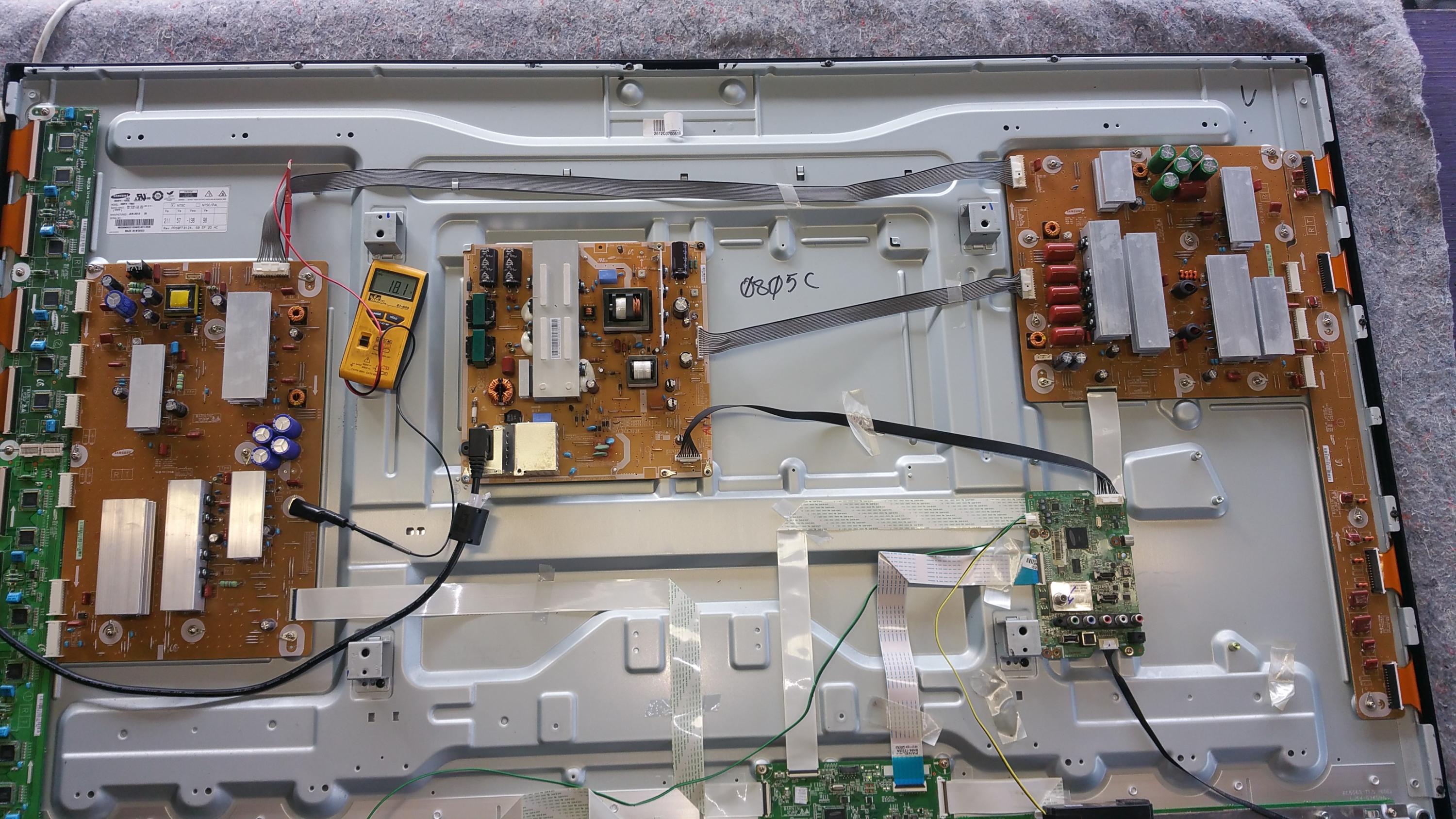

            First off, pic of entire unit attached... As you can see, the cable goes from the Power PCB to the X-SUS and then from the X-SUS to the Y-SUS..
            I am taking my reading from the X-SUS connector that goes to the Y-SUS...
            With all the cables and connectors attached, at power up VS starts out at 215V but then rapidly starts going down... Finally stops falling at around 10v
            With the Y-SUS unplugged from the X-SUS, the same thing happens.. starts out at 215V and then drops...
            With the X-SUS (and by default, the Y-SUS) is disconnected from the Power PCB and reading directly from the Power PCB, the voltage is around 1v at power up and then drops steadily from there...

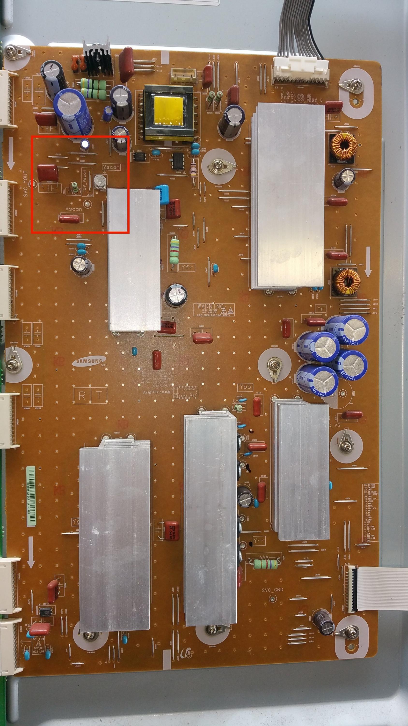

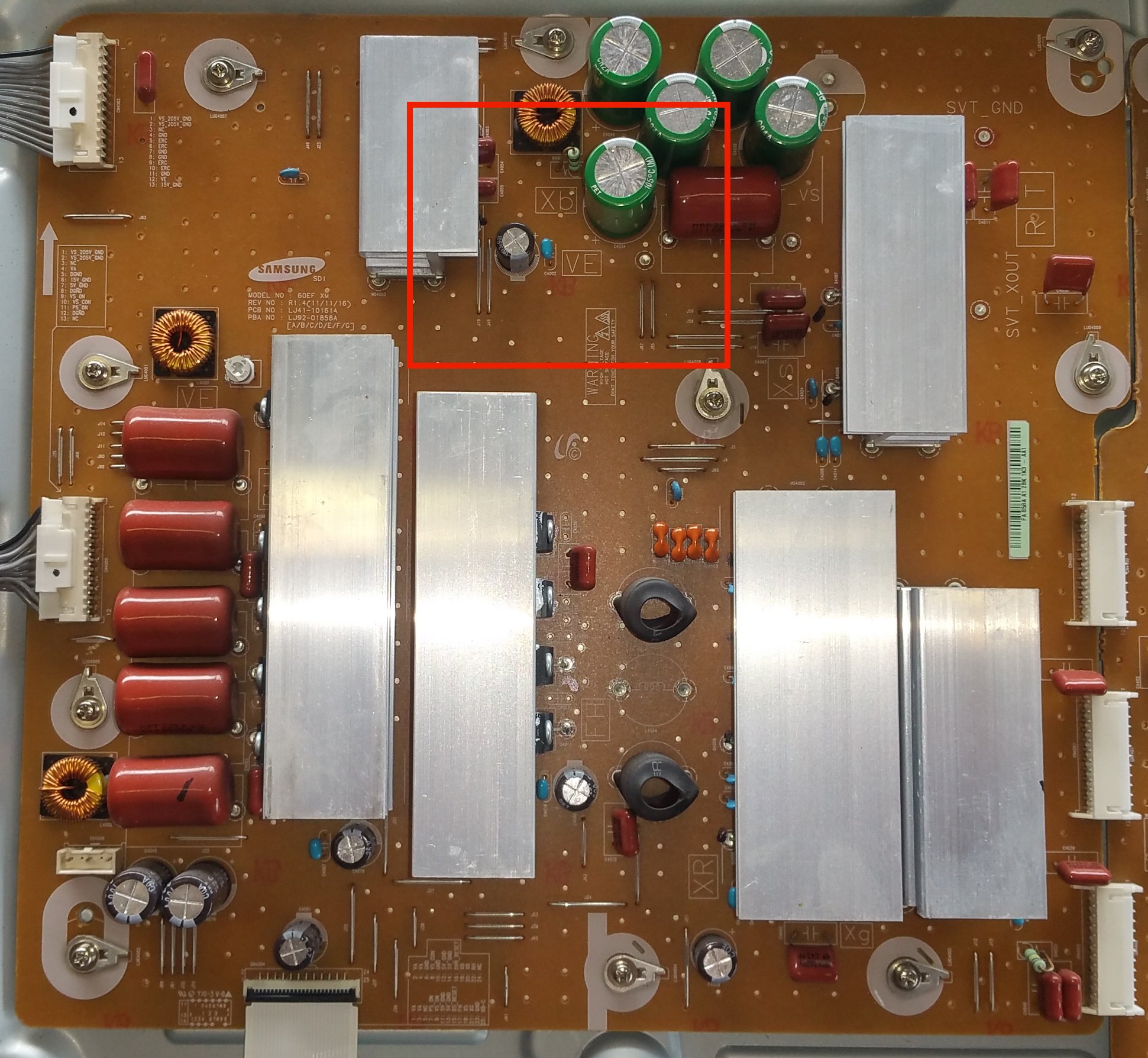

                I found the Vscan and VE areas on the Y-SUS and X-SUS, but I don't see where to actually check the voltages...

                    The silver punch with the circle round it is the test point.
                    Because the main board is shutting down vs-on you'll need to check vscan and VE quickly as they will drop away.
                    They should match your panel sticker.

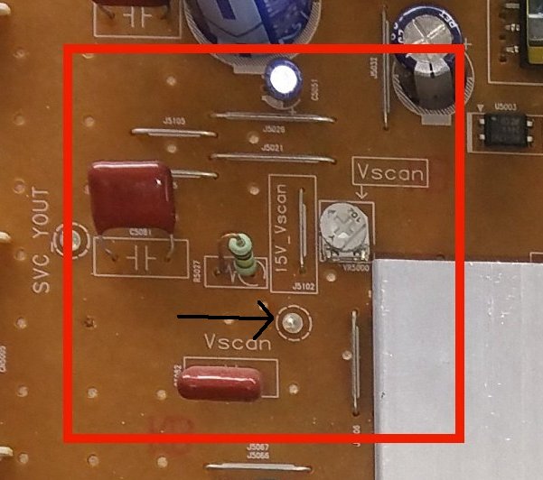

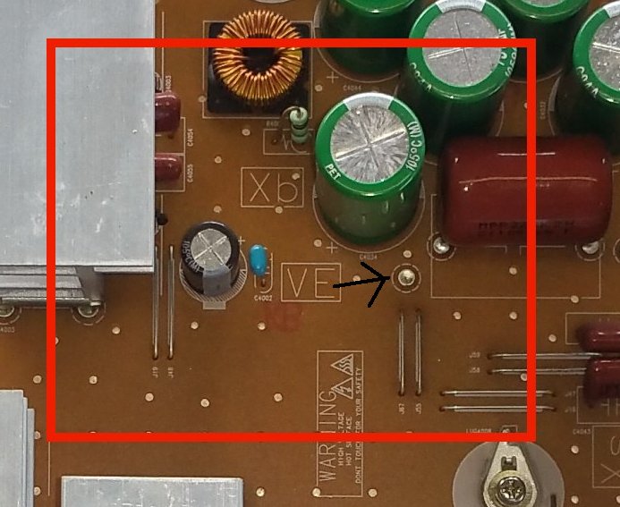

                        OK So, just to confirm, I want to check Vscan and VE where the pads are marked by arrows..
                        Don't mean to be such a wimp around hi voltage... but I have always been such a wimp around hi voltage..
                        • Michale32086
                          • Nov 2011
                          • 1453
                          Re: Samsung PN60E530A3F 60" Plasma. Power Up Samsung Tones No Display
                          Assuming those are the correct points..
                          Vscan fluctuates around -.400v
                          VE starts at around 8v then holds steady at around 11v
                          Those readings are immediately upon power going to the unit...
                              So according to your sticker VE should be 98
                              And vscan -198
                              The X-main supplies the y-sustain. So if one fails it can damage the other.
                              If you unplug the ysus does the VE go to 98?
