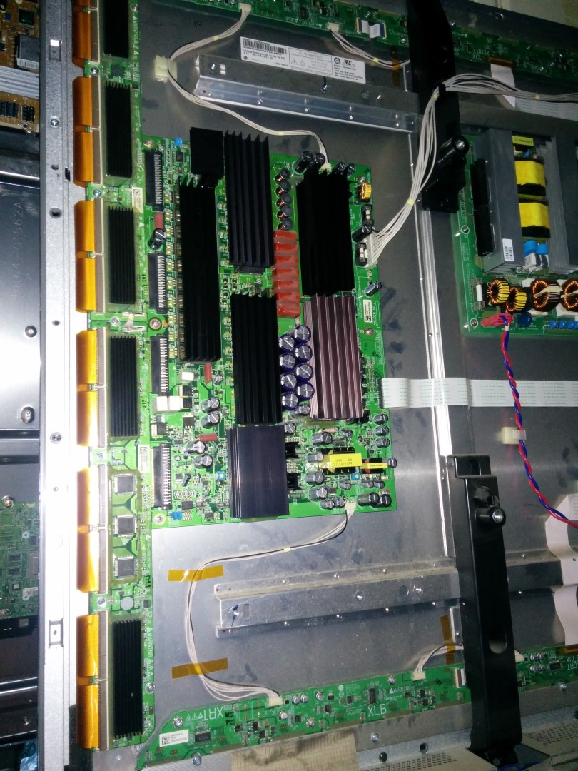

    I have 3 of these tv's,all have the exact same problem,bottom third of the screen is black.
    I'm a bit lost here,as my thoughts go to the lower buffer board as a suspect.
    But that's where the fun starts.

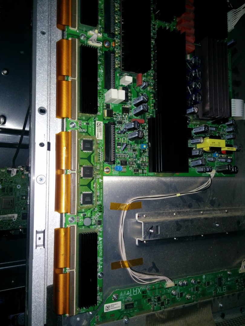

    When I follow on screen where it stops displaying,I end up halve way the middle buffer IC. (see pic#3,I marked it). As far as I figured,the data signal goes from top to bottom?
    I sacrificed one of my lower buffer boards as the donor.
    I have replaced the middle IC 3 times now,with donor IC's,as I was doubting my solder skills.But it still doesn't display the bottom third of the screen. I tried the "repaired" board on two tv's with the same result.
    Am I wrong in thinking it is the middle IC? Any one had this before?

    check for a blown surface mount resistor on the buffer board

      Hmmm,good point.Been so focused on the IC's that I never even thought about that.
      I did forget to mention that I could not measure a short from floating ground to the ribbon cable connectors.
      Will check the smd's ! thank you
