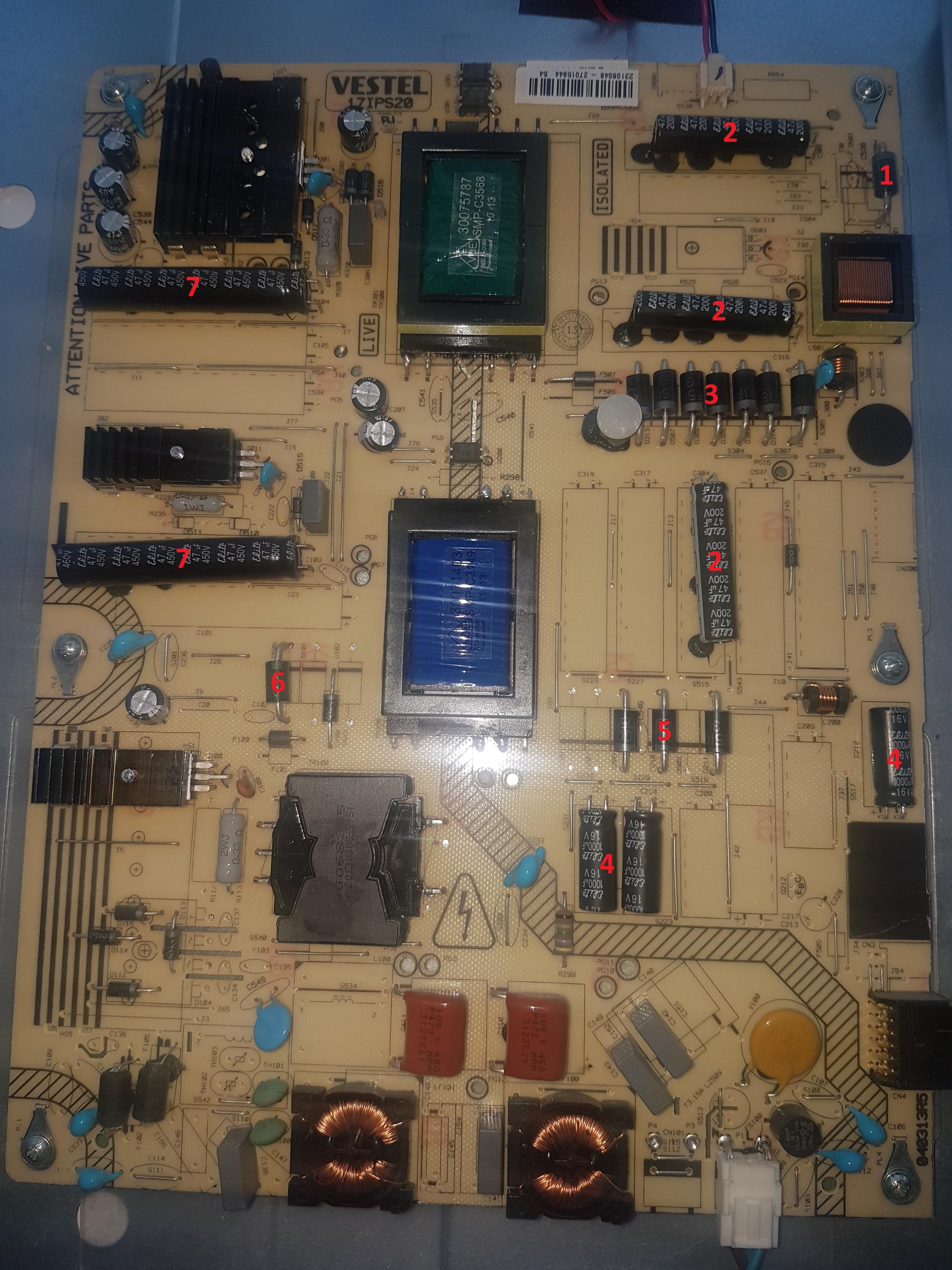

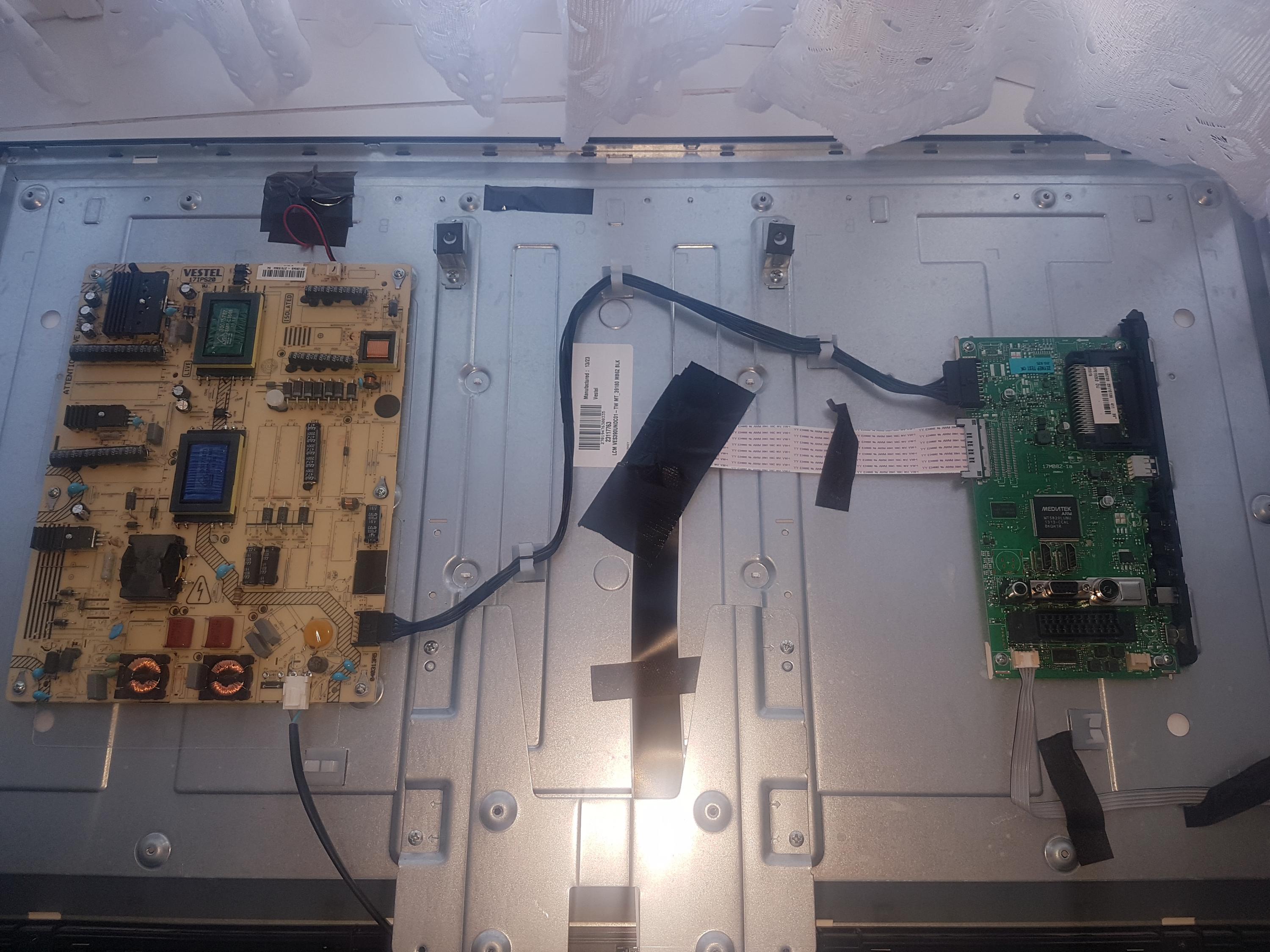

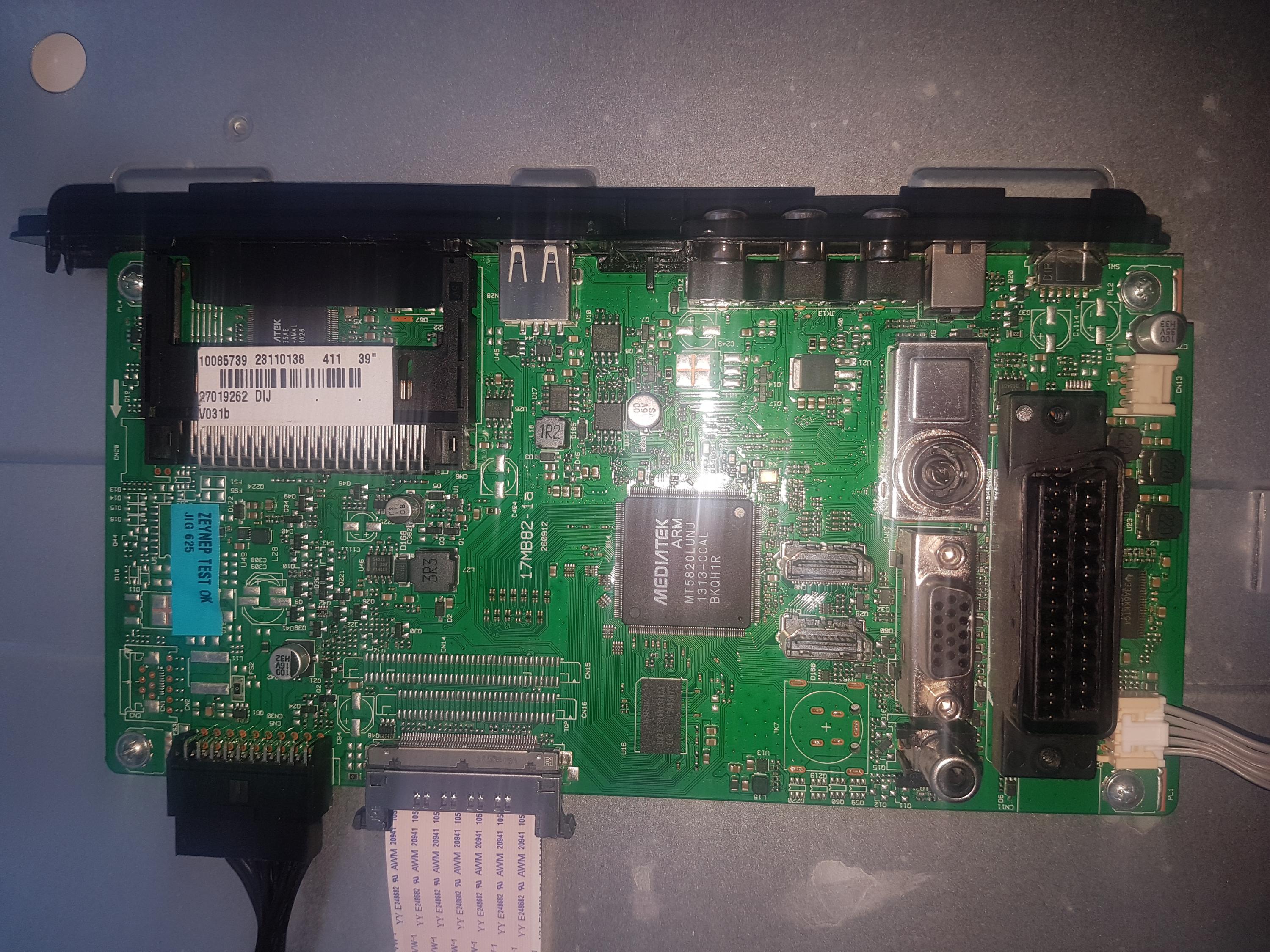

    hi guys
    original fault no no backlight found 3 shorted led`s which have been replaced now working fine except when i plug in hdmi or scart there is no standby led but if i turn on the tv with out these plugged in tv is all good then i can plug in the hdmi or scart etc
    updated firmware but still no good
    voltages across the psu seem low but are as follows numbered in PSU picture uploaded
    number 1 Diode d504 reading is : 167v
    number 2 capacitor 47uf 200 volts reading is :121.3v
    number 3 set of diodes reading is : 121.3v
    number 4 capacitor 1000uf 16 volts reading is : 11.7v
    number 5 set of three diodes reading is : 11.7v
    number 6 diode D506 reading is : 262v
    number 7 capacitor 47uf 450 volts reading is : 388v
    backlight voltage is also 166v staying steady
    THANKS
