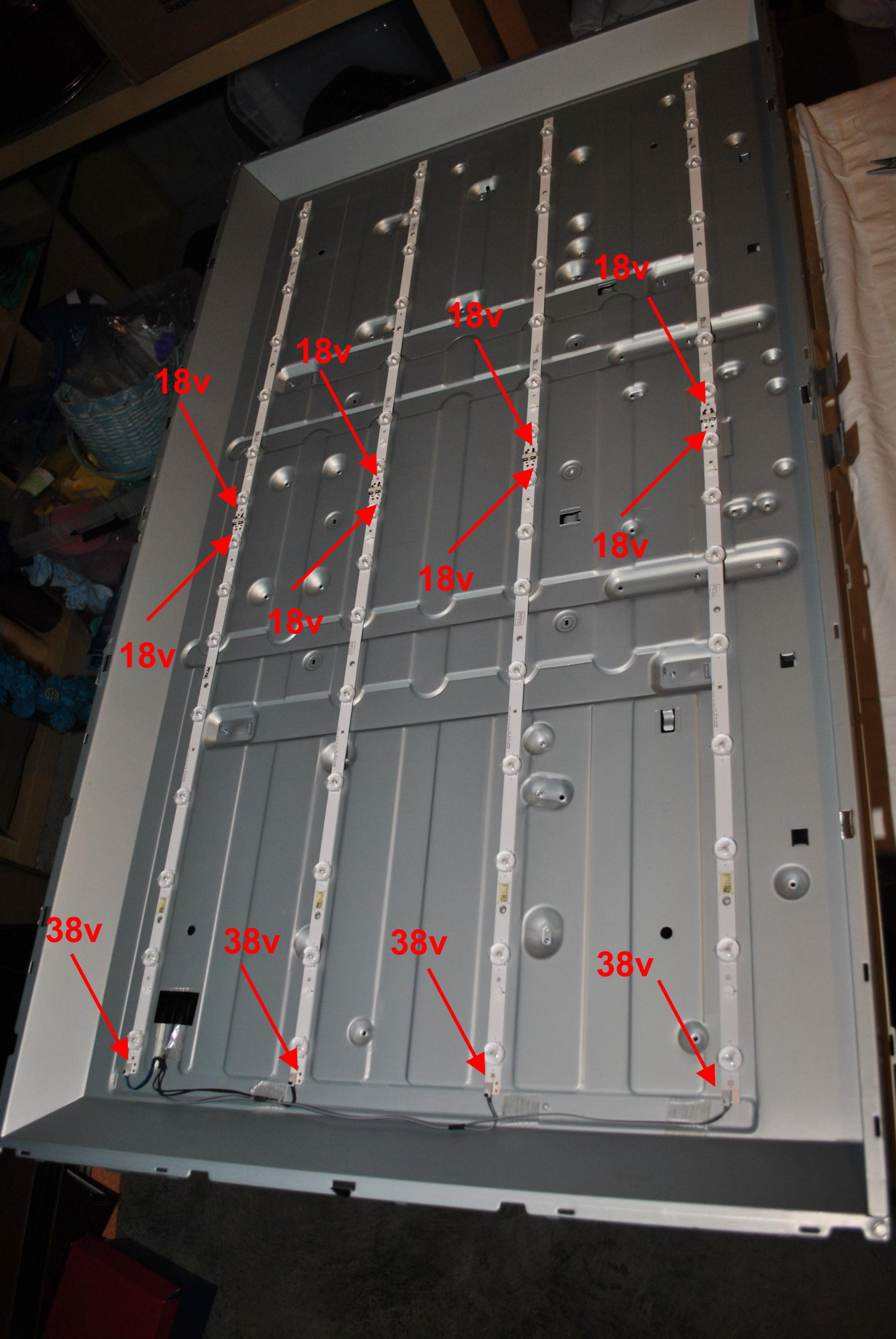

    The big blue cap is measuing 389v. Each LED strip is measuing 17v. If I measure the spot at the beginning of the strips in the area of the connection cable to the P/S board, those points measure 38v.

        I like to know how all the the strips are connected, the longer strip is connected to the shorter strip so you have 4 big long strips and 4 connectors?
        and this one "Each LED strip is measuing 17v" on all 8 strips?
        " If I measure the spot at the beginning of the strips in the area of the connection cable to the P/S board, those points measure 38v." so 38v x 4 = 152V.
        Each set of strip has 15 LEDs = 45V per set

          Here is an illustration (see attachment) to show the points I'm measuring on the strips and the associated voltage readings. Hope this helps. I really appreciate the help.

                  I just hooked everything up, P/S connected to LED, P/S connected to Main Board, Main Board connected to power button. Once I turn the TV on, the LED lights up the same as they did without connection to the Main Board (with the flicker) and the voltage readings are the exact same on all the LED strips.

                              budm, yes, still get over 300VDC if the LED string is not connected
                                #35
                                Re: Backlight Issue on Samsung LED Model UN50EH5000F (version AJ04)
                                That means the boost converter is working but some how with the load it goes down below normal Voltage

                                    May have a bad cap on boost circuit not able to keep up with load.

                                      dskall and budm, thanks very much for your help. I wasn't sure where to begin troubleshooting the voltage issue on the boost circuit so I bought a new P/S board from ShopJimmy for $35. The backlights work perfectly. So there was definitely an issue with BOTH boards (the original and the one I bought from ebay, which I was able to return). All and all I spent about $100 for new backlights and a new P/S board. Much cheaper than buying a new TV. Thanks again guys.
