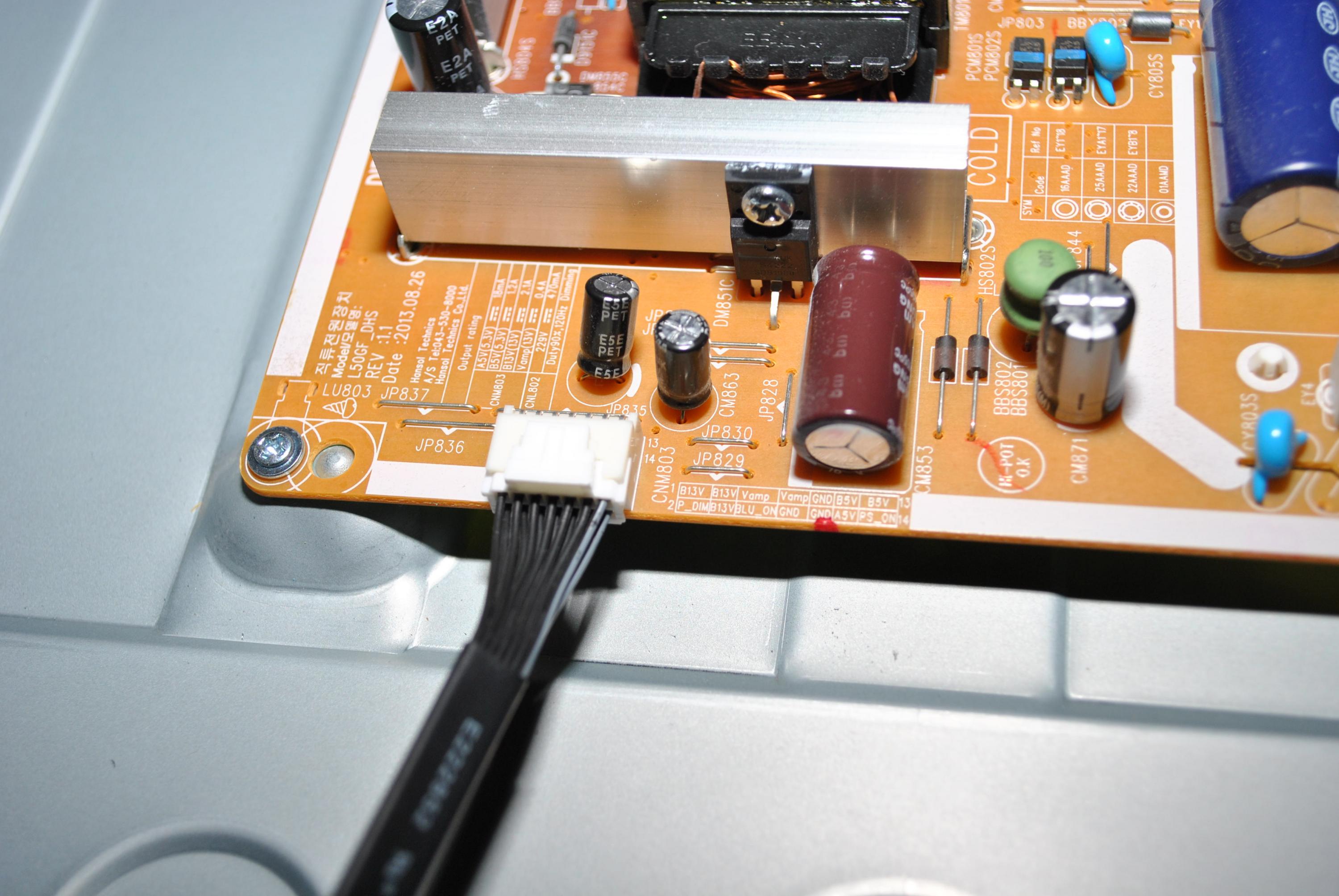

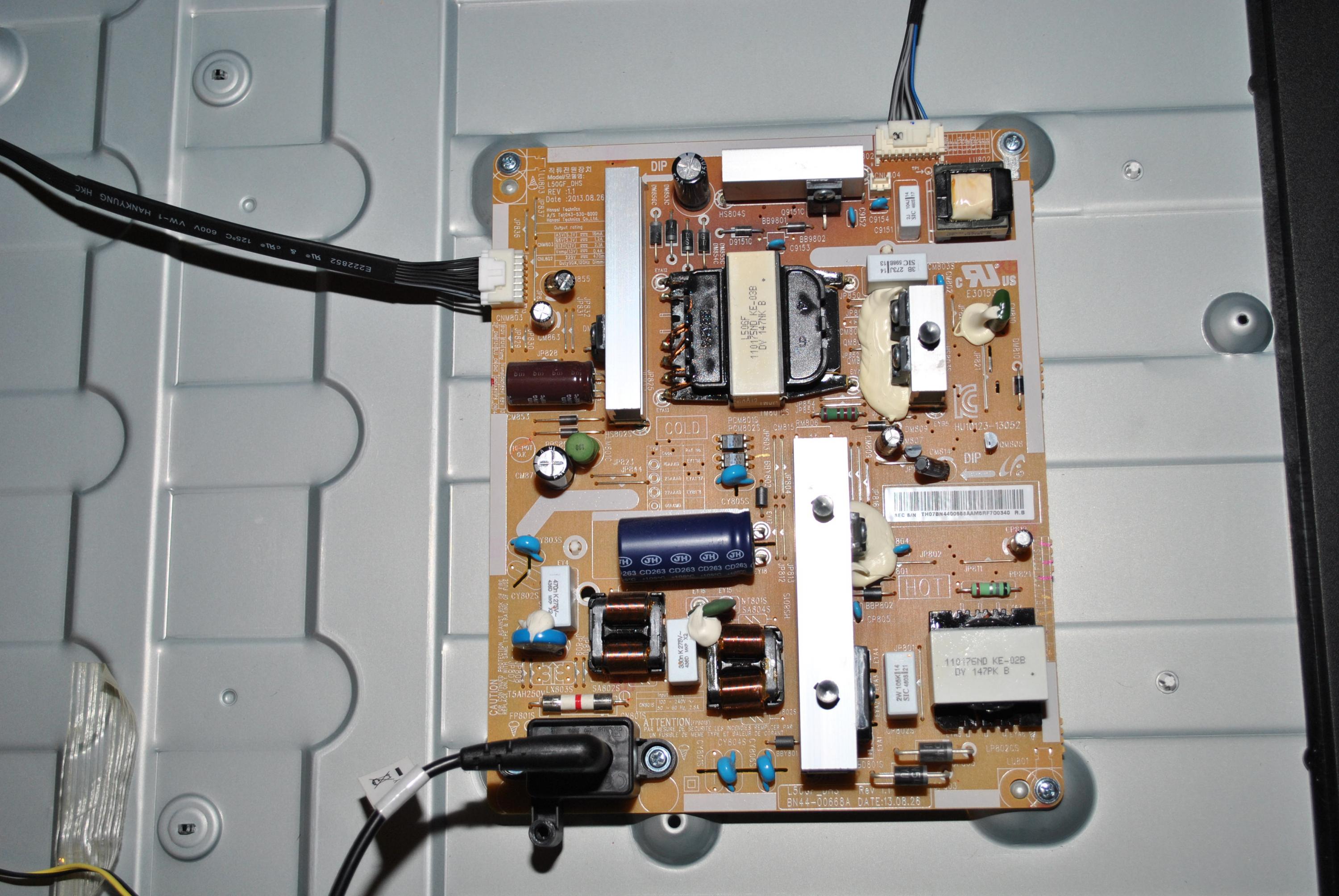

    I have a Samsung LED Model UN50EH5000F (version AJ04).
    Upon turning the unit on, the backlights quickly flash on, and then stay off. I've used a flashlight to verify there is still a picture on the screen and I can hear sound from the HDMI input.
    If I disconnect the cable from the main board (BN96-28946A) to the power supply board (BN44-00668A) the LED backlights DO NOT illuminate.
    Here are the voltage readings from the connection at CNM803 when powered ON:
    Pin 1 (B13V) = 12v
    Pin 2 (P_DIM) = 0v
    Pin 3 (B13V) = 12v
    Pin 4 (B13V) = 12v
    Pin 5 (Vamp) = 12v
    Pin 6 (BLU_ON) = 4v
    Pin 7 (Vamp) = 12v
    Pin 8 (GND) = 0v
    Pin 9 (GND) = 0v
    Pin 10 (GND) = 0v
    Pin 11 (B5V) = 5v
    Pin 12 (A5V) = 5v
    Pin 13 (B5V) = 5v
    Pin 14 (PS_ON) = 3v

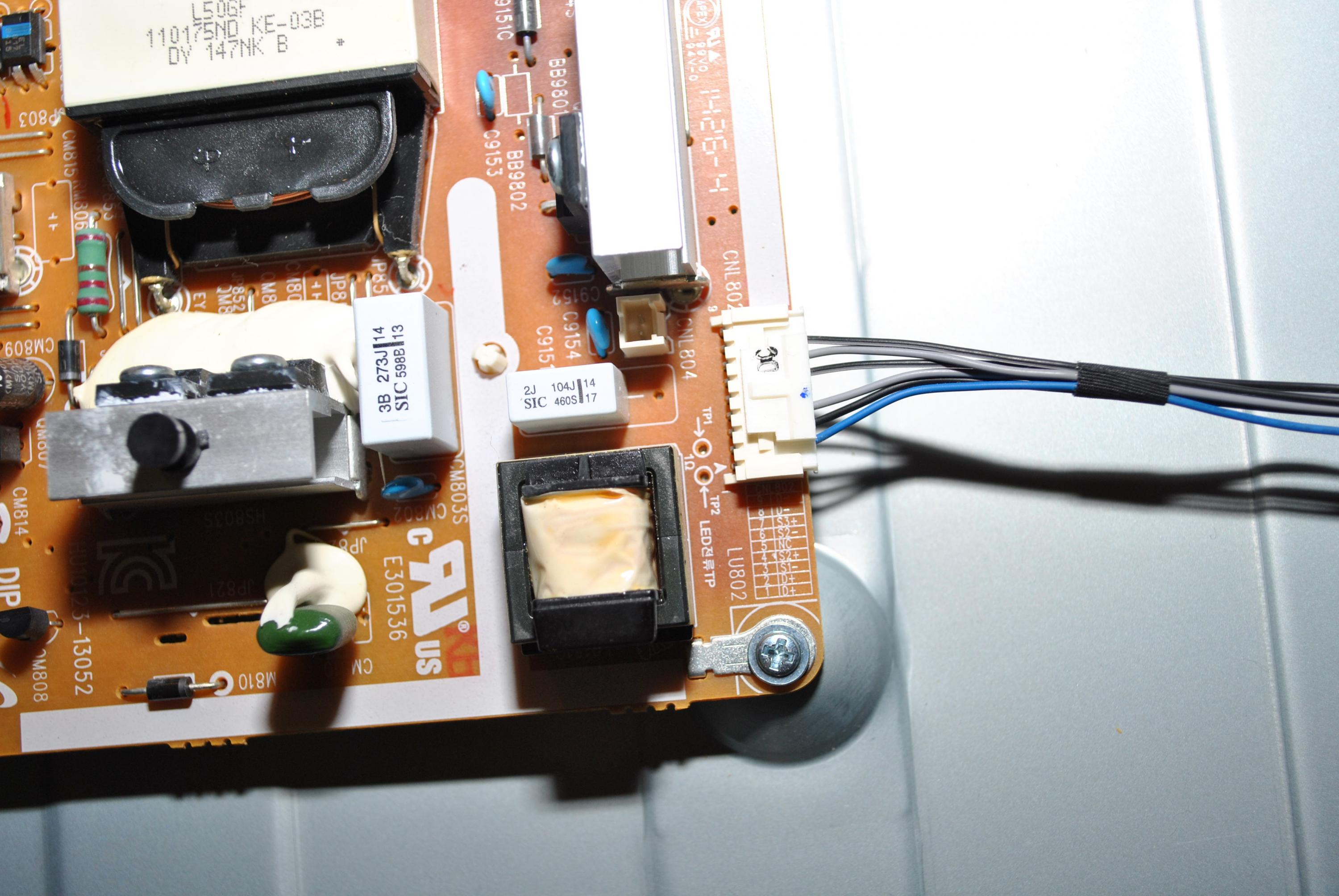

    Here are the voltage readings from the connection at CNL802 when powered ON:
    Pin 1 (D+) no wire = 325v
    Pin 2 (D+) = 325v
    Pin 3 (S1-) = 4v
    Pin 4 (S2+) = 4v
    Pin 5 (NC) no wire= 0v
    Pin 6 (S2-) = 5v
    Pin 7 (S3+) = 5v
    Pin 8 (D-) = 6v
    Pin 9 (D-) no wire = 6v
    Here are the voltage readings from the connection at CNL802 when powered ON and cable to LED backlights is unplugged:
    Pin 2 (D+) = 325v
    Pin 3 (S1-) = 0v
    Pin 4 (S2+) = 0v
    Pin 6 (S2-) = 0v
    Pin 7 (S3+) = 0v
    Pin 8 (D-) = 7v
    Pin 9 (D-) no wire = 7v

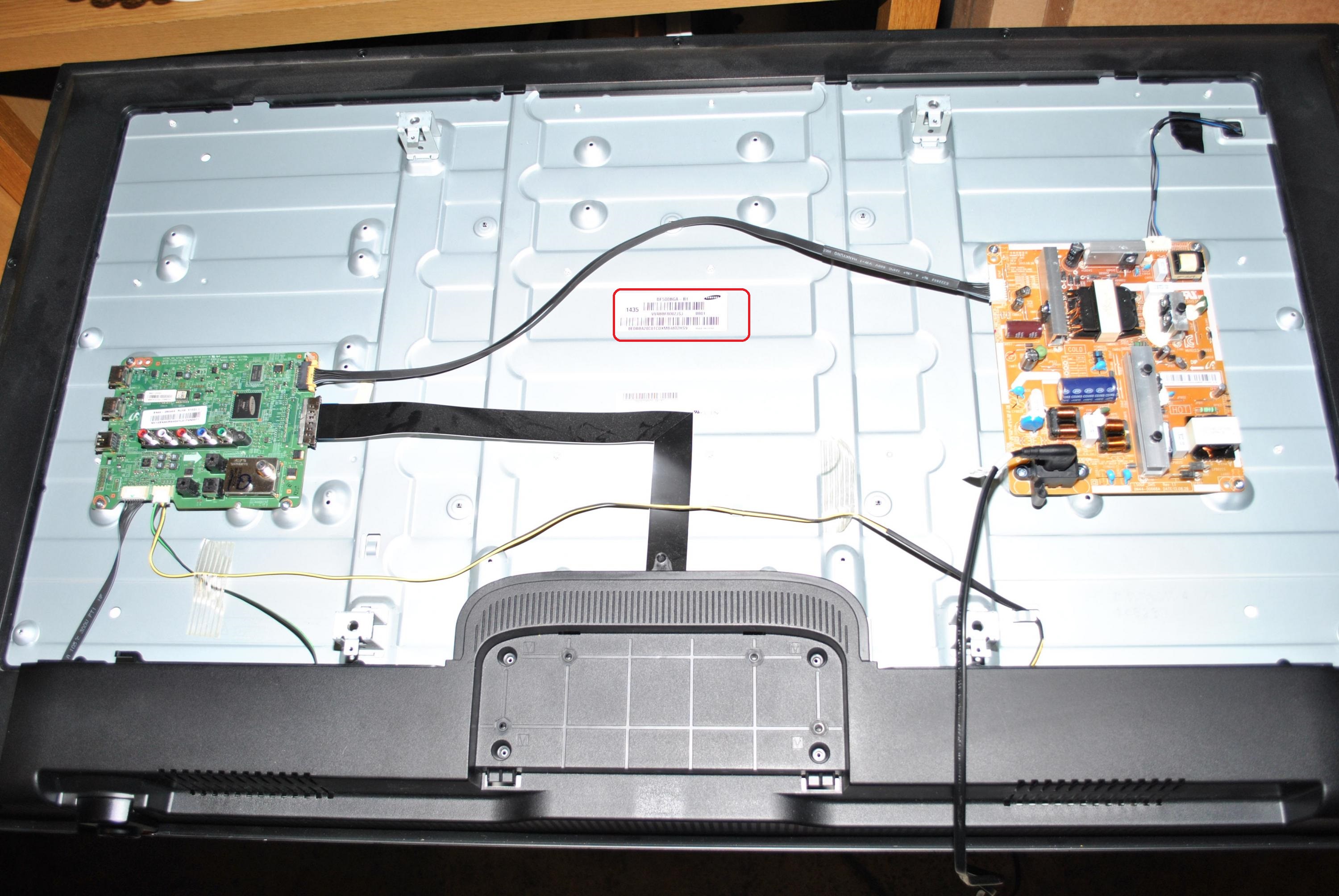

      What is your panel number as given on the rear of the lcd panel.
          Is the rear of the LCD panel this metal chassis in the pictures I attached or would I need to deconstruct more of the television. Trying to figure out where to get the part number. Thanks

            Re: Backlight Issue on Samsung LED Model UN50EH5000F (version AJ04)
            I can make some of the label out but not fully due to poor focus.
            Edit

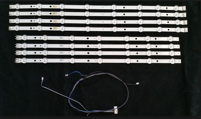

            It looks like DF500BGA-B1 and if it is then it's made up of 2 interconnected led strips per row totalling 15 leds and 4 rows altogether. (15 * 4 leds)
            I suspect they are all connected in series and you have a led(s) fault.

                Makes sense. ShopJimmy is out of the DF500BGA-B1 part, but they have alternatives so I'm going to order part T500HVF02.2. Thanks guys, I'll report back. This forum is amazing.

                  Okay, so the backlights came in today. Swapped them out with no problem, but when I test the lights (unplug cable from power board to main board), the lights are not steady. They are flickering. Not totally on and off, but the brightness difference is noticeable enough to consider it a flicker. Any idea what would cause this? I don't want to put the panel back together only to find out I have another issue.

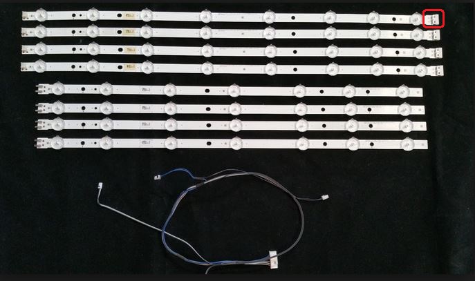

                                • dick_barton
                                  • Aug 2015
                                  • 6643
                                  • Wales
                                  You should be able to measure the voltage across each led strip at the point within the red box (on each of the 4 strips) which should be identical and in the region of 1/4 the supply voltage. There may be a "+" and "-" sign within the box for you to take the readings.
