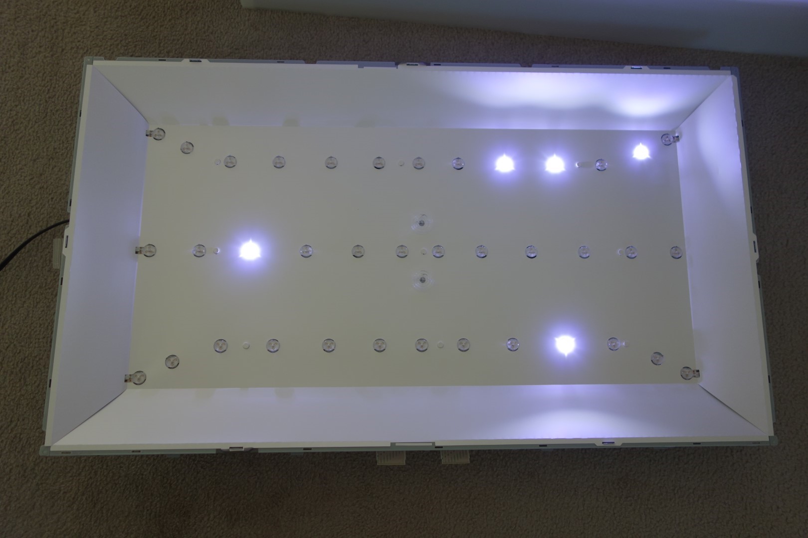

              hi all sorry to bump up an old post but I came across this using my google-fu powers.
              I have a Canadian market UN32EH4003FXZC with BN44-00664A power supply board and DF320AGH-R1 made in China panel that I trash picked from our recycling room. It powers up makes sound and I can see video by shining my phone flashlight through the screen. I thought ok easy it's just some bad LED backlights but when I tested the output voltages of the power supply I was getting results that seemed to differ from others.
              The CNL802 connector reads:
              1: D+
              2: S-
              3: NC
              4: S+
              5: D-
              On pins 1 & 5 (D+ & D-) with or without the LEDs connected I get 170V, and on pins 2 & 4 (S- & S+) I get 0V.
              If I measure across chassis ground I get the following:
              Pin 1 D+ 172ish V
              Pin 2 S- 155ish V
              Pin 3 NC nothing (obviously)
              Pin 4 S+ 150ish V
              Pin 5 D- 0V
              Do these readings seem normal?
              There is a slight brown discoloured portion of the power supply board around diode D9801C which I guess is a little concerning.
              Is there an easy way to test if this power supply is bad for sure? I don't have a LED tester etc though I imagine if the power supply has been putting 170V across LEDs expecting 65V then I probably have some burnt out LEDs too.
              • neilc6
                • Nov 2015
                • 1550
                Re: Samsung U32EH4003 problem.
                You probably have a lot of bad LEDs. Here's a pic of a UN40H. The diode could be shorted but easy to test with a multimeter. You can also test each LED individually with the multimeter in diode mode. Fairly easy to work on a 32 in TV though it's not worth much. An open LED will cause the circuit to be at the max rated voltage printed on the silkscreen for the board.
