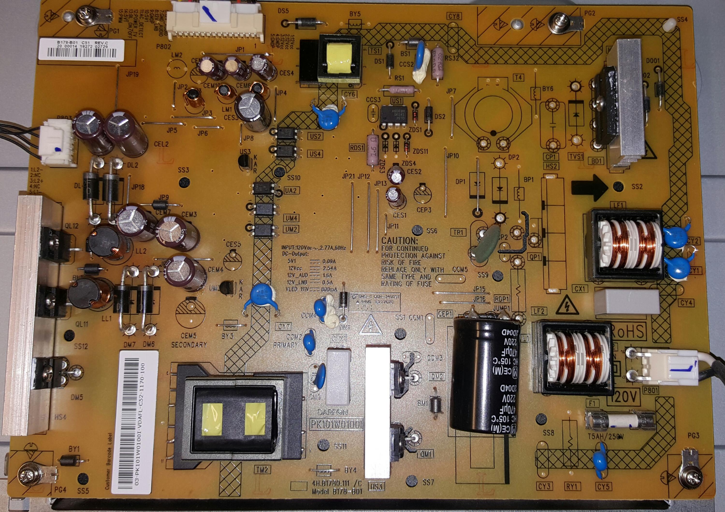

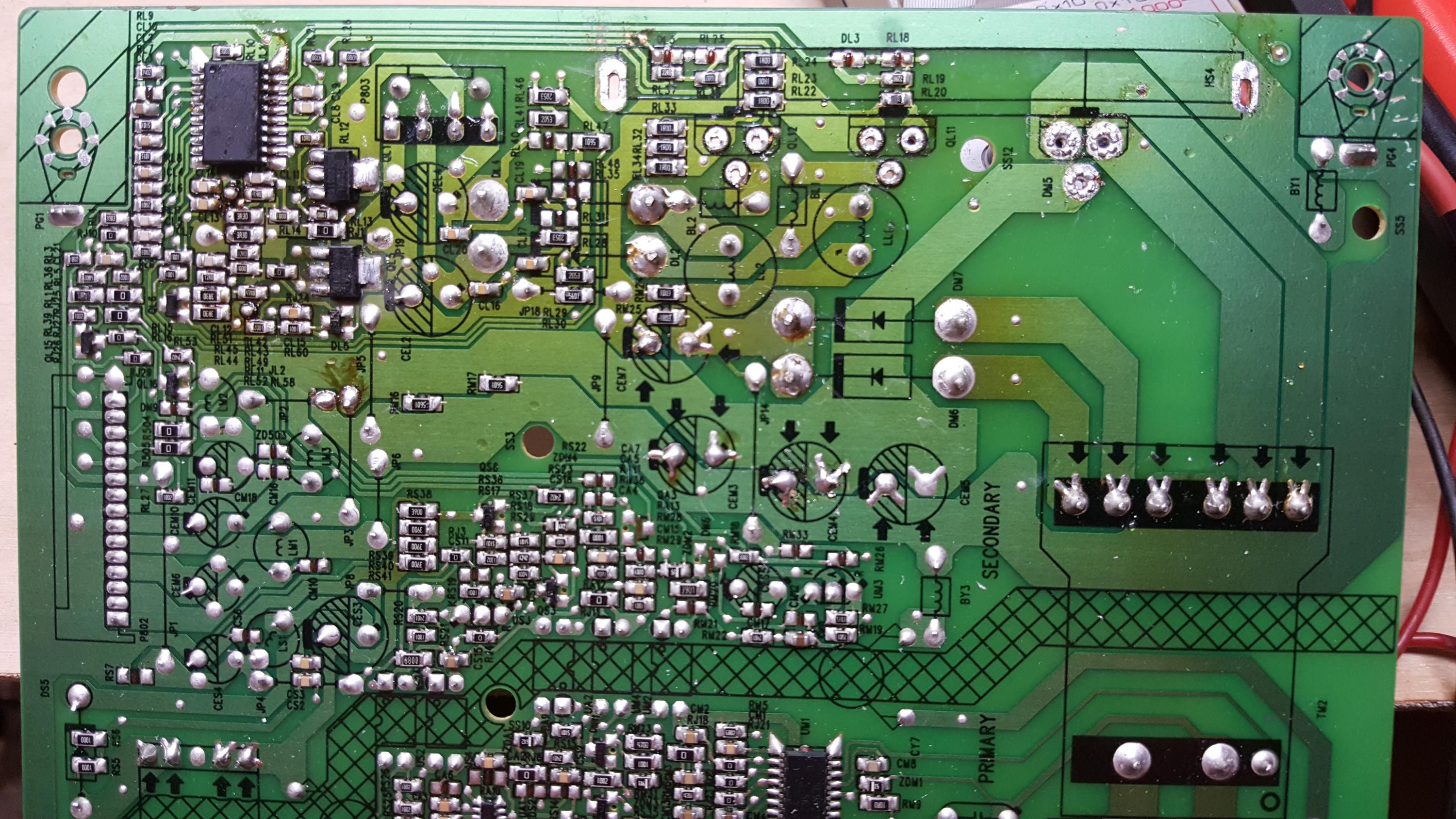

    Here are the pics I promised. Hope they are correct. Should be high resolution. Let me know.

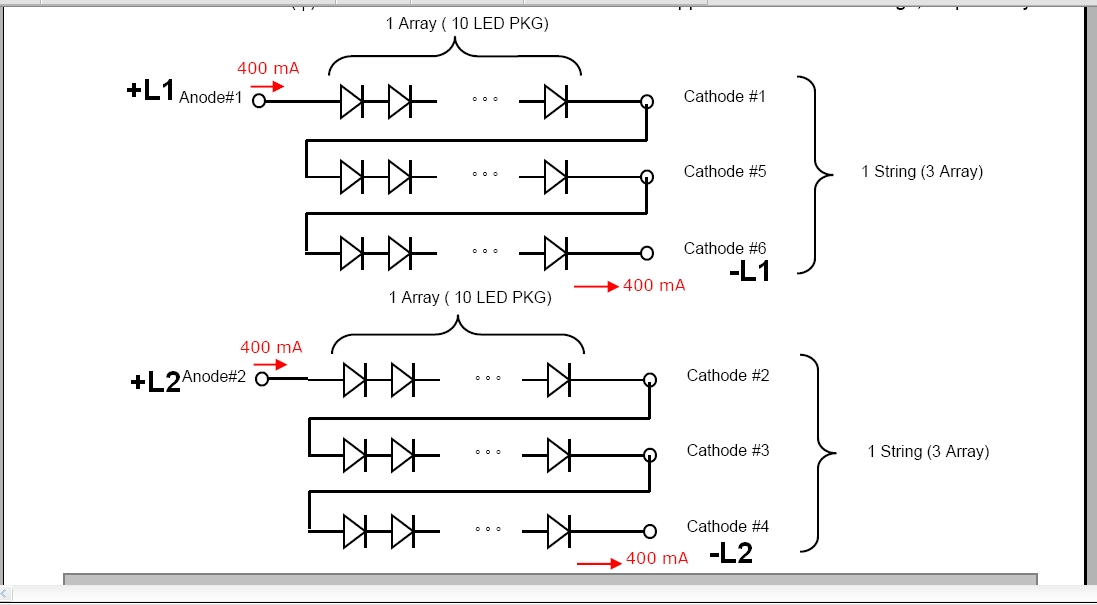

        You have two set of LED driver circuits, thus two boost converter circuits (QL11, QL12, LL1, LL2, DL1, DL2)
        So the question is what DCV do you have on each pin of that 4-pin connector for the LEDs.
        You will have to put black probe on the chassis, red probe on one pin at a time on the LED connector and then turn the TV on and see how high the Voltage goes up to and what it settles down to after 3~$ seconds. Turn off the TV and repeat the same on the other 3 pins.
        I just saw your chart, from your chart it looks like the problem is in L2 string, you anode (L+) Voltage but no Cathode (L-) return Voltage. QL1, QL5 are PWM Controlled MOSFETs (for maintaining constant current through the LED strings) driven by the LED driver/boost converter SMD IC on the bottom side of the board.
        Are you sure you do not have open circuit on the L2 string that is why it went up to 130V before the protection circuit kicks in and drop the Voltage down to 80V, check the inter connector between the LED board really well.
        BTW, the LED Voltage (loaded) is 111V as printed on the board.

          Re: Toshiba 50L1350U only some leds out?
          do l1 and l2 simply go to the led strips? on your notes you show voltage at both l1 and l2.
          what would happen if you swapped the l1 and l2 pins, would the others come on or no change?
          "Tested the small smt mosfets"
          are you referring to ql1 and ql5, almost looks like the bottom one could be a little melty, but probably just the pic.

            I'll swap l1 and two with some jumpers. Yes, mosfets ql1 and ql5. They both tested almost identical. I was concerned as the voltage kept creeping up. Forward voltage I think it was. Might be because my meter puts out 2.5 or 3 plus volts in diode mode? Over the forward voltage threshold of those? Activating the mosfets on the meter check without the gate voltage bring applied?
            Any thoughts on the strange voltages at the drains of ql11 and ql12? My thought was because of a open circuit either in cable, connector, circuit or component causing a reverse build up?
            BTW, I don't know if I mentioned in my post that I swapped those mosfets and got same readings and results. It's in my note I'm sure but to bring it to attention.

                  I'll run jumpers to swap legs and retest components tomorrow. I did run some continuity tests in diode mode, while powered, and got some strange readings. L2- doesn't test continous or do anything with leads in either direction, but the others do something one way, different things in the opposite. I'll post results of that tomorrow.
                  It's starting to look like there's opened and closed gates in the OB3372KP, causing a short or open circuit respectively. Possible?

                      First: you are getting the Boosted Voltage to feed the L2 LED string so that section is working. If the booster is not working then you will not have that 130V.
                      Second: You have 130V feeding the Anode of the LED string Anode (+L2) of the LED string but you are not getting anything (0.3V!!) coming out on the Cathode end (L2) of the LED string L1 like what you are getting on the -L1.
                      So does that make sense to you now?
                      The LED strip has SMD connector to link the strip together don't they?
                      Remove the LED connector from the power supply board and check the +L1 and +L2 DCV to see if when you get when you first turn on the TV.
                      We at badcaps will not be surprised if you find Bad LEDs.

                            What DCV do you get at +L1 and +L2 when the LED connector is not in place? 130V or so?
                            As I indicate, you have 130V going to +L2 which is the Anode of the first string of the LED, -L2 is the Cathode return, so you should have Voltage on that -L2, you only have 0.3V so compare that to -L1 then you will see that you have open circuit some where.
                            See example of typical LED setup with two strings of LEDs. You have Voltage on one end and nothing on the other end, something is not completing the circuit.
