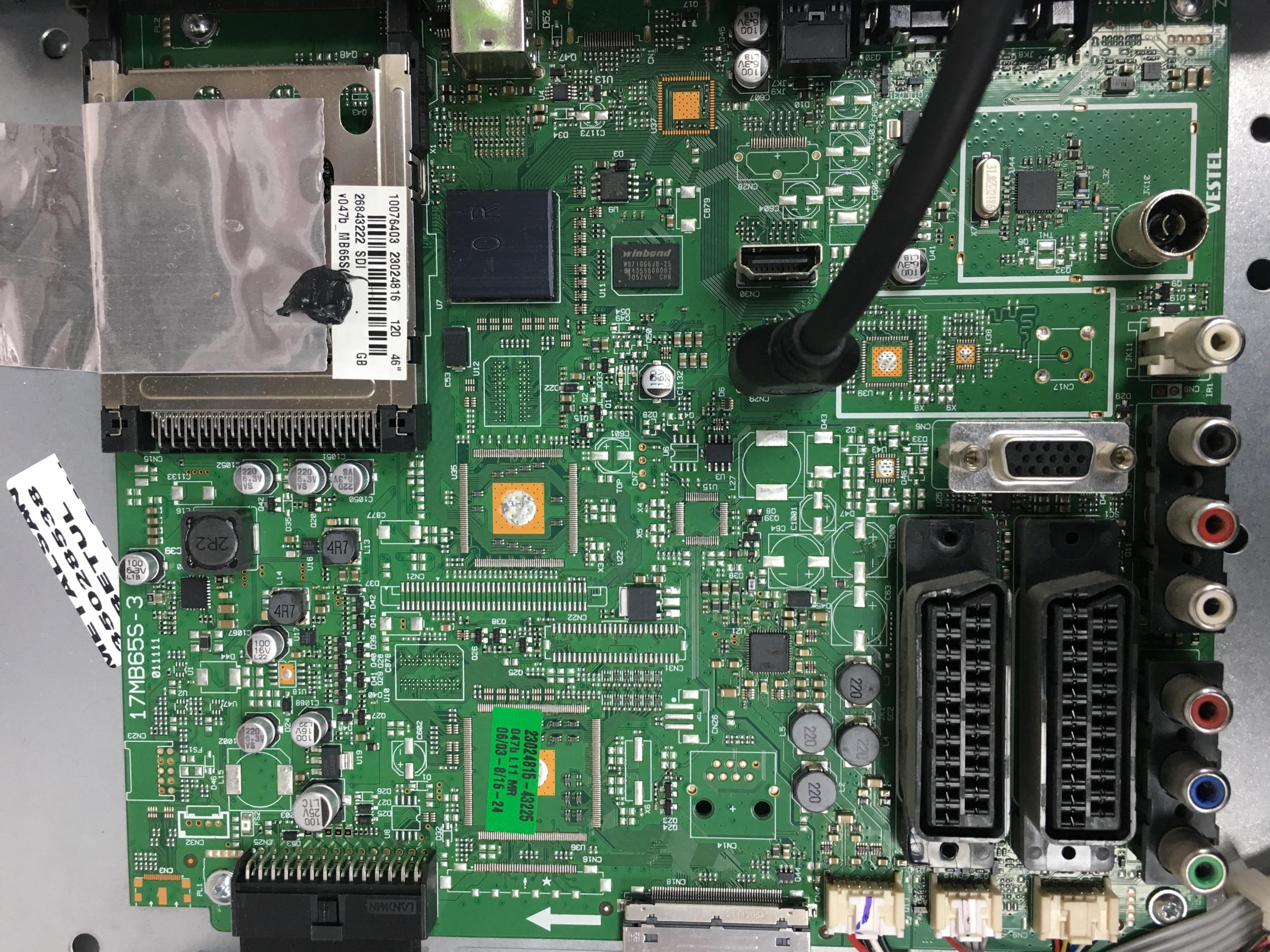

    Got this tv, no sound from main speakers but when a headphone is plugged in, I have sound.
    Few place on the web said to reflow u21. Done that but no sound from both speakers. I have no oscilloscope to test. What is likely to cause this. Reset is needed? How?

    Factory reset the Tv in the menu, sorted.

      I was looking for "reset", "restore" etc but never found it! I was under "first time installation" lol. Yea that did it. Thanks.

        Ay thats what I meant lol also knew it would common on these 17MB65 sets
