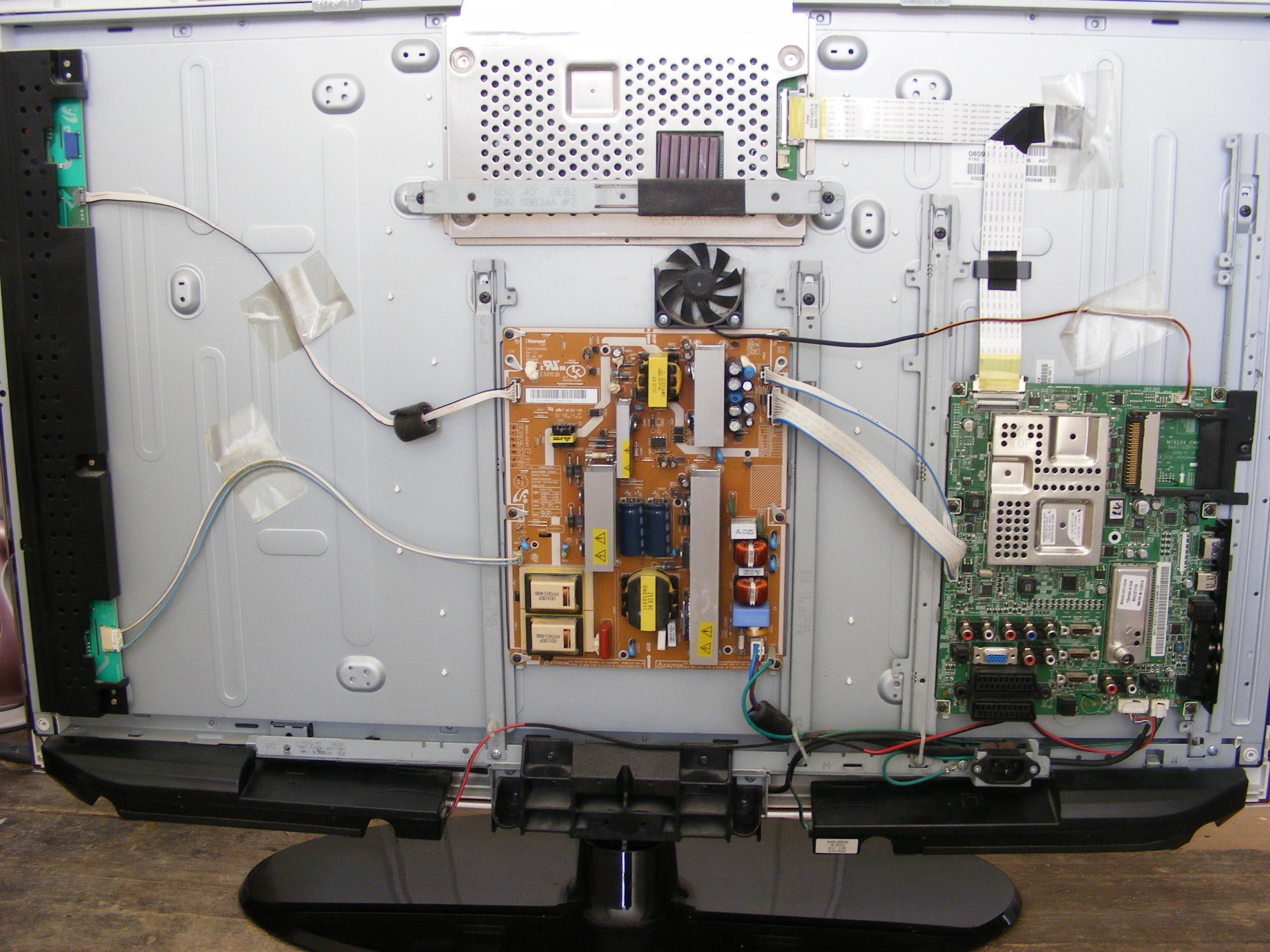

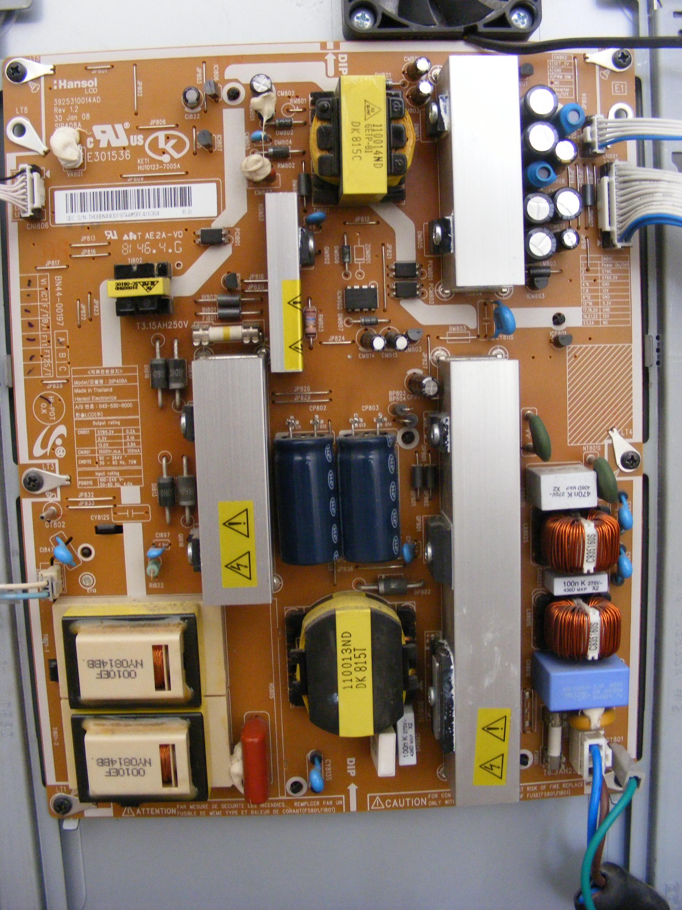

    Hi there. I got this TV originally with one swollen cap on the secondary of the PSU. Changed it and its friends for some nice Panasonics and sent it on its way. About a month later it came back to me as it was randomly restarting.
    Often after about 15 minutes - though sometimes it can go hours - it shuts off and then immediately comes back on.
    • Tried a hairdryer on all the boards and couldn't trigger the problem. Checked and retouched soldering on the PSU with no effect. Tried a factory reset.
    • Have replaced main board, and then PSU and still the problem persists.
    • Wiggled all connectors to see if I could make it do it. Nothing I do seems to trigger it.
    • It doesn't play the melody when it shuts down, though it does as it starts back up, which rules out the buttons and remote sensor. Plus I have tried it with those disconnected and still it restarts.
    I can't imagine it would be the backlight inverter board or the t-con as those would result in no picture and not a restart. So what could it be?
    Did I coincidentally get a replacement main board/psu with the same problem?
    I don't really know how to troubleshoot this as it happens so randomly and quickly that I don't know how to catch it happening.
    Any ideas would be very welcome as it's doing my head in and I would like to see the back of it.

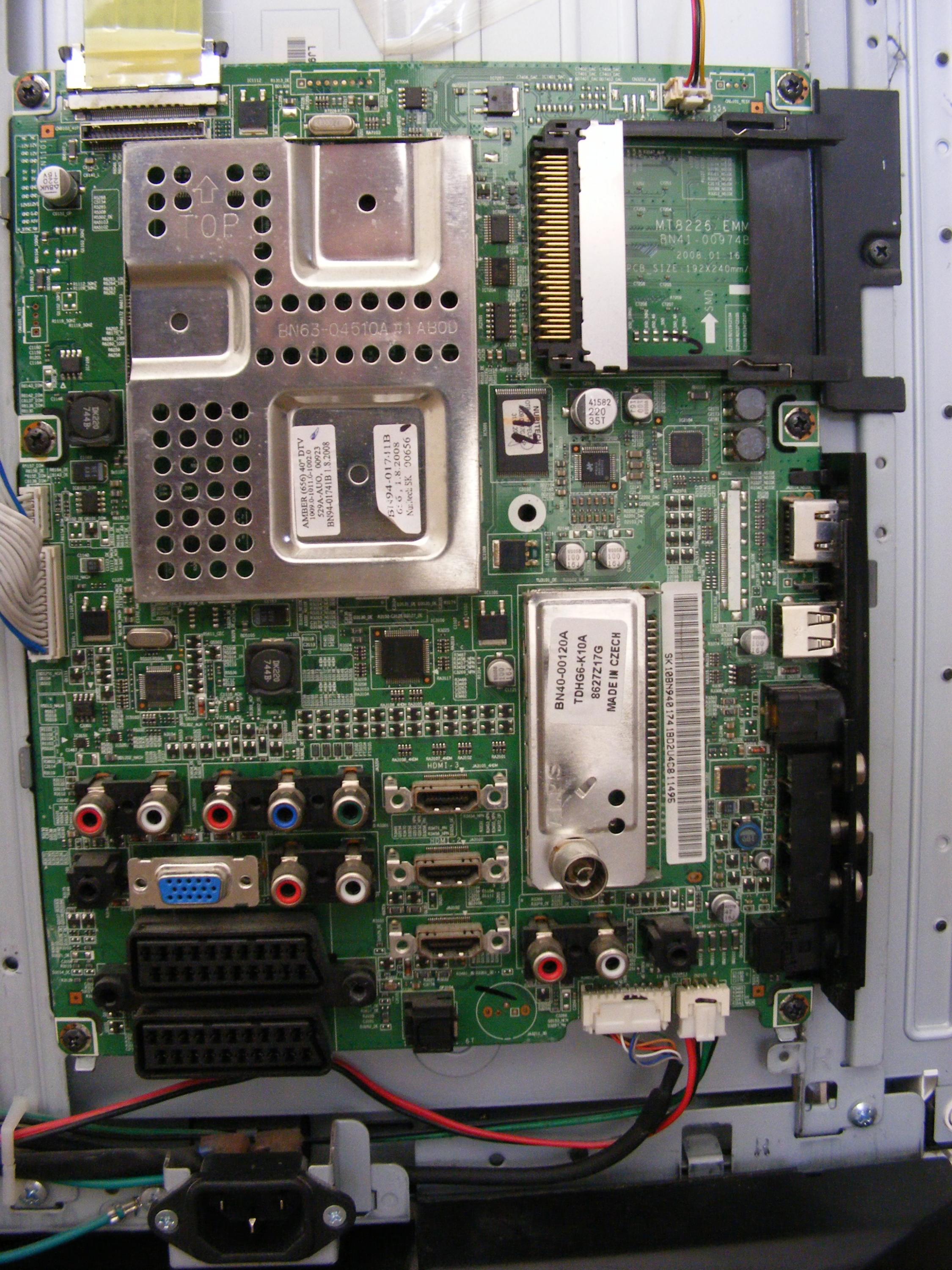

          If the updated firmware doesn't fix it, take a picture of the back of the mainboard. Perhaps this has the dreaded C102 problem since it is a "A" model TV.
          • tn245
            • Oct 2013
            • 530
            Re: Samsung LE40A656 random restart mystery ???
            No resets so far since the software upgrade. Hopefully that's done it. No C102 on this one. All the parts have 4 digit codes and I can't see any similar cap.

                    What is voltage on main cap while on? Have you tried heating inverter and t-con boards?
                    • tn245
                      • Oct 2013
                      • 530
                      391V on main cap. I did try heating inverter and t-con and got no effect. Is there a way inverter or t-con could cause a full restart on this model? I figured an inverter issue would only shut down backlight circuit not the whole TV, and t-con likewise would just cause no image or bad image and wouldn't restart the TV. Or is there a fault detection system that would restart it?

                          It runs with sound playing with all boards except psu and main unplugged. So I'm thinking to leave it running that way for a while. If it doesn't restart it doesn't conclusively prove anything I guess, but if it does do it it means it's in the main or psu and I just got unlucky with the replacement. Conceivably it could also be a connector or cable issue but I have given them a good wiggle test and haven't triggered it.
                          • tn245
                            • Oct 2013
                            • 530
                            So, guess what.. turns out it was the t-con. Ran it as I said with combinations of t-con, inverter, or both unplugged over the course of several days and the only time it did restarts was when the t-con was in the mix. I didn't think that was possible but at one point I did remove the lvds cable while it was on and it triggered a restart, so the main must reboot the TV when it loses connection to t-con. Got a replacement t-con in and all seems good so far.
