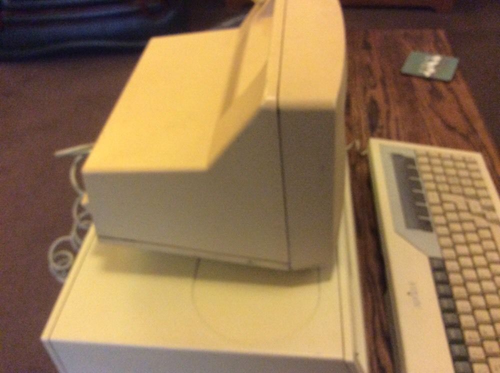

    I recently with the help of the power supply section of these forums, repaired and restored a vintage Apricot-PC. When I got the computer I was'nt given a monitor with it and as I have many other systems and monitors I didnt expect to have problems. As it turns out this particular computer came with its own dedicated monitor and from the circuit diagrams it seems its a video (not RGB/VGA) output of some type yet I have been unable to get a display on any low resolution video monitor. There are only 4 connections on the monitor cable 1:Ground, 2: Horizontal Sync, 3:Vertical sync, 4:Video. When i recently made a cable and connected to a old phillips video monitor with the very same connections it gave me me a display of some kind continually scrolling and ratcheted down each side. No text could be made out. I wonder could someone help me solve what display is neeed for this computer. I have uploaded the service manual which also covers the monitor with schematics that might off some clues.

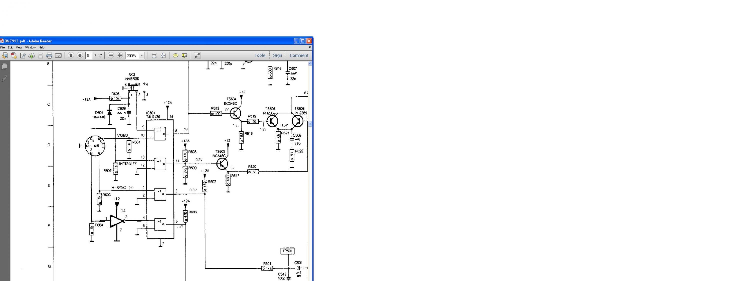

      That monitor in the diagram requires positive going horizontal and positive going vertical sync so thats what the computer must be outputing, what is the model of the philips monitor you are using?
      The diagram I provided would only need one inverter section for each sync signal and not be configured to compine the signals

                Think I have managed to source all the components now. I may need a little bit of help with this first need to find a old bit of vero board or something. I am a little confused with the 74C04 layout on your diagram as its different to what is shown online. See attachment. Can you explain?
                  Re: Getting a display from Apricot computer
                  I think this should work as its only the vert. sync pulse that needs inverting. That diagram was for inverting and combining the h & v sync for a different monitor
                  this is done inside the monitor and uses the +12 volts from the monitor so the diodes and cap. are not required, it should work
                  It may have been possible to copy the circuit used for the video inversion (ic601 pin 9)
                  By lifting pin 5 from ground and connecting it to +12 via a 10K resistor and adding the diode and a small value cap.

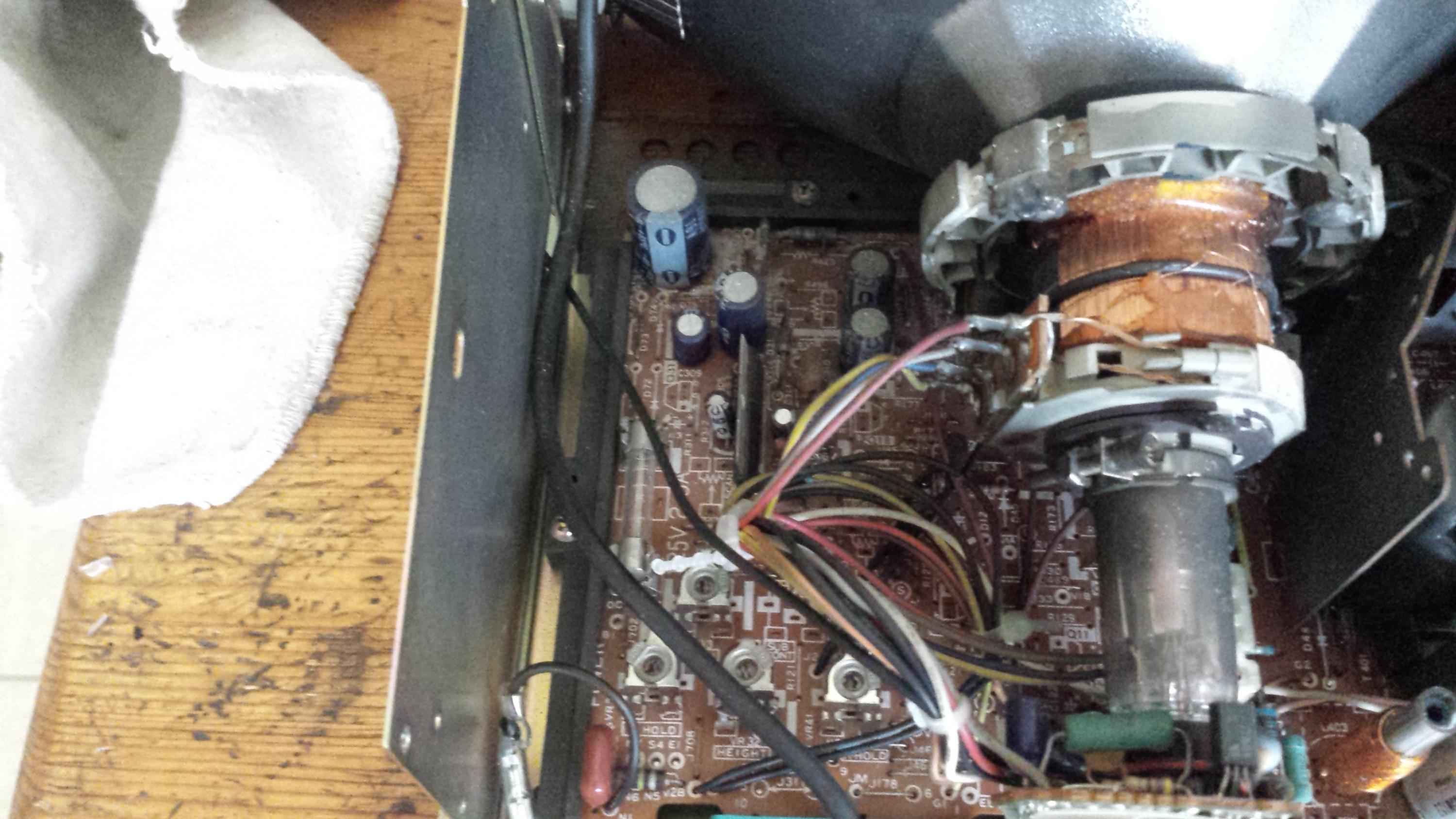

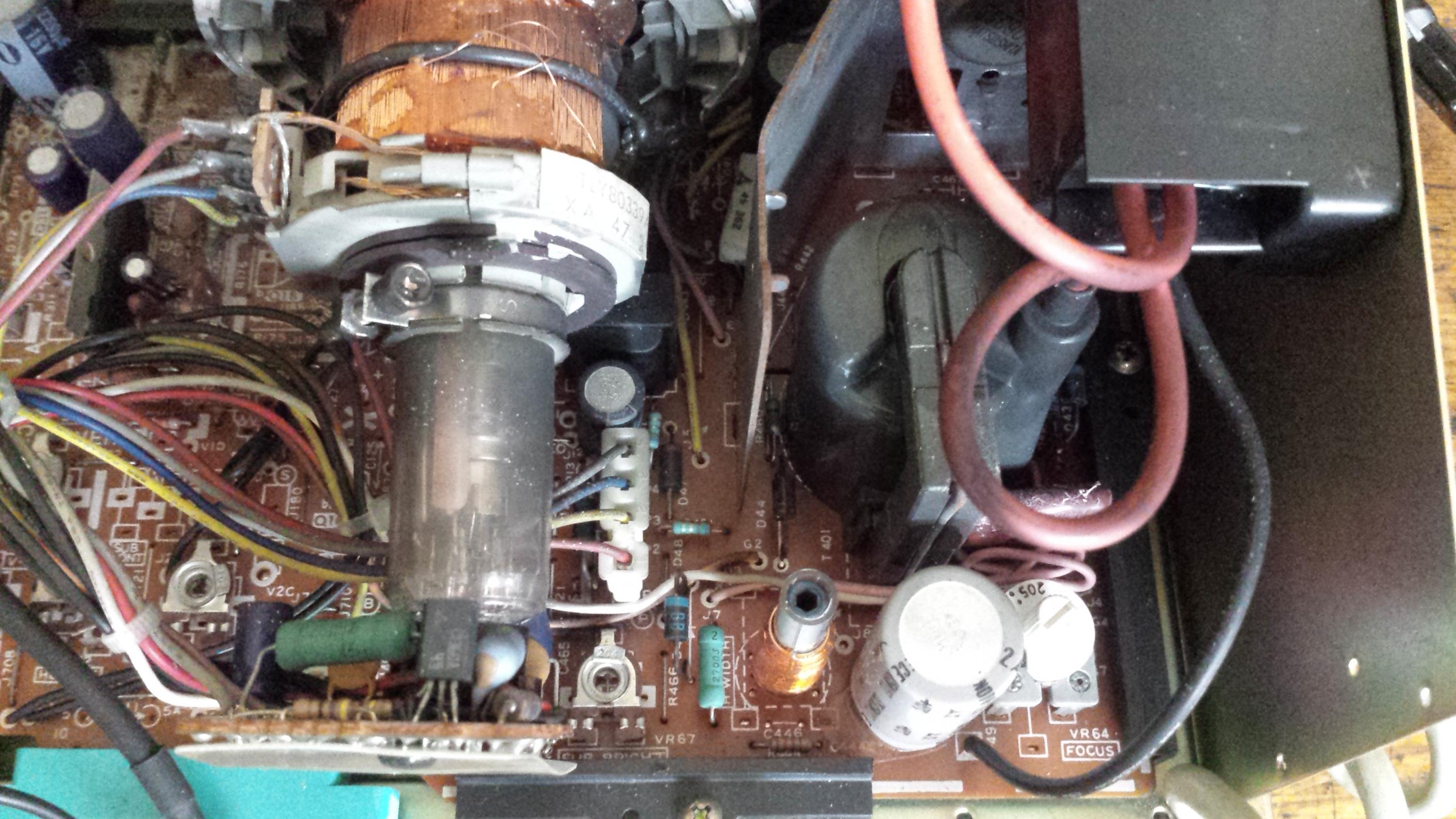

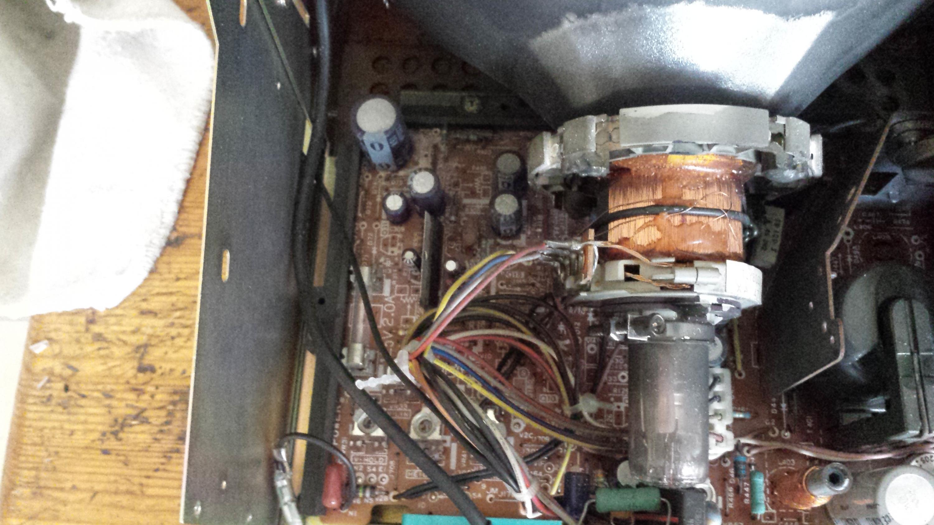

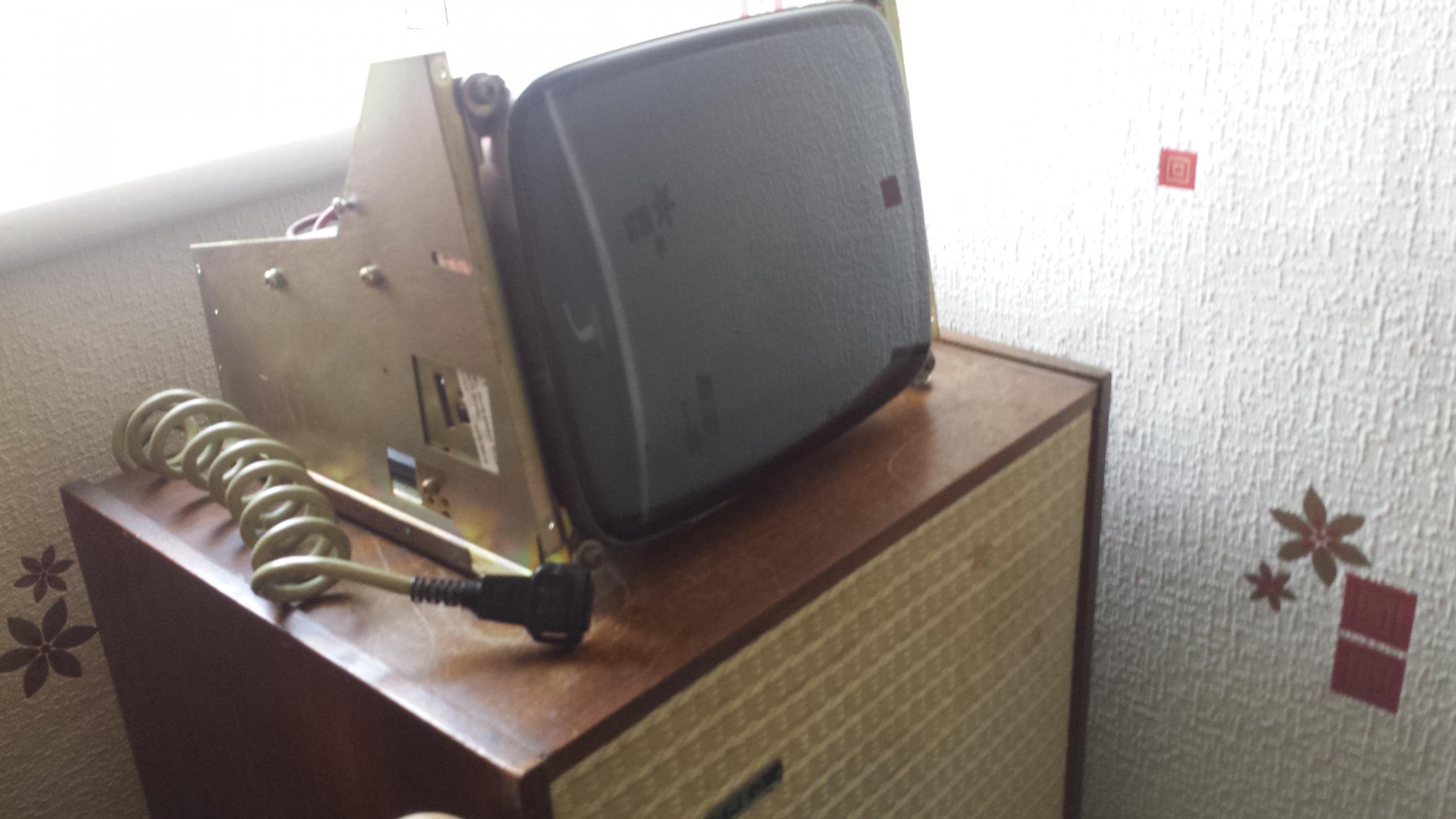

                                      I just managed to persuade someone to sell me a monitor from a non working Apricot system he was selling on Ebay and when it arrived yesterday I stripped it apart to check if anything was gonna blow when I tried it and it worked OK. Its a really tiny little monitor here are some pictures of it inside etc. So at lease i dont have to worry about trying to get something else adapted for use with it now and I now know for sure the computer itself is working properly too as its shows a picture of a floppy on screen asking to insert a disk.
