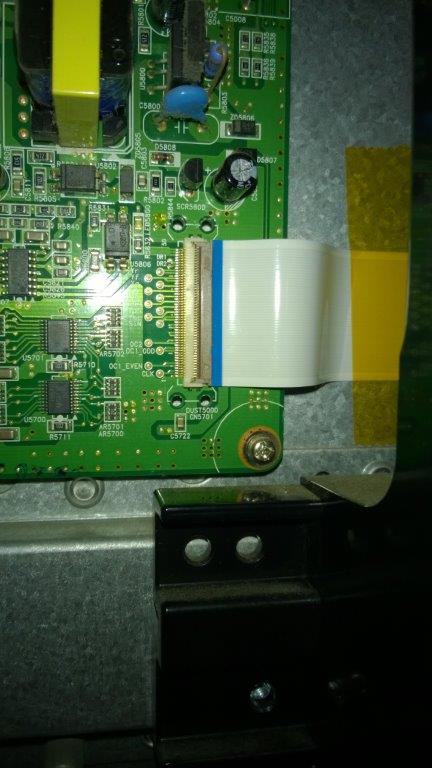

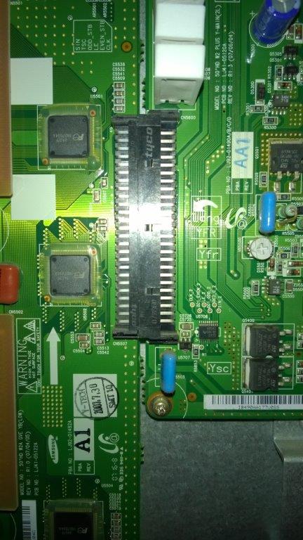

      Re: Samsung PS-50C91HD - disconnecting boards
      Connector latches and screws I can see. Screws I can unscrew. Latches I do not want to break. How do I unlatch the connectors?
            Please see photos. Black connector y-sustain to y-buffer and white connector (data ribbon).
              Its not hard, will link one of my vids on this chassis. We cant help with everything and wipe your ass the whole time you have to try it yourself. Hopefully this can help watch it all the way through.
              https://youtu.be/57aDWsiLIxE

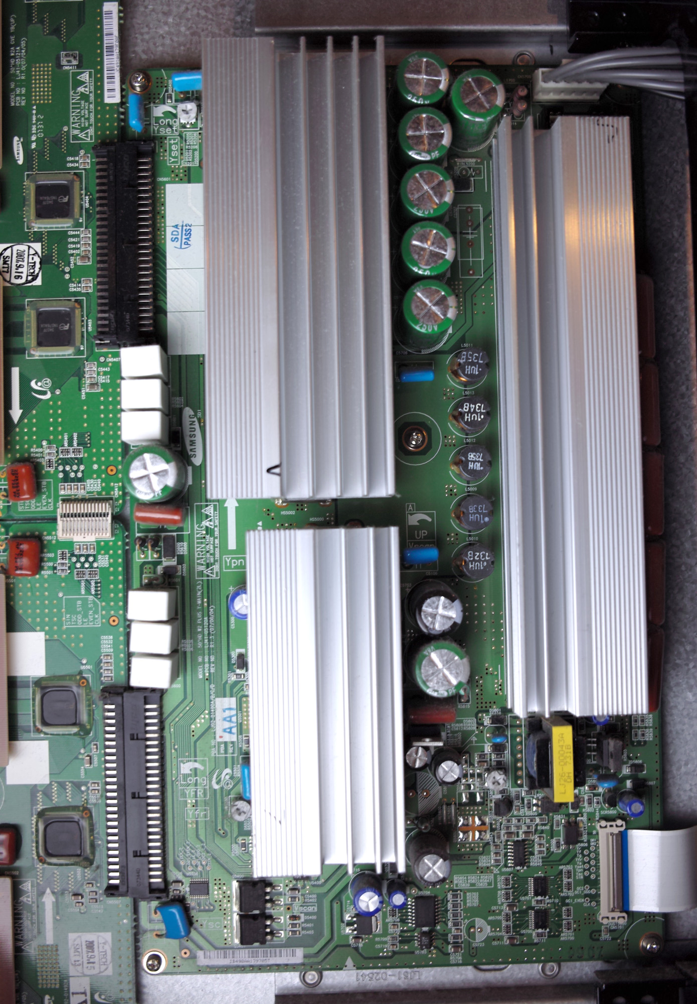

                            Just a quick report - all went well. Broke nothing and resoldered all the joints of components mounted to heat sinks on Y-Sustain Board. All good now. Does not lose video when hot. I am thinking of modifying the back cover so that I can use it as a toaster - the heat sinks get hot enough! :-)
                              thanks for the update this seems like its is a common issue we see on these samsung s with the soldering issues on the parts on the heatsinks.
                                Add fans and you better heatsink them buffer ICs and recap the ymain and tighten all screws on the ymain and xmain and recap the xmain and recap the psu and then your done
