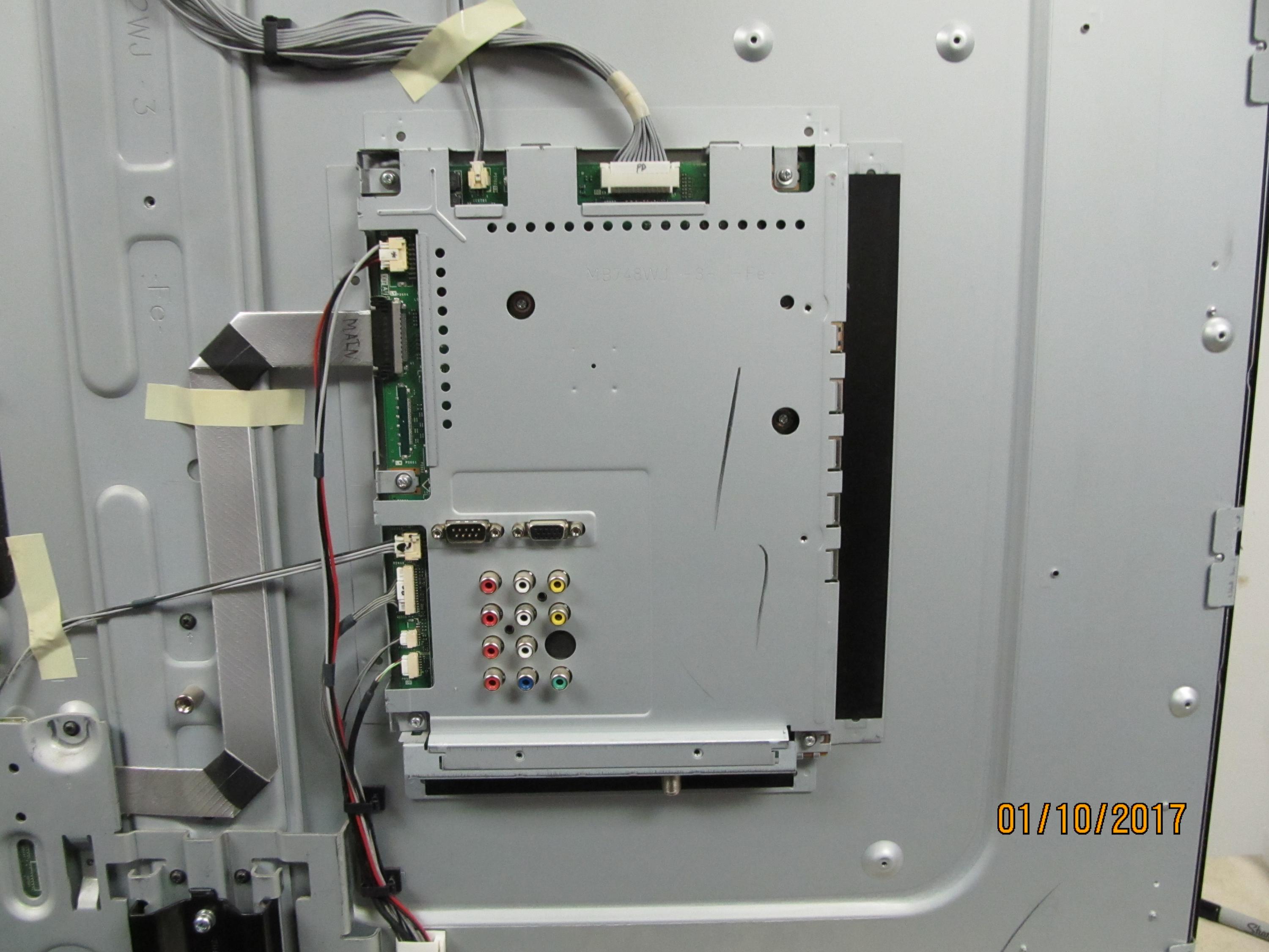

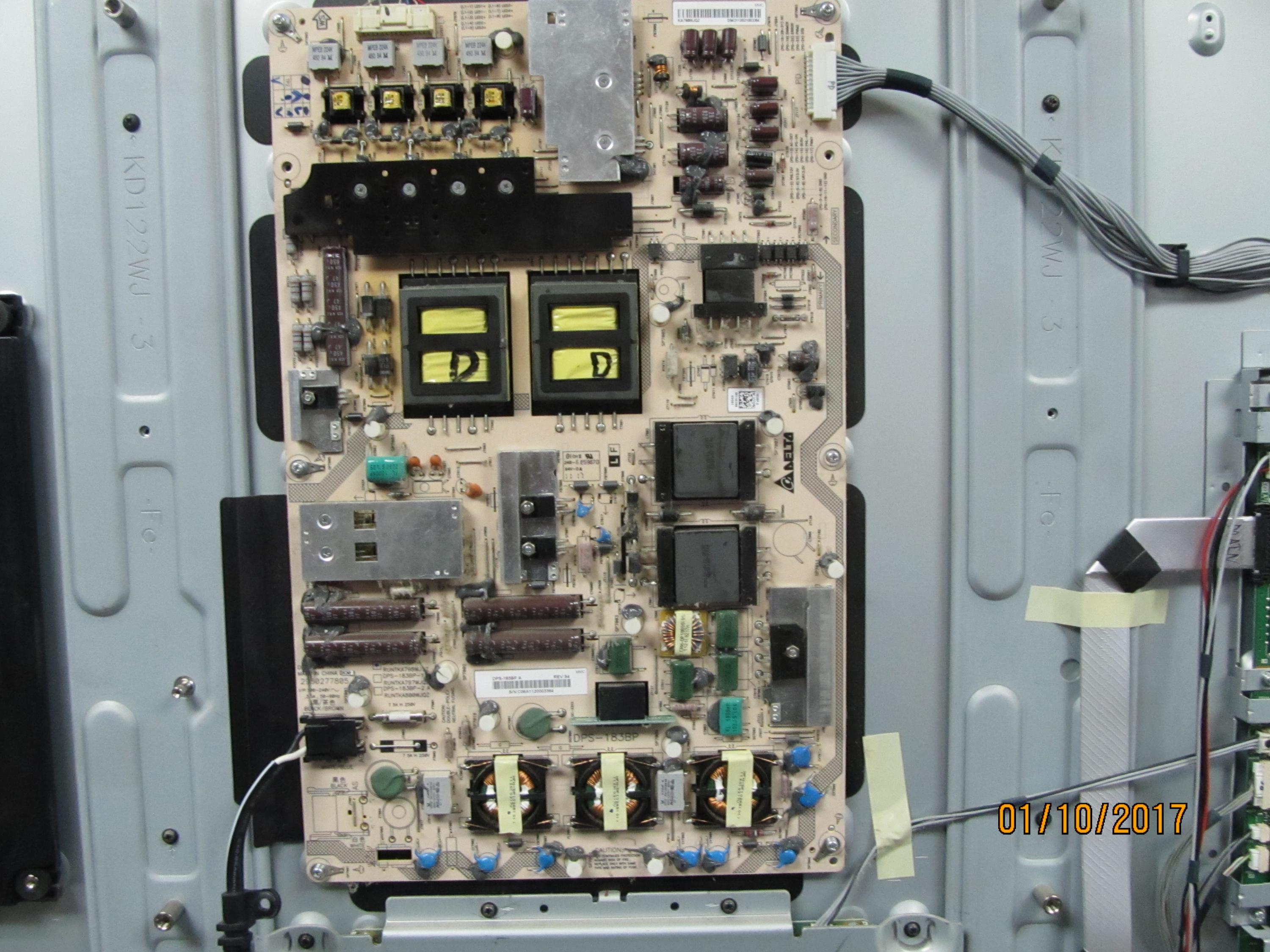

    This came into my place after a wind storm with the two blink code. I could not get it to reset and last more than a couple of seconds. I found one bad led strip in this tv and replaced it. I still get 1 short and 1 long blink but now I can at least reset it and get the tv to work. The only problem I have is if it is unplugged I have to do it all over again. I would love to get into the service menu but with this problem it is impossible. I have read some of the thread's on similar TV's on this forum and understand the blink code to be a bad power supply but when I reset it and test the voltages on the p.s. they are all good. I am more inclined to believe bad main board and was wondering if any one has any thoughts on this.

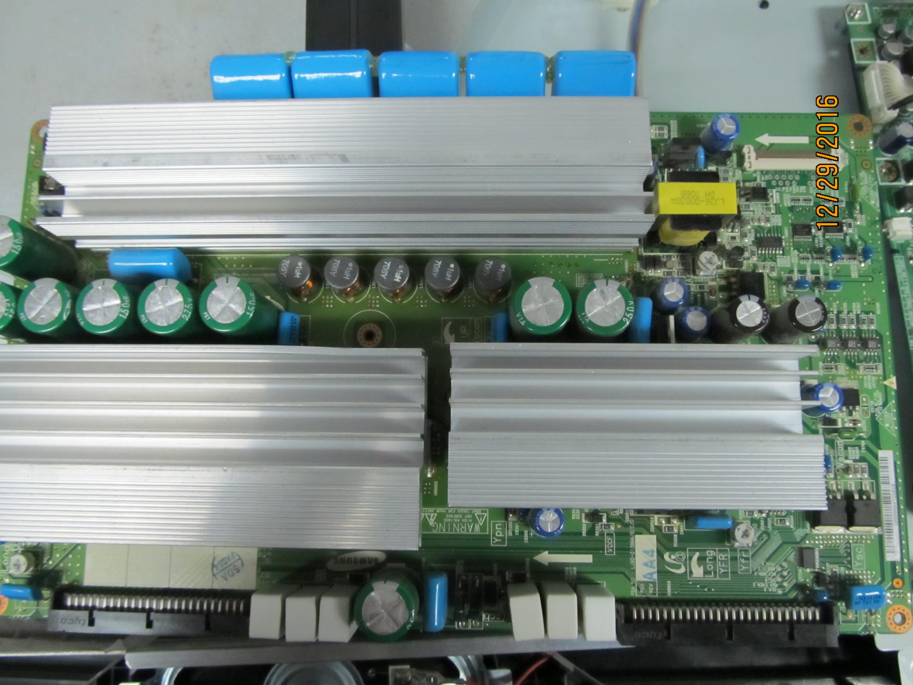

      sharp EDGE lit LED tv,replaced one of the led strips,so NOt edge lit? ? shows picture of plasma boards.
      I don't know what your smoking but I like two of those plz.

            Think its meth tbh

              Sorry, wrong pictures. I am averaging 5 TV's a day to troubleshoot and I am the only tv/tablet and cell phone tech so I get in a hurry. And the comments about meth are not really appreciated and not necessary on this forum. Yes one long and one short and I can not get into the service mode since I am supposed to unplug the tv to do it.
