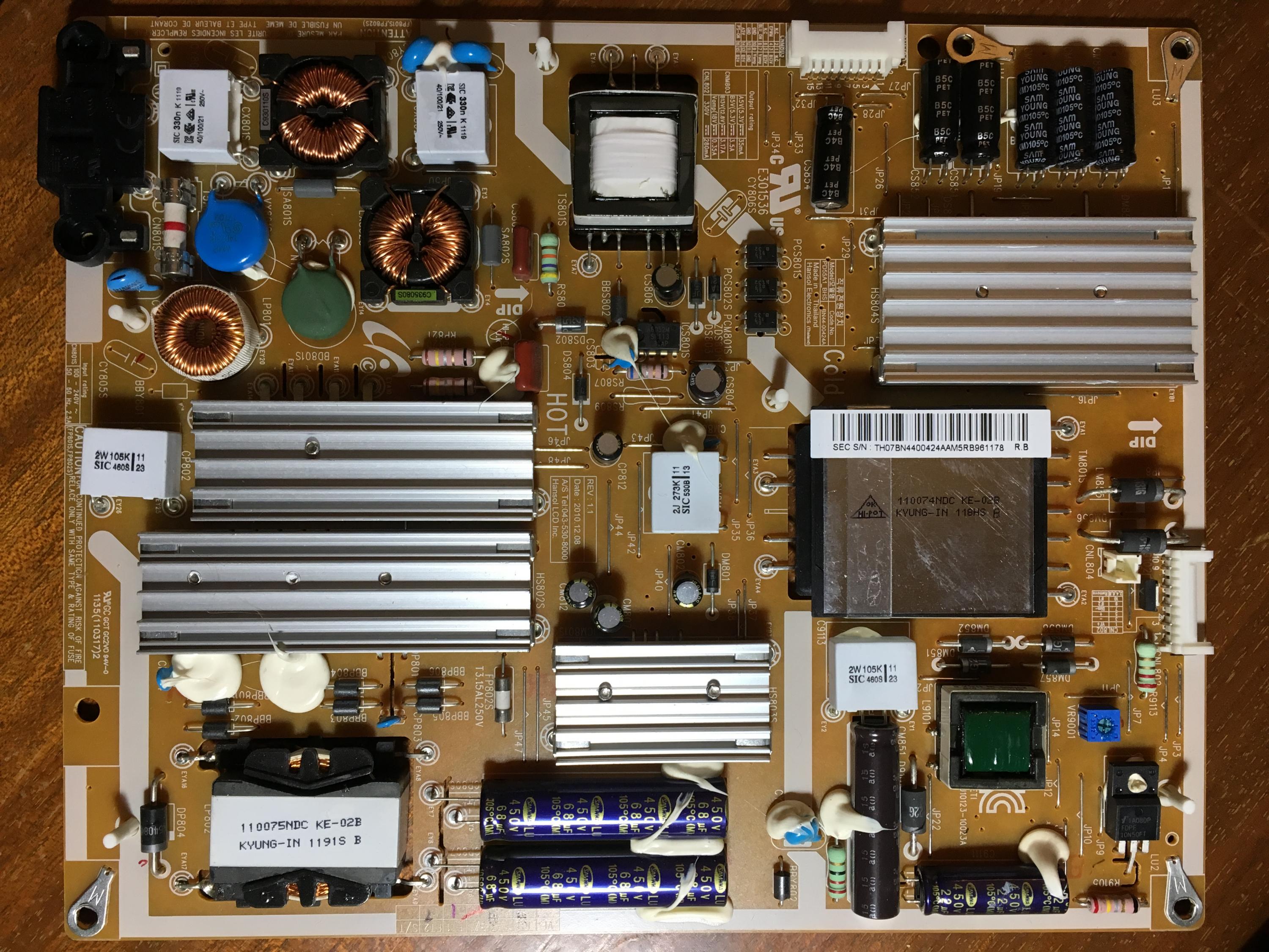

Hey everyone, I've got a Samsung TV UN55D6003SFXZA that is not working. If I unplug the TV from the outlet, wait a few minutes, and plug it back in, the startup screen ("Samsung SMART TV") appears on the screen for a second before the screen goes dark. At the same time, the standby light blinks 5 times. And then if I try to press the power button, the standby light blinks once each time.

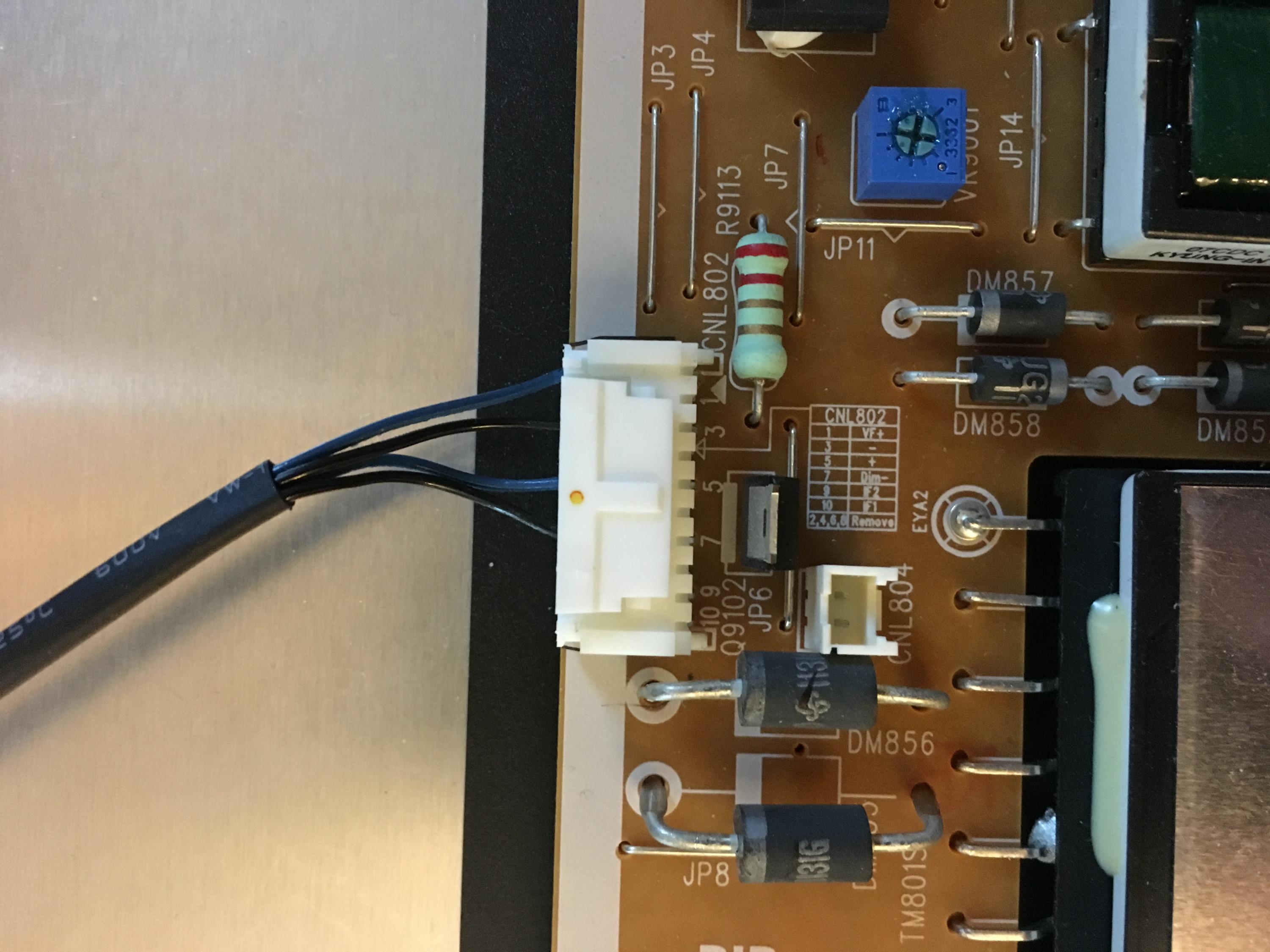

I disconnected both the main board AND the LED connections, and noticed the voltages at the power supply pins cycle up and down - is this supposed to happen? There seems to be a sound (sounds like a cricket, if that helps) coming from TM801S every 4 seconds or so, and after 90 seconds or so it stops making that sound. After disconnecting the power, the sound continues a few times before stopping. Does this mean the power supply board is bad?
Any help I can get would be great! I'm giving this one last chance before I take it apart and sell for scrap parts.
Here are the voltages with various configurations: with only the main board disconnected, everything hooked up, and with both main board and LED disconnected.
CNL802 (connection to LED)
With only the main board disconnected:
Pin 1 (VF+) = 325VDC peak, 322VDC steady state
Pin 3 ( - ) = 162VDC peak and steady state
Pin 5 ( + ) = 162VDC peak and steady state
Pin 7 (Dim-) = 1.1VDC peak and steady state
Pin 9 (IF2) = 0.6VDC peak and steady state
Pin 10 (IF1) = 0VDC steady state
