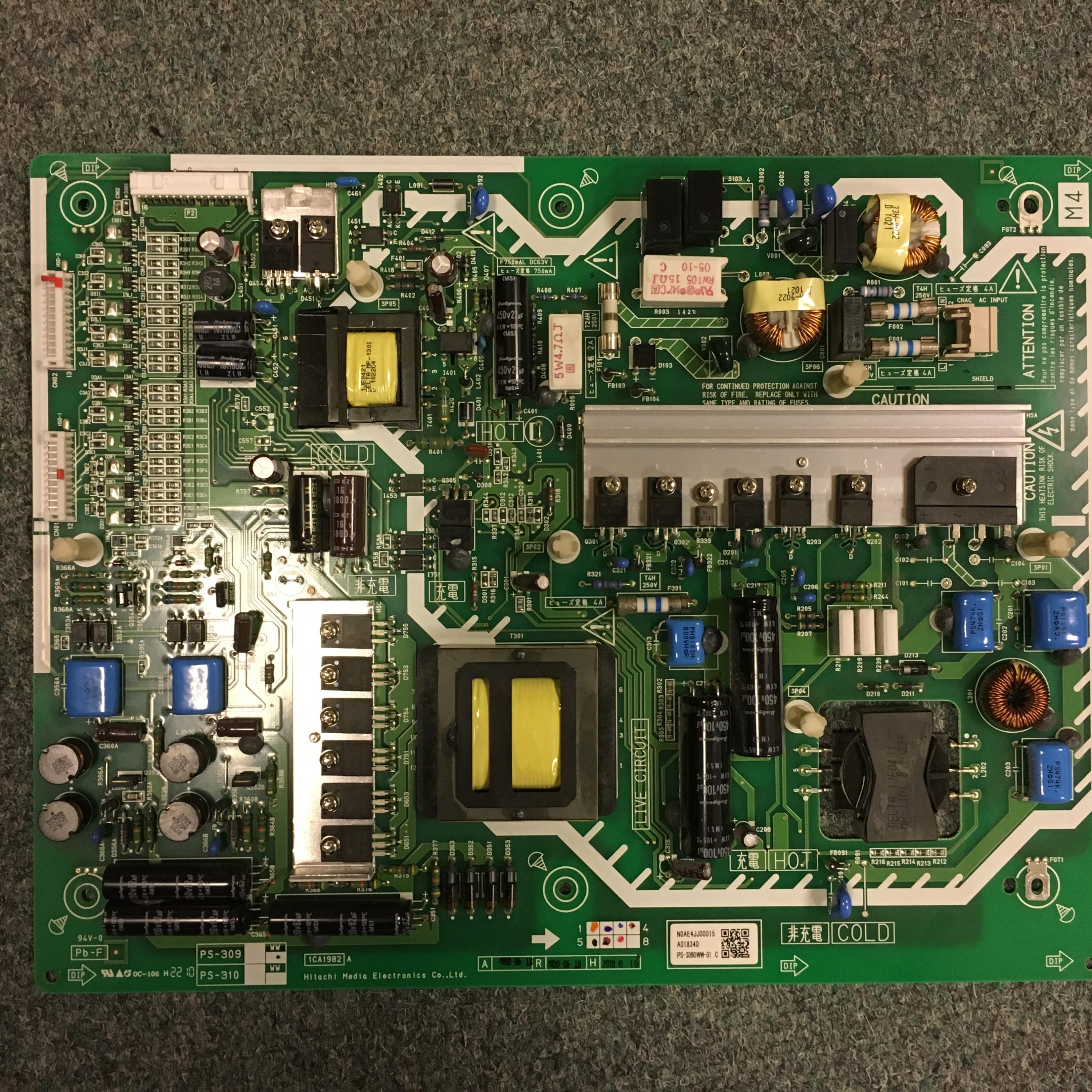

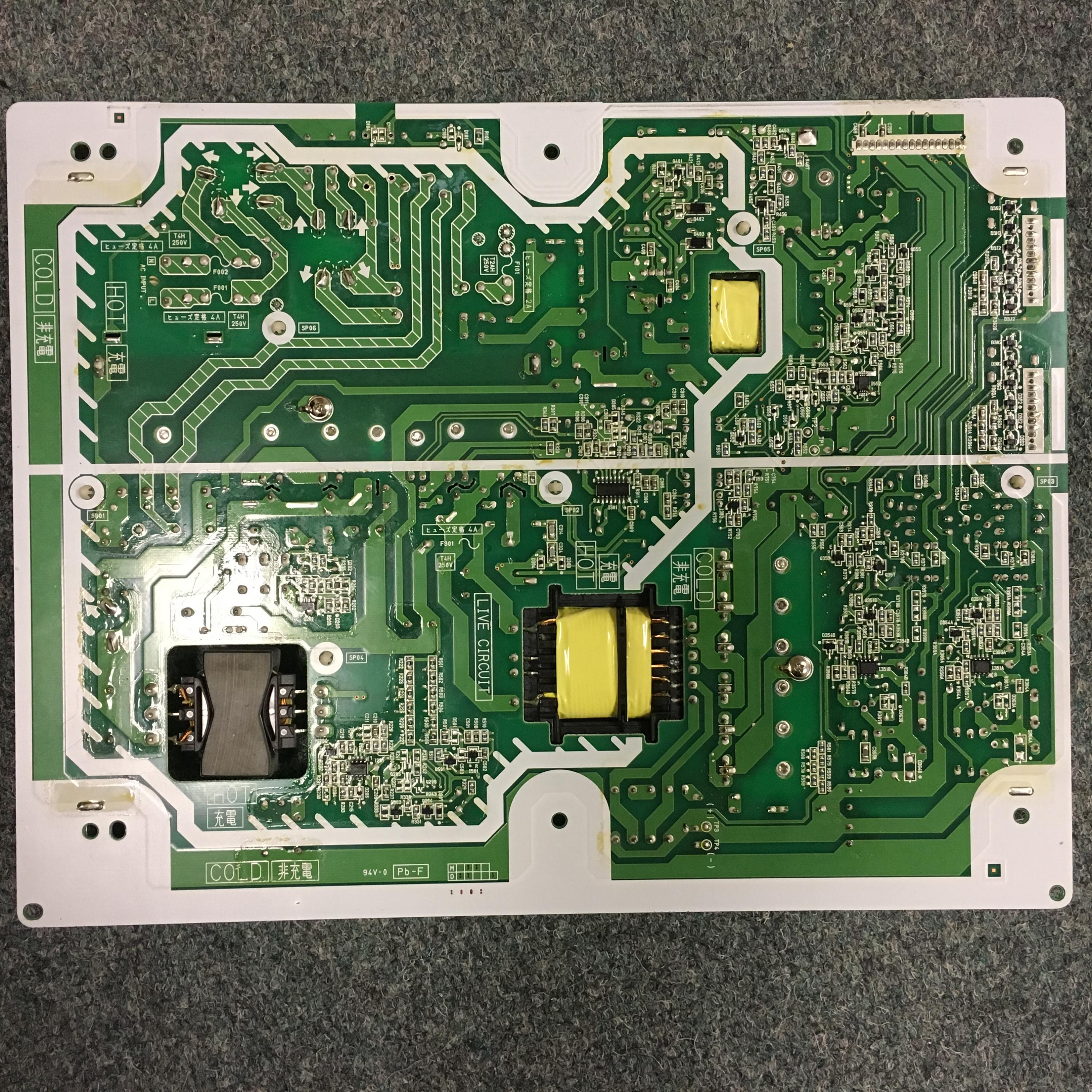

    I have a new toy to tinker with, this time it's a PANASONIC TX-L32D28. The power board has blow both it's fuses, while poking around I tried to desolder one of the relays and broke it in the process , it's a DEC I can't find an equivalent of, so I ordered one from China on ebay, it's a DQ1U 12VDC DEC, if anyone is familiar? I think a HF36F012HST would cover it as a temp solution.
    Any hoot, here's the board, no sign of bulging caps, no sign of anything burnt out, the two rectifiers on the hot side both check out OK Any ideas?

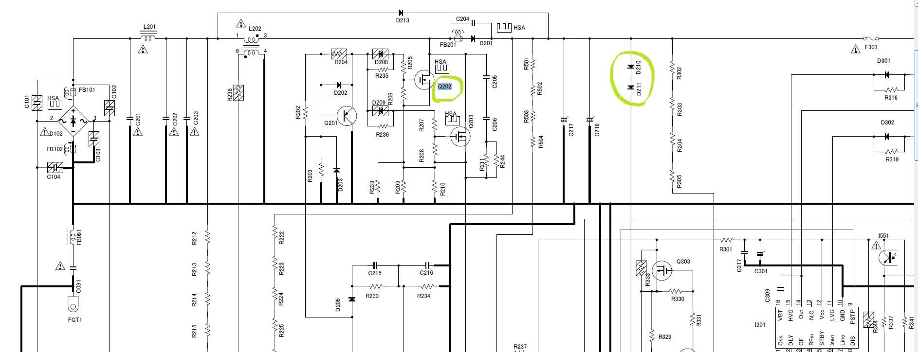

    Thanks to some lovely Russians I've found some circuit for the N0AE4JJ00015 power supply! Attached for others to find

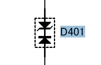

        I've found what appears to be another dead Diode (PCB has a diode symbol), this ones large and has a blue ring, T2D 04 I don't know if it's a Zener or not :/ Fails a Diode test, 0L in both directions, 1.6 mOhm, 0.9 mOhm in the other.

          This would be the weird diode I couldn't test, no wonder my meter didn't know what to do with it, that looks like two types of diodes in one package

              There was a noticeable arch of electricity from Q202, the casing is a little scorched between drain and source pins, I pulled it but oddly enough it still tests fine on my component tester.
              I seem to be getting 2.5volts on pin 12, which is the SOS and -3volts on the Relay pin.
              I'd be grateful for an experts opinion, schematic attached

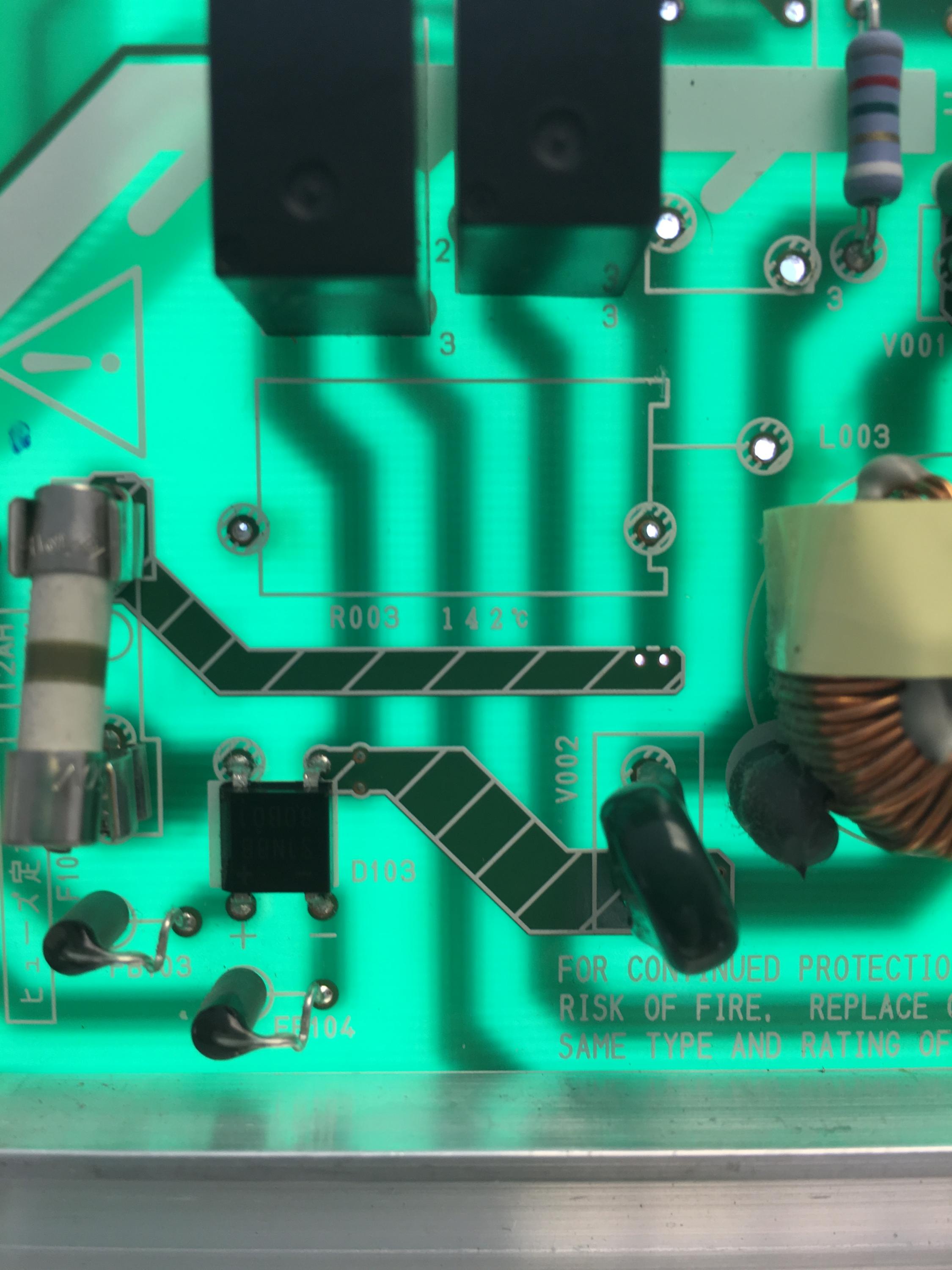

                I've now found an odd 3 legged thermal resistor combo, which doesn't seem to be very well at all, it's RWT05 15ΩJ, (R003 on schematic). Although this has three legs, only two of them are in circuit, 1 leg is soldered in, but there are no tracks to it on the PCB (image attached) I suspect this is a test point of some kind?
                I assume I can replace with a two legged alternative?

                  Have ordered a straight 5w 15ohn resistor, as far as I can tell this should be fine, it will just lack the thermal fuse, not as safe, but will allow the circuit to operate.
