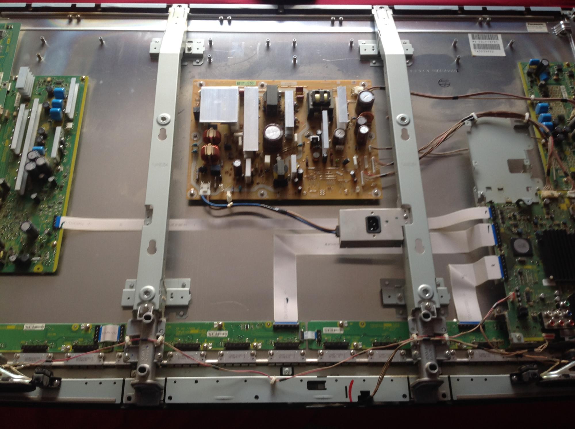

    Got a Panasonic 50" PDP TX-P50S21BA which uses the TNPA5105 SC-Ydrive board. Fault is 4 Red Led blinks, found Vsus rail to be almost shorted to ground and the SC was the cause.
    Doing a video on the repair of this board soon, already alot of parts are failed so this will be fun to do, I hate these boards when they fail they really do go out with a bang. Will keep you posted

      Lol you should tighten the screws on SC as I noticed they did seem rather lose on the transistors.

        Strange, have not seen that at all yet and they have springwashers. Is this all of them or selected few?

          I noticed that I could get a few good turns out of the fets on the heatsinks. Quite alot blown on this one again ahh.

                Well, I've done one of these don't remember any real dramas. 70 quid, even if you earn 1:1 to our dollar seems an awful lot. Genuine Panasonic spares?
                You can get away with 30F125 for the RJP3034, RJP56F4A for the DG502LW

                    Cheers I do know but they seemed to be just as much matey, also they are from genuine ebay sellers who Ive used before hopefully they are good.

                              Also for this one I plan on adding some additional heatsinks onto the tiny SC ones help it cool a little better these get so hot when they are running which could be the reason for failure shame Panasonic

                                  Vince about 20 including Igbts, resistors, controllers, Optos etc I got off lightly with this one I had a 42" 5105 which blew up so badly I just replaced it. Id like to know what causes such a mass failure though as it really is bad on these ones my guess is, one fet shorts takes out the controller and shorts the rest though that but its bad.
